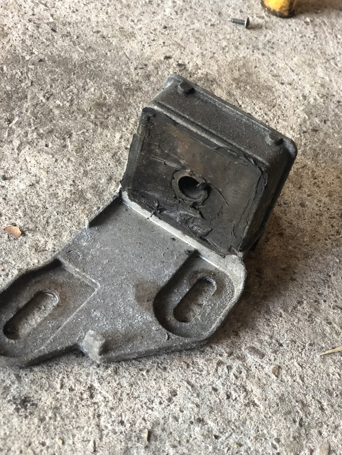

182? Get 2 standard exhaust hangers with new rubbers, then gets some black high temp silicone and start filling it up slowly.
it doesn’t really run, so just go slow. Then once it’s loaded up, smooth off with a wet finger in both sides.
mine have lasted 14 years cost sod all as the mounts were cheap as chips and silicone was a fiver.

That’s one, ain’t pretty but for 5 minutes effort and £25 a pair or less.
