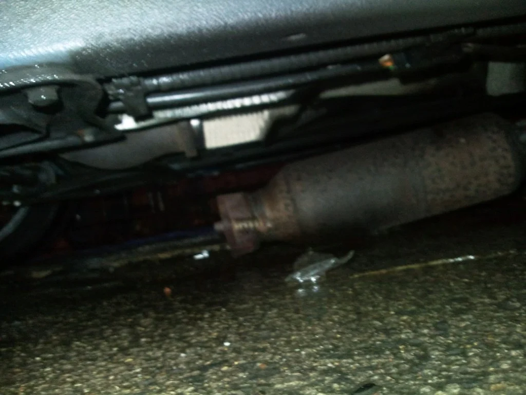

  Octavia vRS
here is a pic of were its snapped, what do u think?

would have to have a look at it, but that just looks as though the bolts have snapped - or have the cups that the bolts sit in pulled through the manifold?
i'd say a decent welder would be able to sort that in-situ if the mani's damaged
ed. if you could take a good picture of the end of the manifold (looking up the pipework), that'd confirm if the 'c' shaped lugs on either side have snapped. even if they have, could likely be repaired for much less than the cost of a new mani+fitting

so u think this could be repaired? i have just found apart on the floor too. i will take a pic of it.
pics would be good. it's probably repairable, but it's finding someone who's interested in making a good job of it that might be difficult (depends how knackered it is)

manifold looks fine from what i can see, fire ring is missing, so i'll guess just knackered fire ring and/or bolts probably

I think that fire ring is what i have found on the floor so my manifold looks ok, just need this part welding back on? I will still get some pics up.
the mesh ring just slides over the lip on the end of the manifold - no welding req'd
if the manifold's actually intact, you just need a new joint kit (about £20 from somewhere like KTEC or NorthWestPerformance)

Sorted this. It was the two bolts that had sheared and I just got the two bolts replaced ans it's as good as new.
