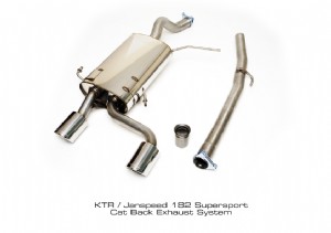

Should have a small adapter piece, like the middle bit in this pic:
