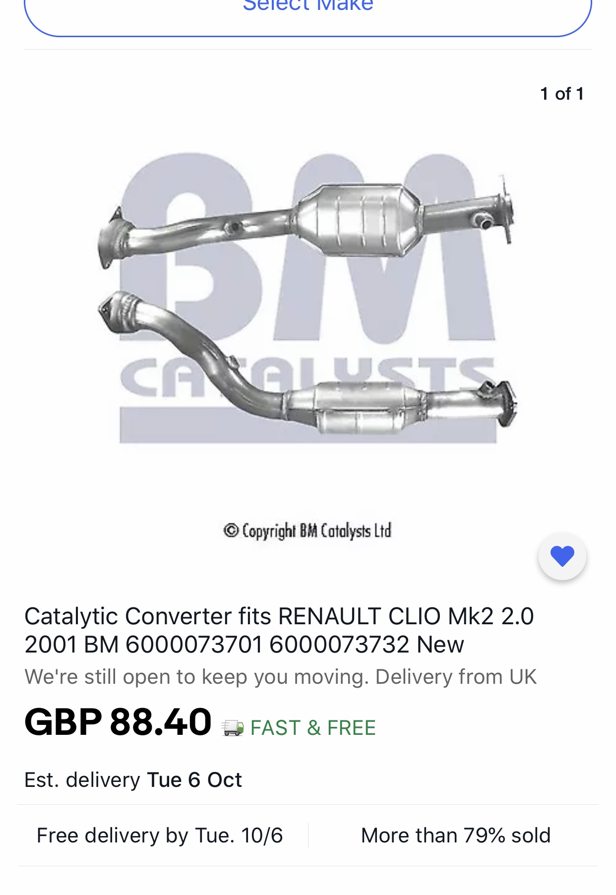

jameswrx
Wonder if these are good enough, seem a bit cheap...
