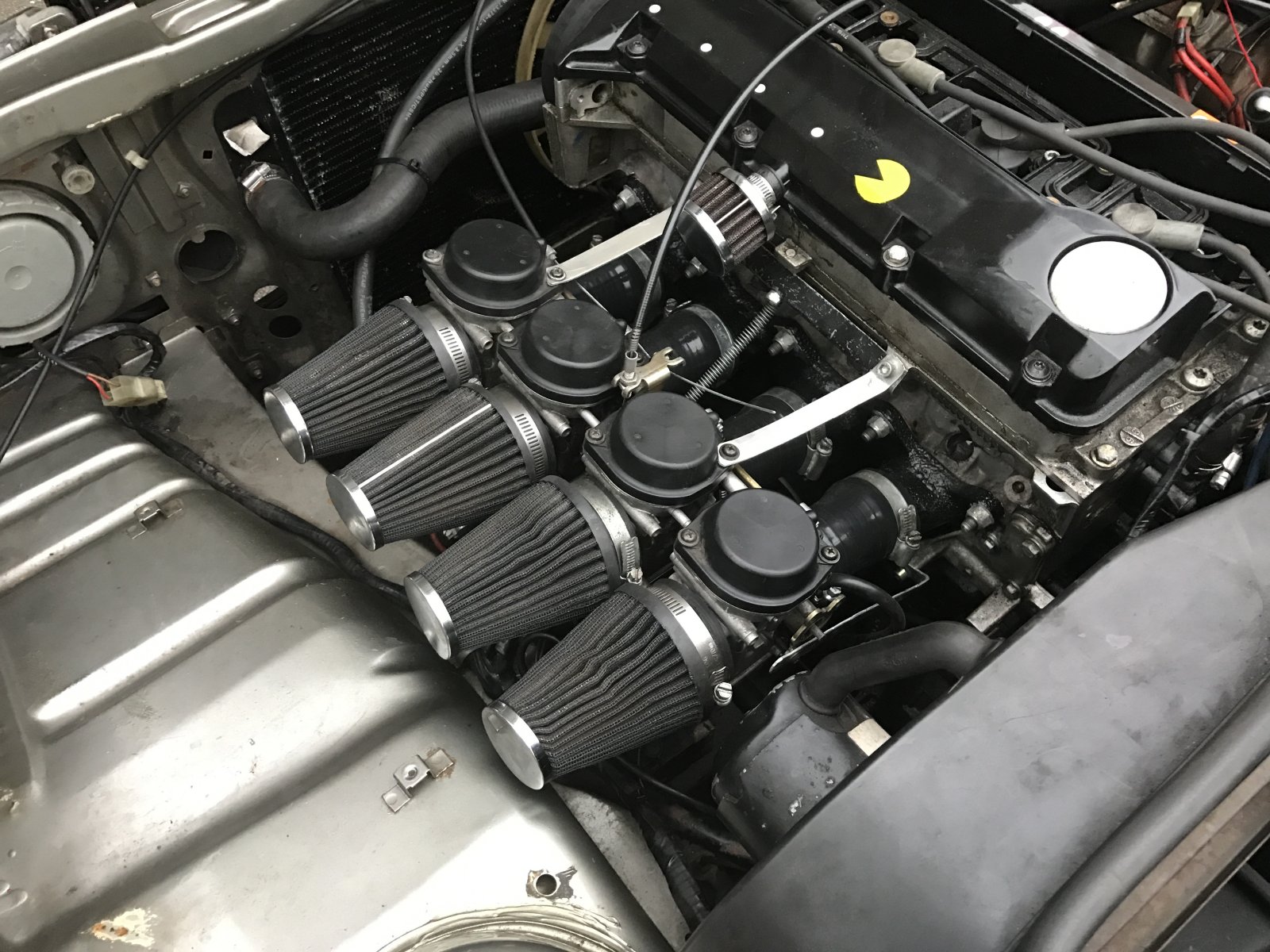

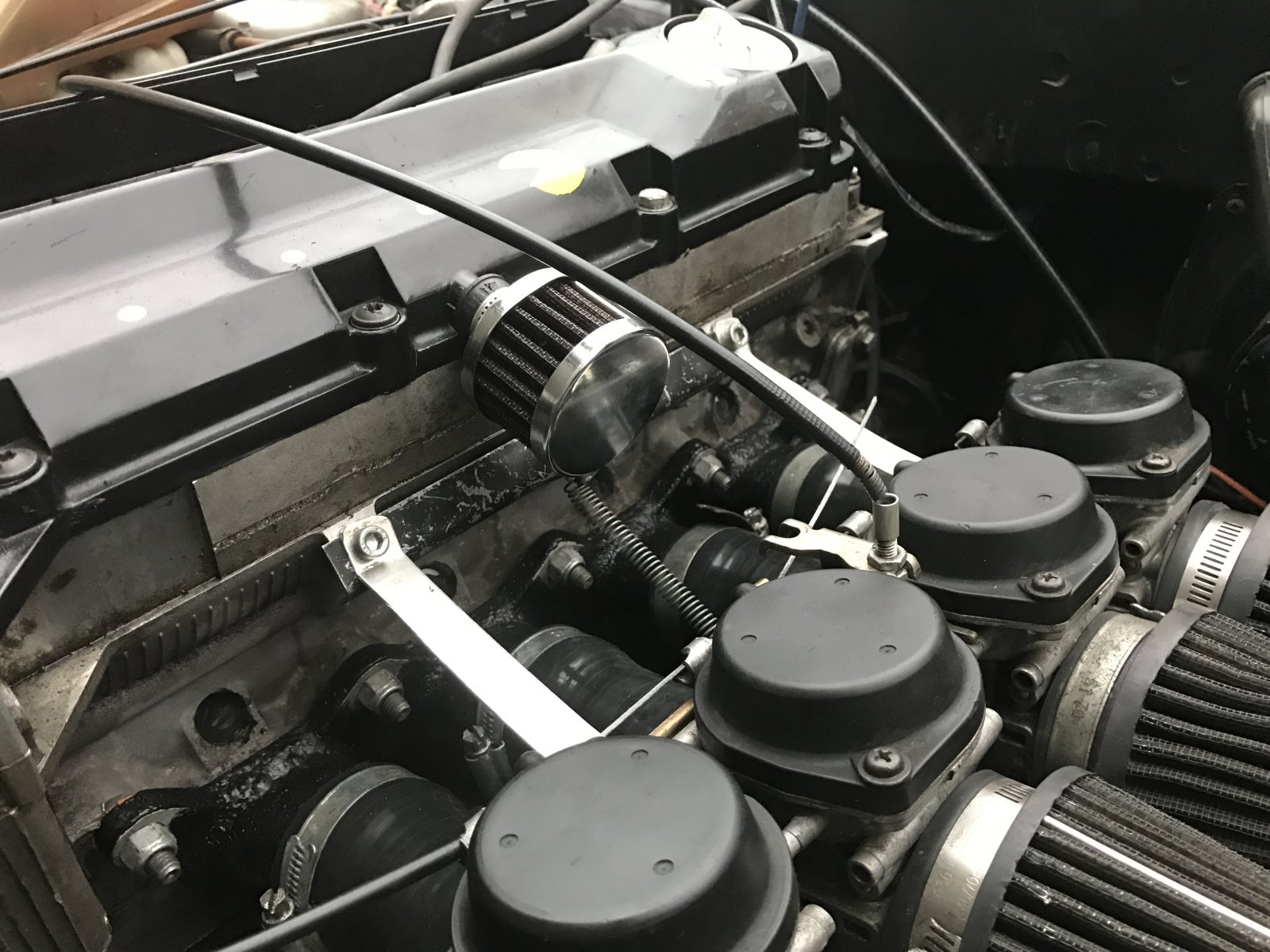

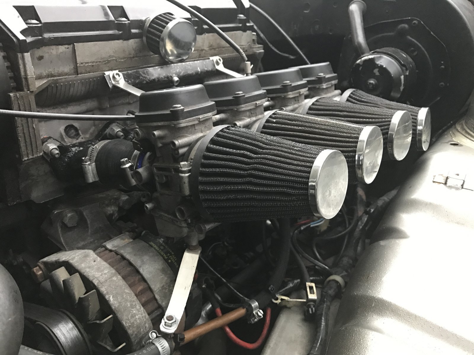

So, my carbs have been shaking themselves loose over the last week or so leading to a couple of breakdowns.
@craigyt came to the rescue again with a little bit of custom bracket work and they're now spot on.

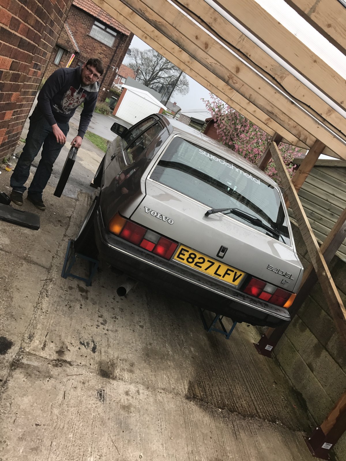

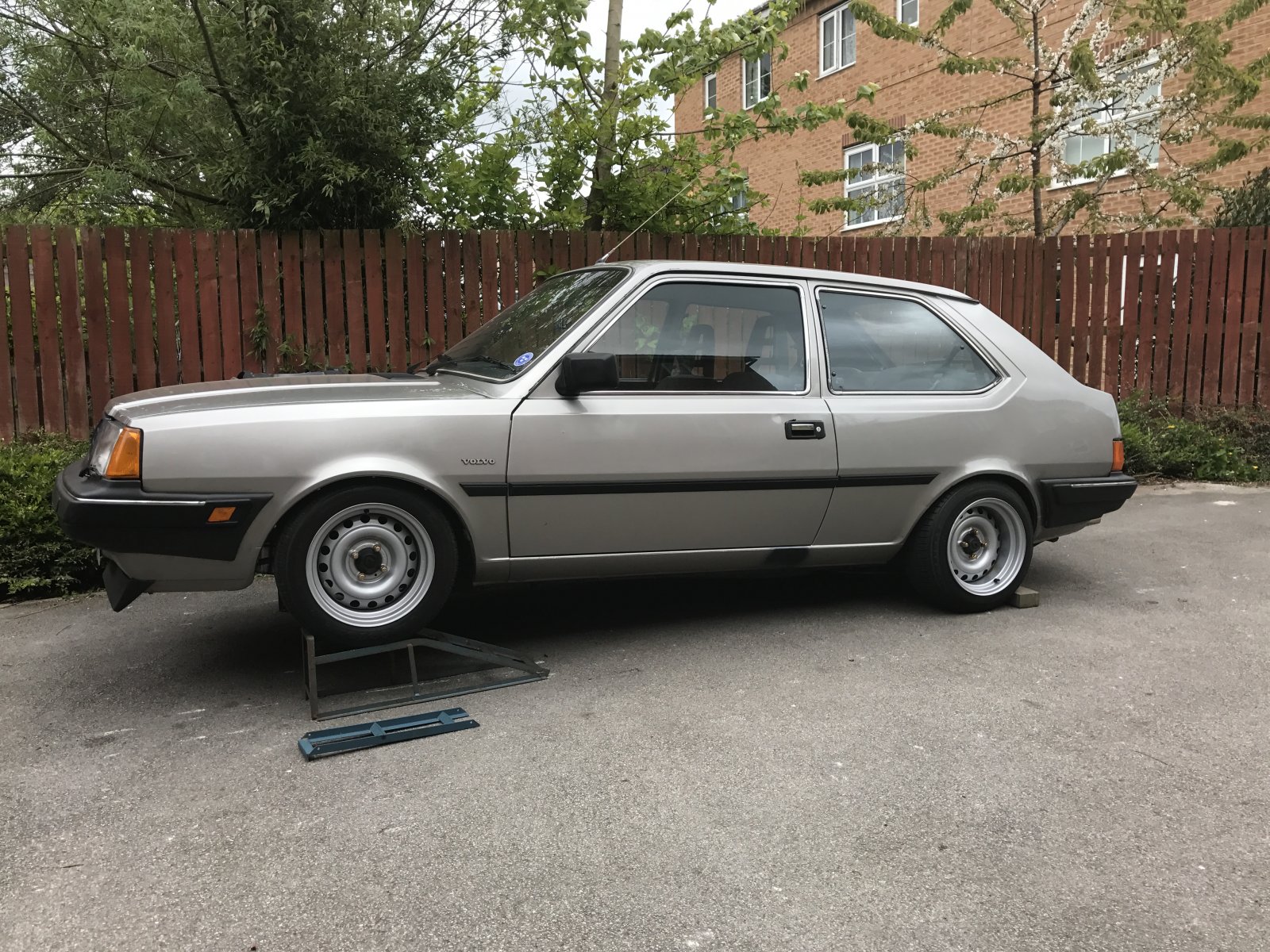

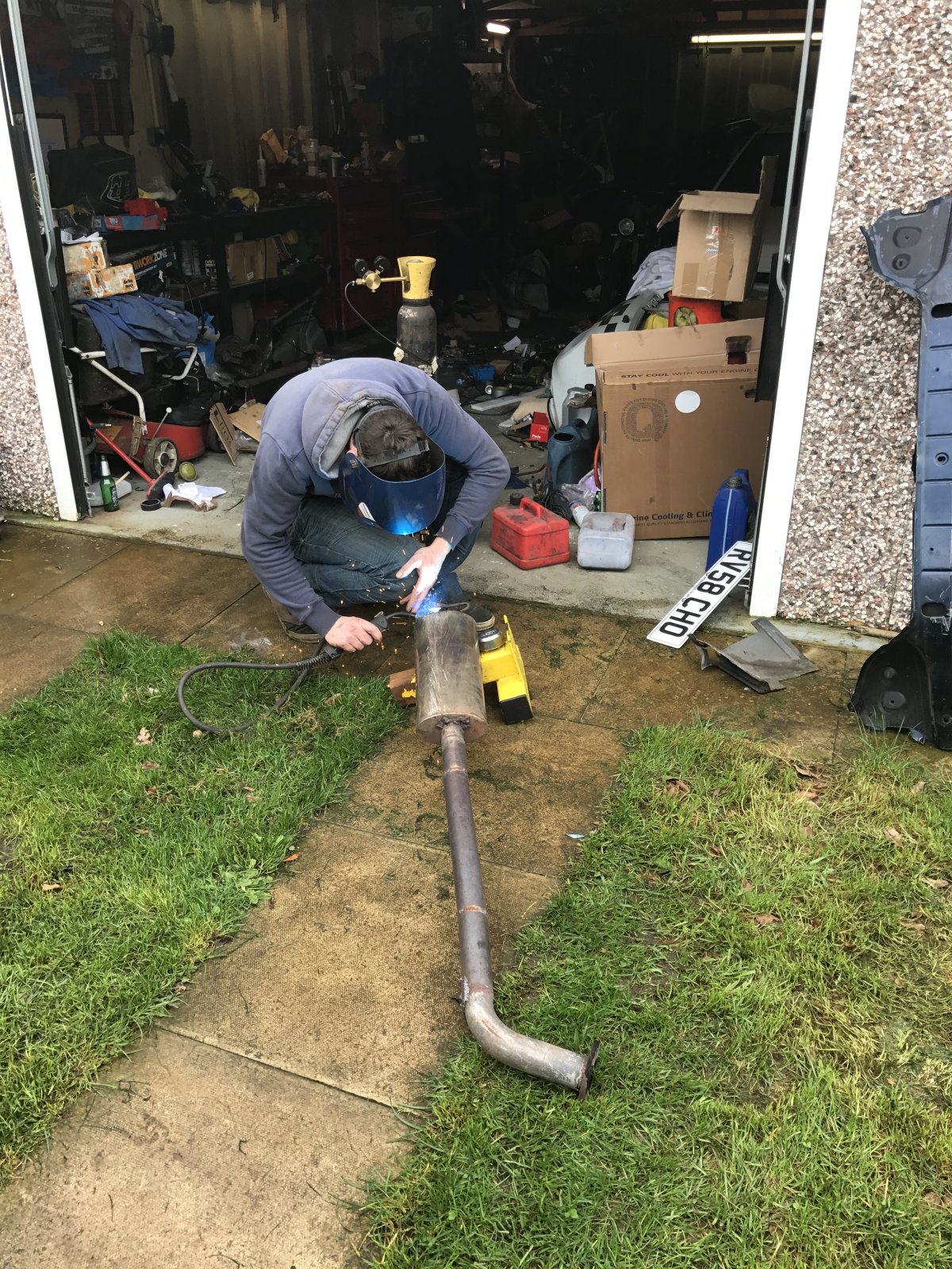

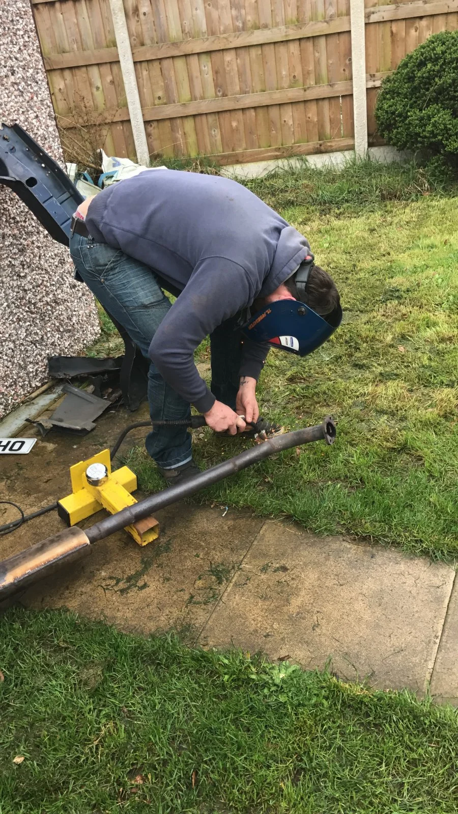

9 hours on the Volvo yesterday with @craigyt!
First on the agenda was to sort the exhaust out which has had a rough time over the last few weeks.
Weld life.

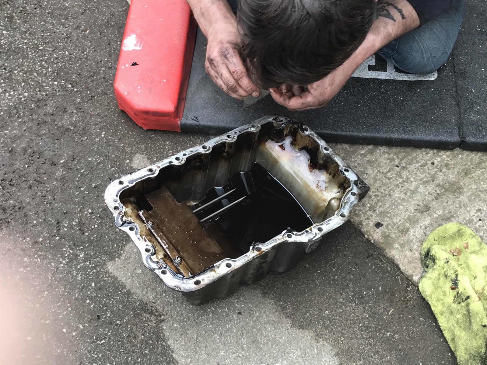

Also, when we did the conversion we found out that the previous owner had just put a bolt in the dip stick which wasn't ideal. Unfortunately it was a sump off job to sort this.
So now the sump is back on with fresh oil and filter and can now check the level!
Picture from the end of the day. The car is booked in for the rust on the door, arch and boot sorting on Friday so we'll see how that looks. I'll then be booking in at the body shop for paint and the car park dents sorting.

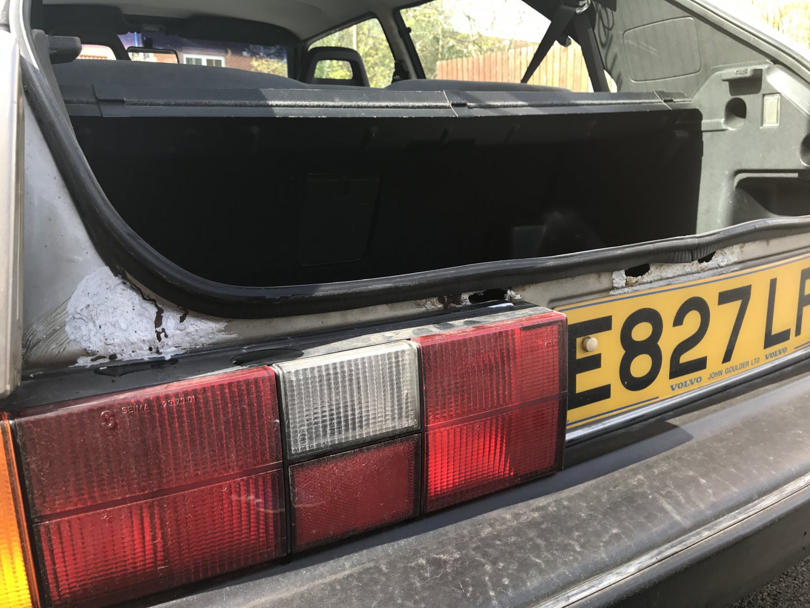

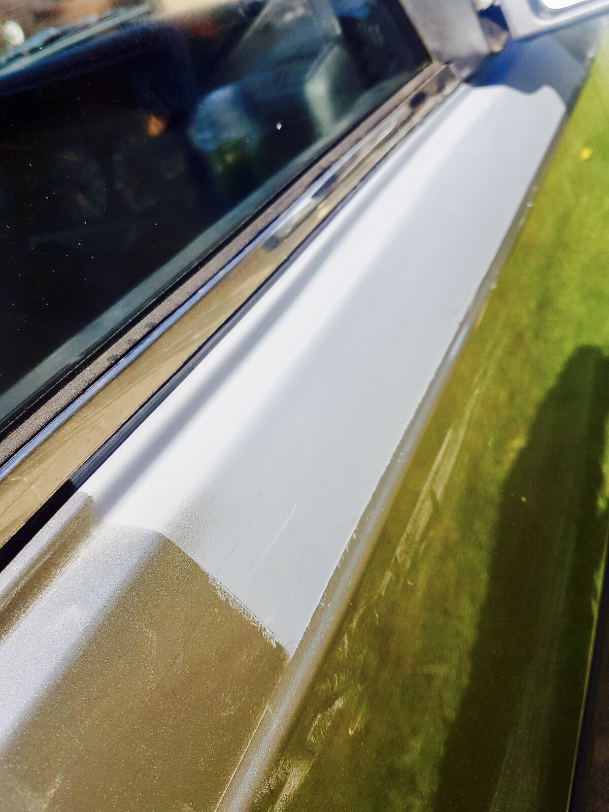

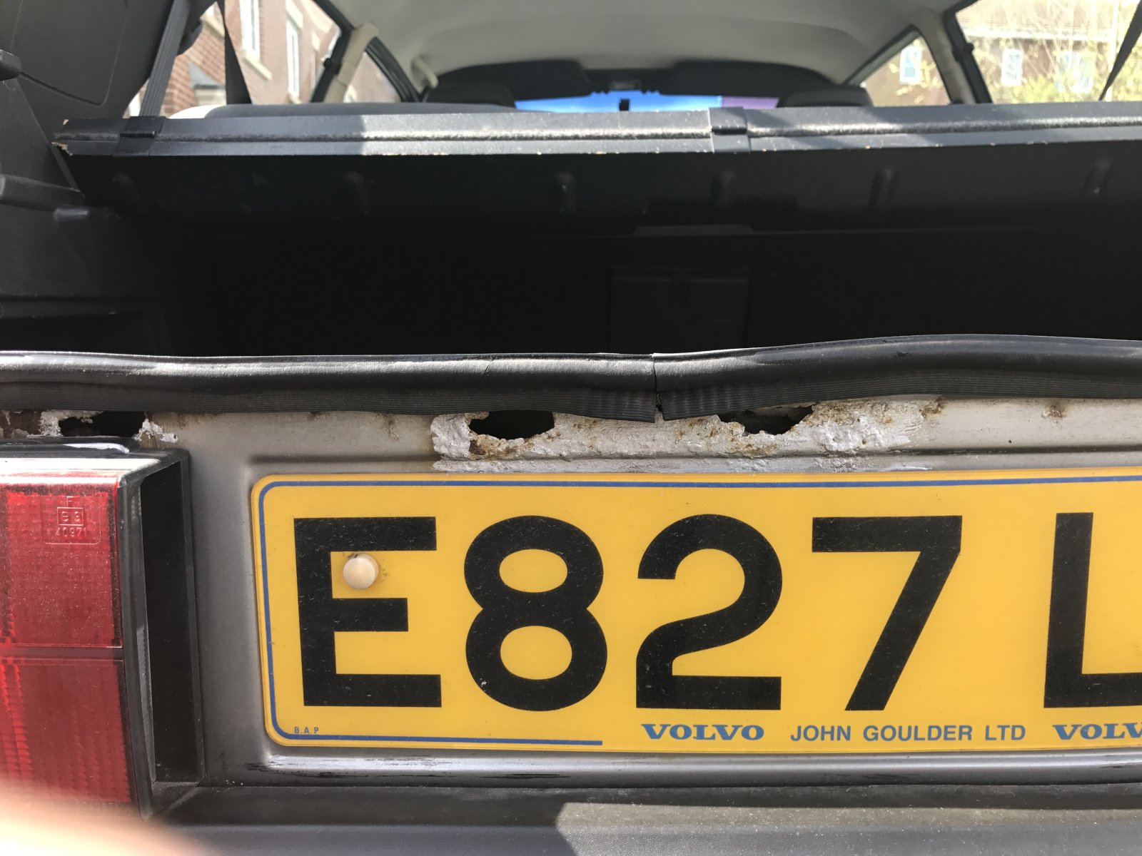

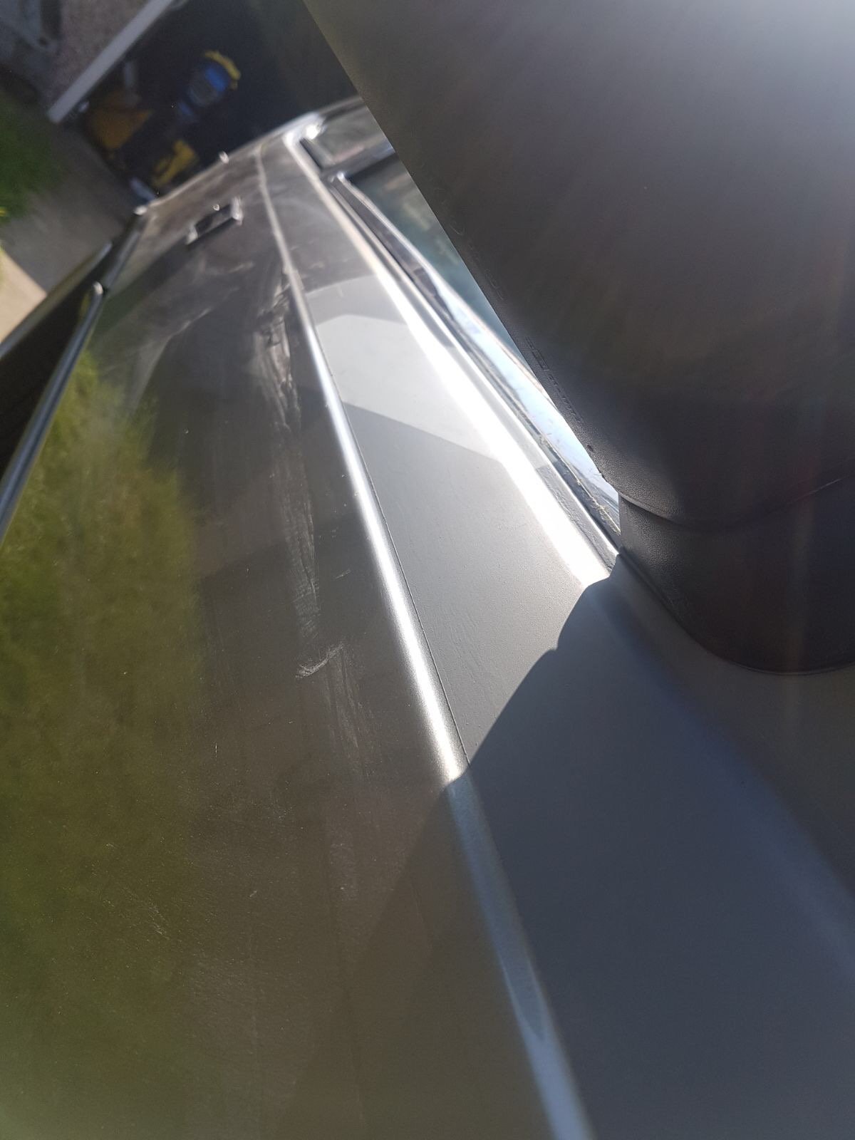

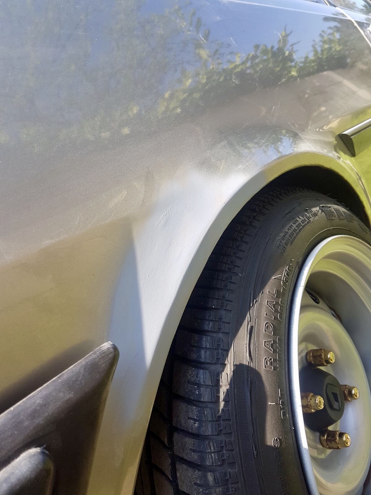

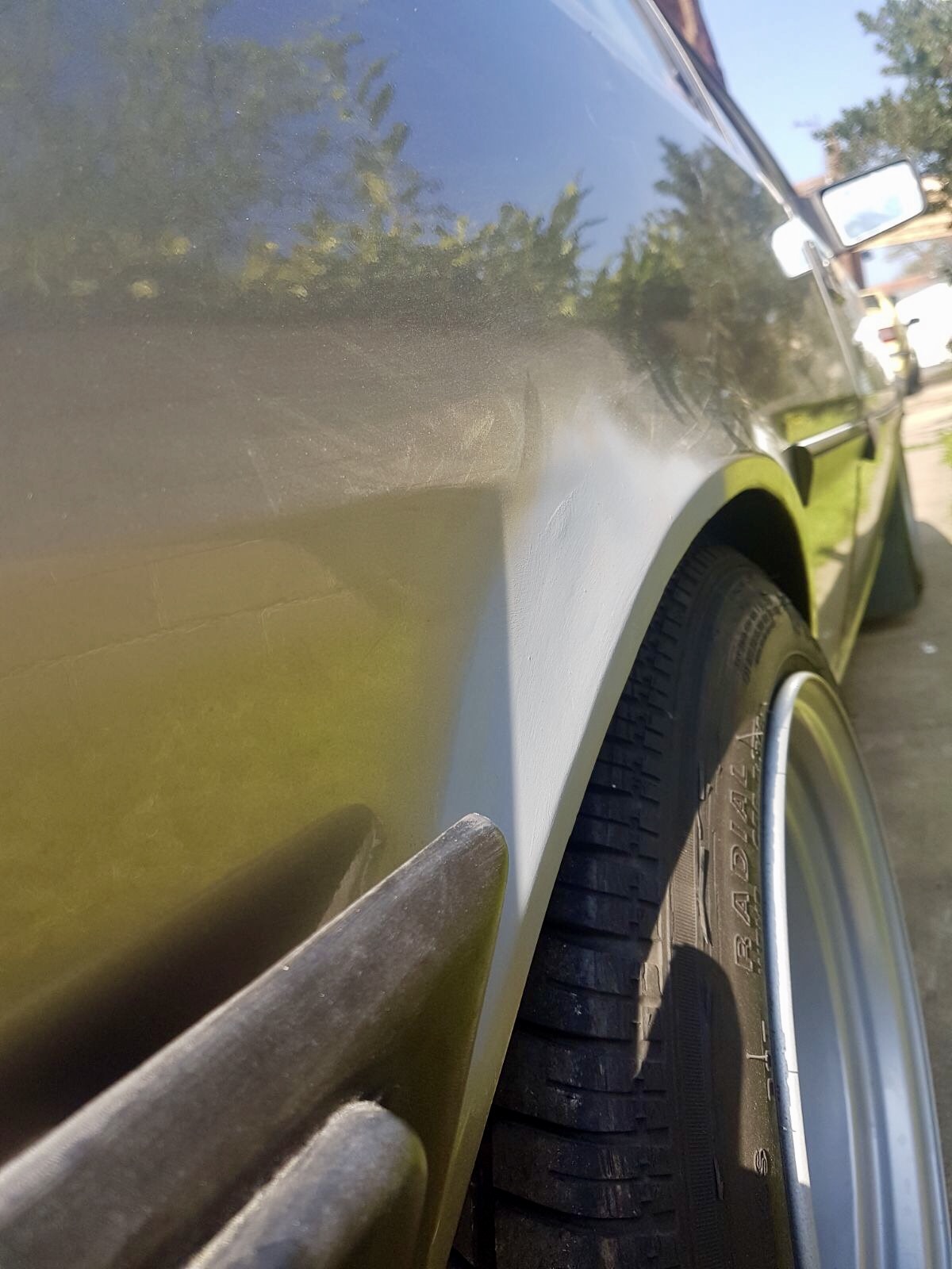

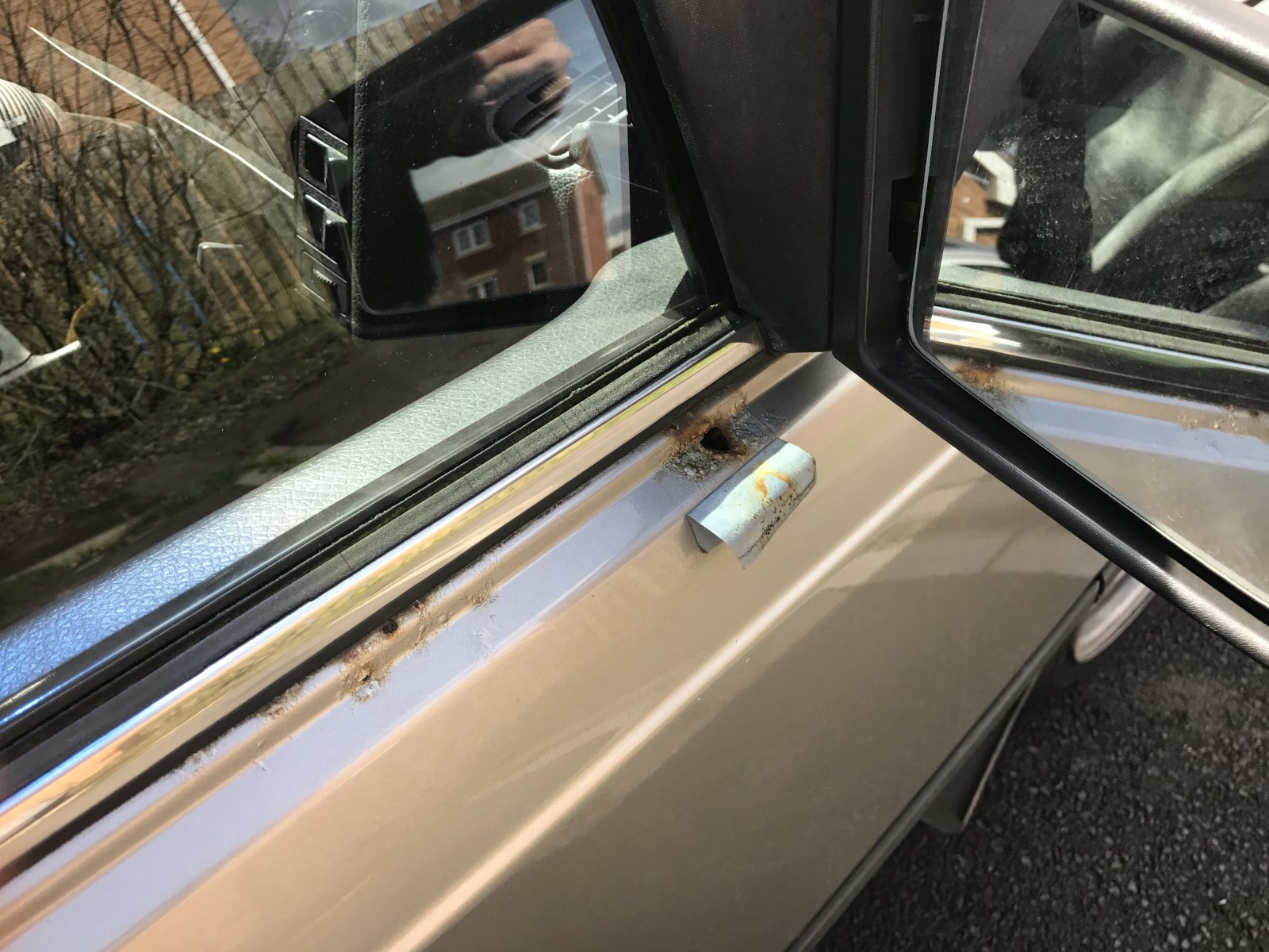

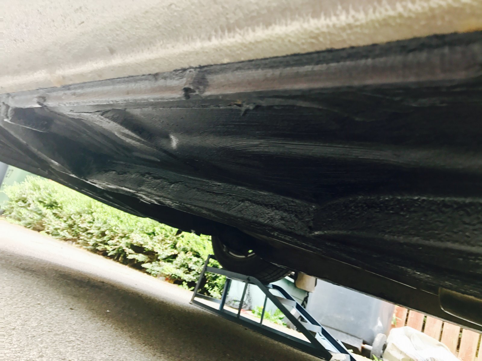

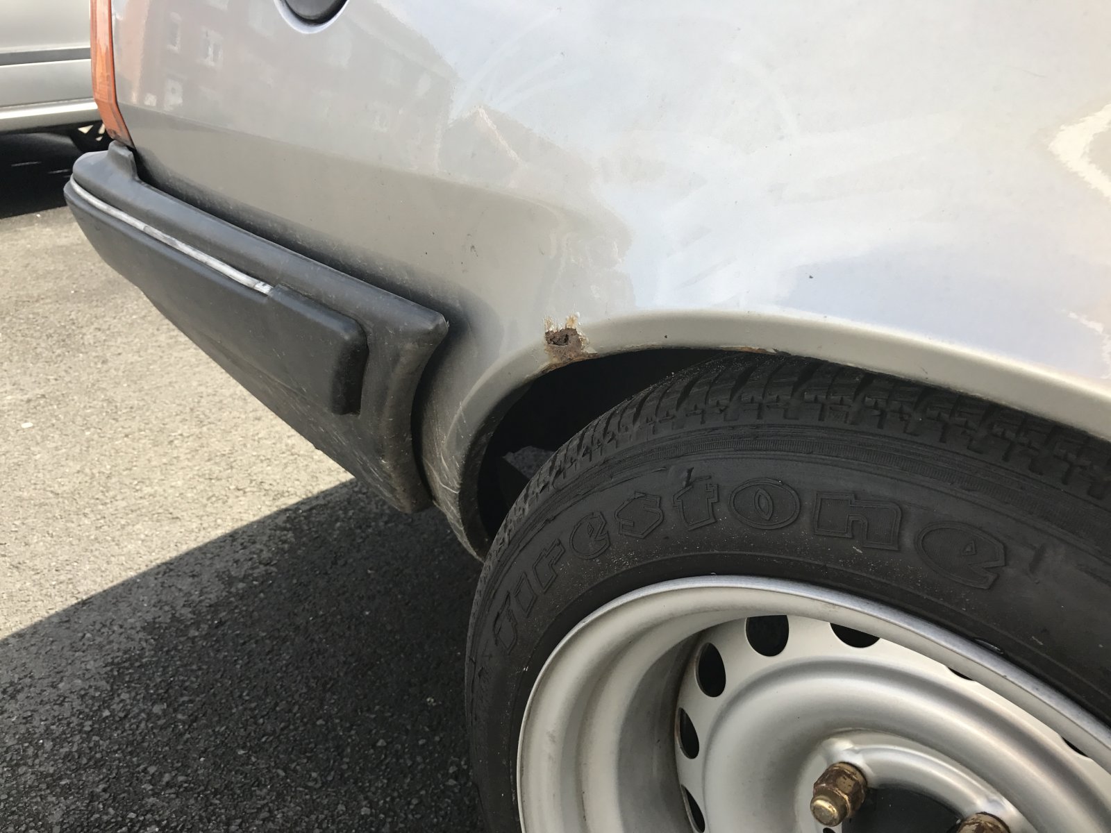

The 340 went in for some rust repairs on Friday. Had a hole in the rear arch and also a hole in the top of the drivers door.
Also the rear panel above the number plate was pretty screwed.
No pictures of the rear after the repairs but got some of the door and the rear wing. Really happy with the repair that's been done and just need to sort out getting the bits painted now.

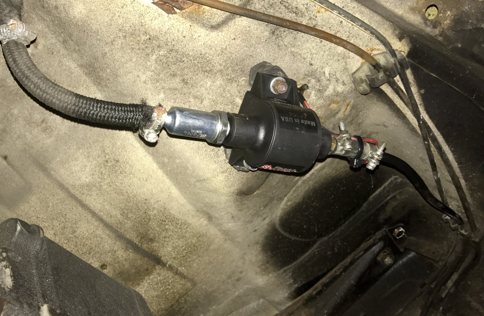

From here it looks like it's hanging off the end of the hose. There's no hose (as far as I can see) on the other side of it, so nothing really to stop it sliding off the end and releasing the fuel hose.
  106 rallye
The lead on the end of the silver filter is very long, the hose is on as far as it was on the old pump. Its on correctly it just looks wrong because of the lack of length cos the hose is a little too hard from the fuel
McGherkin
McPension
I get that the pipe is quite long, but there's rubber on only one side of the jubilee clip, no?
Way I was taught was that there should be hose either side of the jubilee, because to slide off it would have to squeeze the end of the hose before it could slide over it.
  106 rallye
There is hose either side, what you can see is the excess jubilee hiding the hose. Zoom in and you will see it
