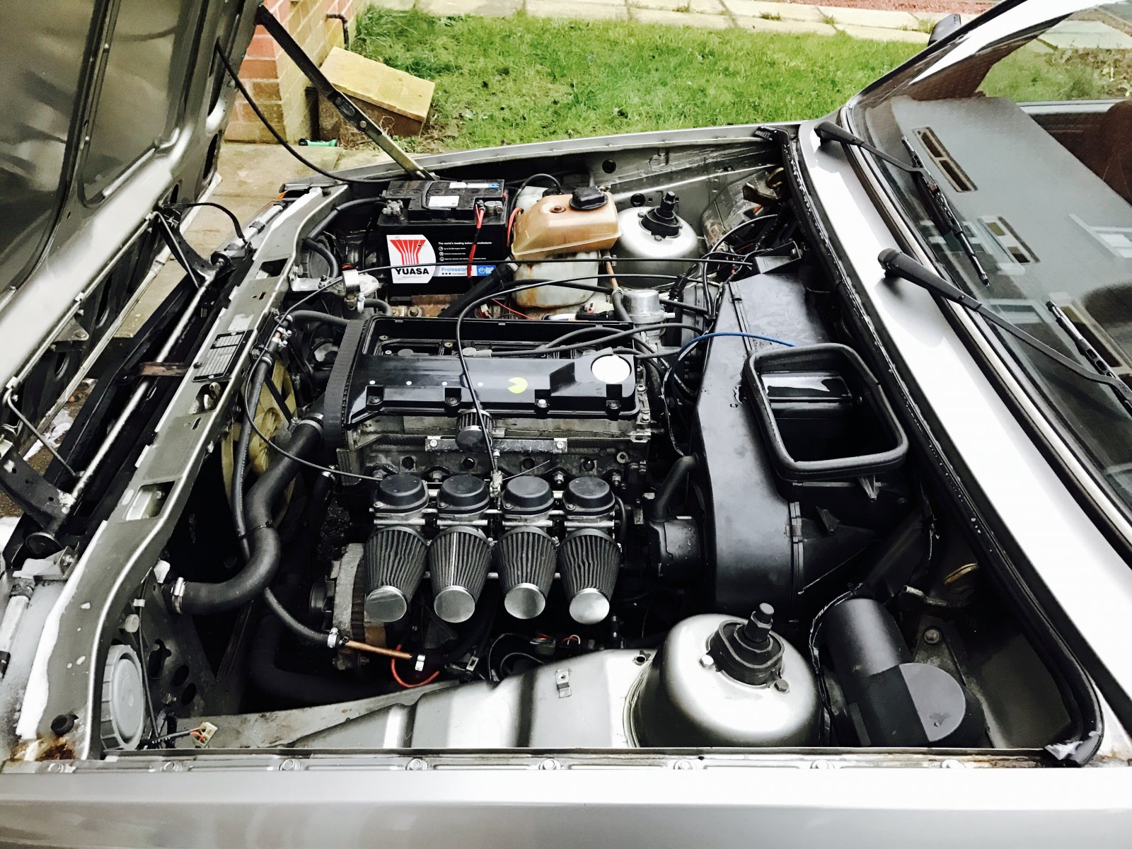

Disappointing day today on the 340.
Set off with craig to get the carbs set up and detect a blow from the exhaust. No biggy. Drive a little further and can smell coolant -check under the bonnet and there appears to be a small leak from on of the hoses as the back of the engine - again no major issue.

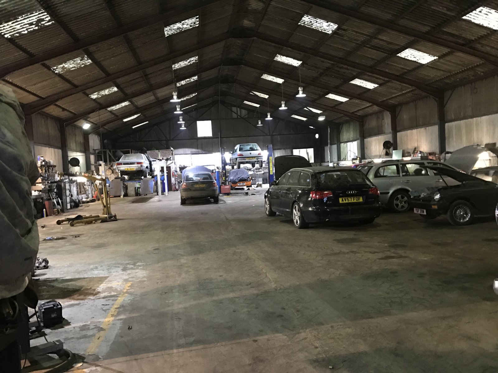

Get to bogg brothers and some mystical old carb guru comes out, sprays the inlet manifold with carb cleaner, detects a leak and tells us to come back when it's done!
So half a tank of juice and 3hrs later my carbs aren't set up and I have three new leaks!
Daz...

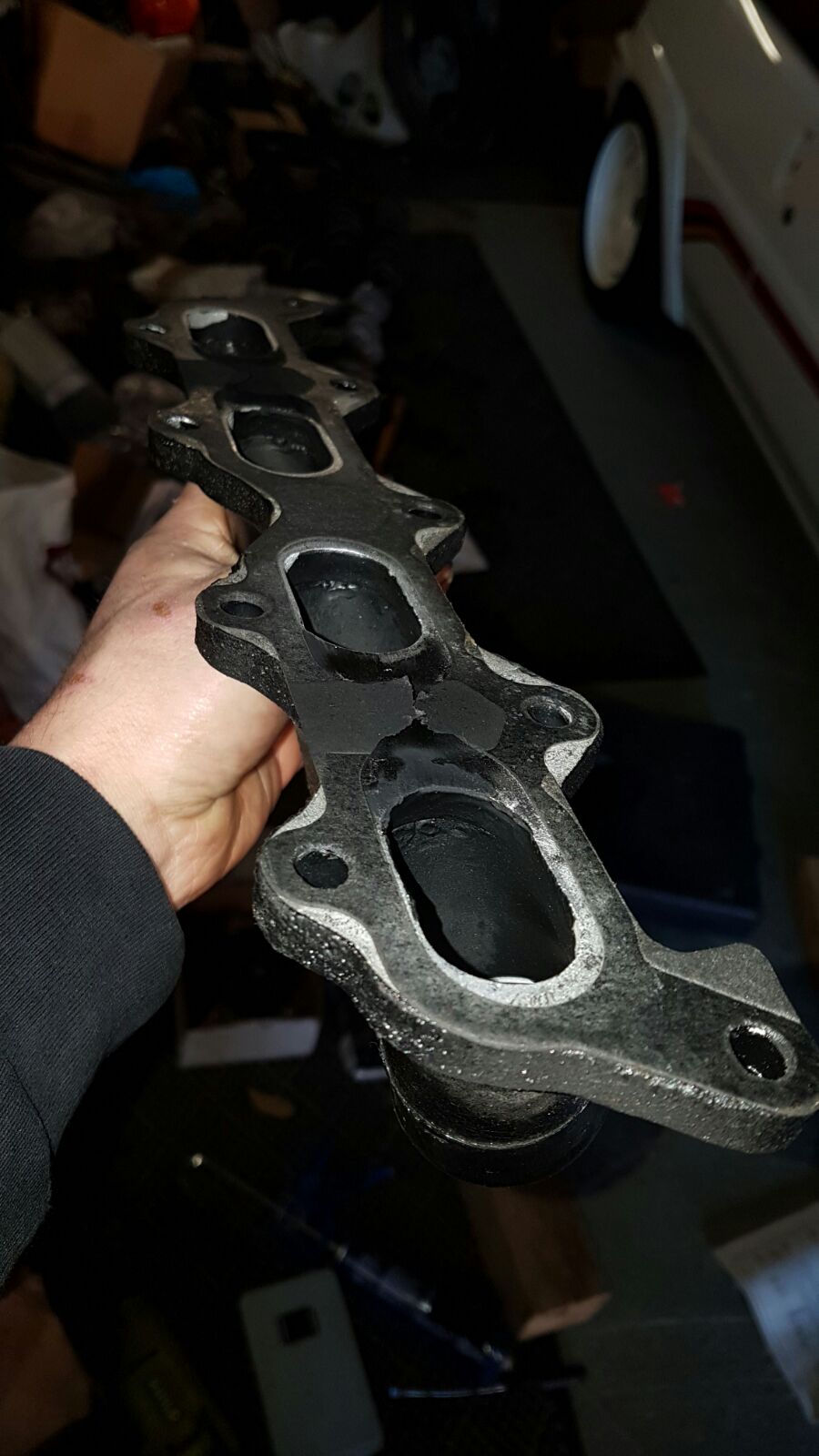

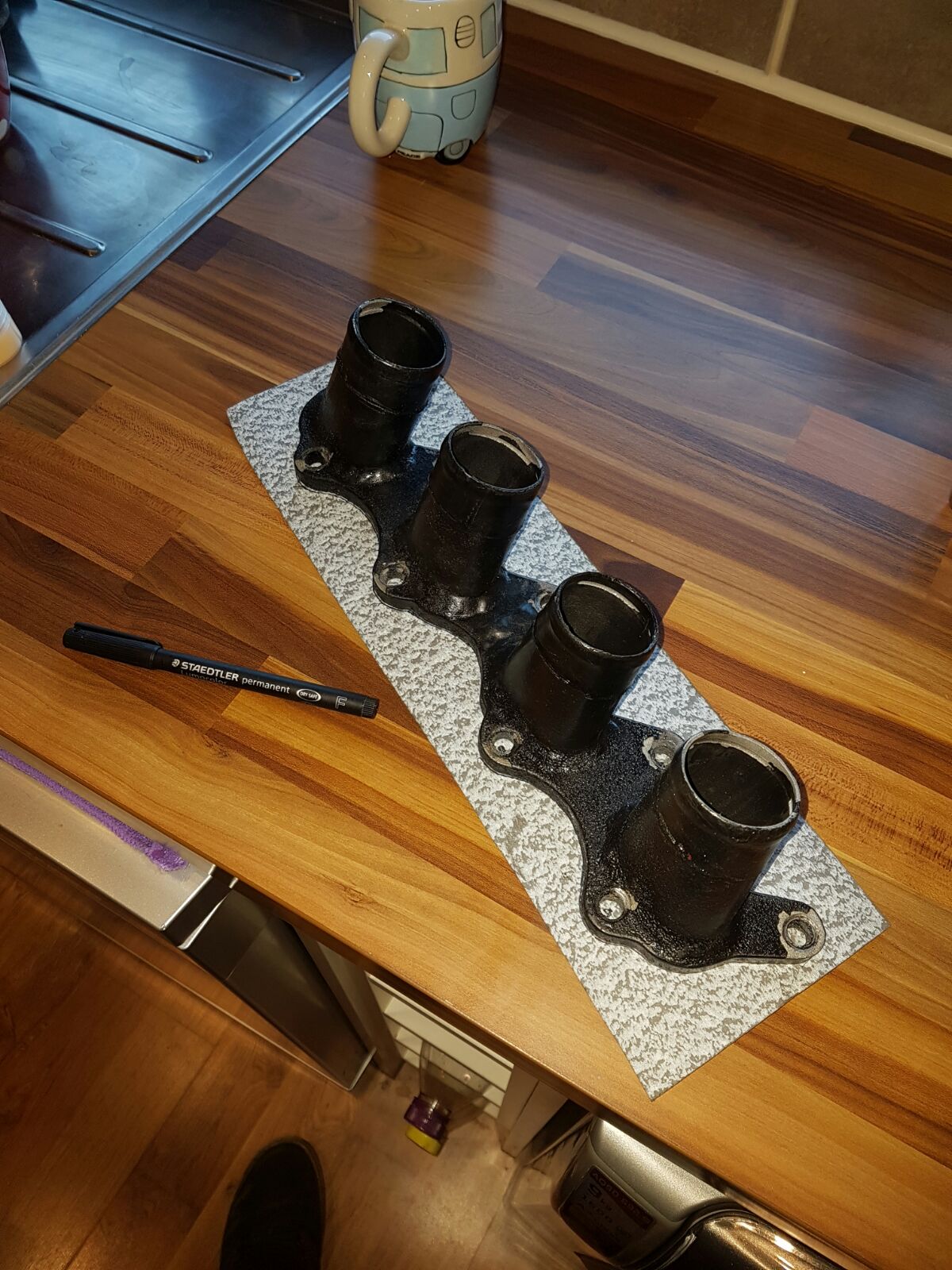

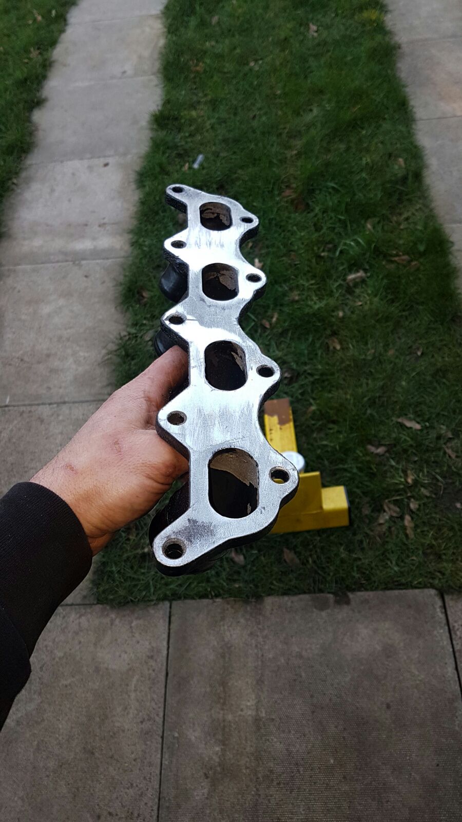

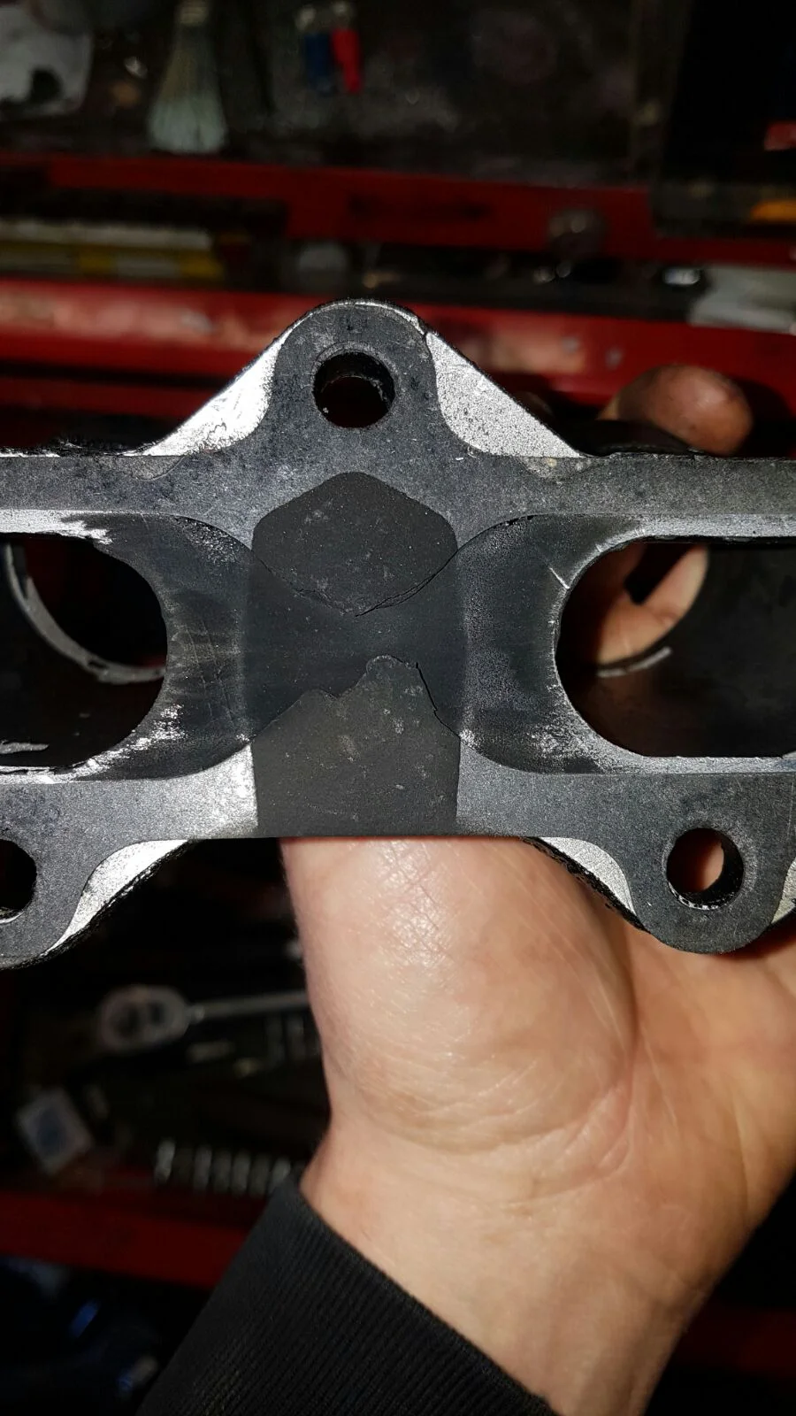

Kudos to @craigyt ? After today's disappointment he got on and sorted the issues out straight away.
Turns out the inlet manifold wasn't very flat - hence the leak!
Silver bits are the high spots.

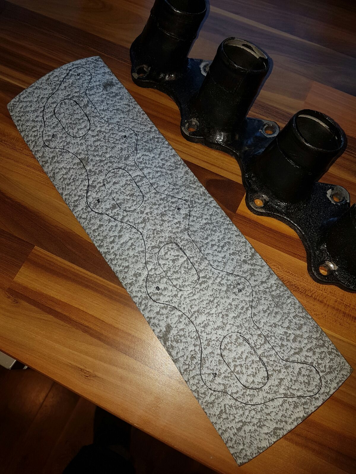

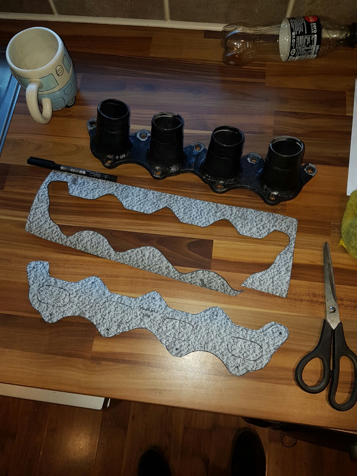

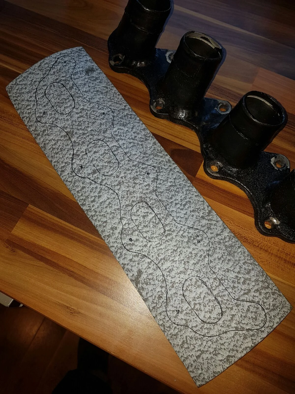

Video of craig righting the wrongs!
The guy from bogg brothers was nice enough to give us some gasket paper so craig made a template and cut it out.
Then back on the car and all the carbs buttoned up!

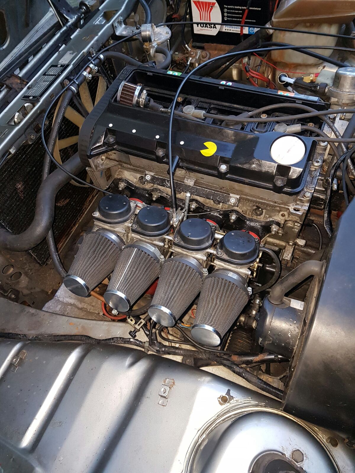

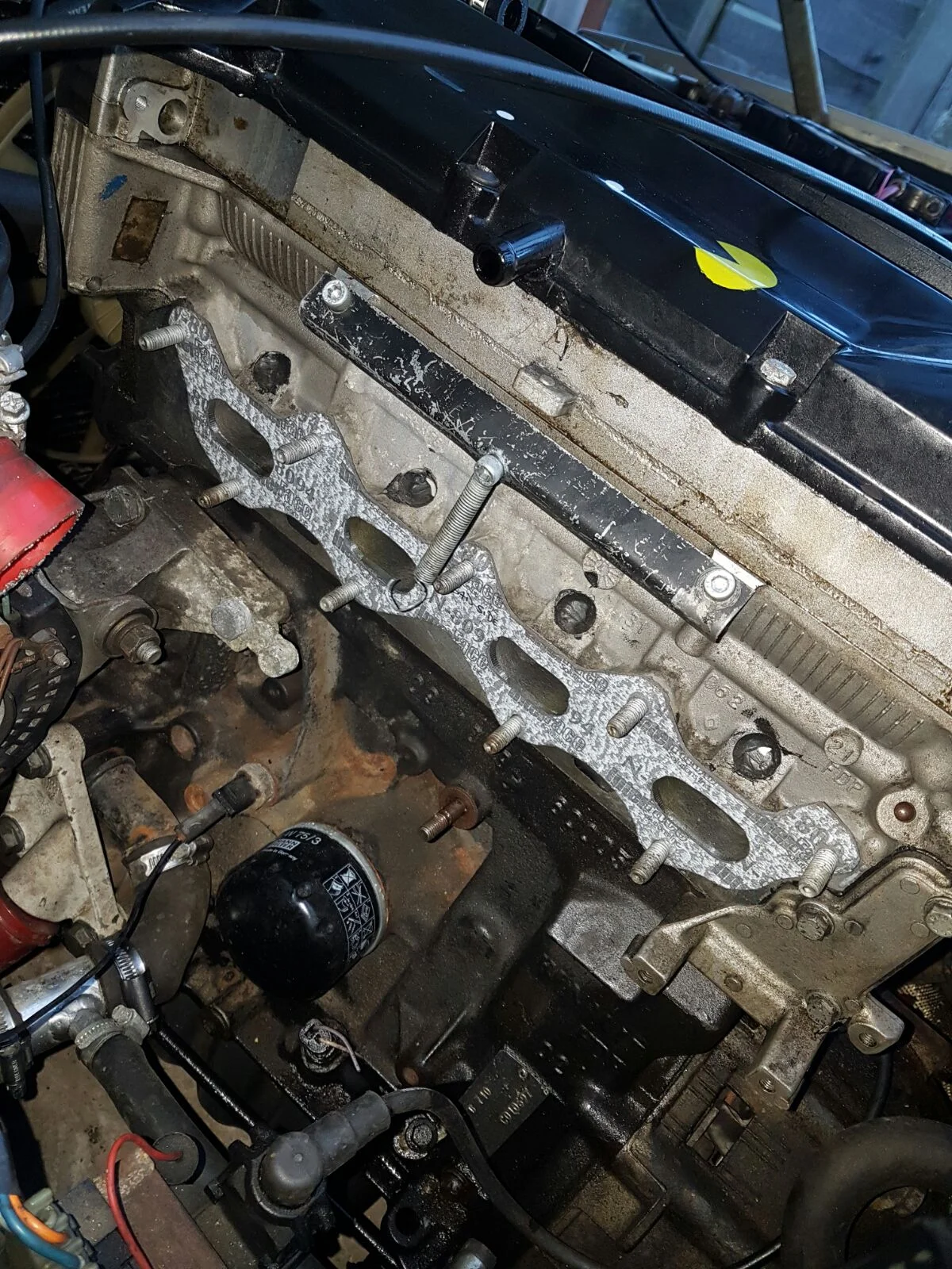

Another day and another trip to bogg brothers!
Unfortunately it was more disappointment! Despite our best efforts the manifold was still blowing so had to come away again.

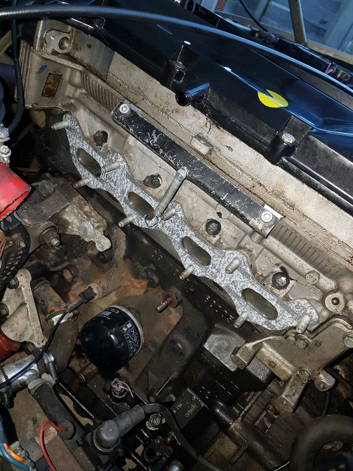

On the way home the car was running like s**t but found the reason why when I got home.

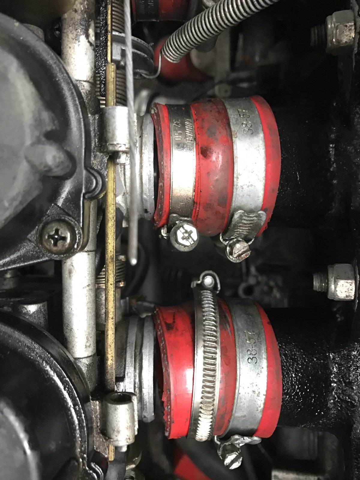

Pretty sure those gaps aren't indicative to good running! Think mr bogg must have dislodged them slightly when tinkering!
Anyway, new plan is to take the manifold to a shop and then rebuild it all from th bottom up with a genuine gasket and see how that goes.
  106 rallye
  PH2 172
The runners have beads on the ends so wont come off. Iv never had yhe carbs off at that end so either bogg has been messing or they havent been tight enough from the start as iv never checked that end!!!!

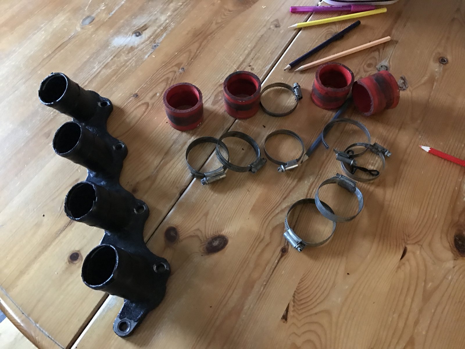

Sorry, I`m not familiar with the term runners. Please explain.
The red hoses used as inlet rubbers appear to be just plain radiator hose chopped to length.
  106 rallye
The runners are the pieces of tube on the inlet manifold that the silicone joiners slip over. These have a bead on them so the silicone shouldnt slide off
  PH2 172
Not a commonly used term, but you are correct.
This is what I had in mind, with a proper lip to locate the carb.
