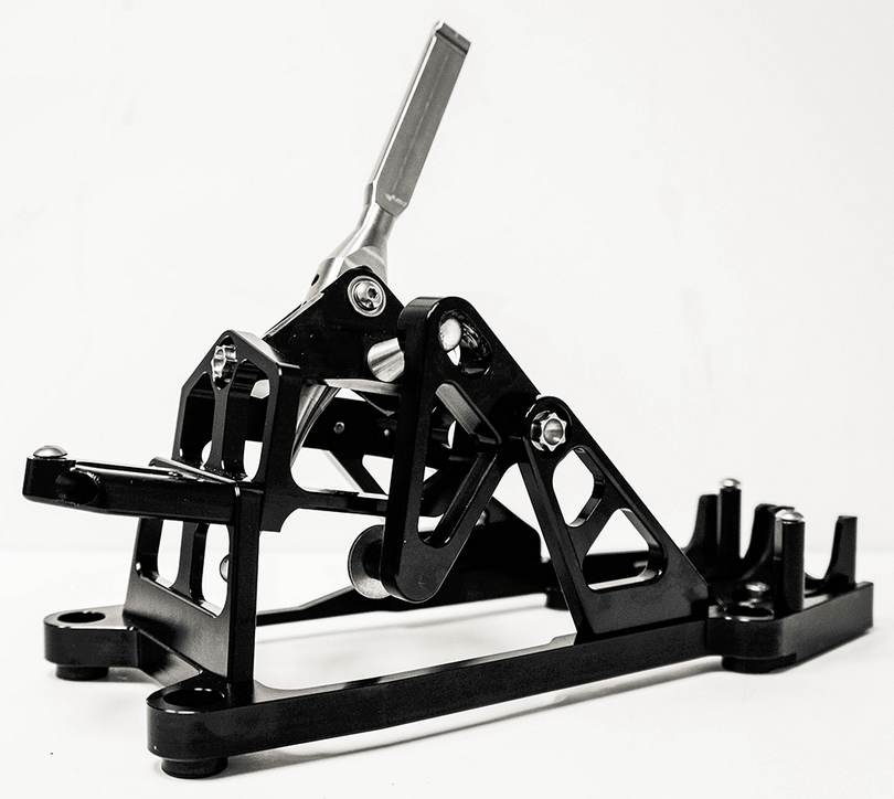

The likes of the CAE etc suffer less as they’re all designed for boxes with cable operated shift. The BMS/modified Scenic item isn’t quite right either even though it attempts to fix the issue with a middle ground approach. The issue I find is the control weights on it are too light and it doesn’t feel right to me. Just a long OEM shifter and the increased leverage means it has little to no feel. (Just my opinion).
Similarly I have a Numeric Racing billet shifter & cables for the Cayman which is as pretty to look at as it is use.
All solid roller bearings and so precise it makes a PMS feel like wooden spoon in custard.

Mine had the original option Porsche short shifter which I have to say is pretty good. This is the true meaning of the words “bolt action” though. To be honest, the price isn’t that bad $700 USD.
