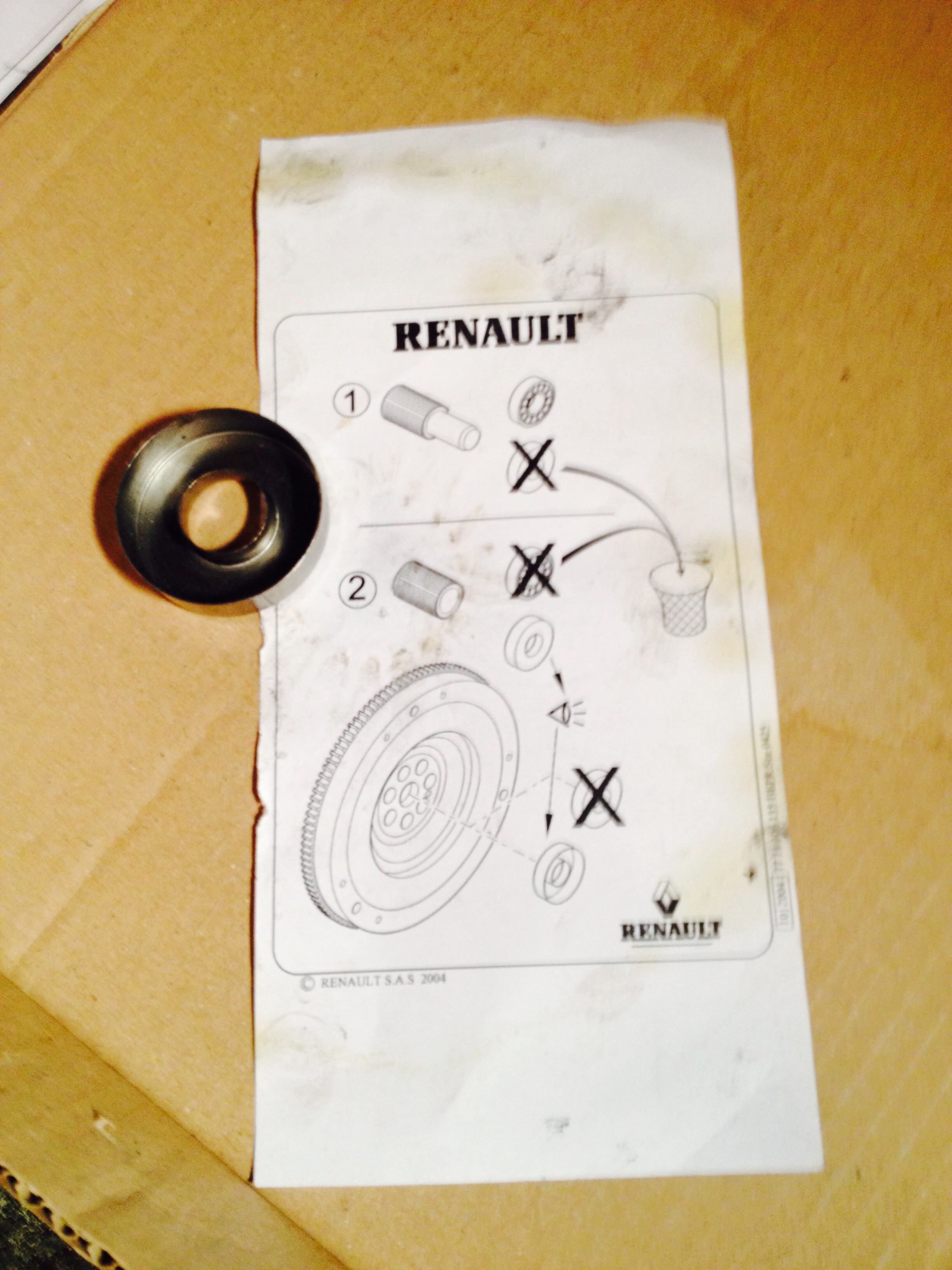

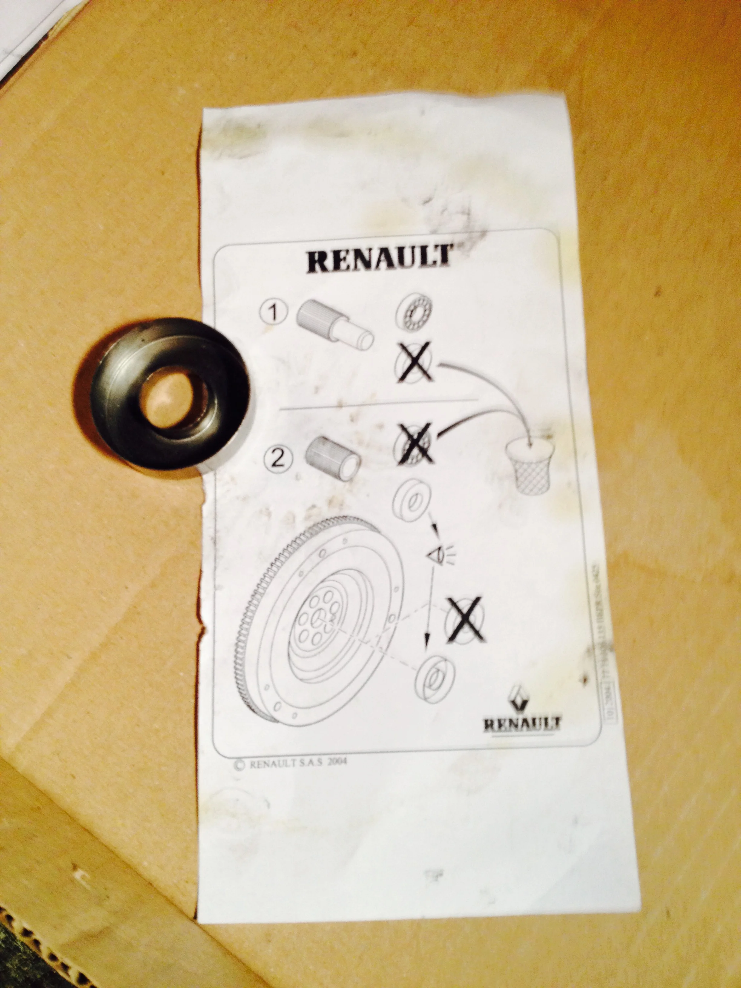

C ciaran1380 Car 2005 Clio 182 FF Oct 25, 2015 #1 Changing the clutch at the moment and trying to figure what this means? It fits onto the clutch alignment tool, but isn't solid between the clutch plate and flywheel? Does it even need to be fitted? Attachments image.webp 468.9 KB · Views: 257
Rob669 Car 172 Ph1/Scooby MY00 Oct 25, 2015 #3 It fits on the flywheel, it's a bearing and goes on first, then the clutch and then the cover.
B bloke Car dan's cast offs. Oct 25, 2015 #4 Rob669 said: It fits on the flywheel, it's a bearing and goes on first, then the clutch and then the cover. Click to expand... never seen a bearing like that in my life:wink:
BashRacing ClioSport Club Member Oct 25, 2015 #5 the input shaft on the jc5 box doesnt have a spigot end so no need for a bearing, it's just a piece of pressed tin, chuck it
