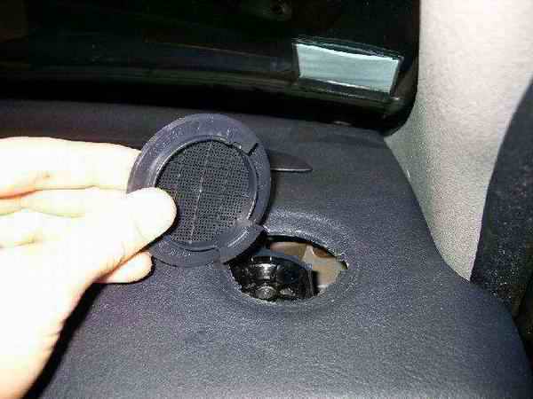

Thanks everyone, I appreciate the help! So in terms of speakers, is there anything I should be looking for? Also for rear, is it coaxial ones I buy? (not sure where the tweeters would go if I bought component!)

For the tweeters they are in your dash, they are about 3" wide
Here :) If you were to replace them you would need to remove the top dash plenty of guides of how to on here :)

Yea for the rear coaxial is what you want.
Probs best just to replace the door speakers with coaxial too, as you'd struggle to wire up components judging from your experience!
Then just leave the tweeters or unplug them if they sound too harsh.
