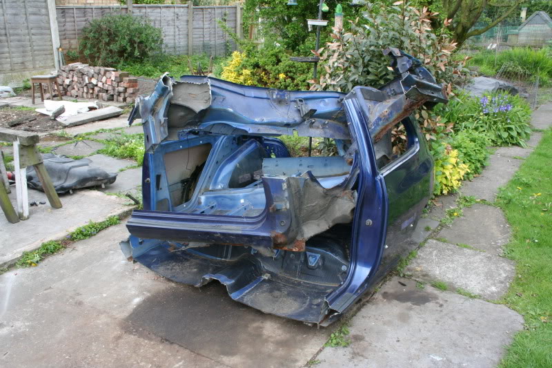

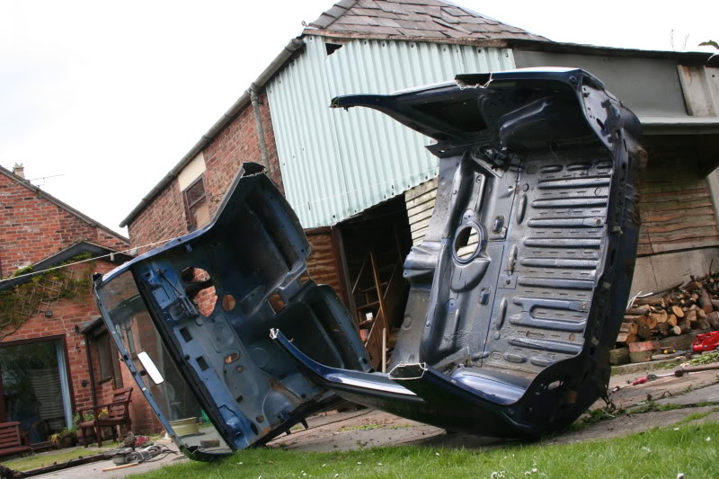

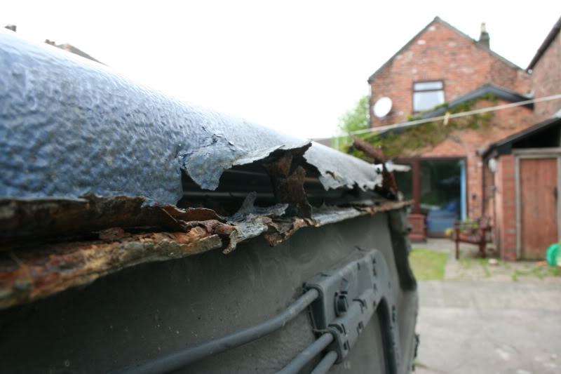

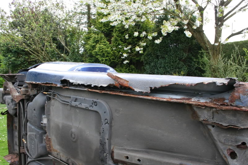

I wish i'd taken pictures of my grey one before I weighed it in.
It looked mint from the outside, not a mark on it. Even the sills looked original! Got it on a ramp and it was held together with silicon sealer/filler and about 3 layers of stonechip paint. You could stab holes all the way down the inner sills with a screwdriver.

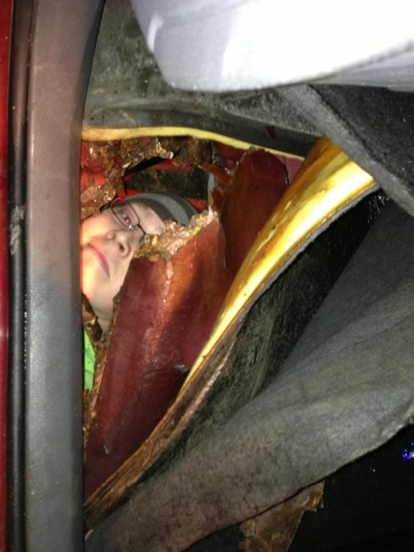

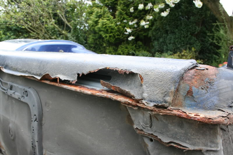

This was on one that had failed an MOT on rust underneath. It looked quite tidy, But it was rotten. Worst I've seen. Shame that it had been botched! Cheack rear inner arches all round and at the end of the sills especially. Use a skrewdriver or something to just poke about in there.
Under the Underseal there was someone hiding in the hole, In the passenger foot well! :lolup:

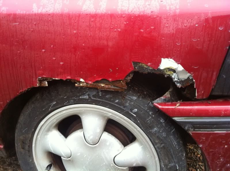

What about the red one that stu has posted on the previous page?! That whole back Wing is full of rust and filler! Look at the state of it!

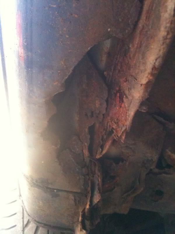

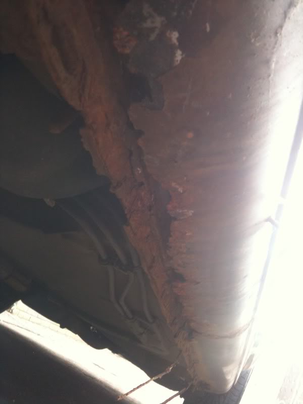

Heres another of my awesome purchases. Inner was just as bad as outer, it was rotten up inside the car too. Dont have many pics though.
Heres front passenger jacking area.
only needed 'minor' welding when i bought it. Sideskirts hid most of it!
