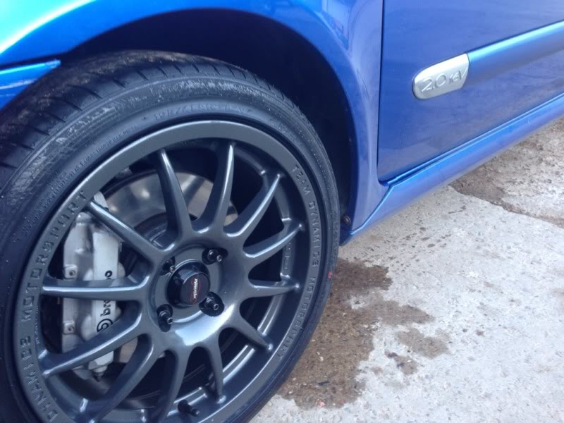

M MG cup Car Cup In bits May 8, 2013 #2 You have more threads than posts, I take it you struggle with reading. Answer is yes, 16" wheels with small spacers or 15" wheels with big spacers are needed (wheel dependant) custom brackets, 197 braided hoses
F fluffy dice Car 172 May 9, 2013 #3 just got myself some 4pot brembos myself for my 172 the a easy fit? did you buy or modify some brackets? and they will fit in 16"?
LiamR172 Car None May 9, 2013 #4 Did you not read post number 2 in this thread? Clearly states that they fit under 16" wheels with small spacers, or 15" wheels with large spacers.
bozothenutter ClioSport Club Member Car FF Arctic blue 182 May 9, 2013 #7 Hmmm, i rin et37with 10mm spacers.....thus means in can go to 7mm spacers! Might solve a small rubbing problem
M MG cup Car Cup In bits May 9, 2013 #8 I can't remember how tight they were to the caliper but definitely needed a spacer to work.
bozothenutter ClioSport Club Member Car FF Arctic blue 182 May 9, 2013 #10 Use the search man! There is a guy called seiz on a french forum. Pure do a whole kit. And some of the ppl on here hed their own made up
