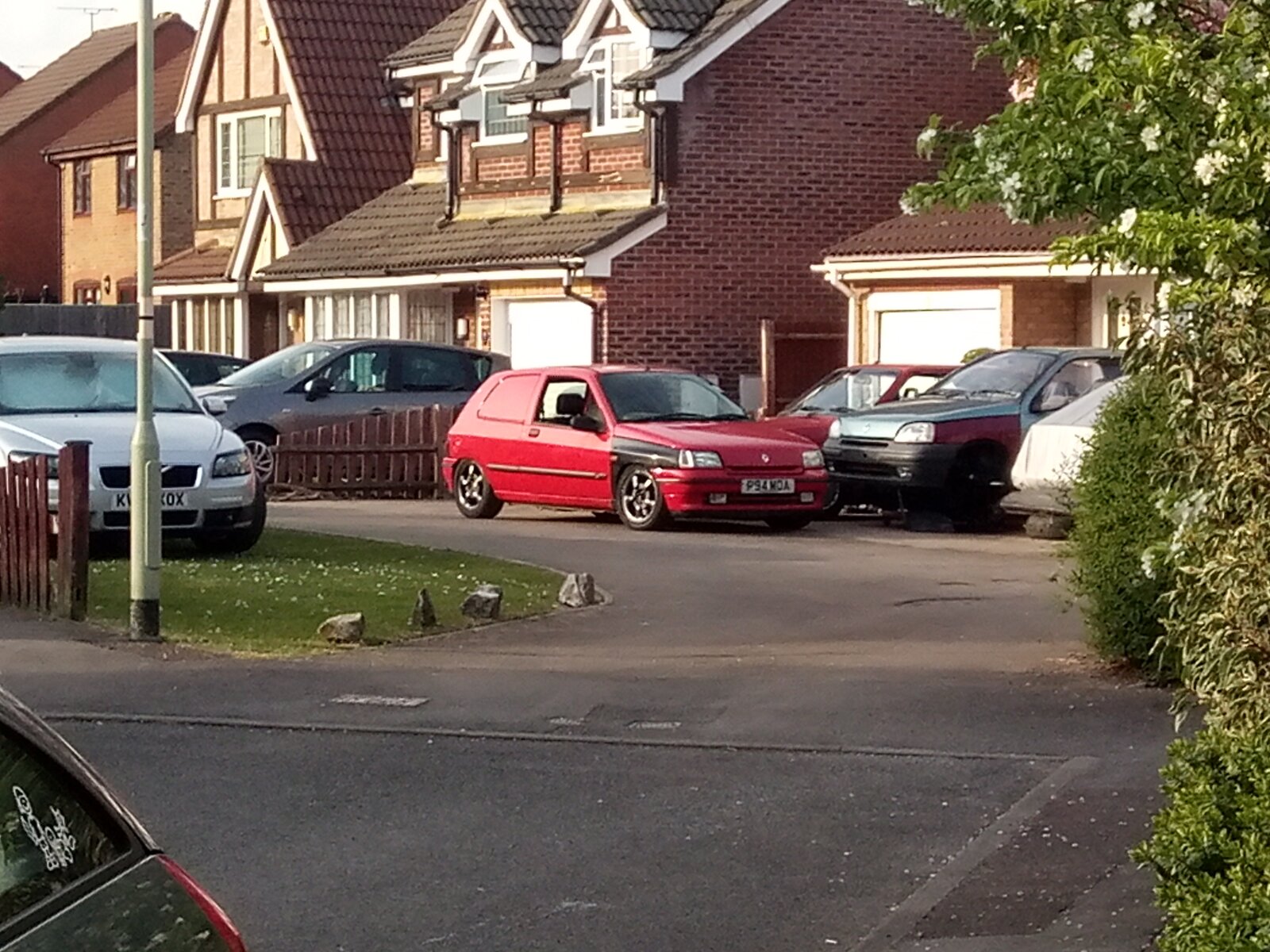

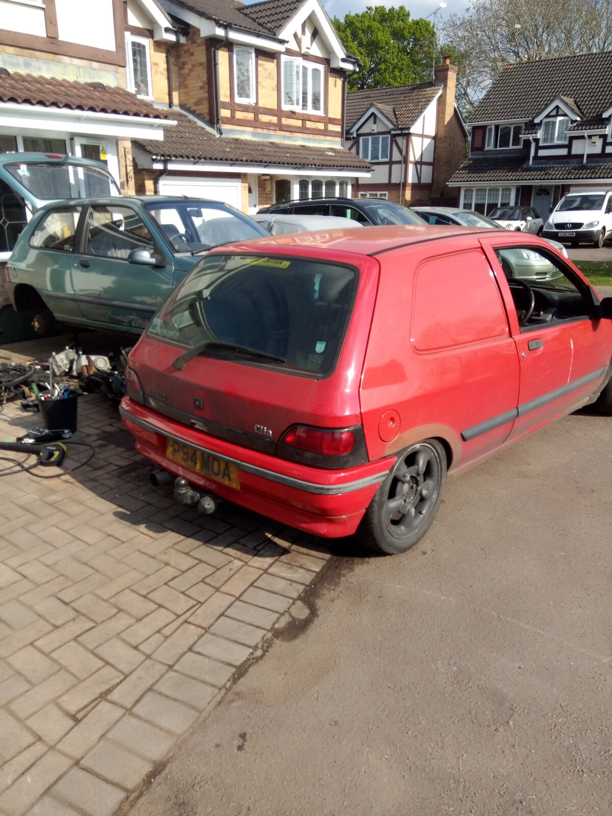

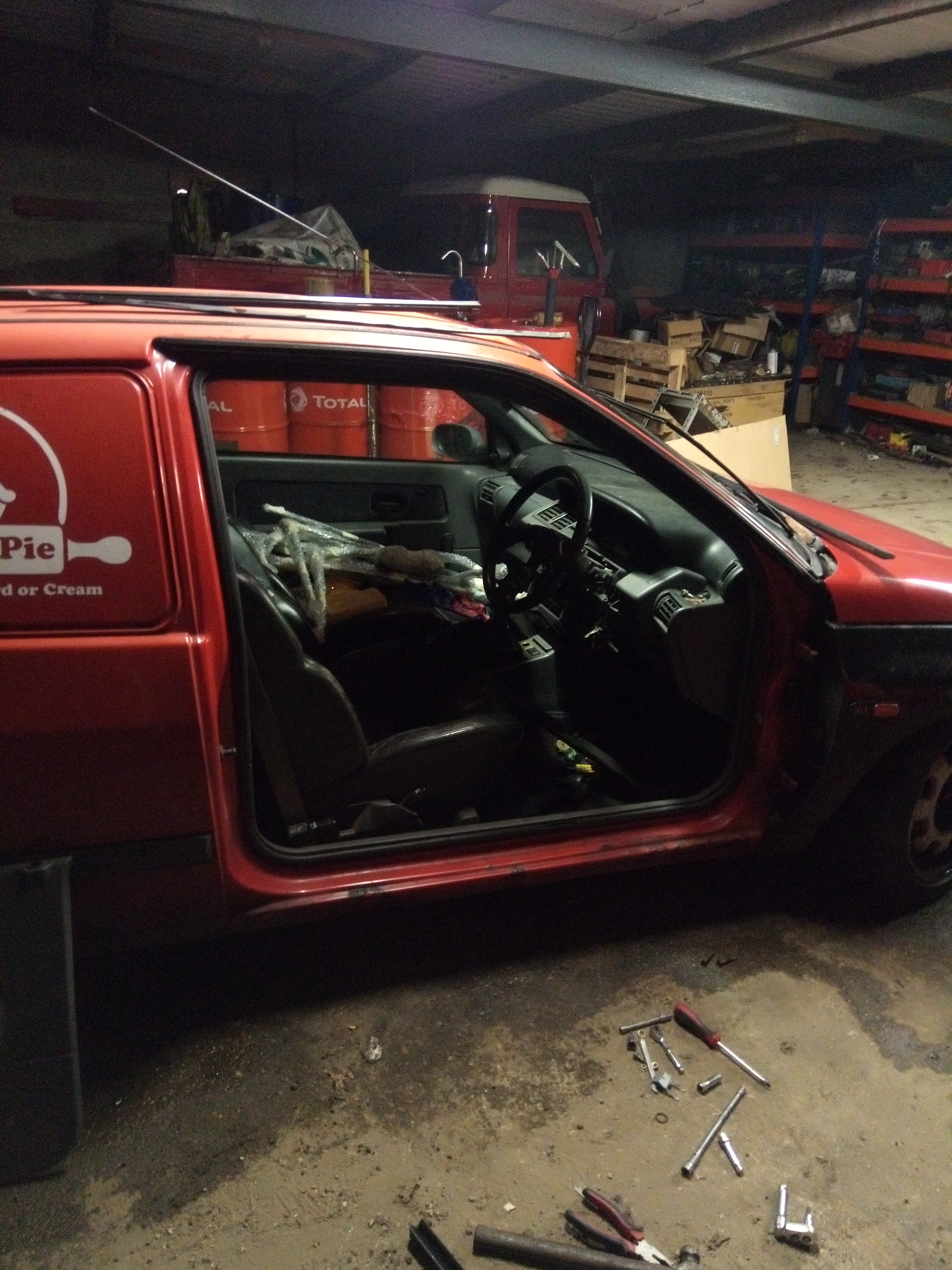

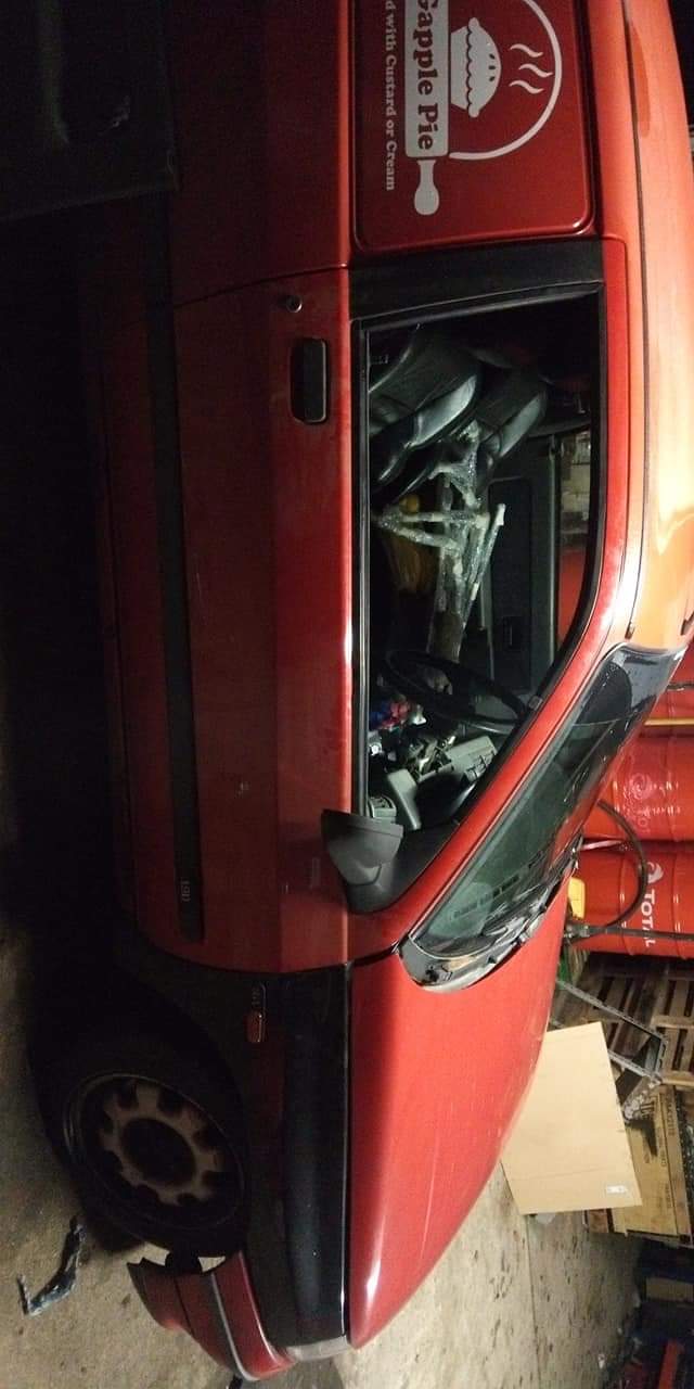

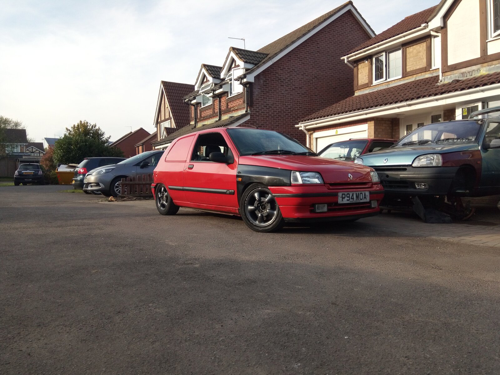

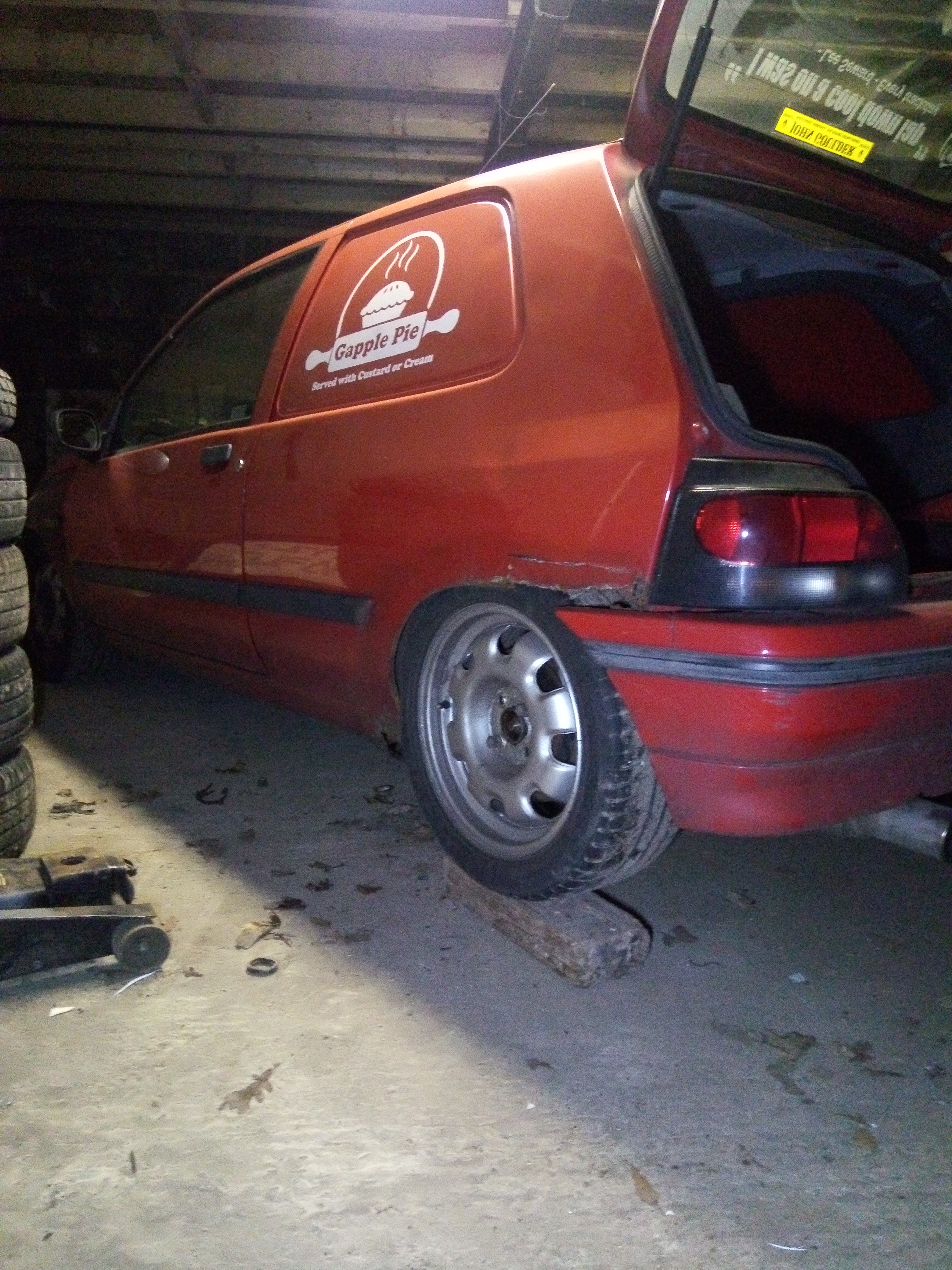

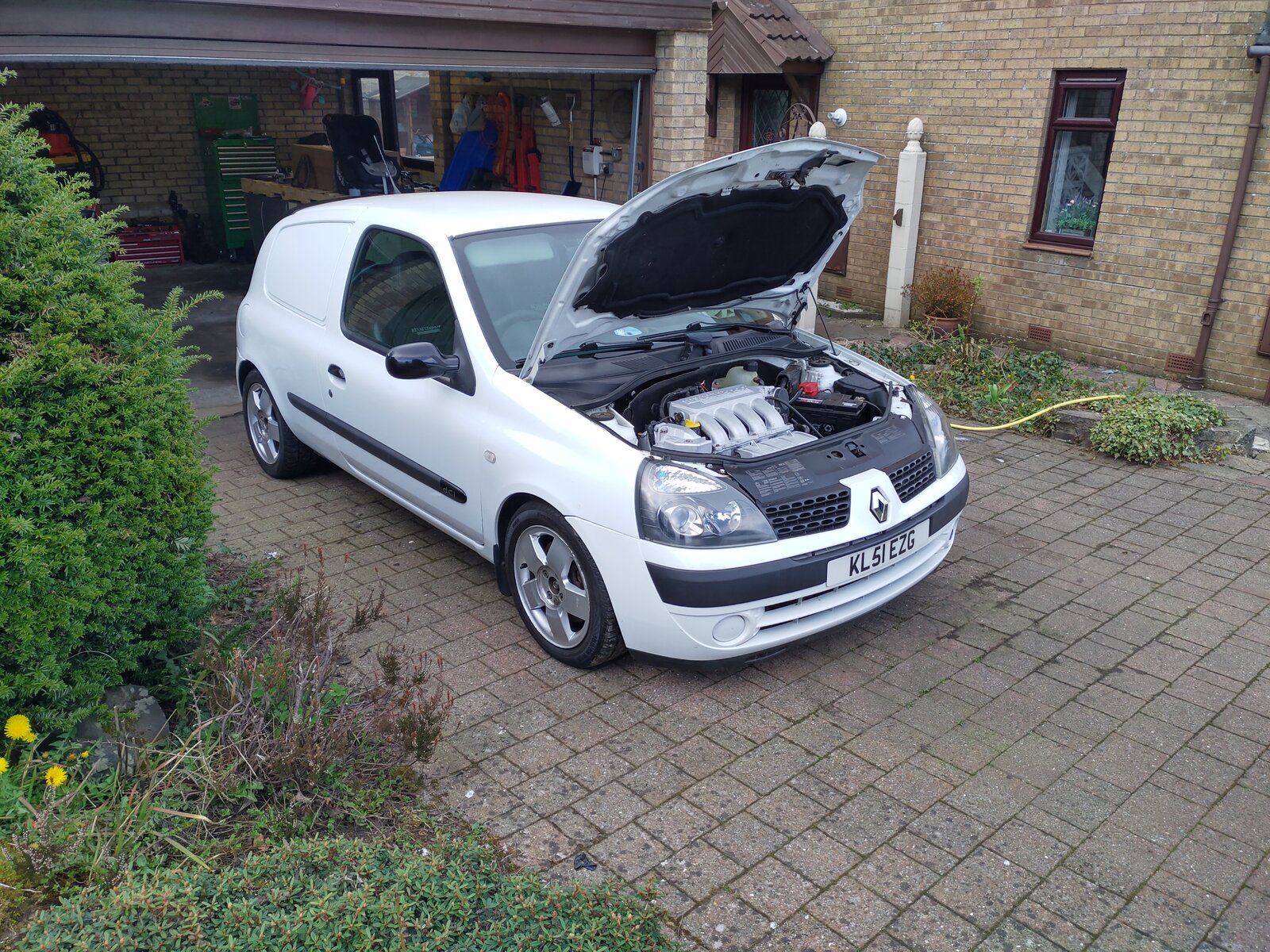

Here's a little project I started by accident it just sort of landed in my lap really I've always wanted another Clio van since I used to have a ph1 white one with a hybrid Williams engine but didn't think there was any left untill a friend of mine got hold of this one it wasn't long before it developed a coolant leak and killed the engine he gave me the car in exchange for a couple of favours .

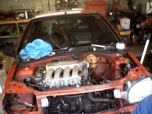

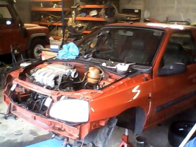

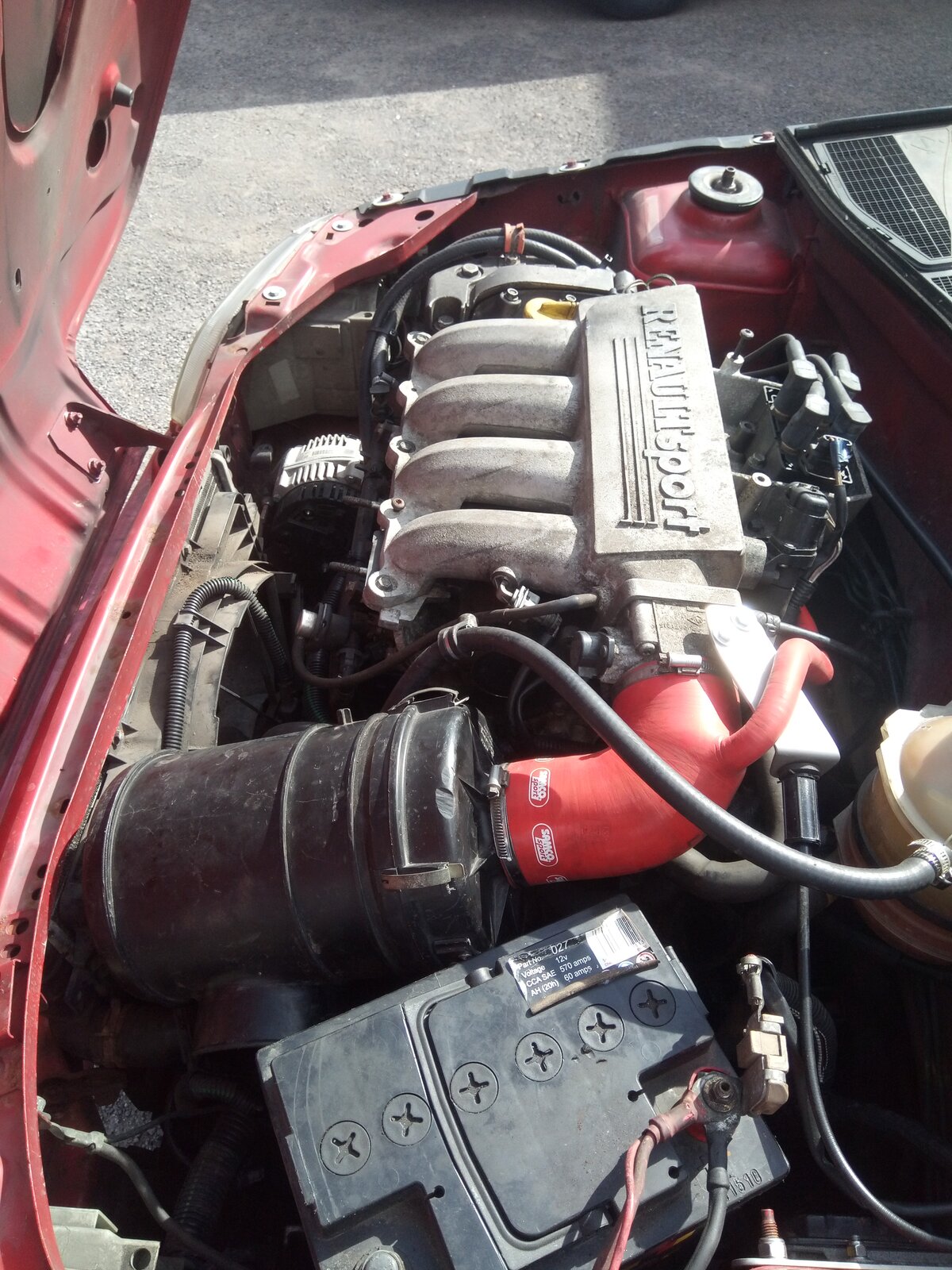

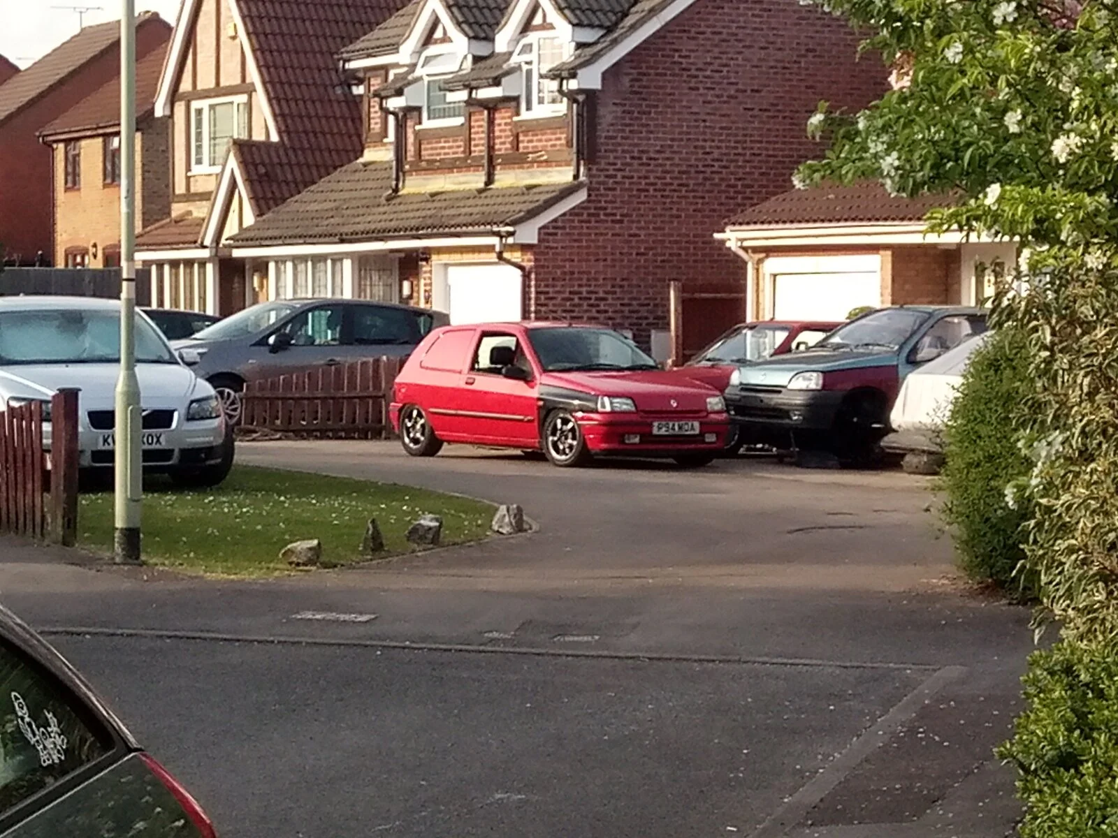

The donor car was a ph2 172 and I had just enough stuff laying around from a ph1 I broke to get it going so the van no runs a 172 ph2 engine with a ph1 inlet box loom and ECU 182 manifold it also runs 172 wide track and brakes I sold off all the bits off the 172 and I've managed to do the conversion for free and even made money the only real cost was getting the ECU de immobilised
Conversion was done over a few days with help from my friend Peter tacking the loom late one evening the car was originally diesel do I changed the fuel tank and filler neck and entire car loom as I couldn't work out if petrol and diesel looms were the same and it got rid of the bodger in aftermarket immobiliser at the same time

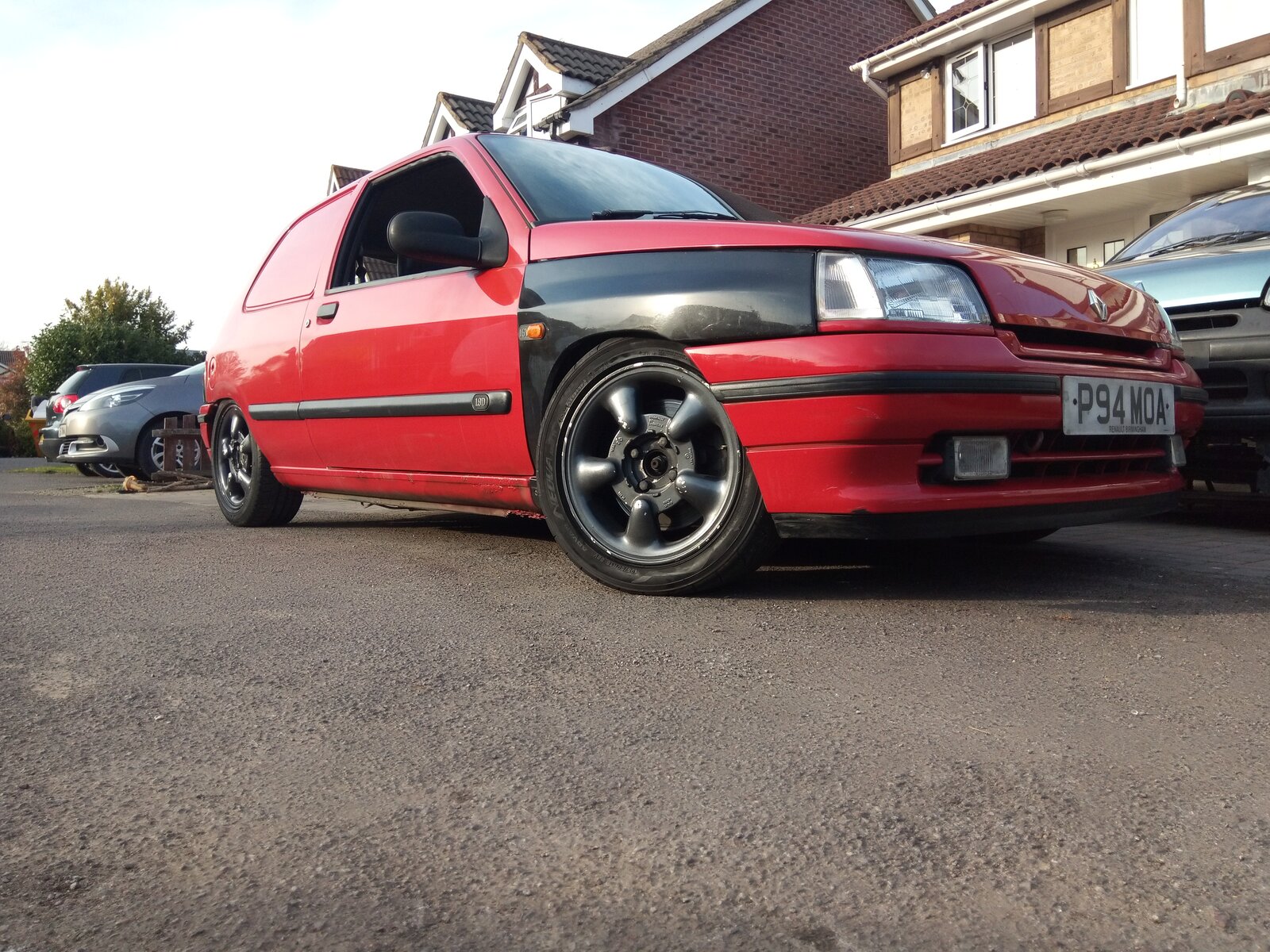

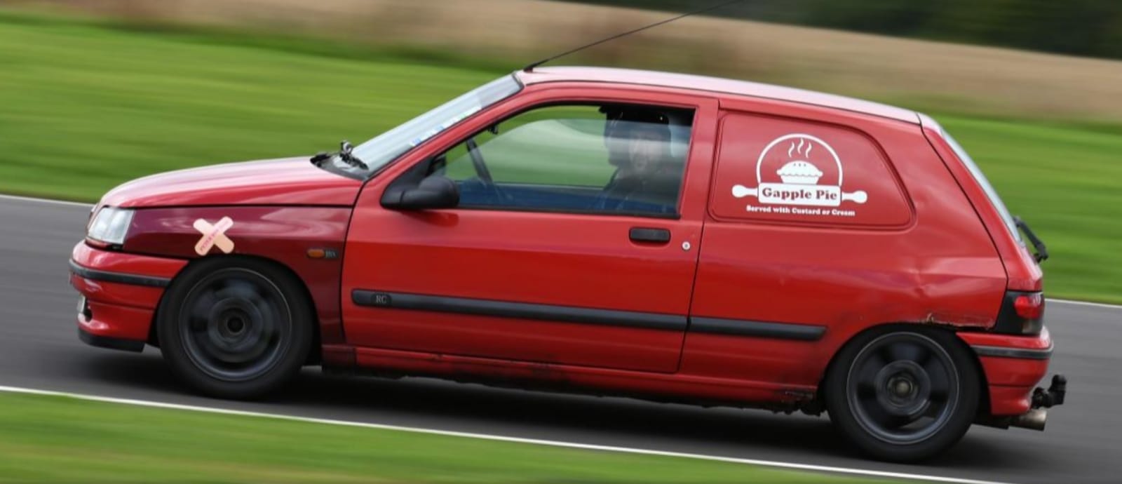

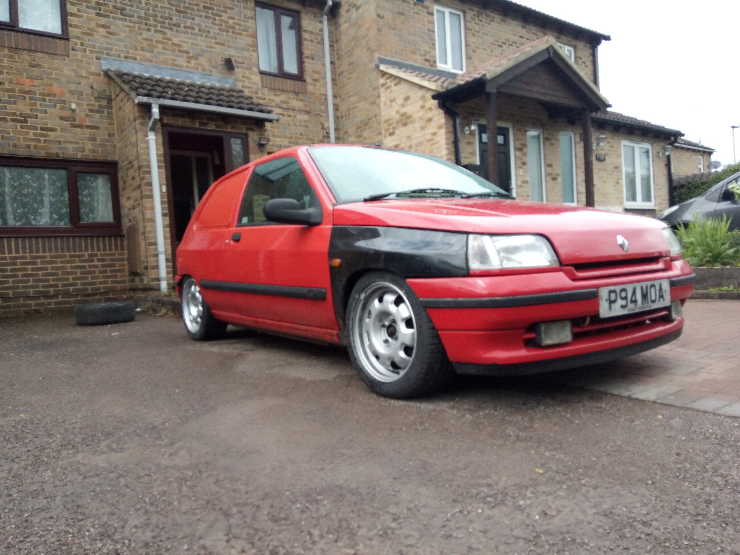

It seems to have got itself the name the death van some how while I was at Mallory and it seems to have stuck i really wasn't sure I liked it when I first got it on the road but I've really fallen in love with it now and have been enjoying driving it alot more on the road than the 297 was a bit much for the road
Also it was a pH 3 and I couldn't have that do I had to fit a ph2 front end

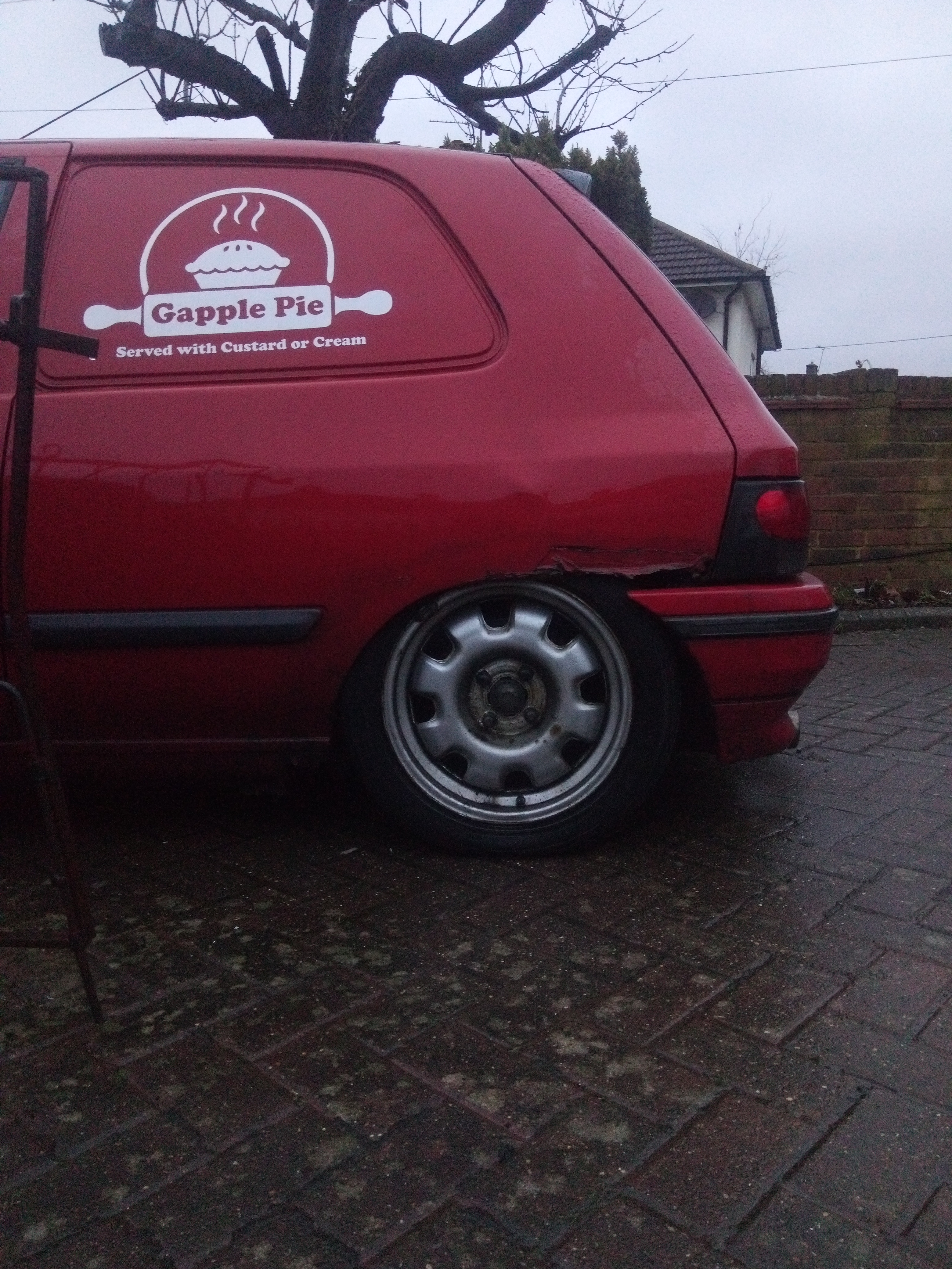

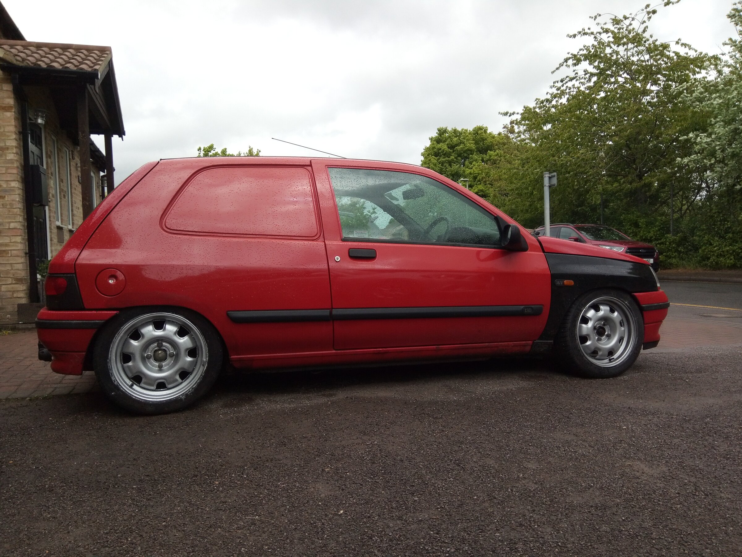

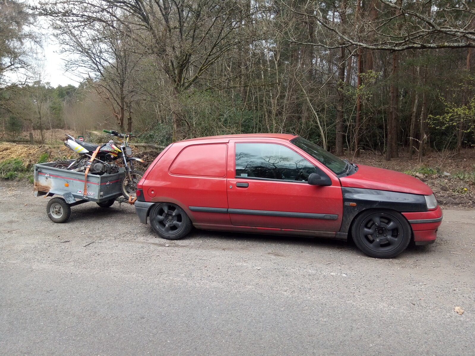

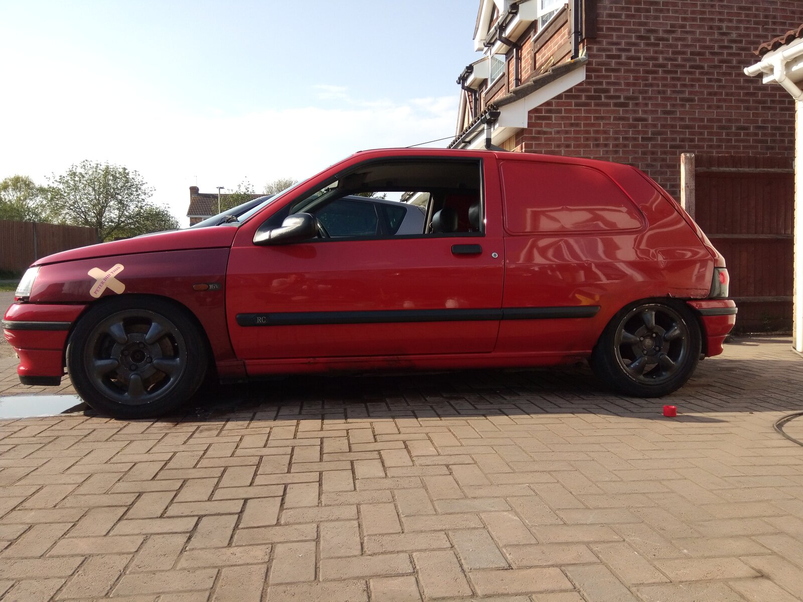

Eventually it will be getting the cammed engine out of my valver (also f4r) the clutch too and the gearbox will need a rebuild at some point and I need to do some welding to the n/s cill should have the new wheels fitted by the weekend for extra sleeper effect

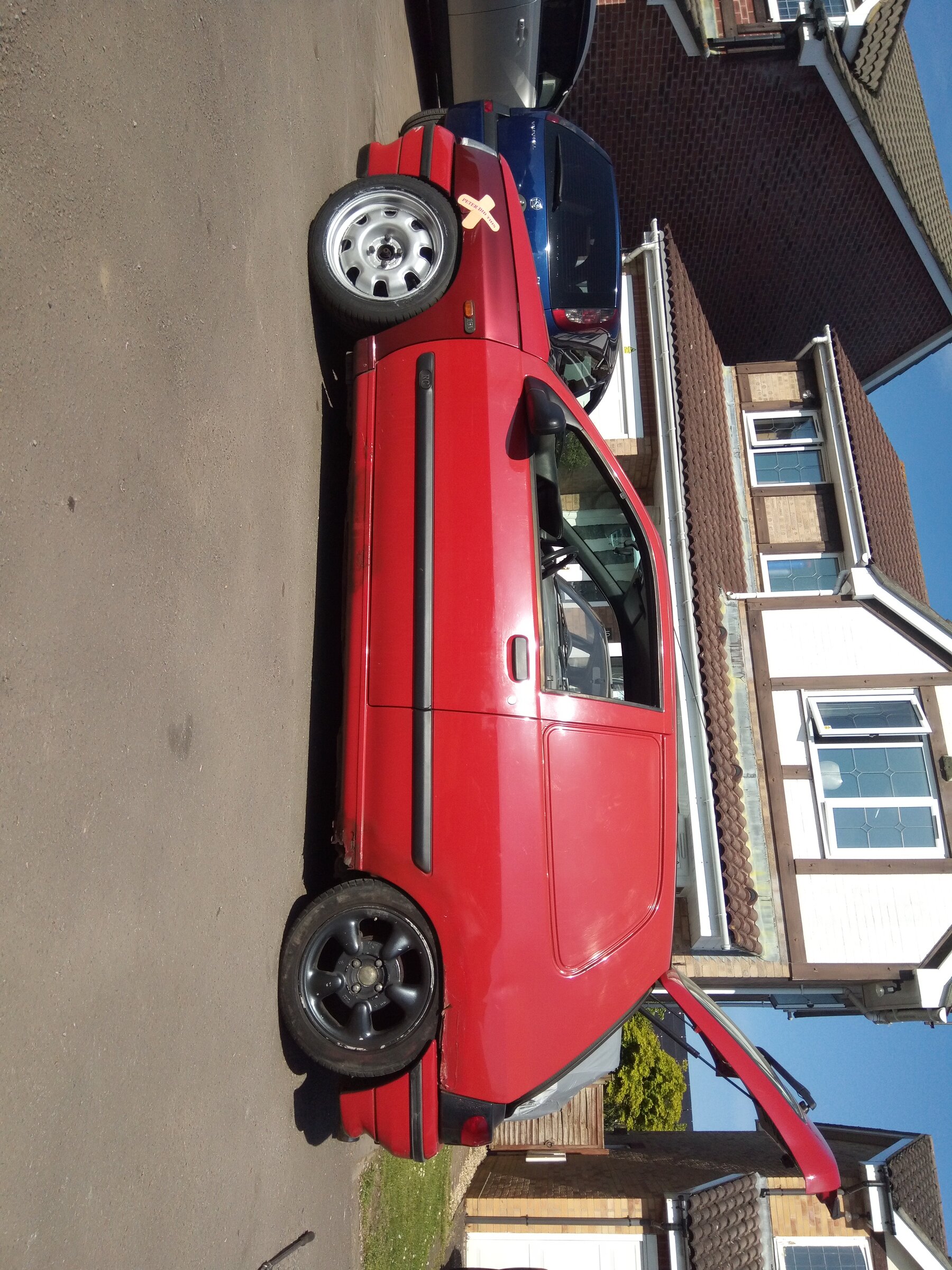

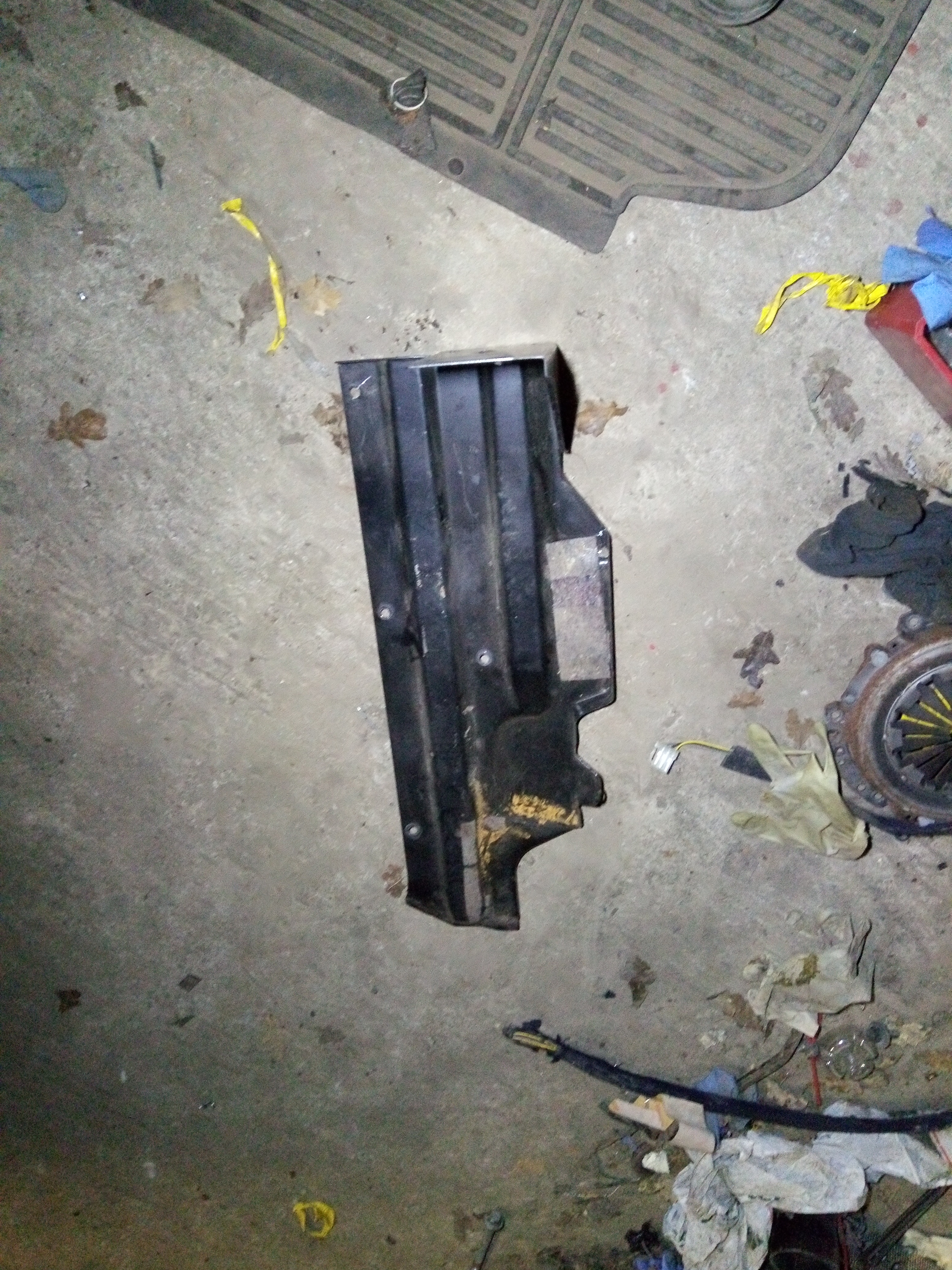

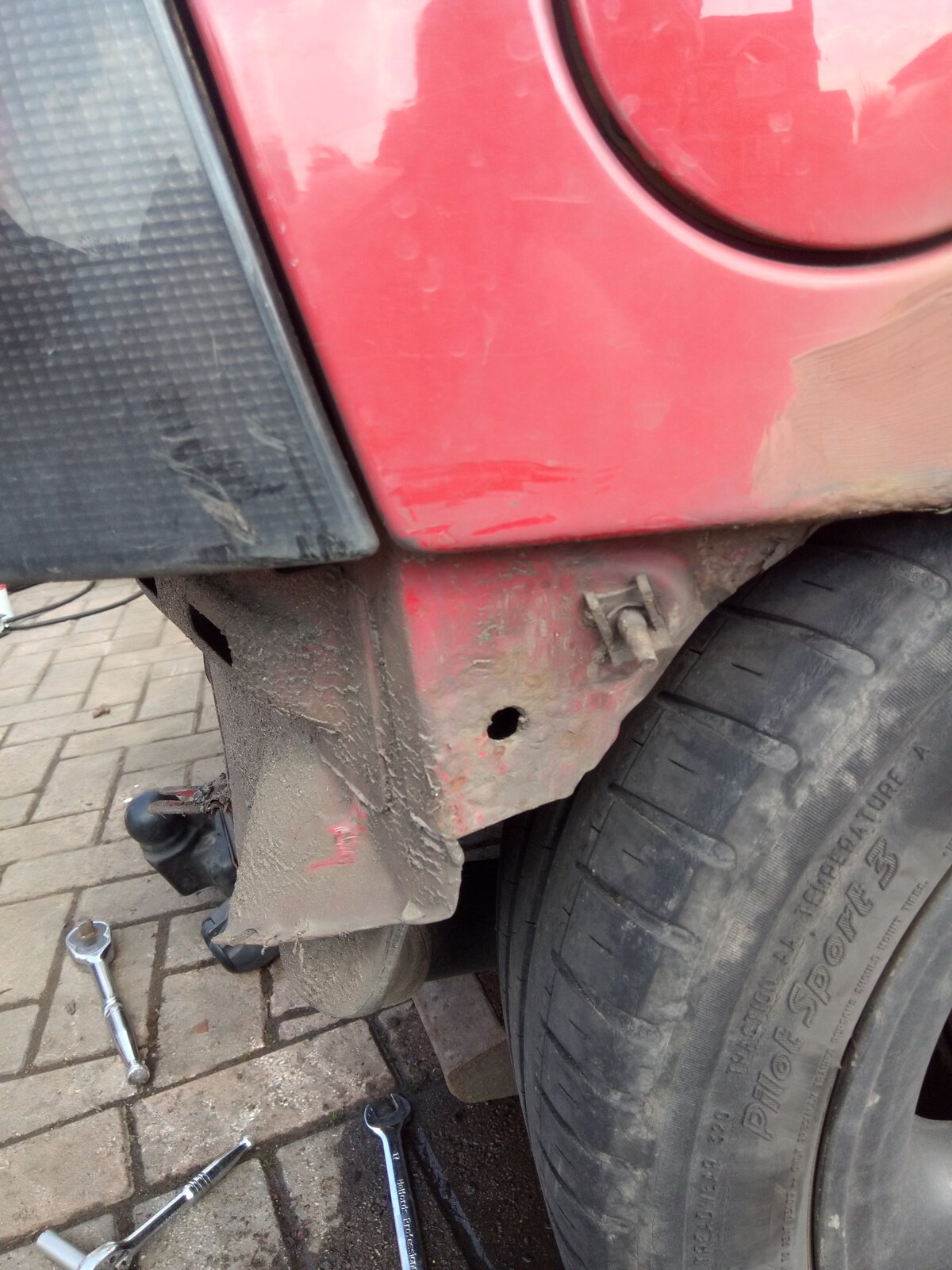

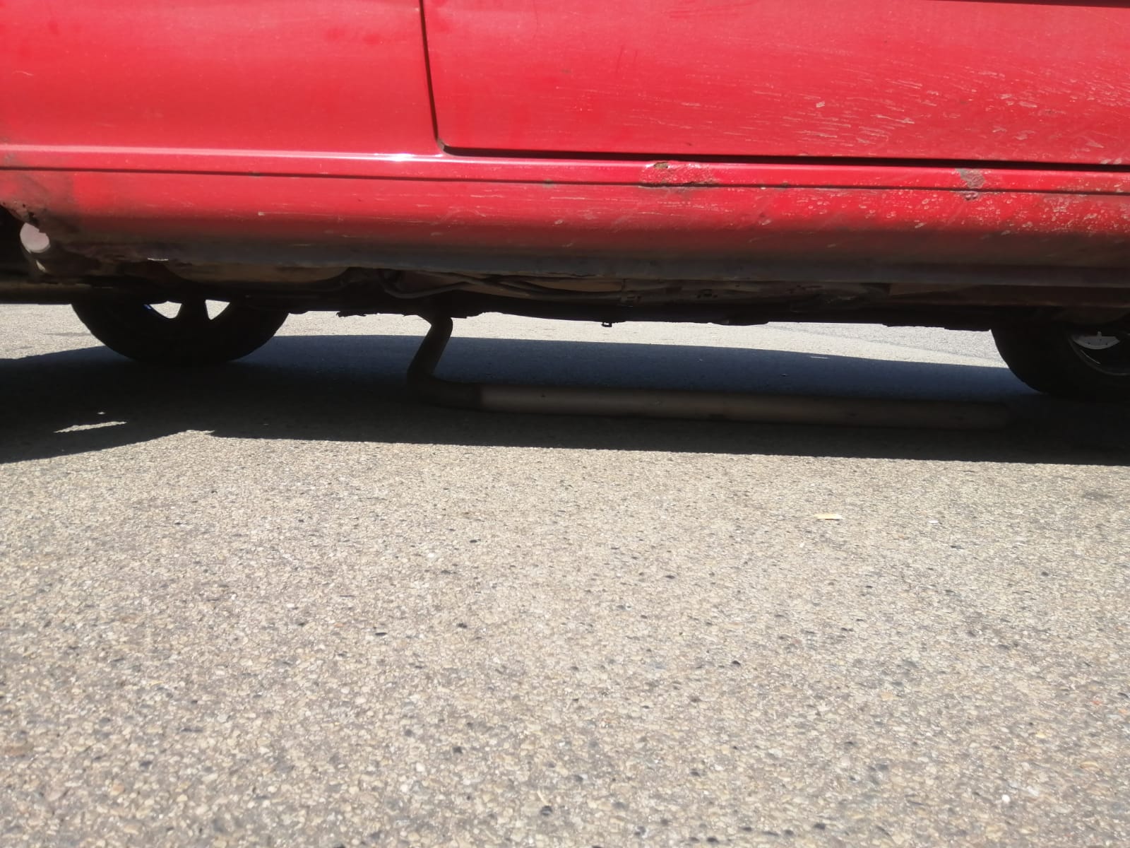

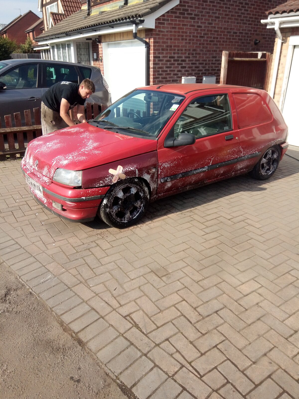

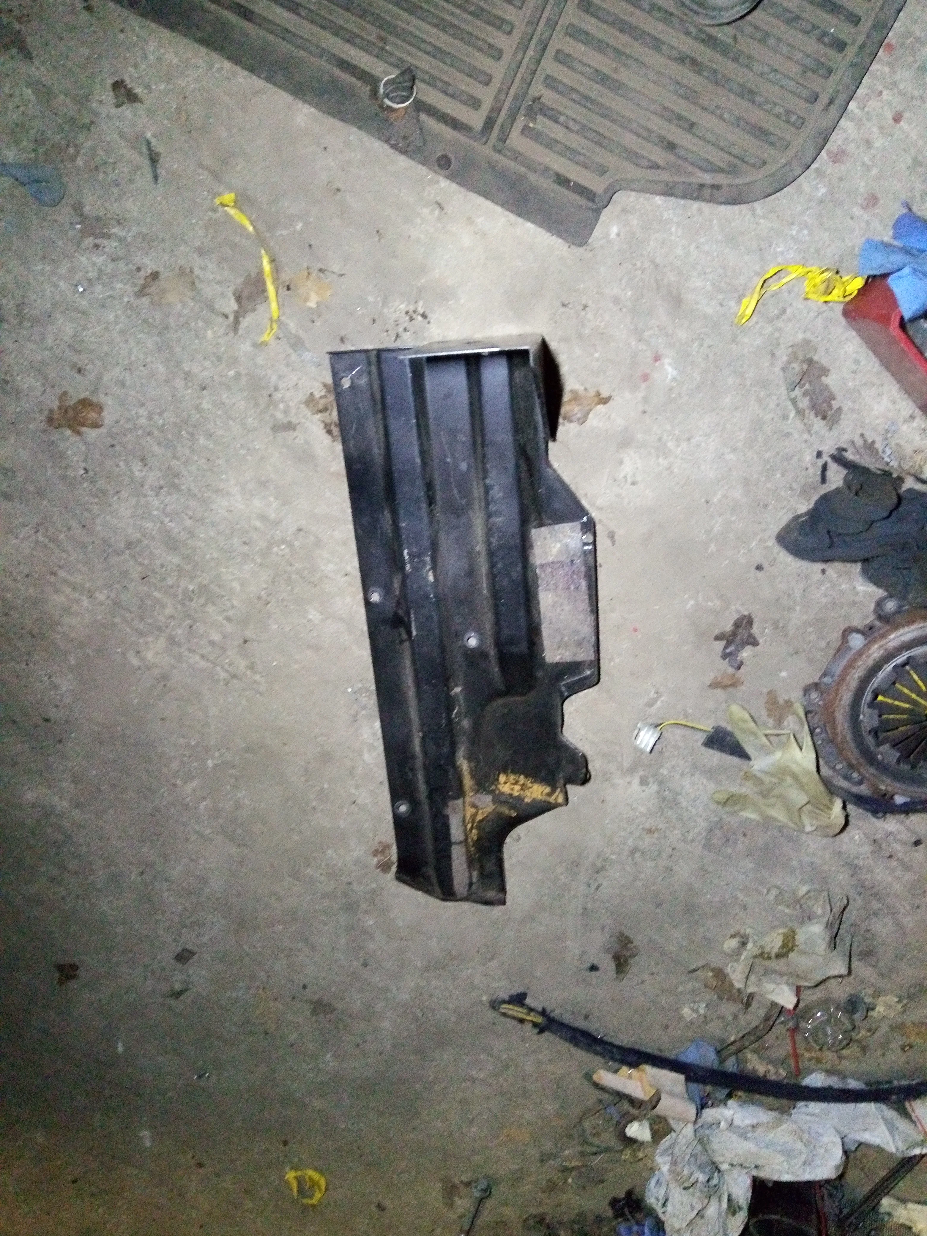

Finally got round to fitting the colour coded RT bumper been putting it off for over six months now as it involves removing the tow bar but I'm glad I did as it's fixed the exhaust knock was knocking on a bolt so I turned it around

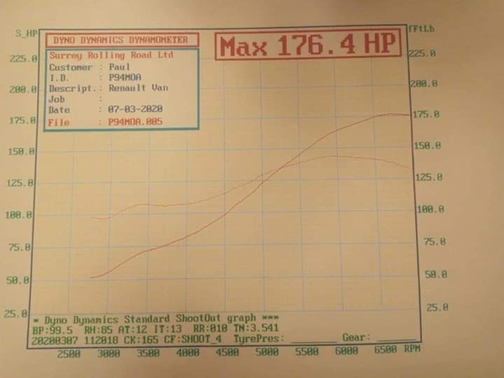

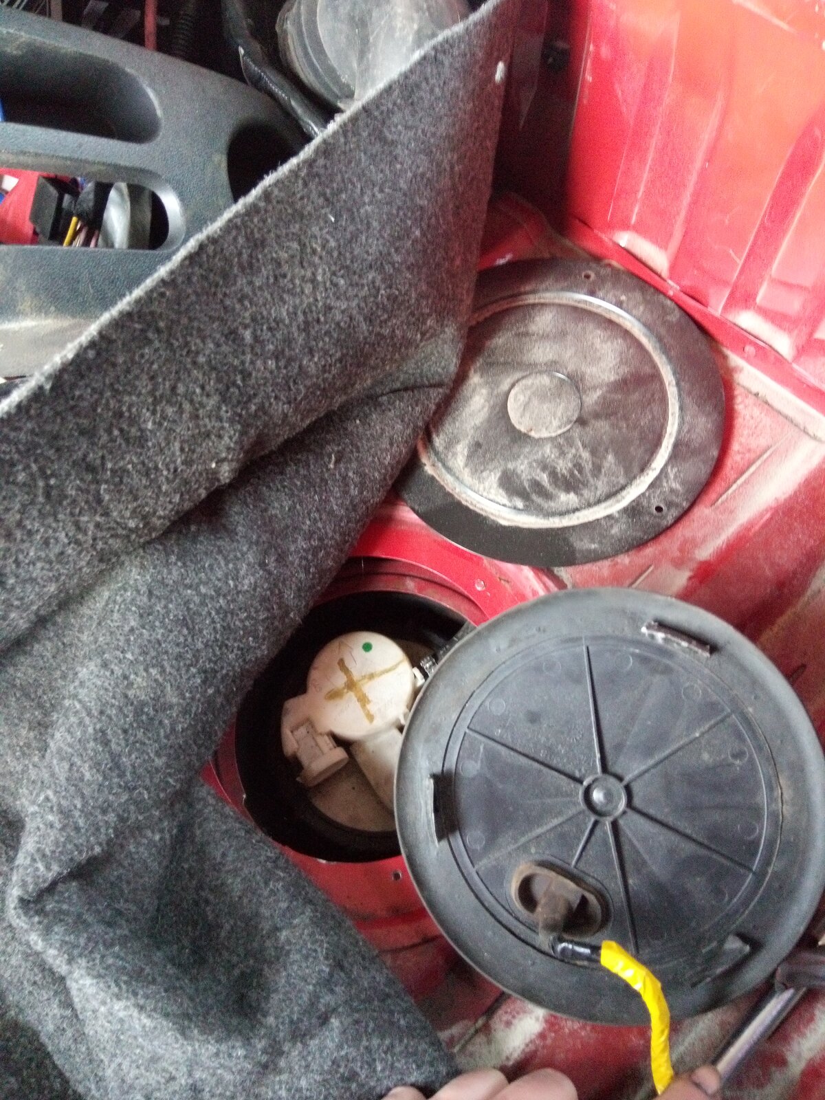

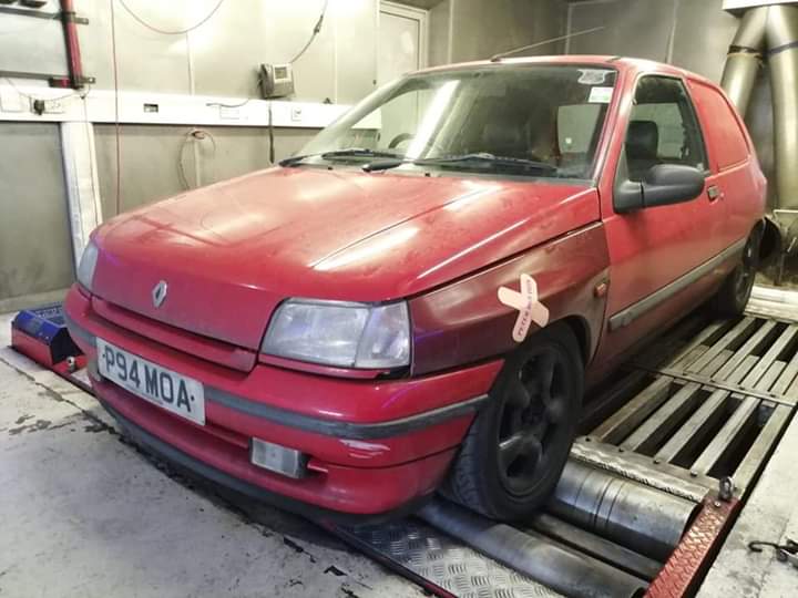

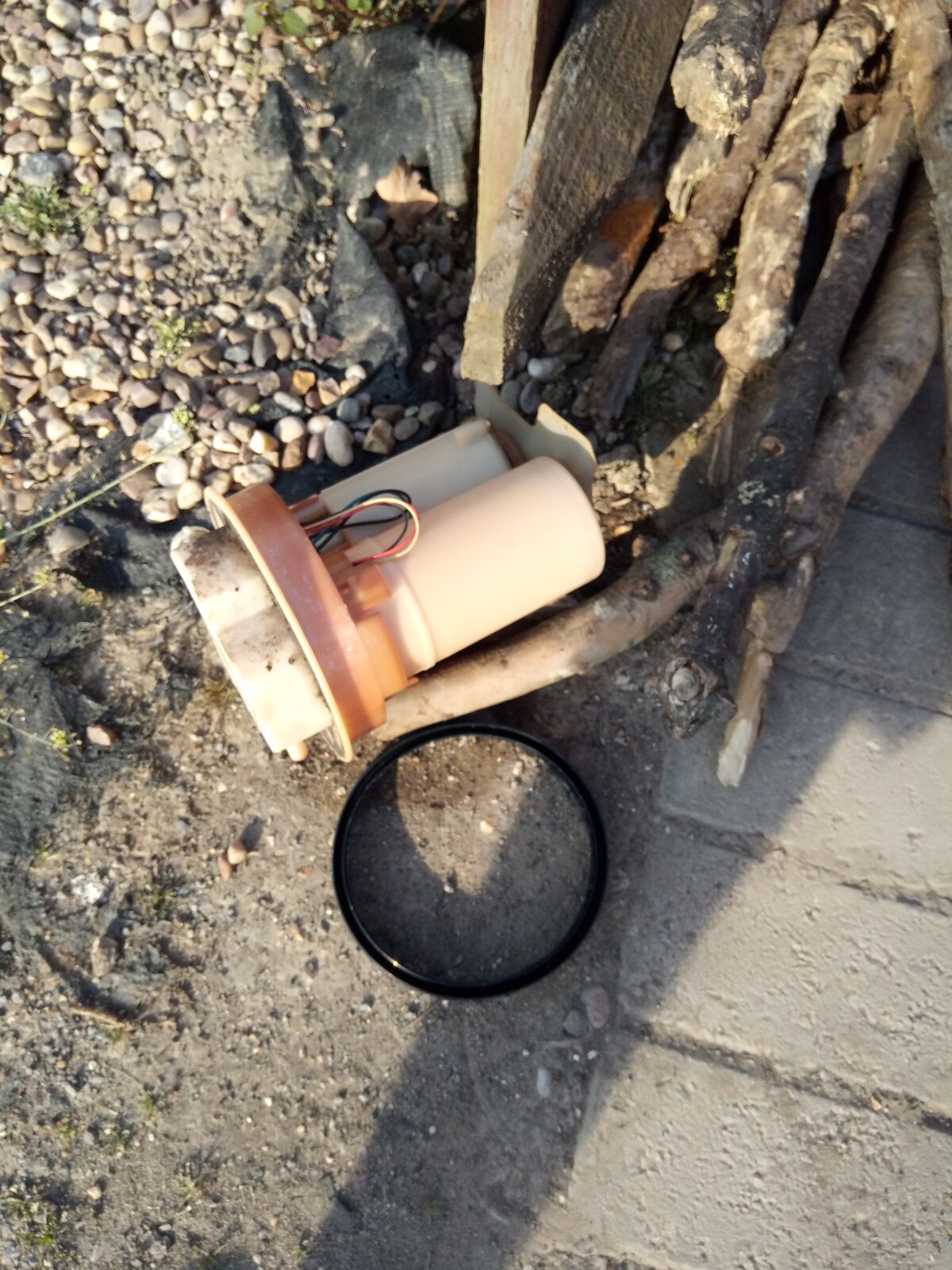

So after learning when the van was on the rolling road that it runs a little lean at the top and bottom (almost misfires at about 2k ) I decided the ageing 1.2 fuel pump was the issue do I fitted a valver fuel pump unfortunately it still seems to be the same :(
Will you try upgrading to a 1*2 fuel pump?
If you have fuel pressure but not enough fuel, perhaps the injectors need cleaning? Or there's an air leak in the intake system somewhere??

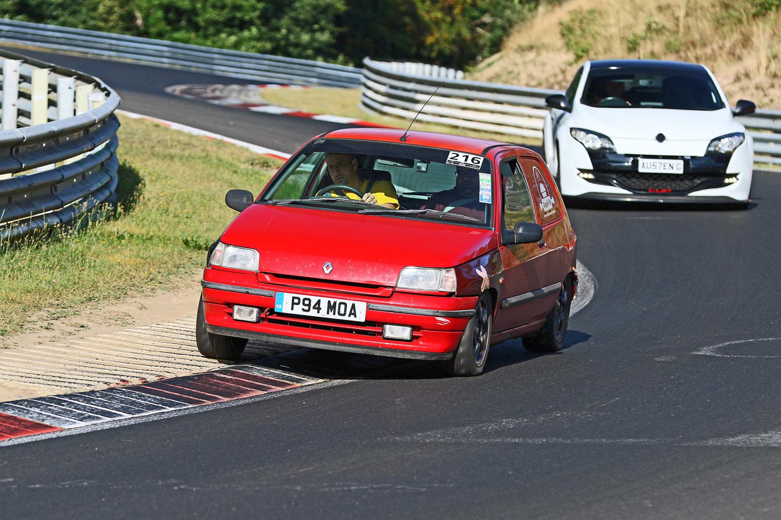

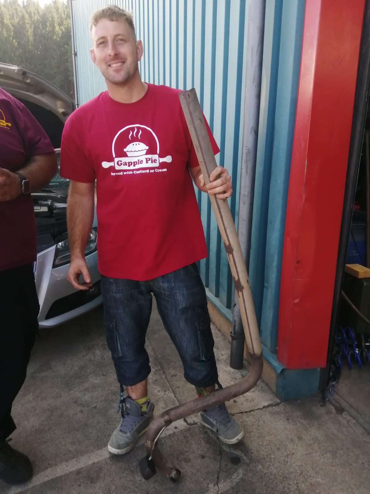

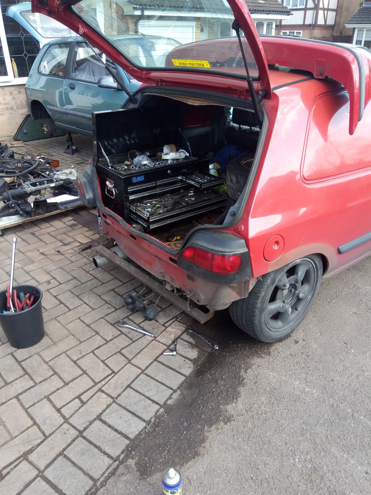

So after a brilliant day in the death van at castle coombe the gearbox s**t itself it's been crunching for a while now but it finally happened luckily I made it home and to work where it stayed for a month till two days before the spa/ring trip I decided to pull my finger out
So I managed to throw it together just in time for the trip getting the tracking done moments before we were about to leave the van was nearly faultless the whole trip only the exhaust falling off spa finished that off but didn't cost me too much down time got it fixed during lunch what track can't wait till next trip

'People' bang on about french cars being unreliable but they really aren't and enjoy being used!
I hope you were overtaking that McLaren in the picture ;) lol

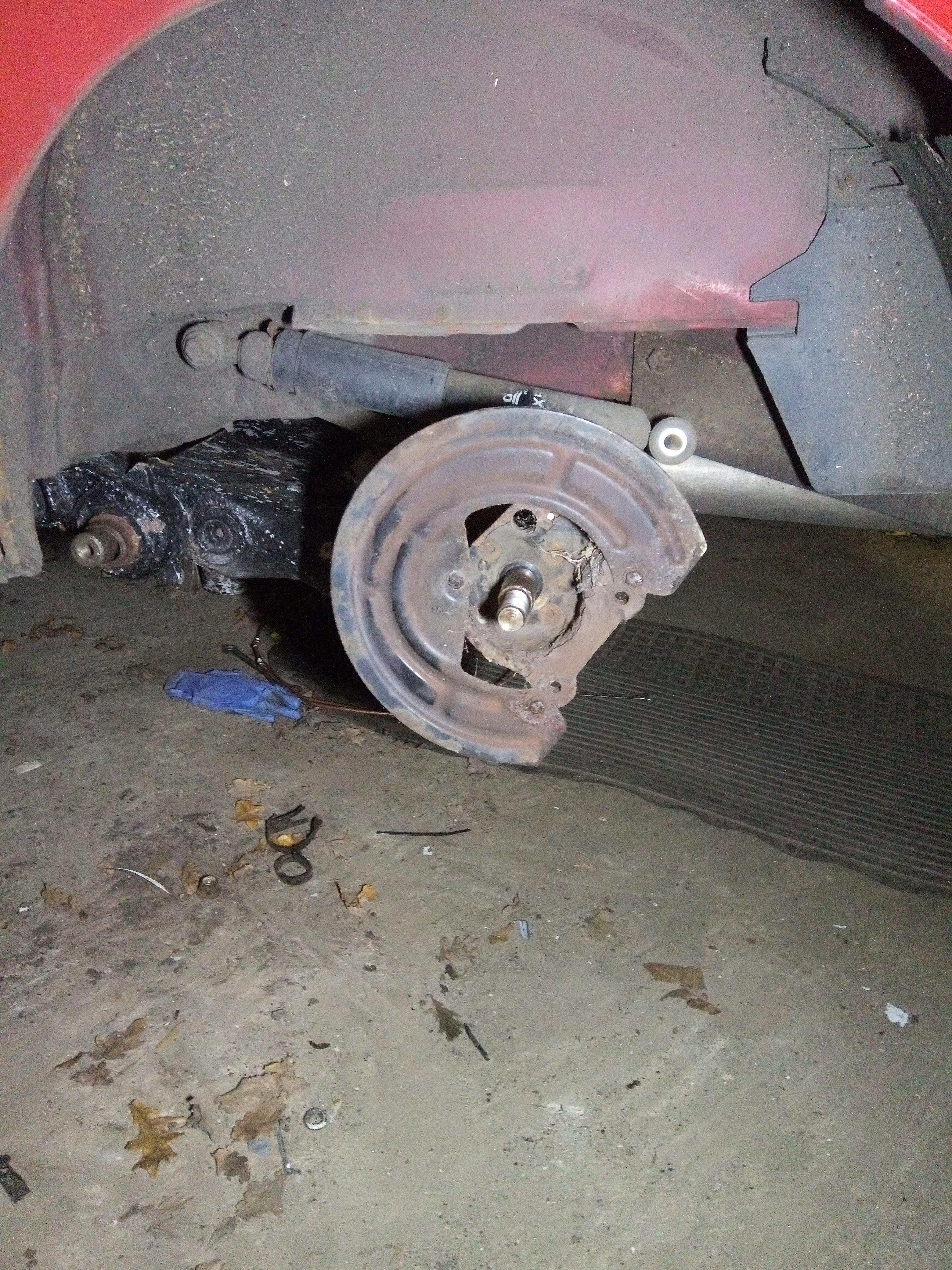

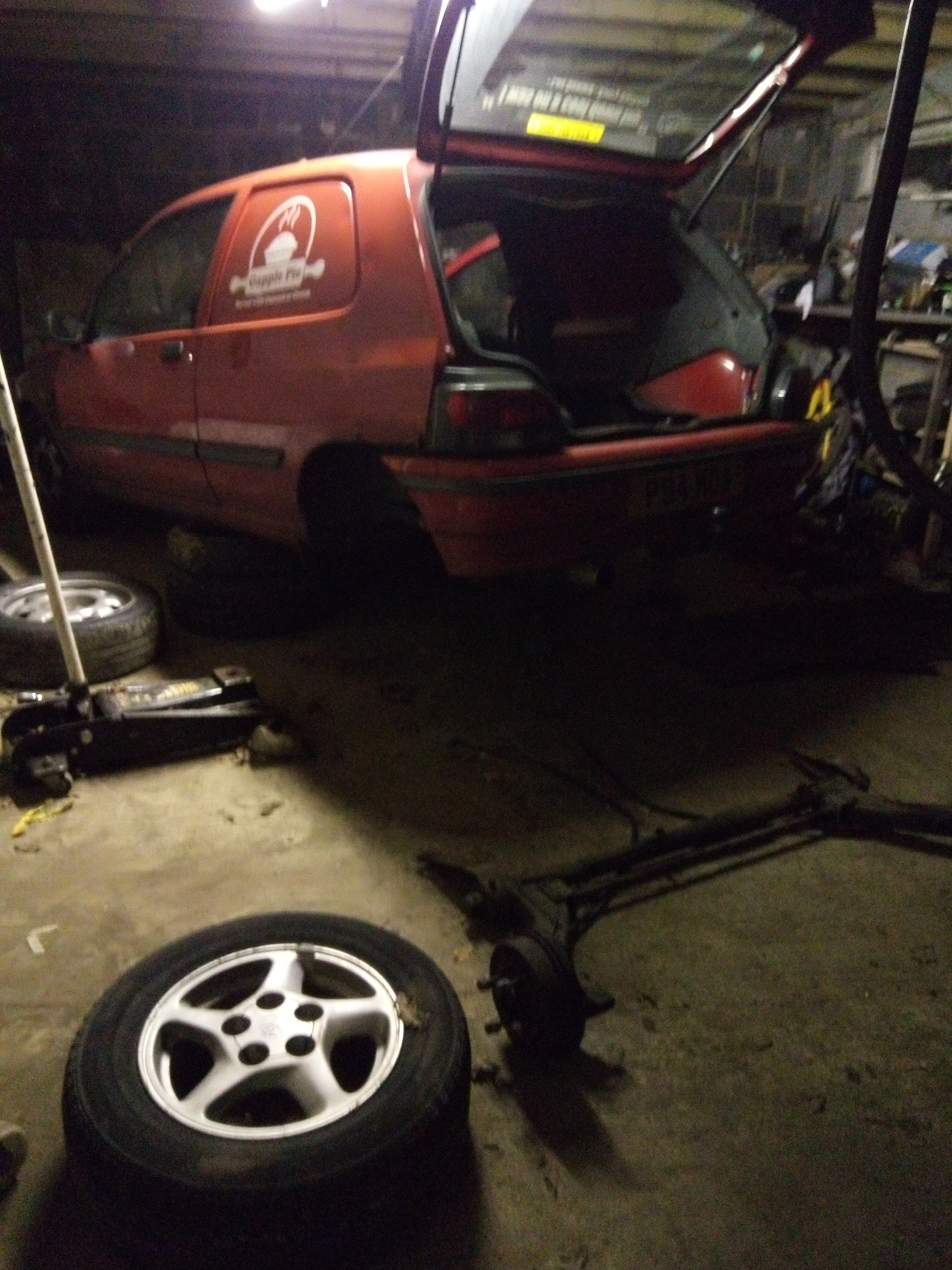

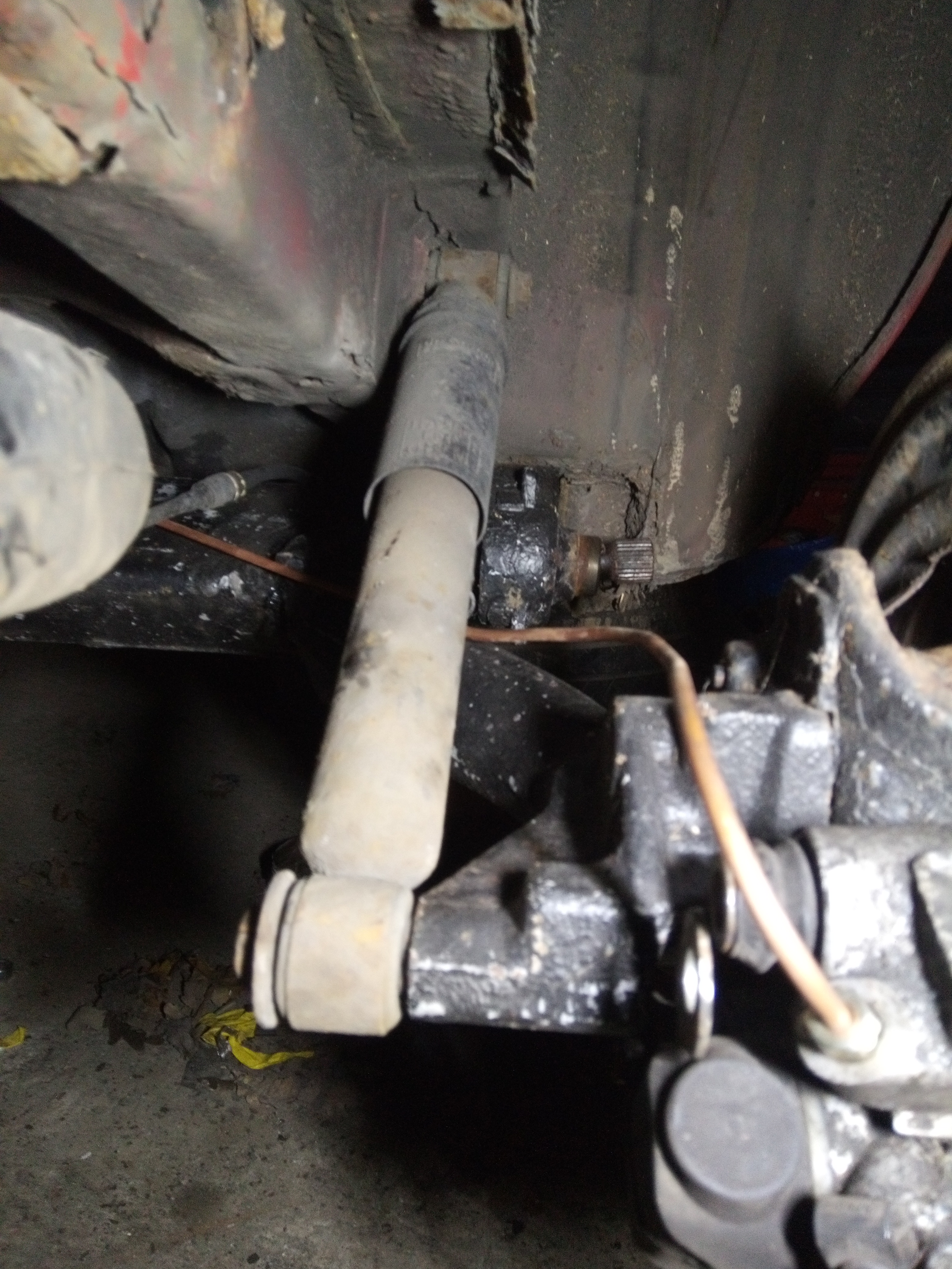

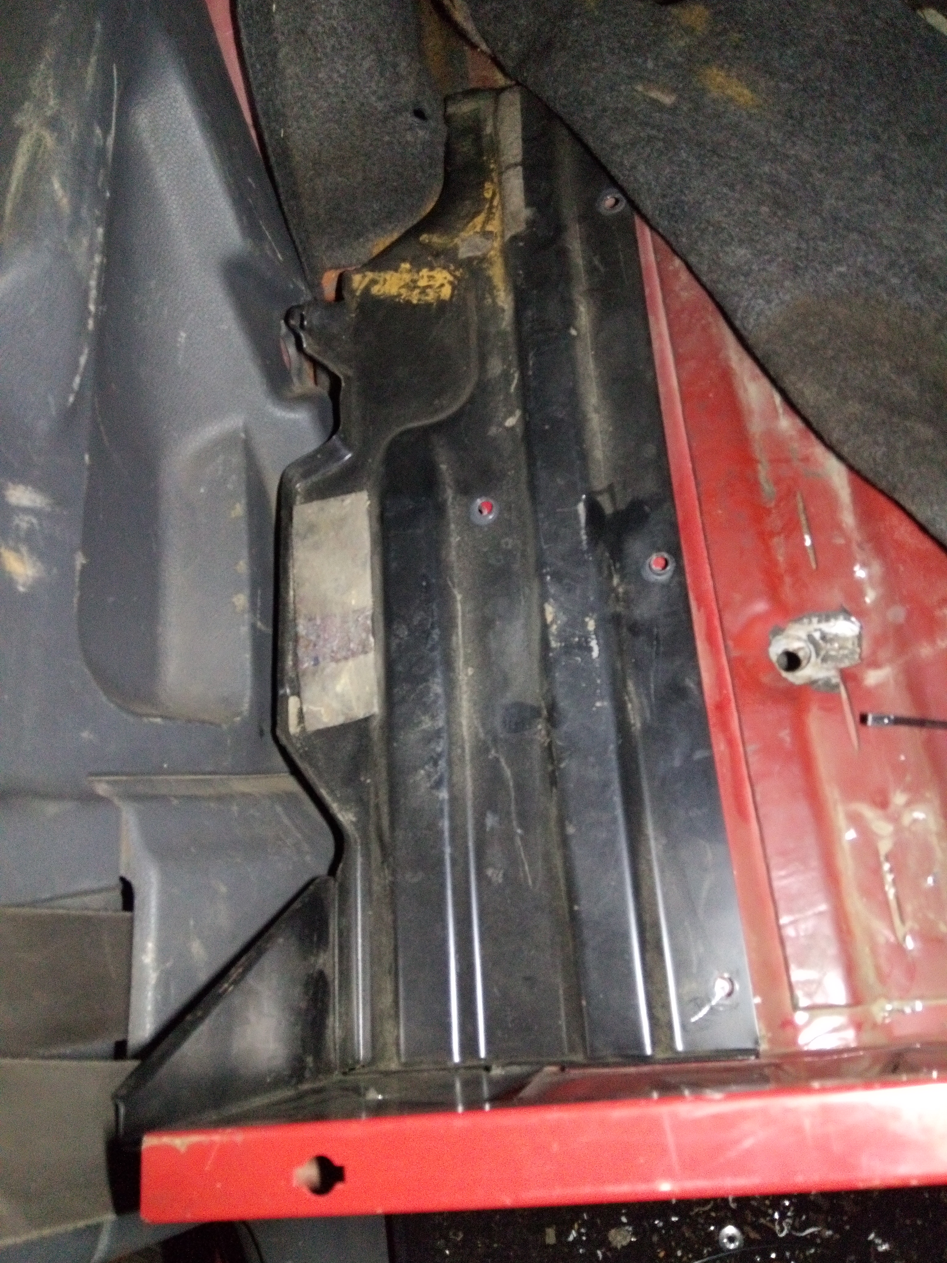

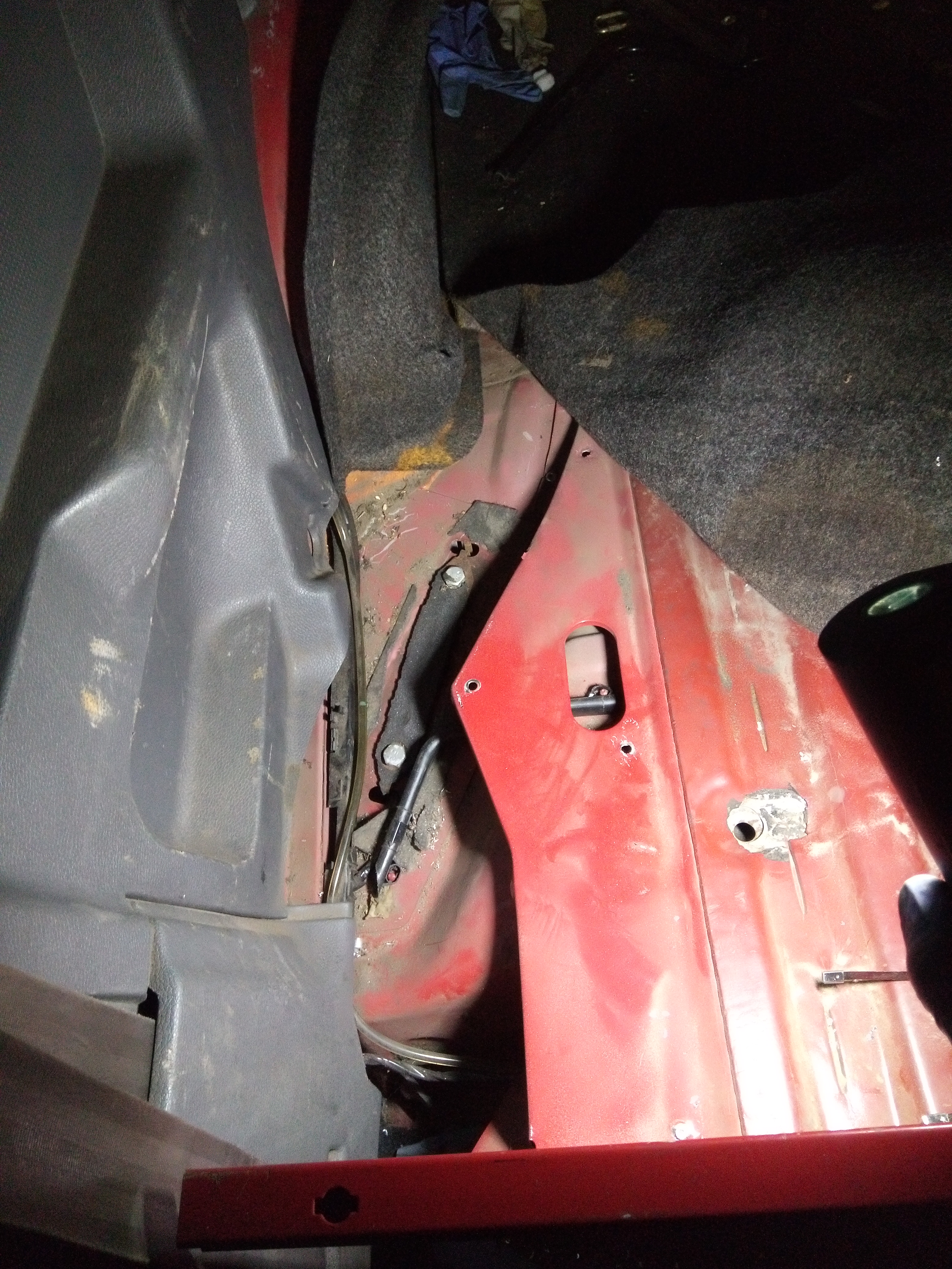

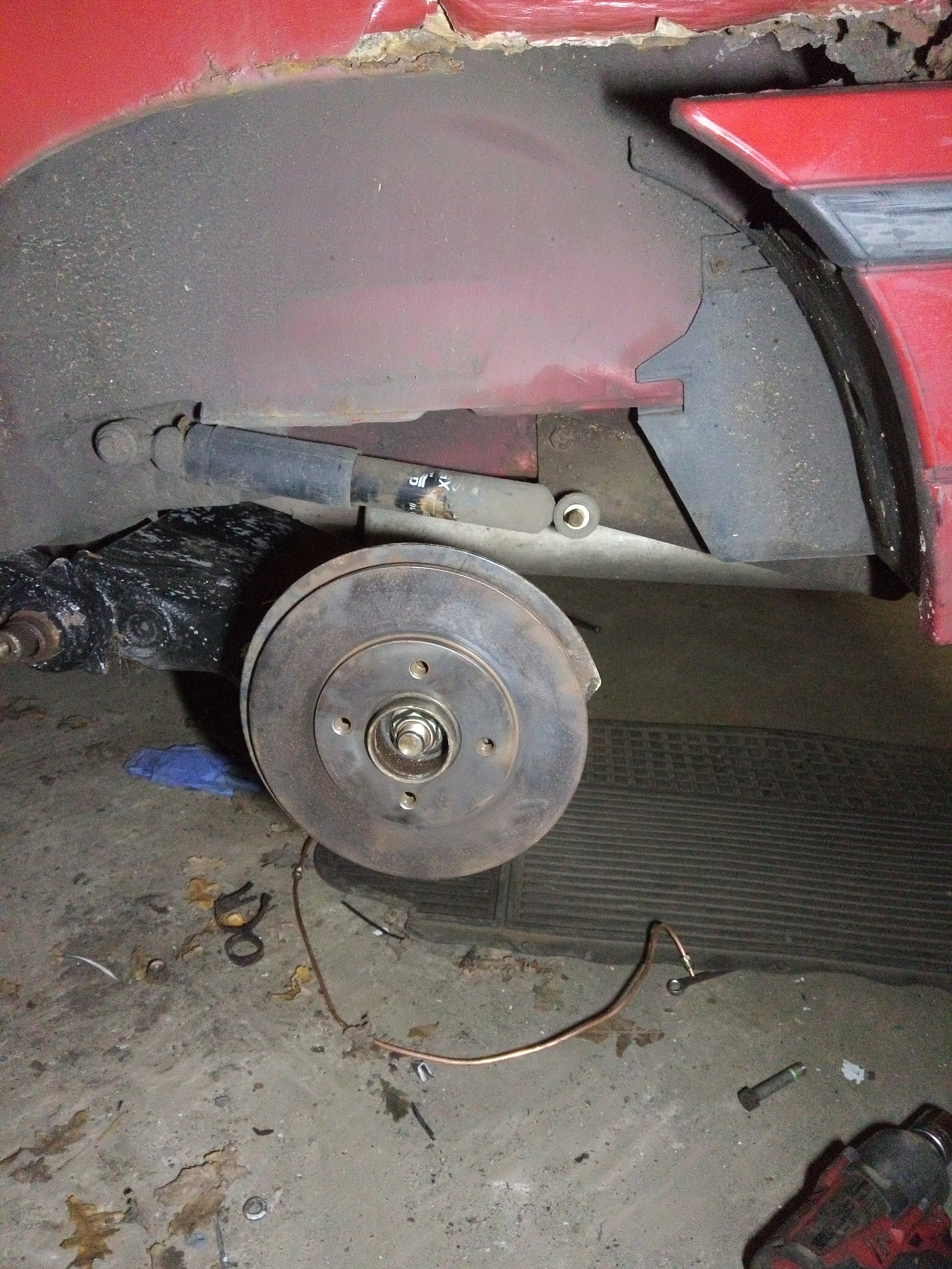

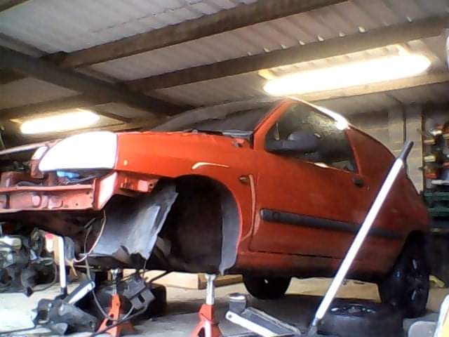

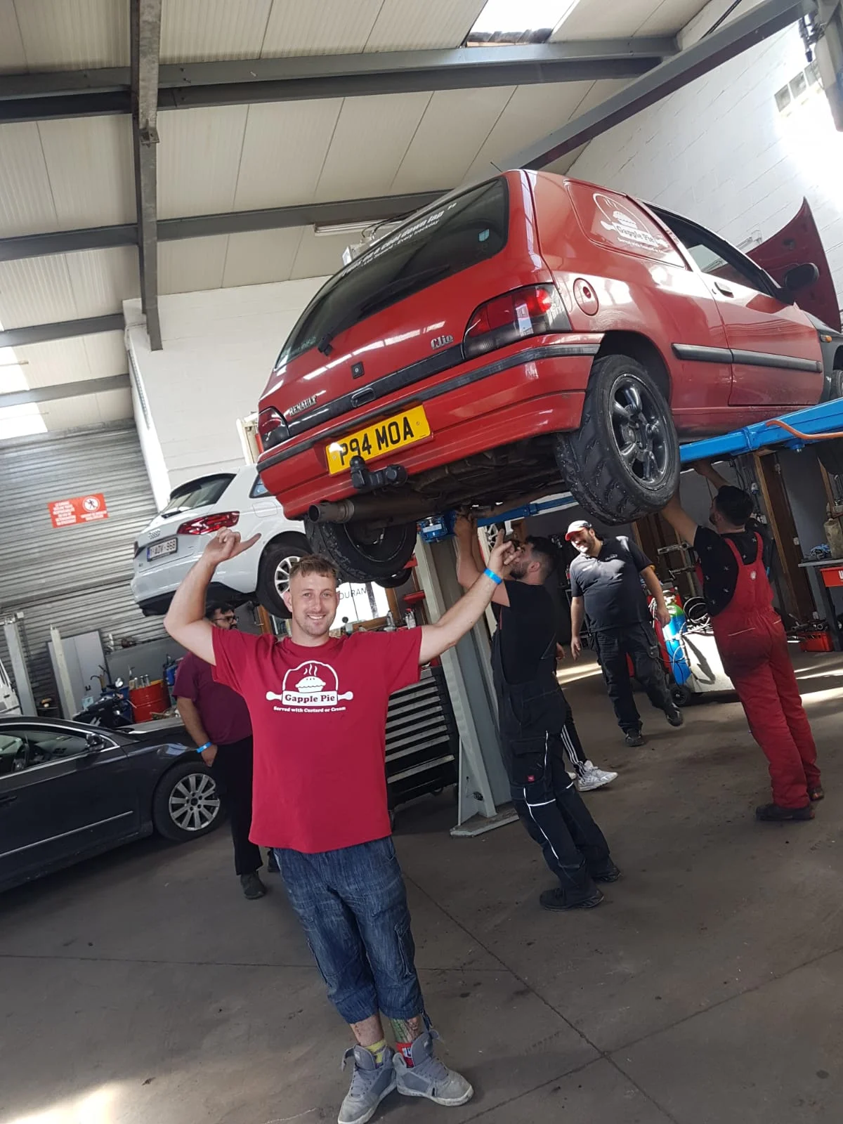

So the loved death van popped a brake cylinder so I thought it was time I updated the brakes on the rear so the disk conversion was the only real option unfortunately as it's a van I had to remove some of the boot floor
  197 clio 16v
Banished the drum beam and got the disk beam on other than one spinning captive bolt it was a peice of cake obviously I gave it appropriate death van lows I'm quite happy with the results it seems alot stiffer at the rear
