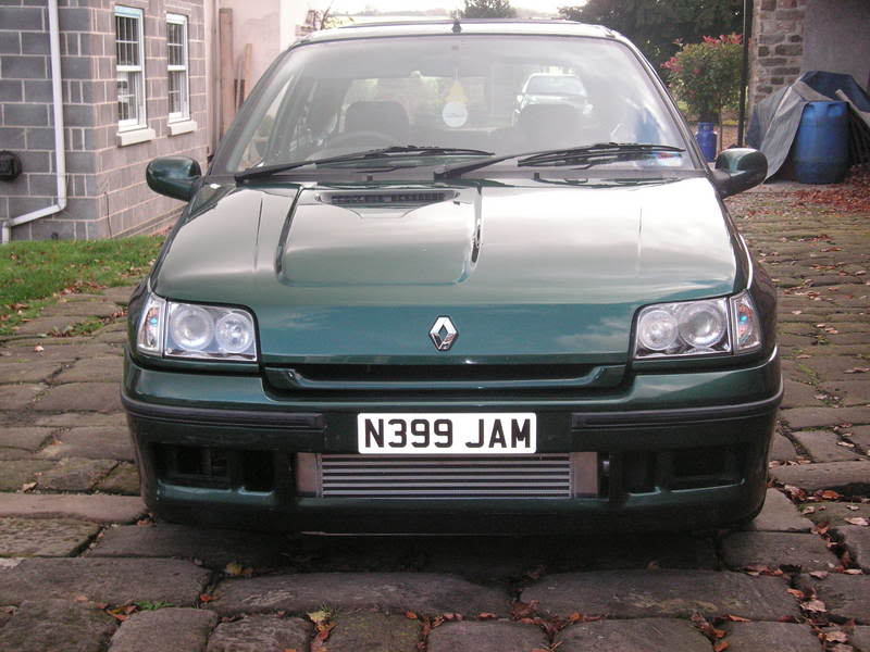

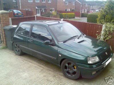

Just gonna start off my project thread as i'm building up on lots of parts for the conversion, I brought a Phase 2 Clio 16v in brooklands green off ebay as a non runner, (Immobiliser fault!) £20 and one second hand phase 1 ECU and it was runnin an good too.
Pic of car when brought, Was a bit shabby and there is some rust on the rears as usual,

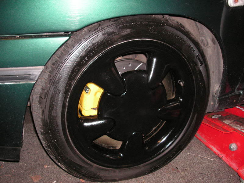

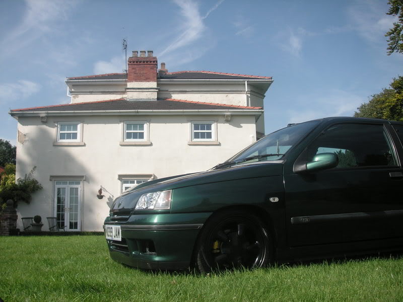

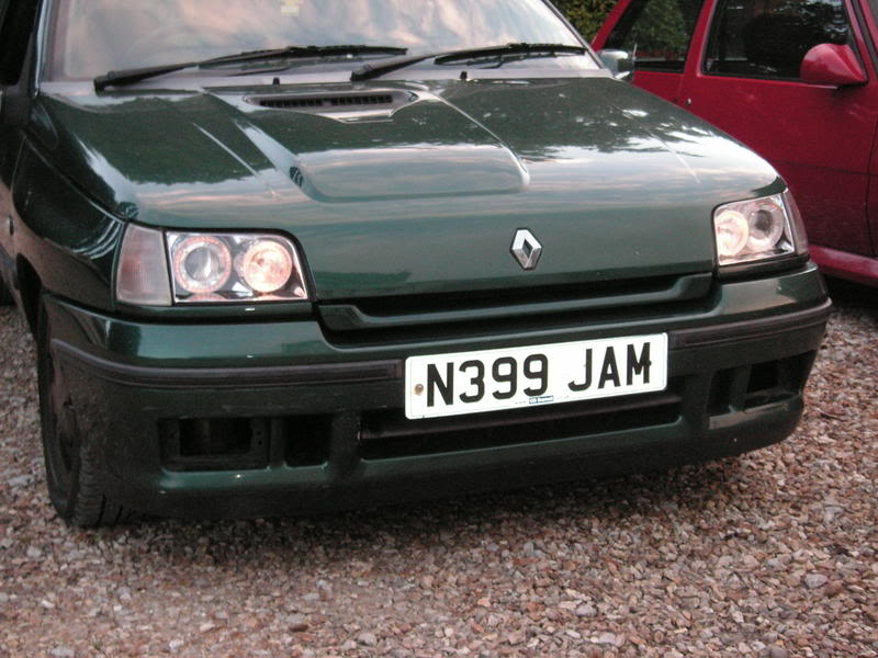

After about 5 hours flattin down with 1200grit we buffered for another 2 hour (While having a few beers!) i fitted centre caps and painted them an the wheels satin black, I have painted all the plastics since these next pic
Also fitted angel eyes and new drilled and grooved brakes too.

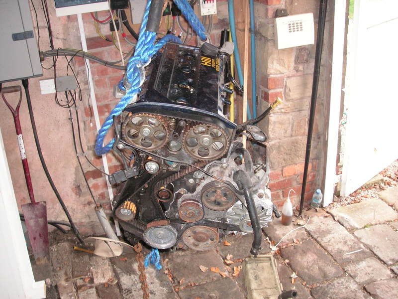

Also i've just brought a spare engine to fit all the parts to so mine won't be off the road long, as i'm ready to get an engine stripped down ready for the forged low comp pistons and other goodies when i buy them!
Want to be looking around 240-260bhp when finished as it's the stage 2 i'm building not the 320bhp stage 3 (Yet!!)

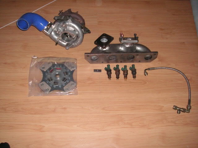

Spec list will be:
Wossner lowcomp forged pistons (((needed)))
Garrett GT28r Turbo runnin 14PSI
handbuilt s/s manifold (Got to remove wastegate port!)
R21 turbo injectors
Huge one sided FMIC with custom pipe run
Fastchips high boost low comp chip
Helix 4 paddle competion clutch
Gtt gear box for strength with soft peddle (((needed)))
Water/meth injection
1.0mm MLS headgasket (((needed)))

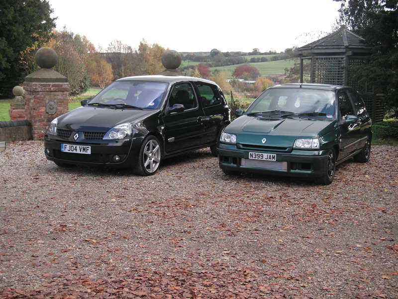

When did you buy this one? I swear it's the one I went to look at about 18 months ago (somewhere near Oxford), it had really nice refurbed Turbines on it though.
I'm 99.9% sure that's the plate from it, I got it HPI'd and everything.

May I ask about the welded exhaust manifold why there are two exit flanges? one for the turbo? one for the exhaustpipe? or will the two flanges be connected again?

Ones for an external wastegate but his tubby will have an internal one.
What power are the pistons good for? I know lee with his low pressure tubby has had a few heat problems...
The other little port is for an external wastegate but it's being welded up, lack off room near the brake resivoir!

Yer the manifold was off lee harding!

I think that yours may be one of the only green phase 2 valvers in the country. Green ones were very rare in phase 1, never ever seen a green phase 2 apart from yours.

Yer so if theres not many green phase 2's about bet mine'll be the only turbo green phase 2 ;-)
