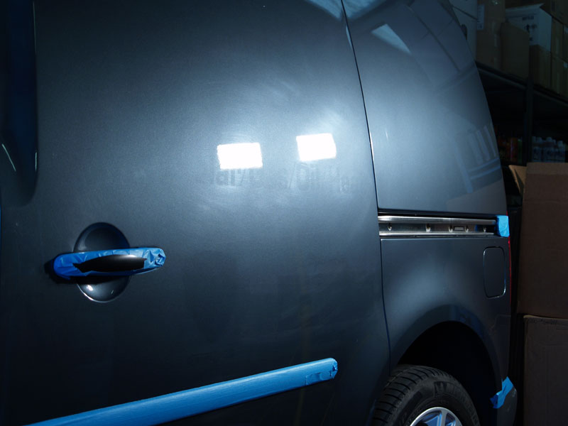

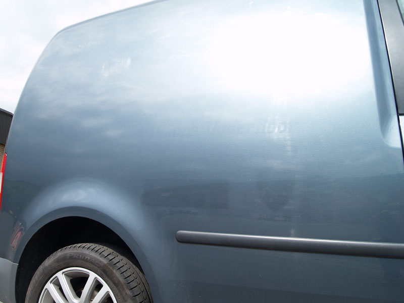

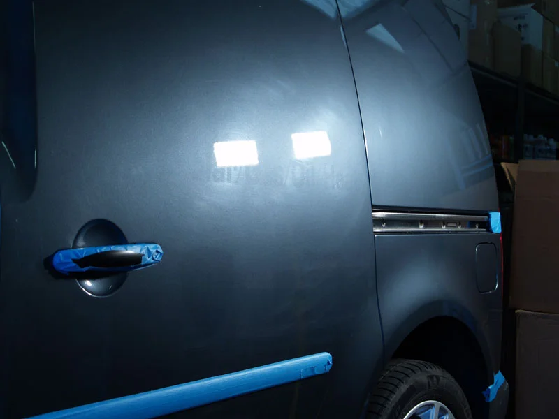

I've just picked a second hand van up and that had similar problems and stupidly I never picked it when I was buying it as it was always raining or viewed under cover. In full sun it looked a mess.
Luckily it turned out to be just the freshness of the new paint and the oxidised and scratched laquer making the removed graphics stand out.
A good machine polish cleared everything and more and left behind a lovely metallic paint.
