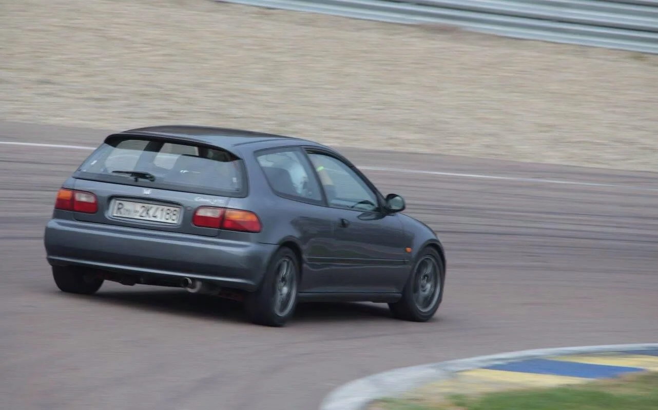

I sold that to buy a tatty EG6 Civic that i then built into a very clean looking and daily driveable track car, lots of money but in the end it looked ace and was very fast, at least for me.
With track wheels here, used to have gloss black TD ProRace3.

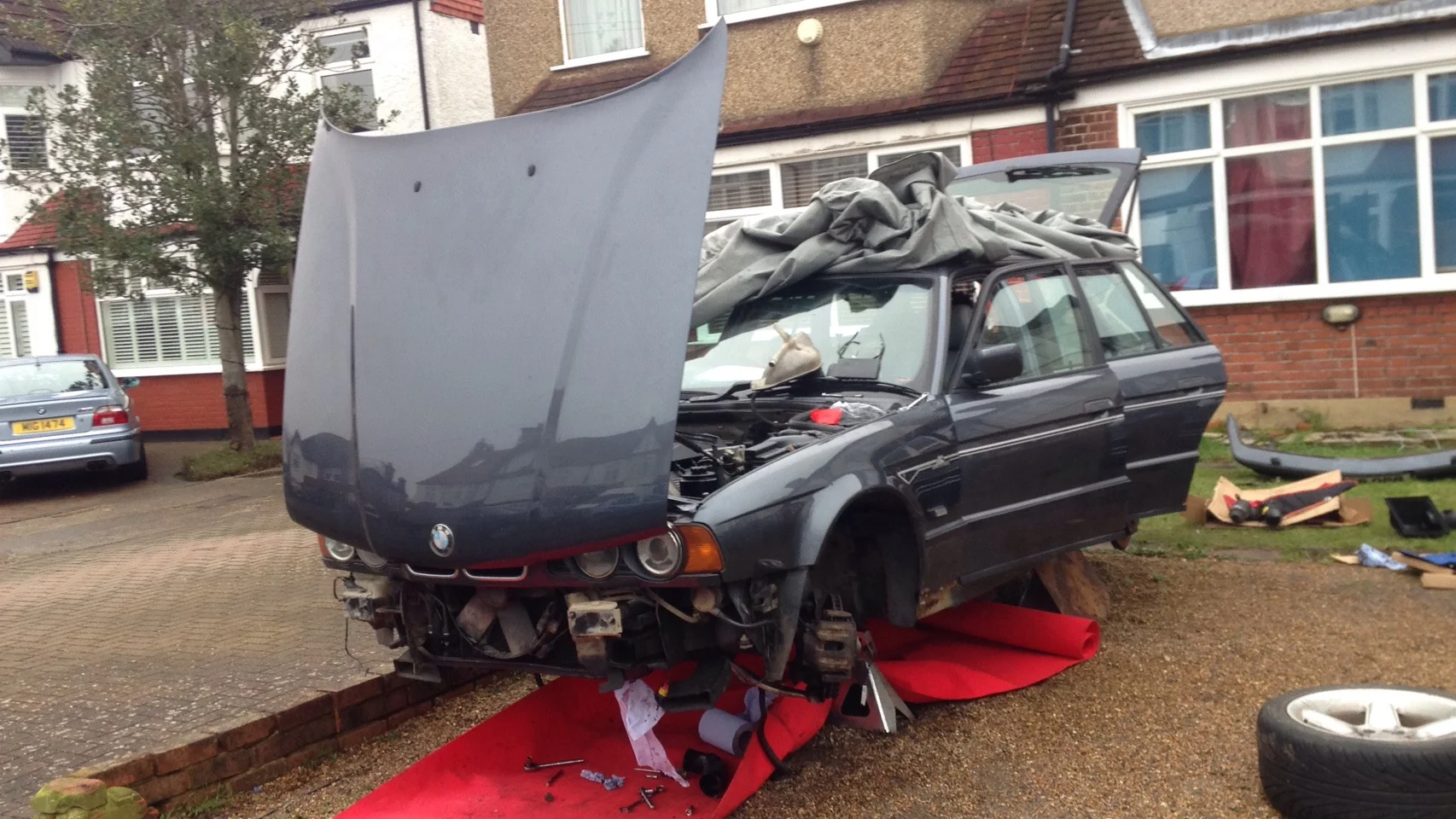

I drove it for a year (don't really know how) and then realised she needed some love. I sorned it, got the axlestands out and started the project, this is June 2016.
things soon looked like this
Restoring this car is taking me forever, working on it is a nightmare, parts are not always a click away, and more importantly, it does 16 mpg at best.

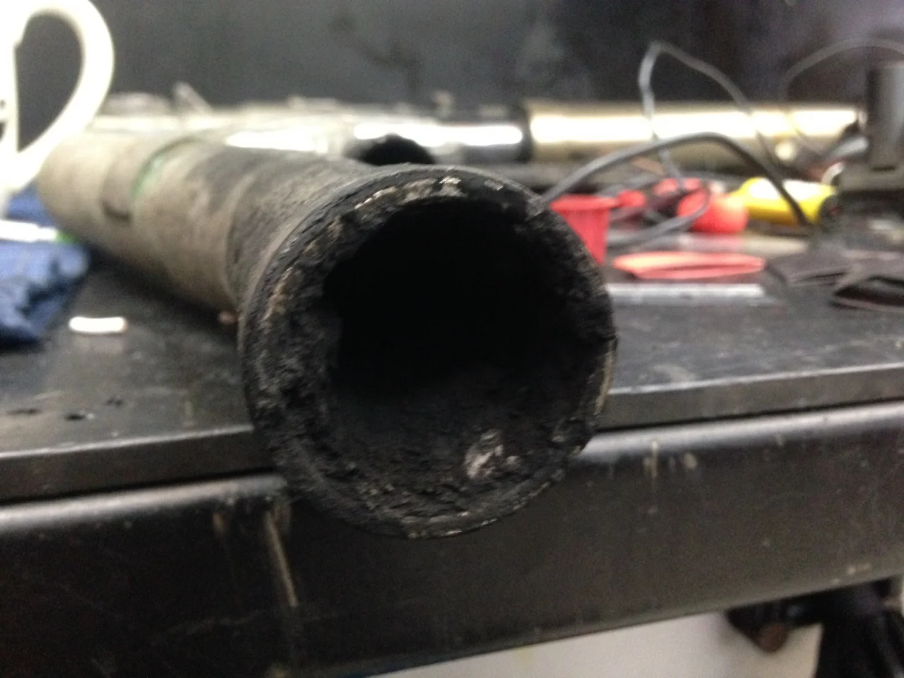

First things first, I watched videos about this without even owning the car, let's clean the EGR and cooler pipe:
... and I did an awesome job NOT taking any pictures ! But trust me, they came up MINT. we have an aquablaster at work, which is a lot like a soda blaster only much better. The valve itself was NEW, not a mark on it, moved freely as it should and looked great, the pipe took some serious scraping and blasting, then received two new orings and back at work. I shall take them off again to take pictures and also because I'm very curious about how they get so sooty.

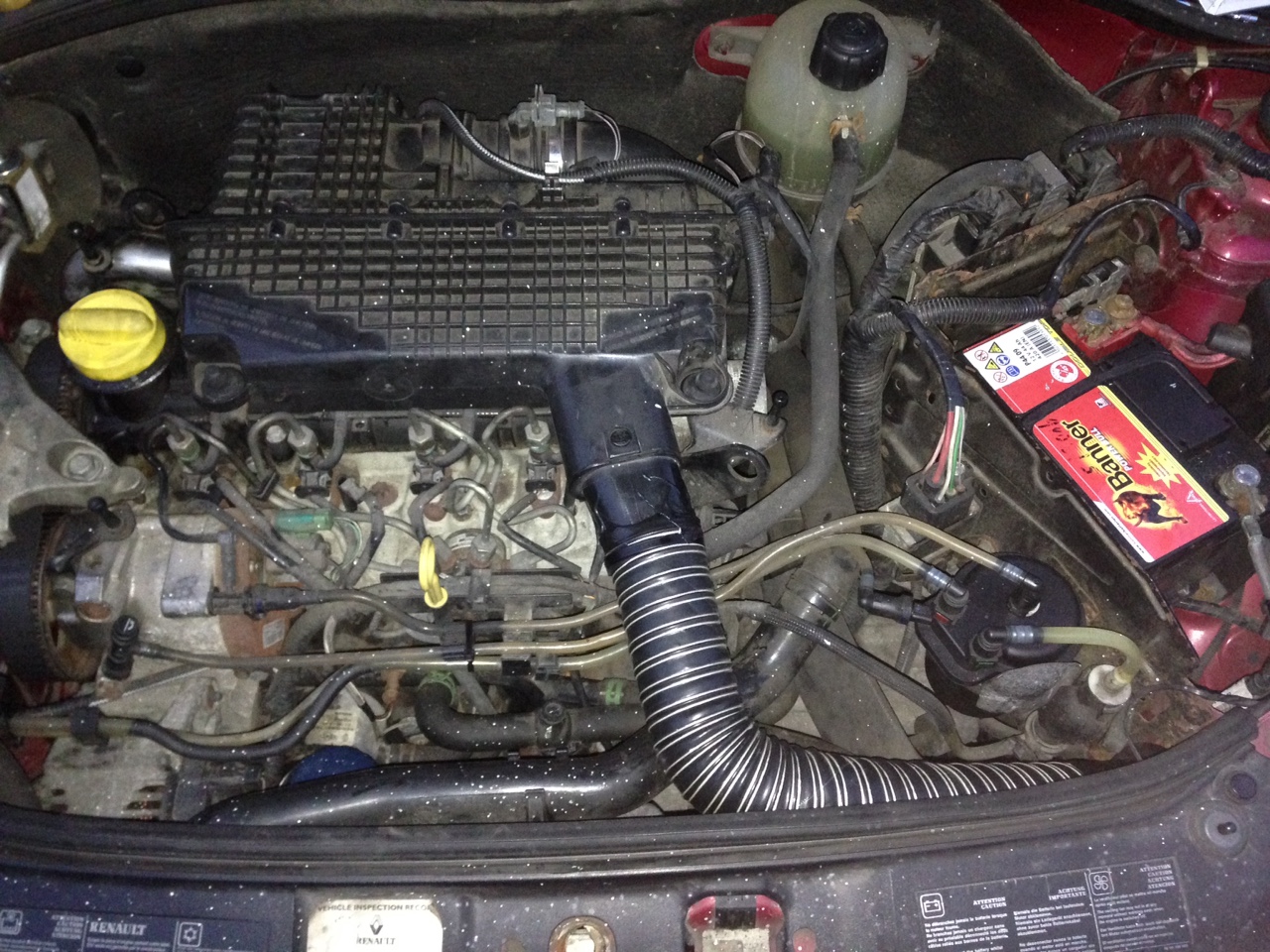

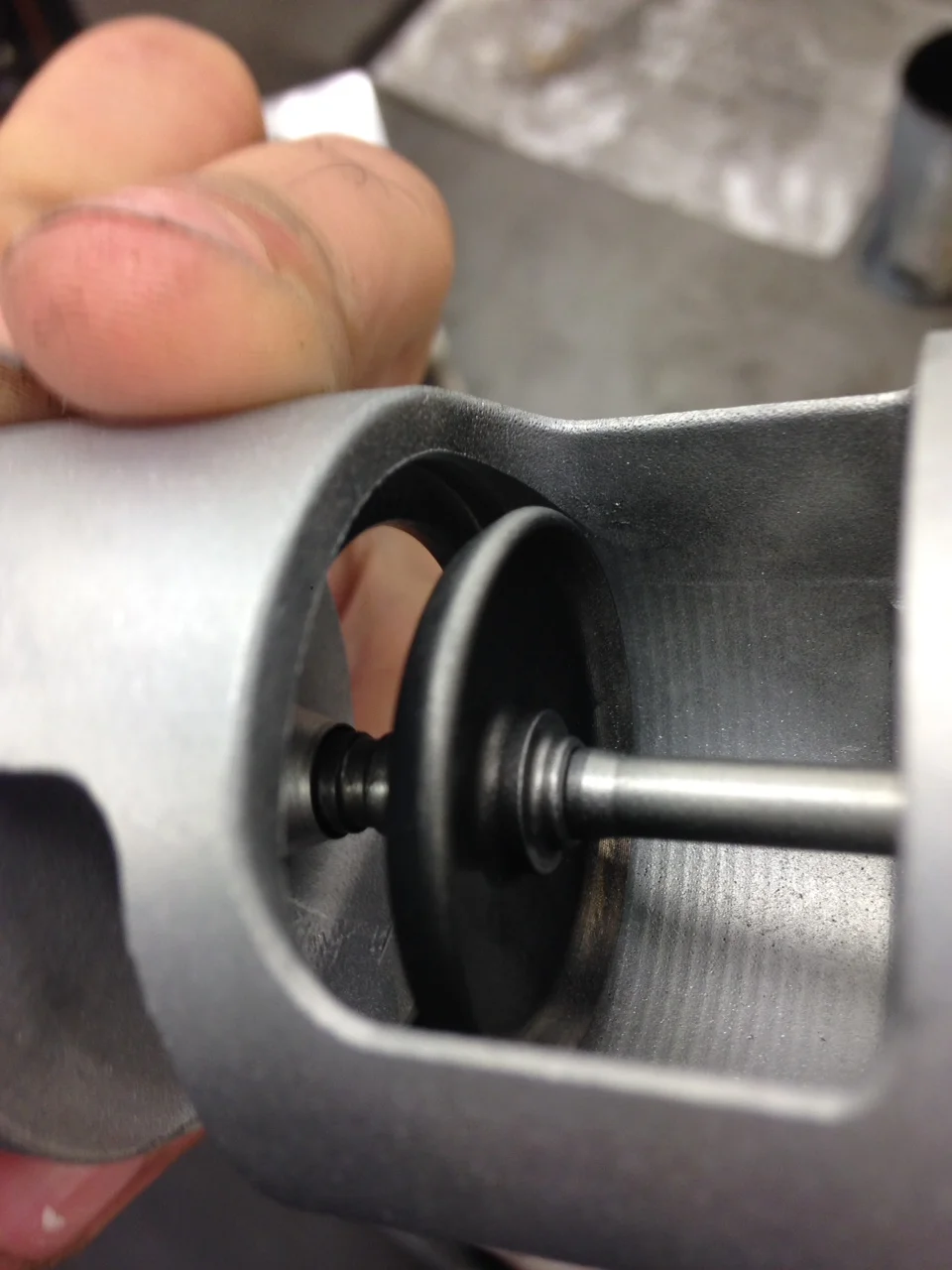

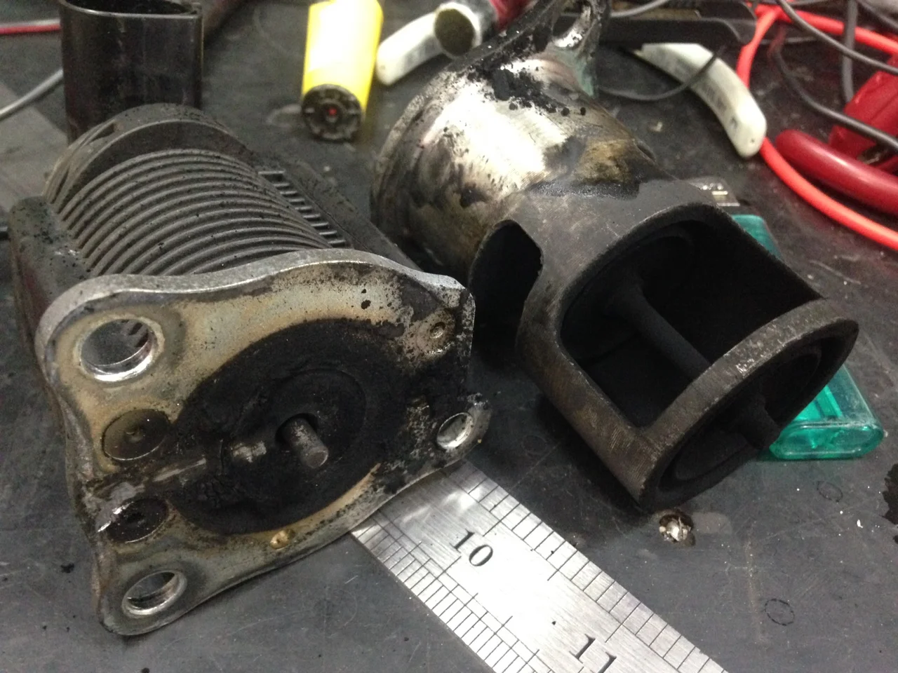

The inlet manifold got a good scraping and vacuum clean, I'll be back there soon.

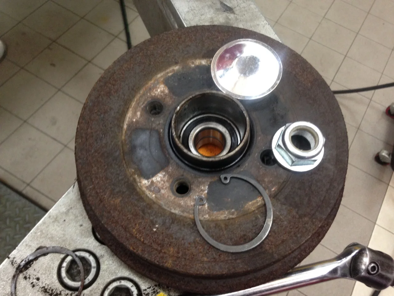

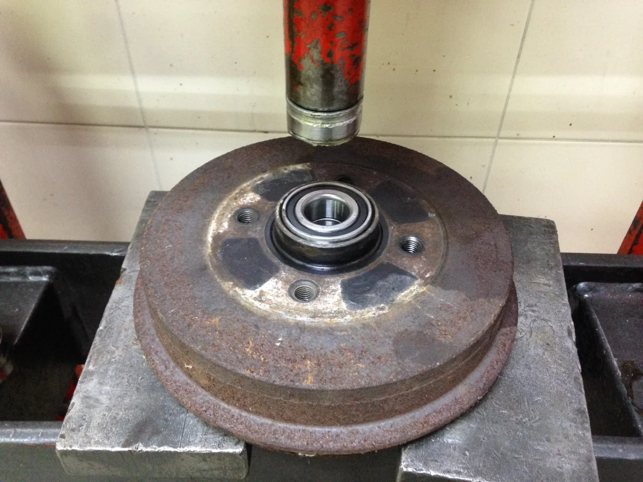

one of the rear wheel bearing was roaring since mile one of my ownership. I've heard these are pretty easy to do, let's give it a go.
people don't lie, that was a 5 minute job, if not 4:30! I'll do the other one for peace of mind if it's this easy !!

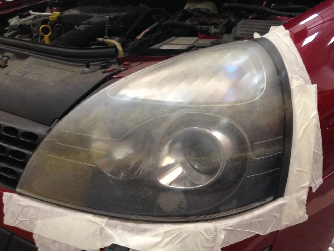

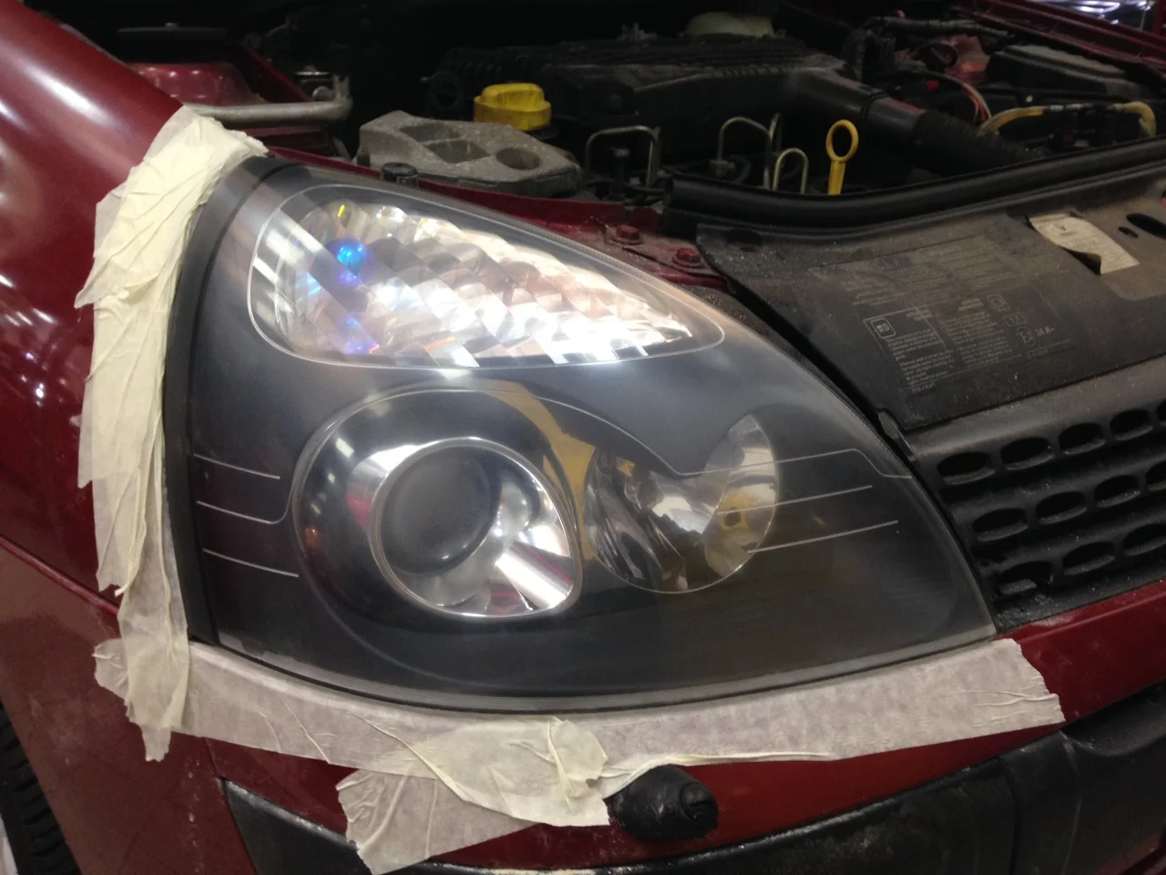

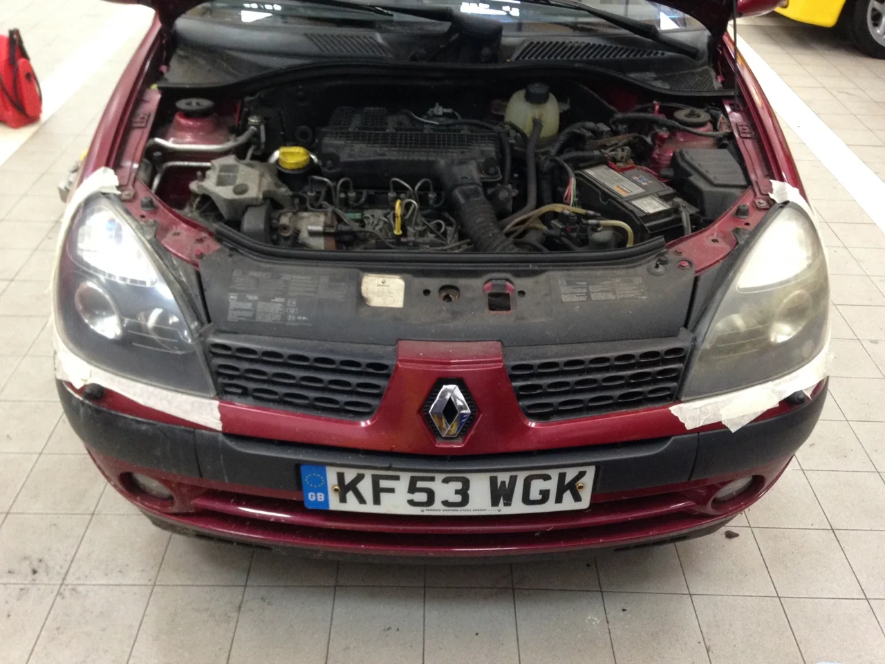

next, faded headlights, Unlike the bonnet, roof and roof rack these won't be staying like this. I purchased one of those 3M kits with drill attachment and gave it a go.
well, I'm happy. here's the before:
and after
and I rushed it a lot, there's more there if you're patient, I shall try again.

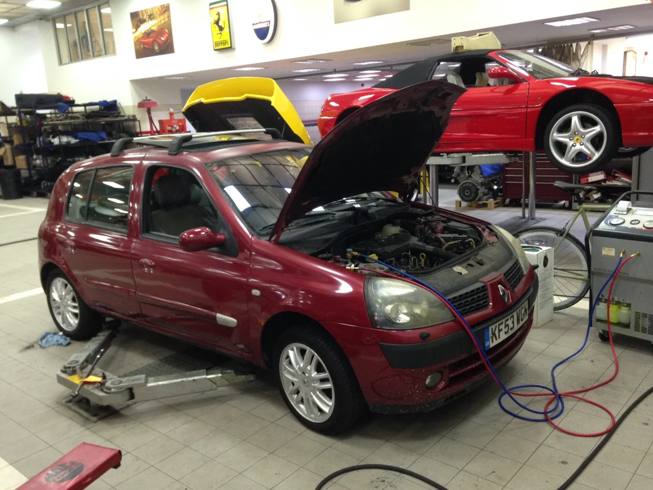

then aircon regas. I was ready for failure because, and this is my opinion, a/c gas doesn't just fade away, if it's gone there must be a leak ! and well, there isn't really, the car held vacuum like a champ, but lost everything when the fittings were taken off, suspect schrader valve. we tightened it and gave it a go, regas it is then !
after a week of driving I think that valve might still be leaking, I'll get a new one. But hey, aircon is back for now !

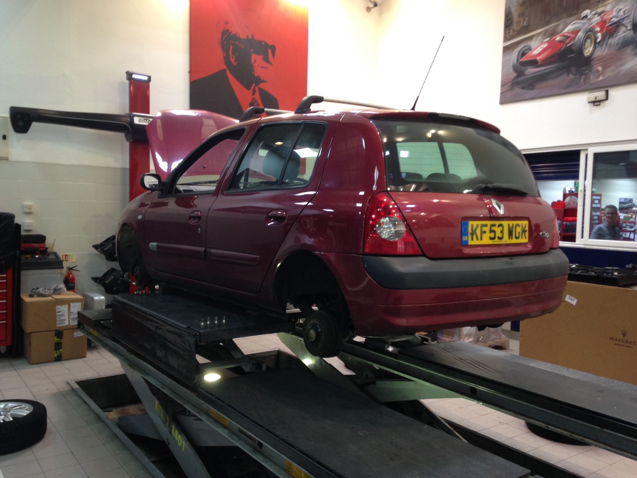

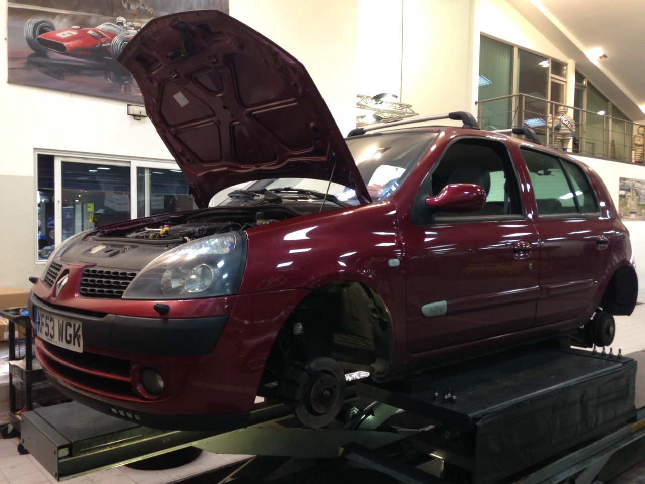

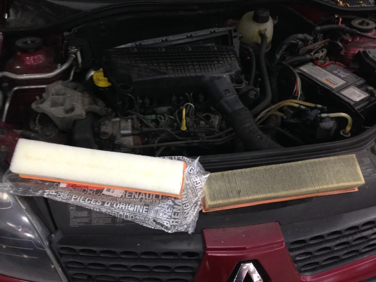

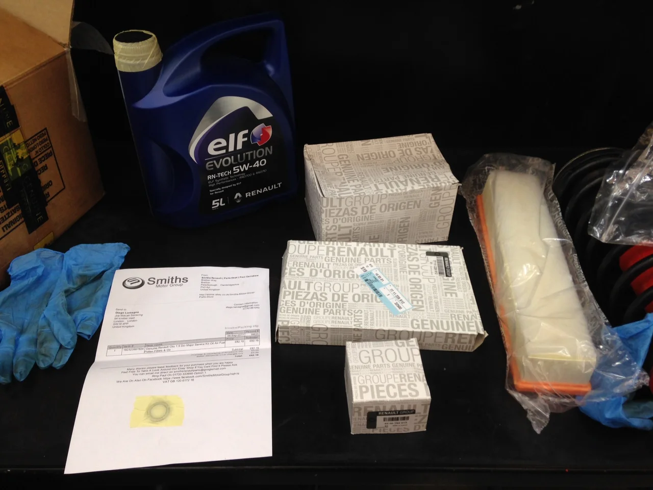

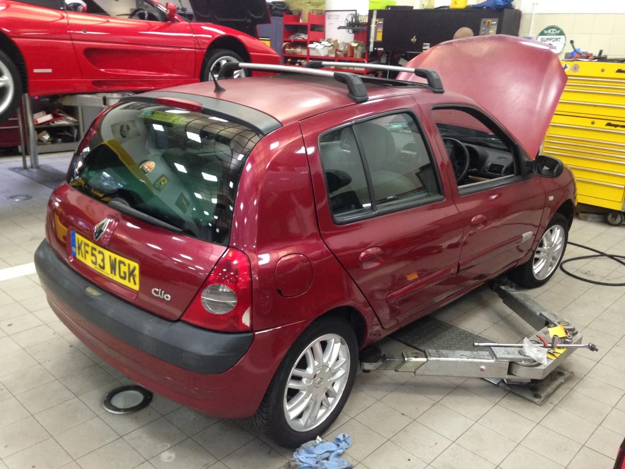

And we are at the present time, time to get my gloves on again for a major service; I got myself a genuine service kit, might aswell, was only 80 pounds including the oil !

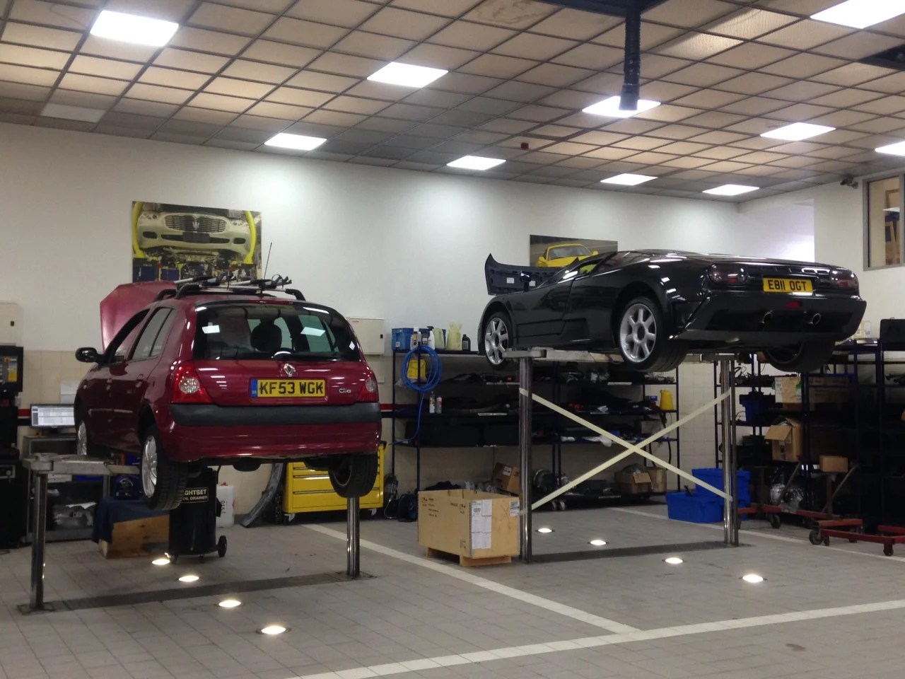

I racked the car next to an half french EB110GT, maybe even cars do small talk, at least these two should understand each other! we don't have anything french at the moment..

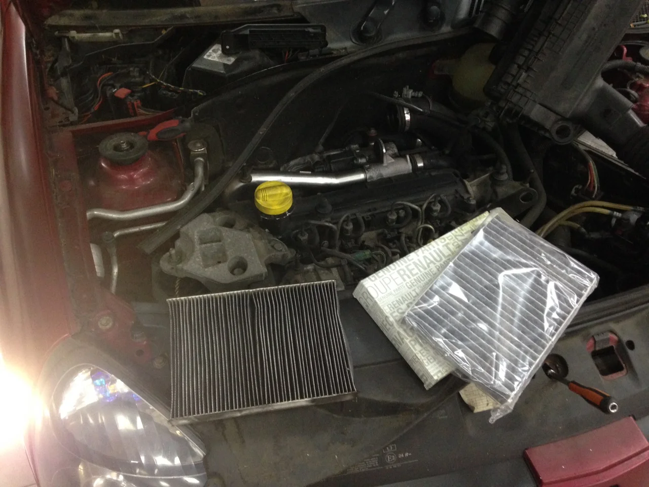

the pollen filter had never been changed I think.

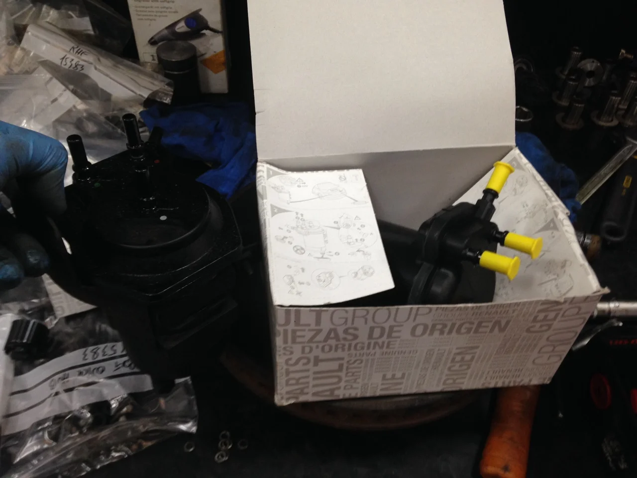

diesel filter one of the easiest I've ever done.

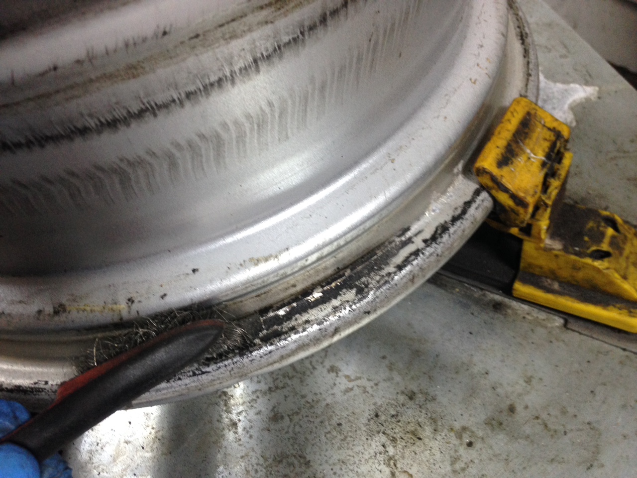

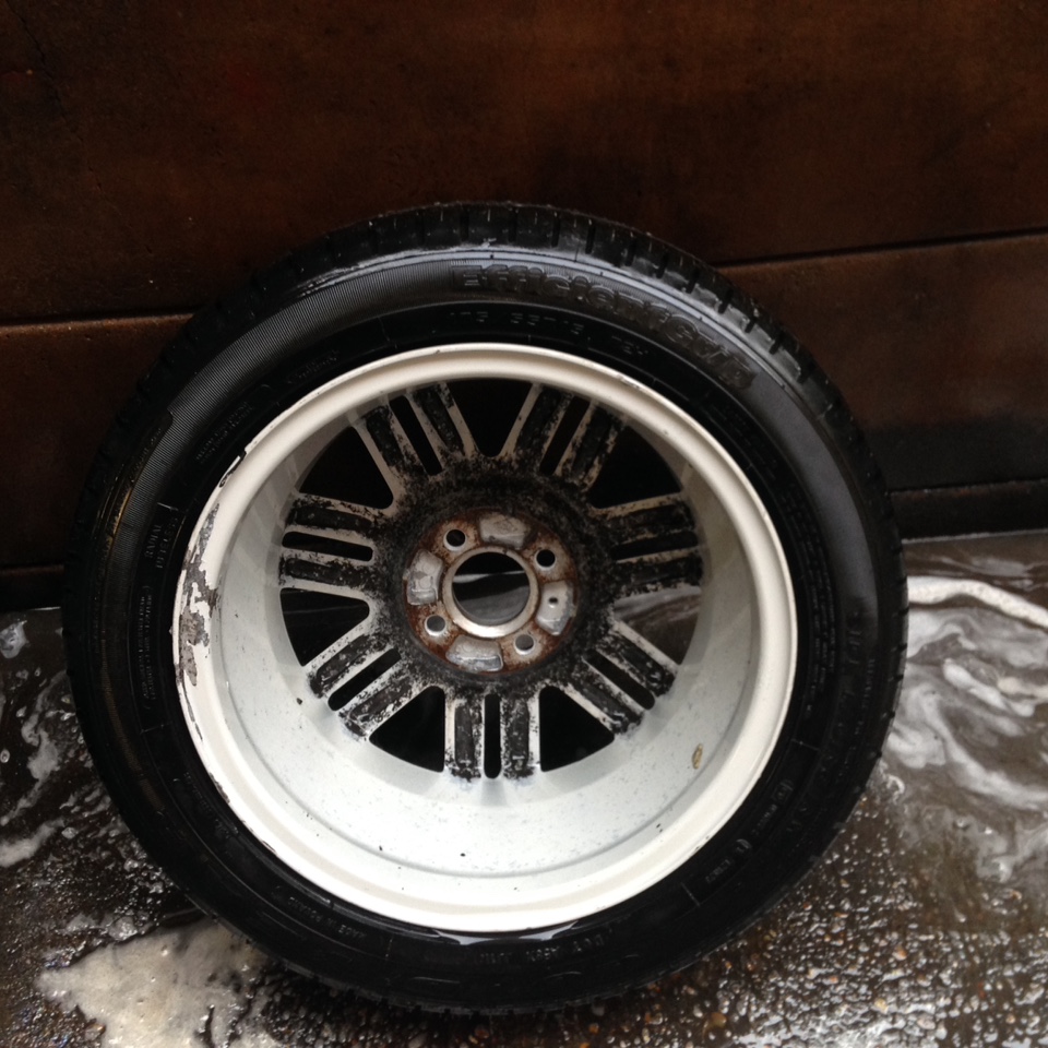

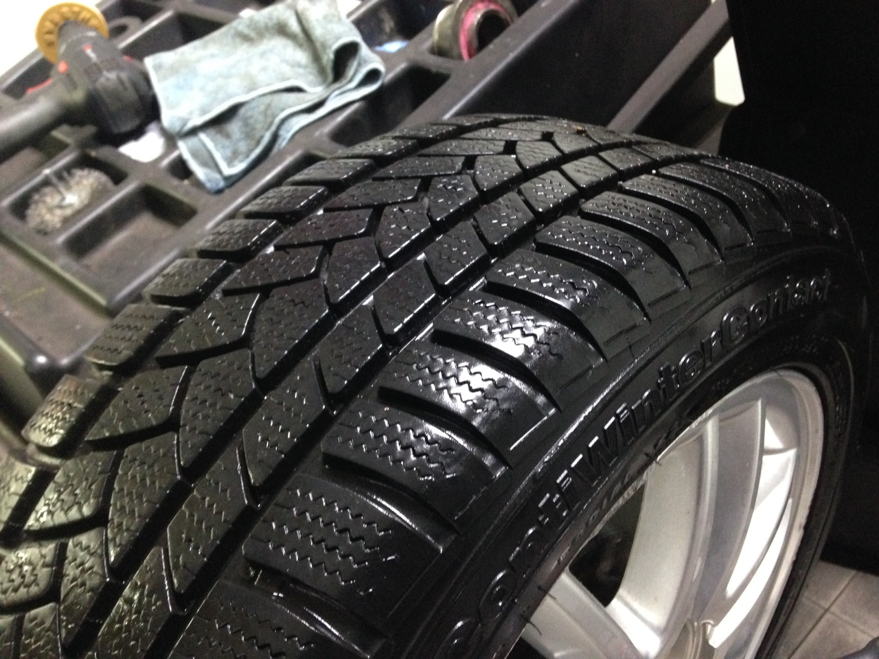

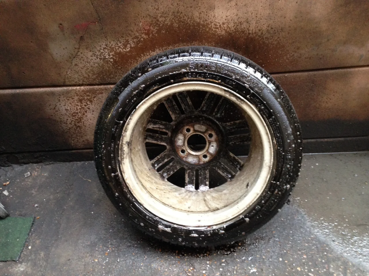

I can't stand 4 different tires, so while she was in the air I threw in two GoodYear EfficientGrip that I found on gumtree last week; 28 quid for two 2015 tires, 7mm tread left, almost new, I'd say pretty good deal.
While fitting the tires I cleaned the inside of the rims and removed any old leftover weight and glue, very common on cheap old cars; both front wheels then balanced on zero respectively with 25 and 35 grams each, they're straight.
I'll be fitting two more efficient Grip as soon as they come up at a decent price.

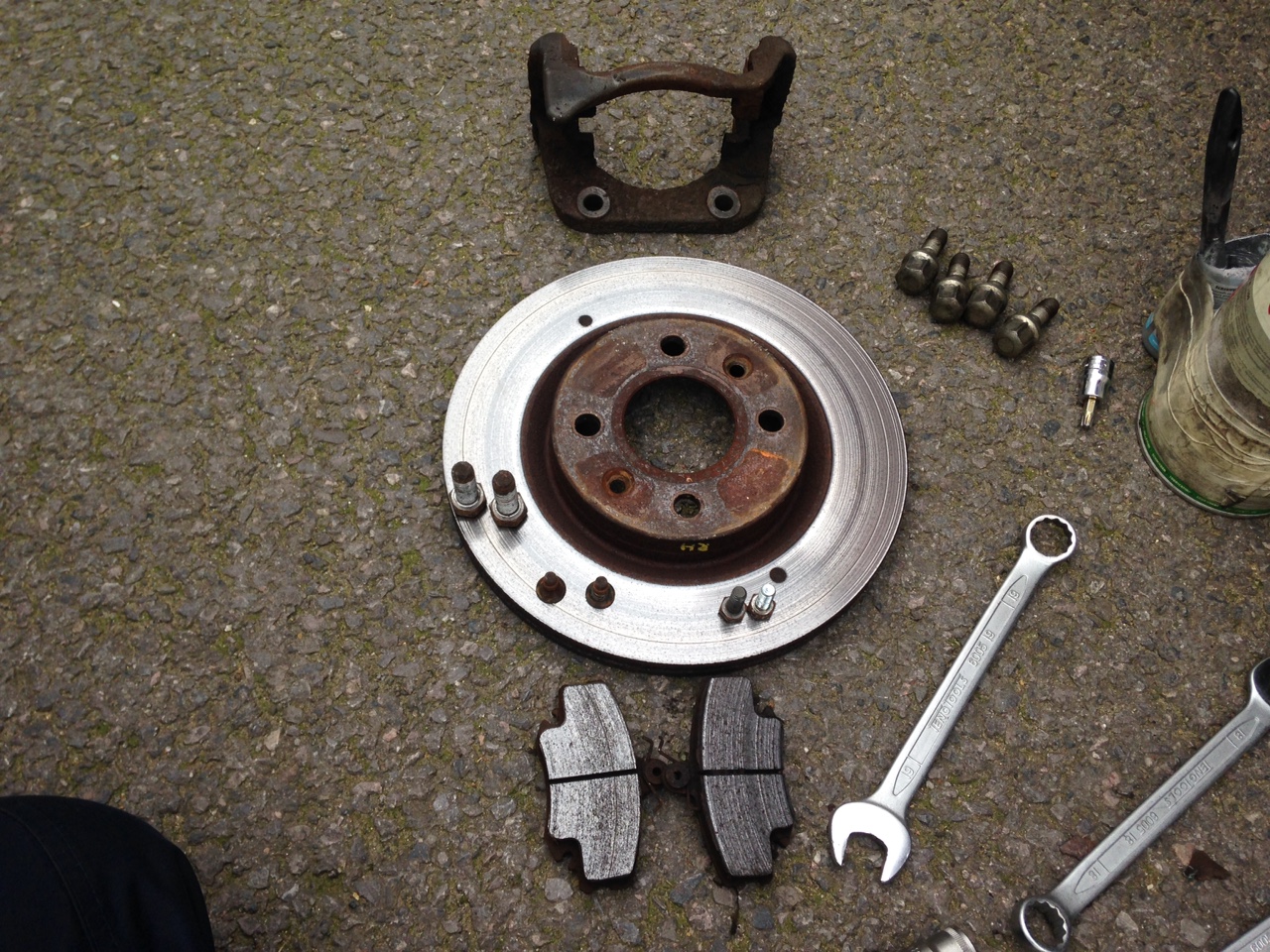

as said before, I replaced the other rear wheel bearing, nearside, even if not needed. the part was 10 quid, and the fitting took 2 minutes, timed this time.

this is today, there's still some stuff to do;

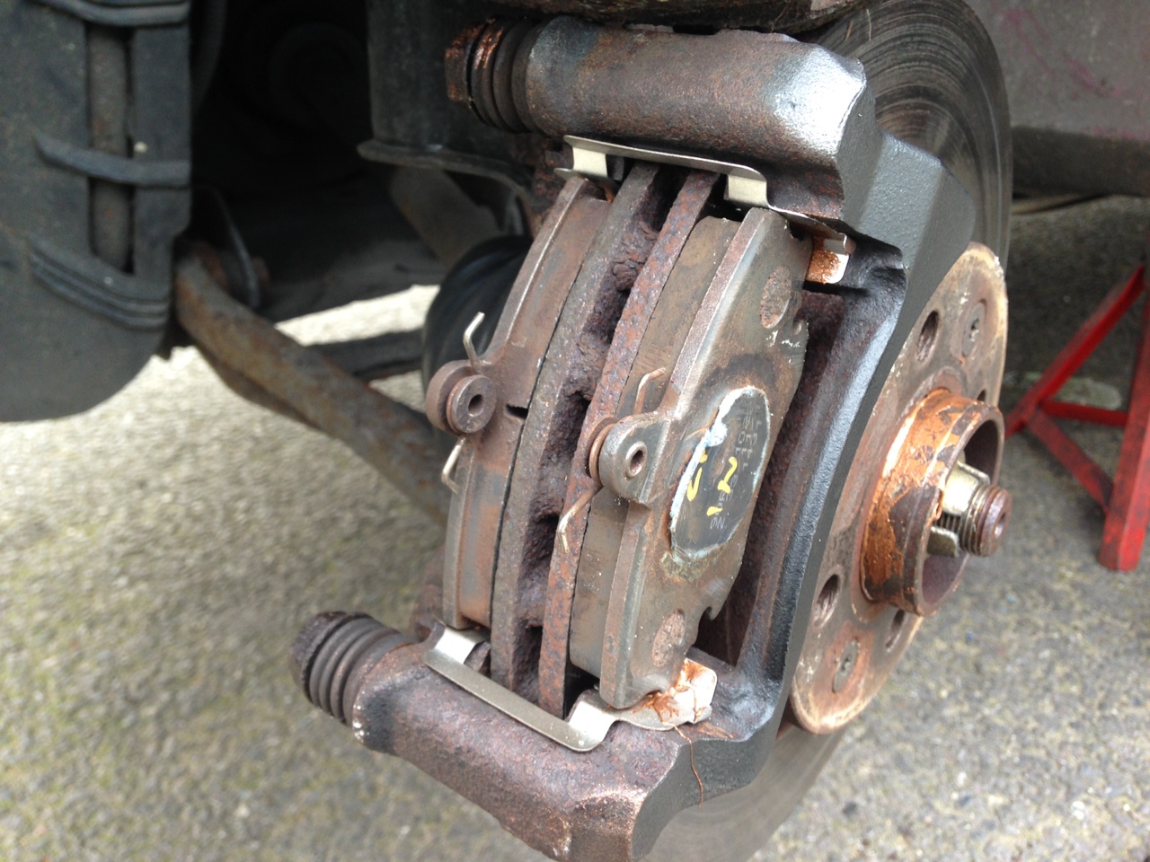

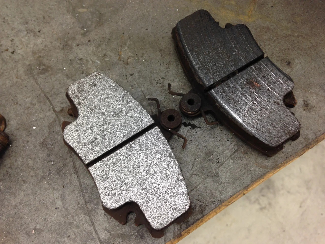

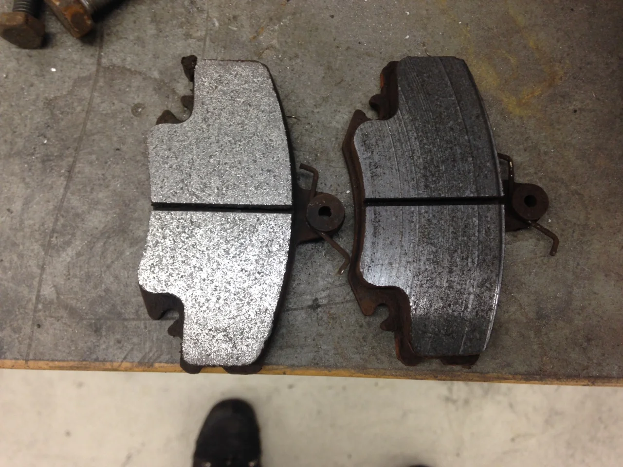

the brakes feel ok, plenty of pads still left but the discs are grooved and the fluid it's probably 14 years old. the abs light comes on occasionally because of a cracked sensor ring. I bought two stainless ones, to go on soon.

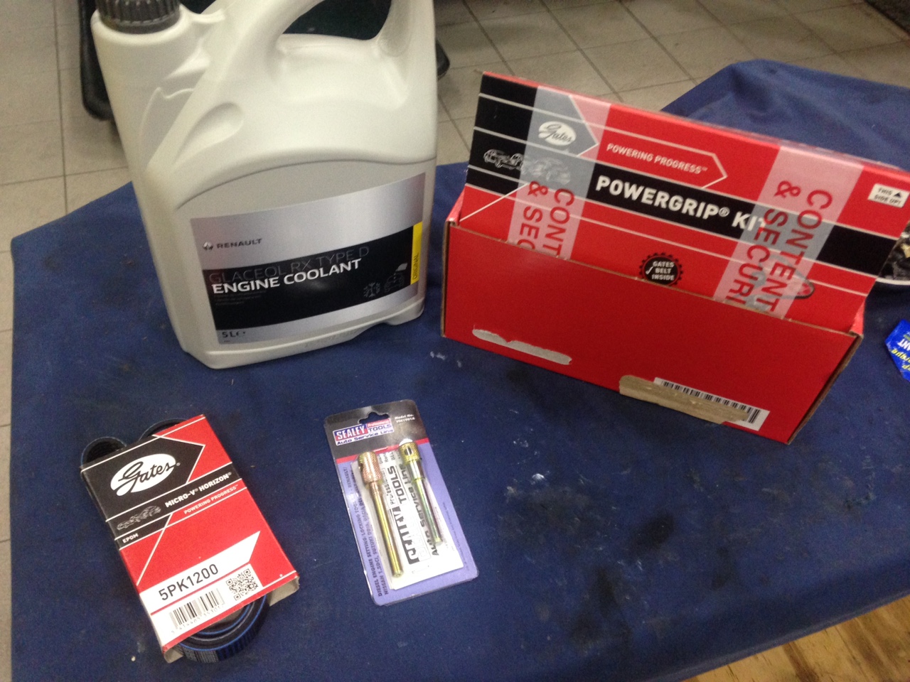

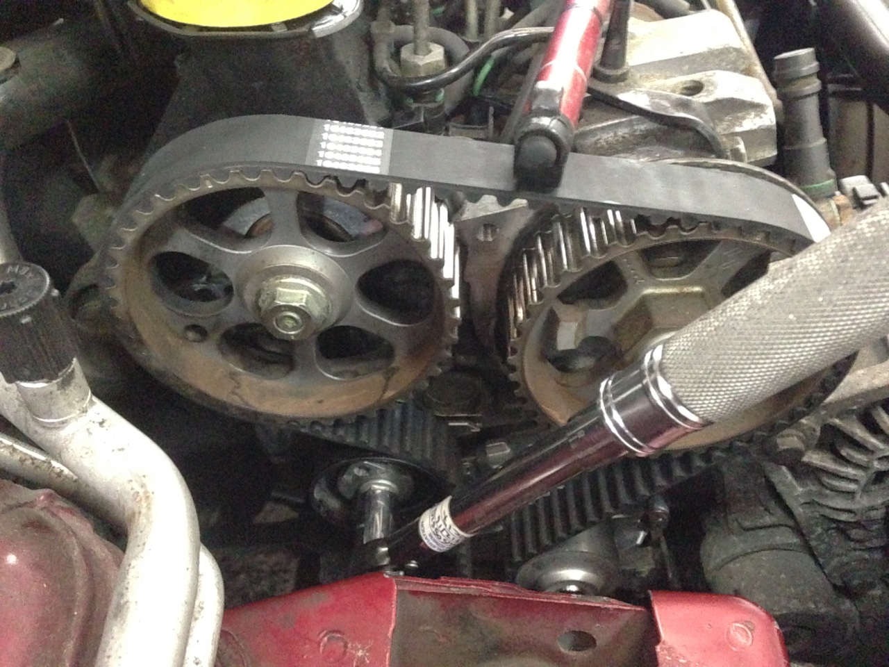

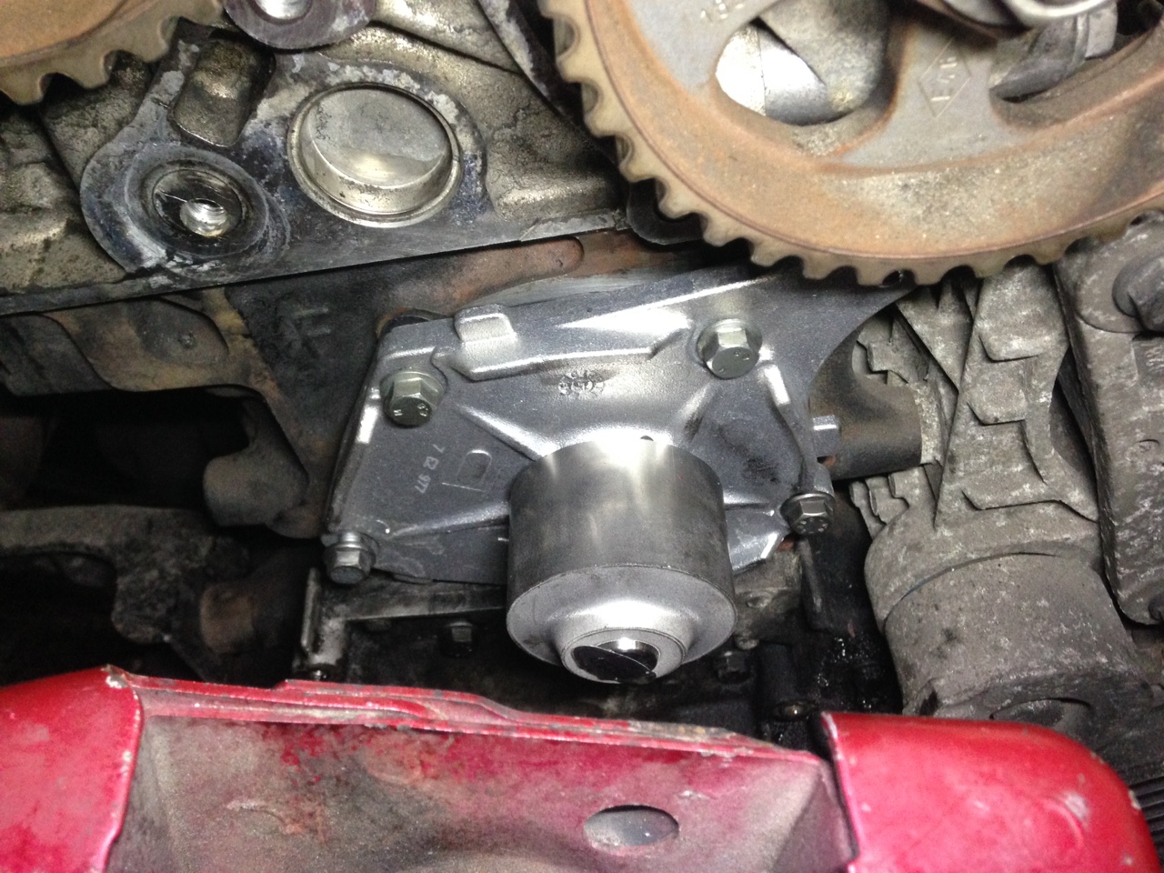

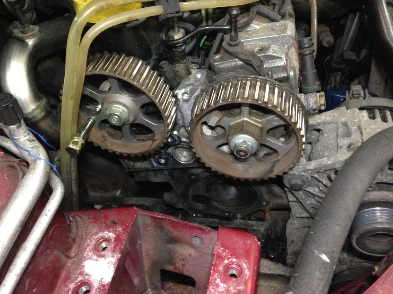

Anyway, last Saturday I tackled the replacement of the cambelt. I don't know when and even if it's ever been done, so I didn't take any chances and did it as soon as I could.
Here's the stuff
That's a complete Gates kit with water pump that turned out to be the wrong one but still useable, I had to reuse the bolt for the crank pulley, belt and water pump fit right in and so does the tensioner.
New coolant also to go in, genuine Renault again.
I replaced the drive belt too as it was long due.

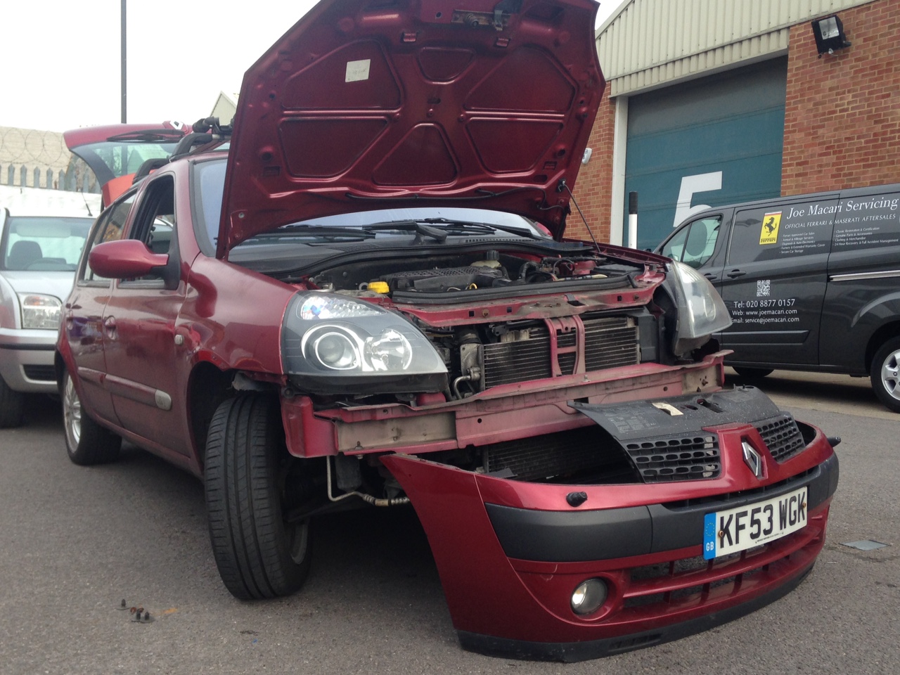

Some random pics, it's a very hard job and I was tight on time so not much time to photograph stuff around

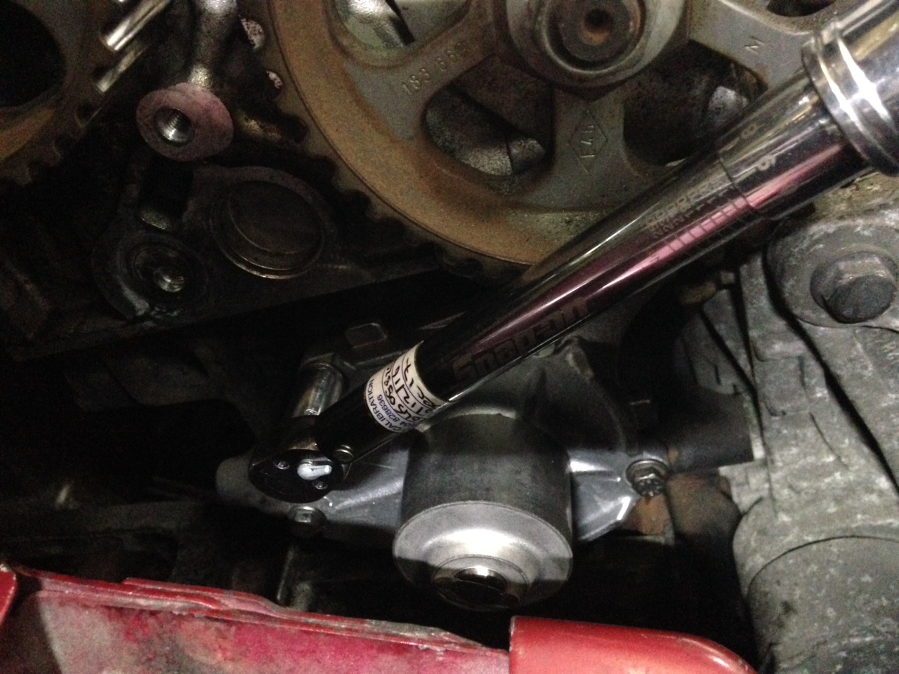

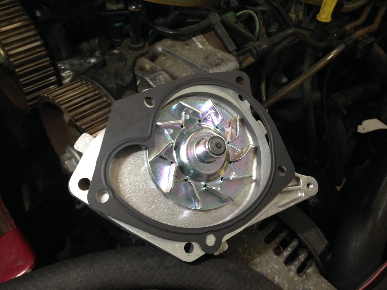

New gates pump with gasket, I cleaned up the bolts and on it goes
Some torque wrench shots so I look cool and pro

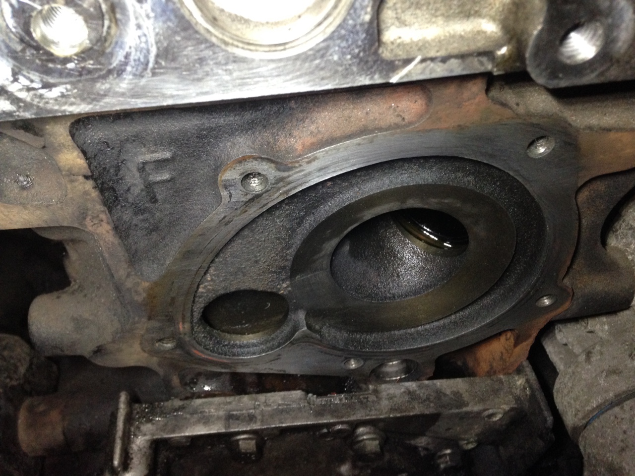

So job done but what a pain. The crank sprocket can turn freely on the crank, never seen that in my life; also the timing lock pins are almost useless, as the one on the crank only acts as a stopper but can allow the crank to turn back when you're undoing the bolt. Why not make a hole as per the cam ??
Weird
Anyway, I need to do the whole mess again as I forgot to put in the lower timing cover behind the belt, and without that one you can't put in the other two. Yeah.

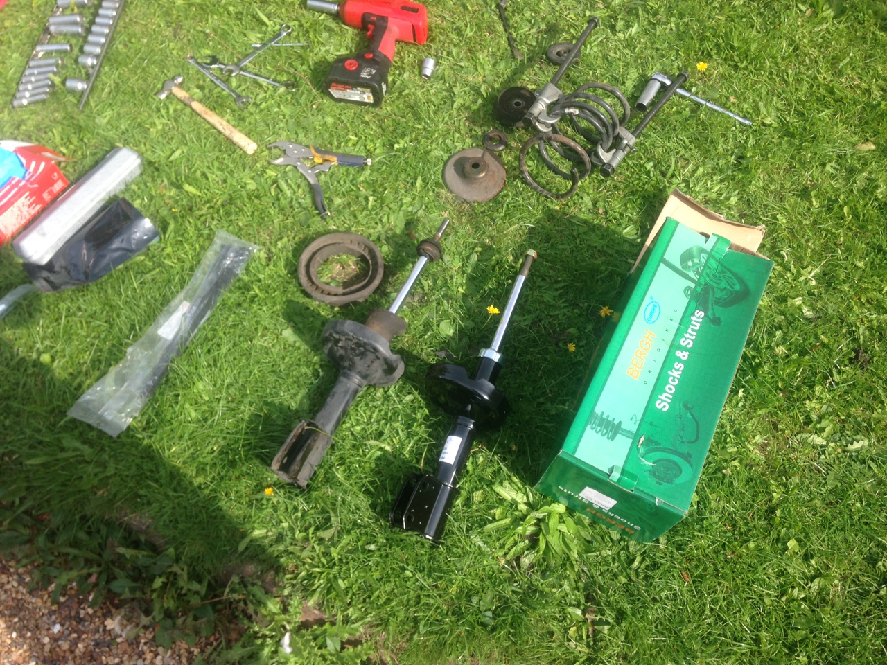

Yesterday was shock day, I tried to change the front shocks with some cheaply aftermarket ones, can't go genuine on this one !
Some of the new stuff the kit included mounts.

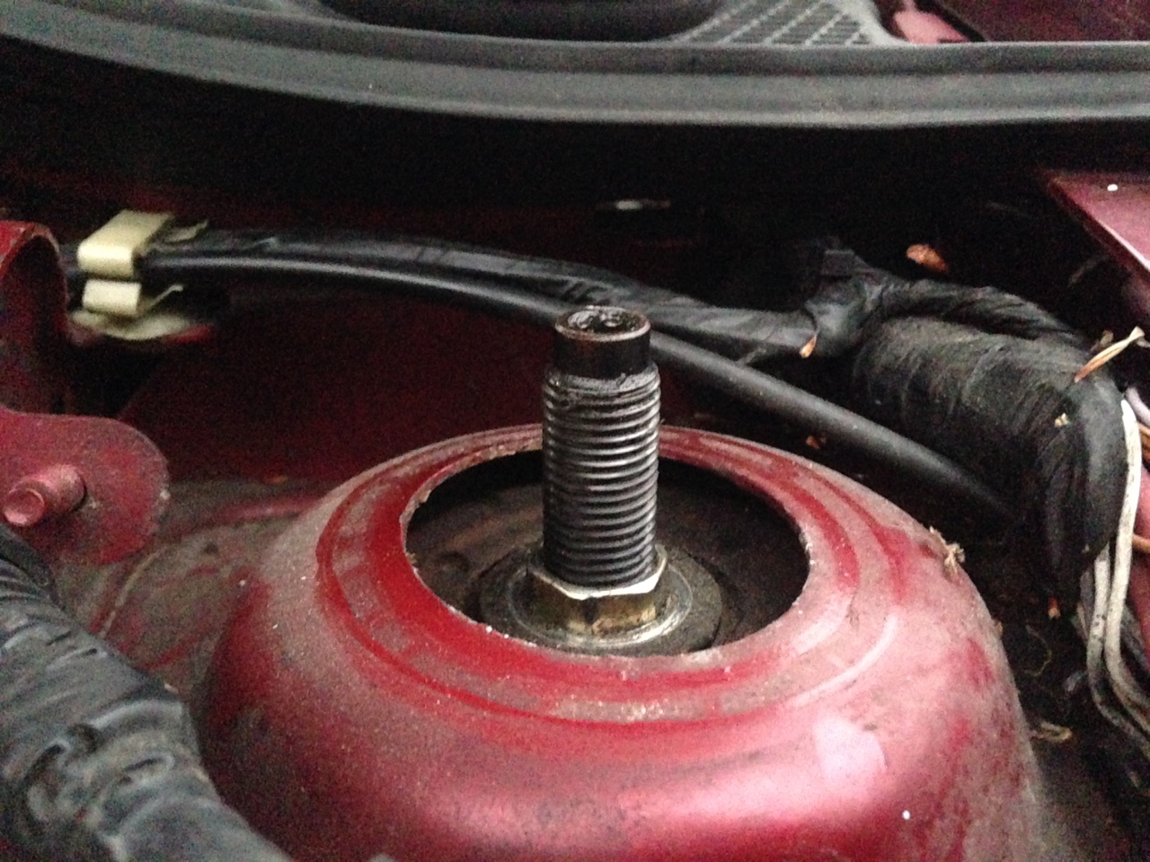

I still have an awful amount of play on the right strut top mount, but I'm up against the lower retaining nut so I'm guessing whoever has been there before me has messed up the order in which things go back together.
will look into it again, I run out of battery on the impact, today the other side goes on, we'll see.

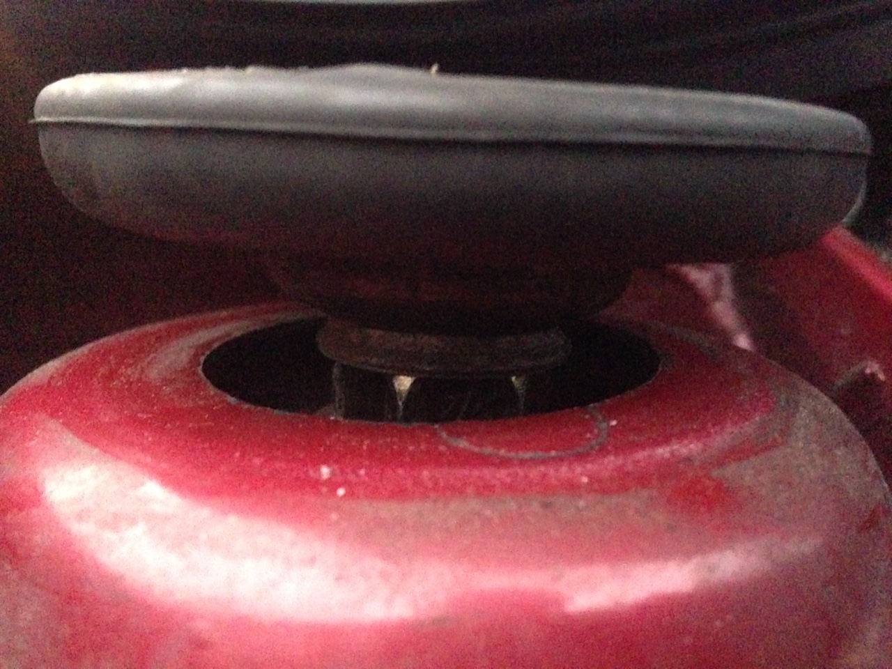

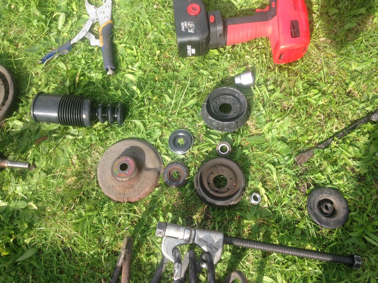

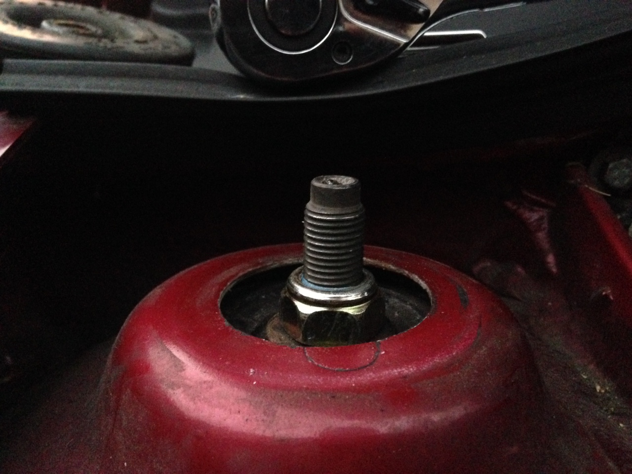

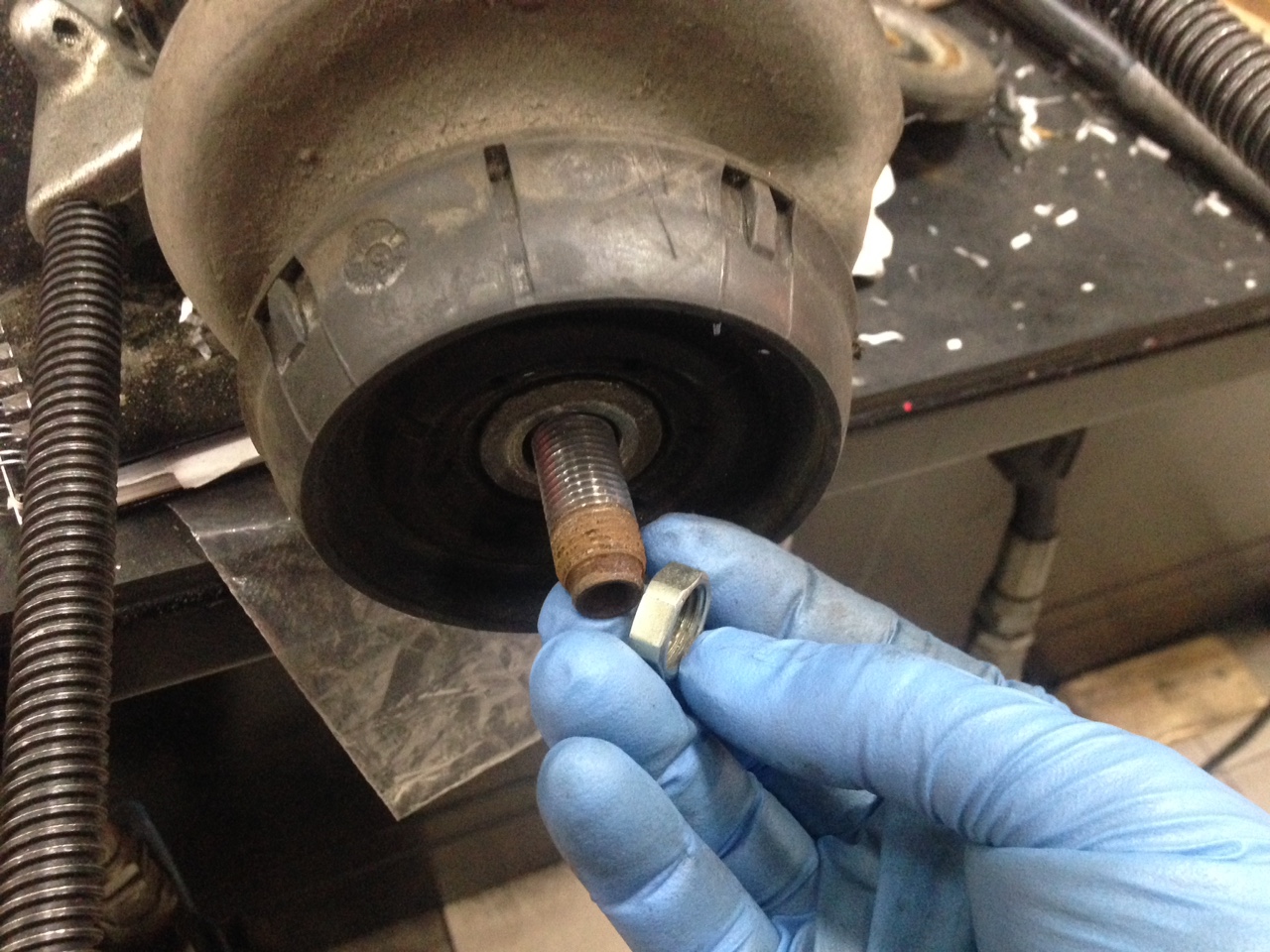

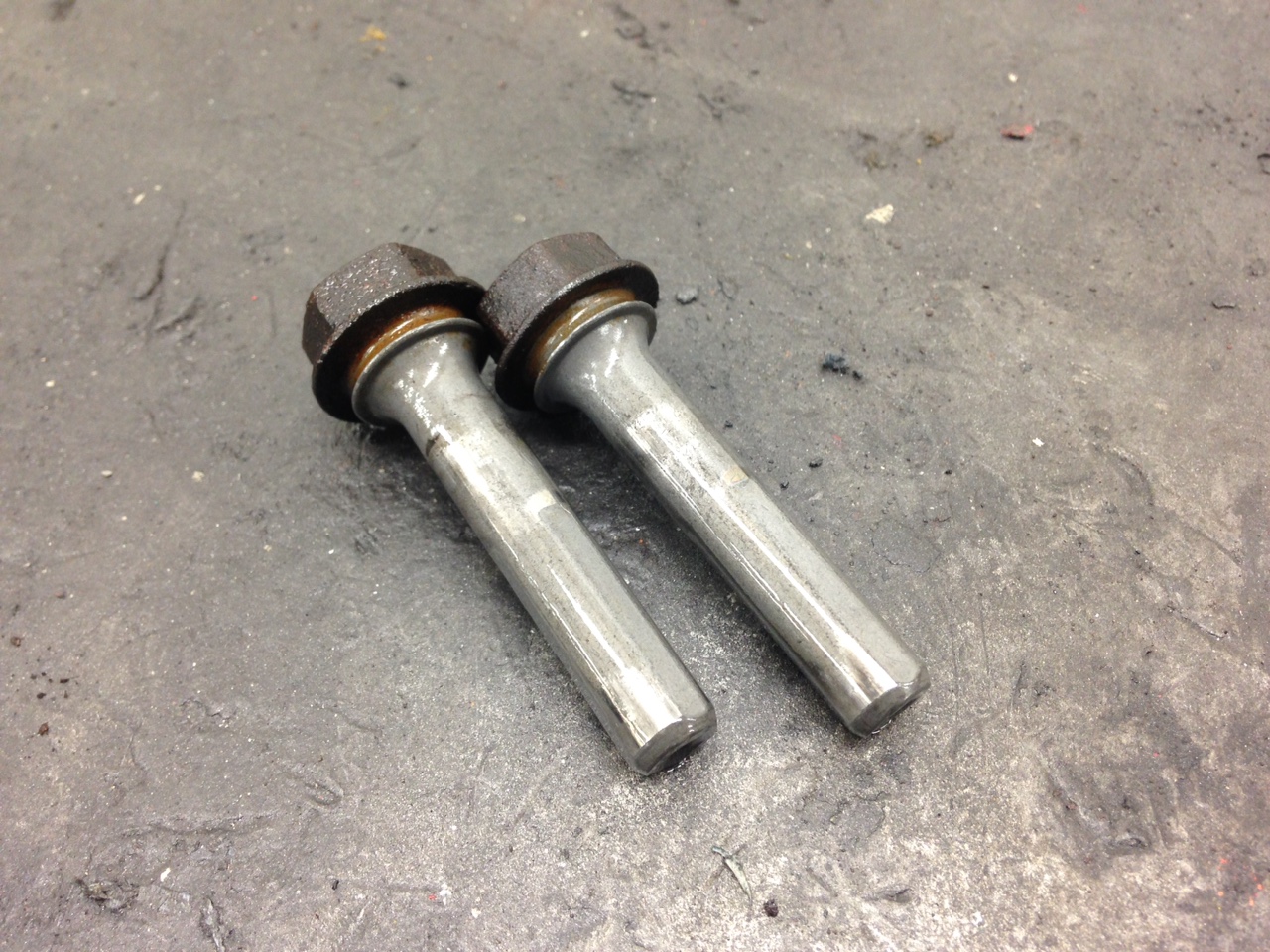

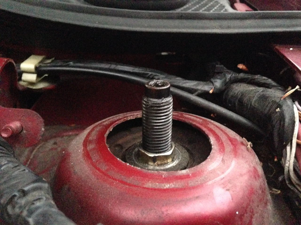

Found the problem with my new struts.
Here's the retaining nut that comes with the aftermarket ones
And here's the one that genuine ones have
As you may notice, once you do up the top nut, the one in the engine bay, this happens
The two nuts come in contact before the top mount clamps down the chassis. Not good.
Strangely my car had the good nut only on one side. The shocks then are perfectly ok, all I need is another "good" nut !

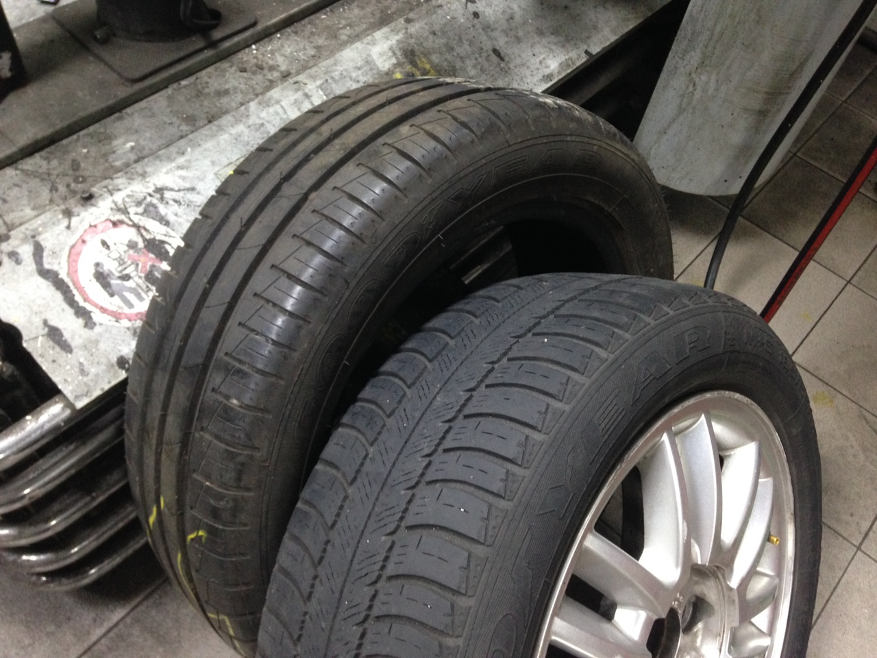

the car has received a second pair of Goodyear efficientgrip, that makes for a matching set, don't know when the last time was for this car !
Tire change done my way, takes twice as long as "trade" time
On zero again, although both rear rims have lost their roundness, we'll see how they do on the motorway.

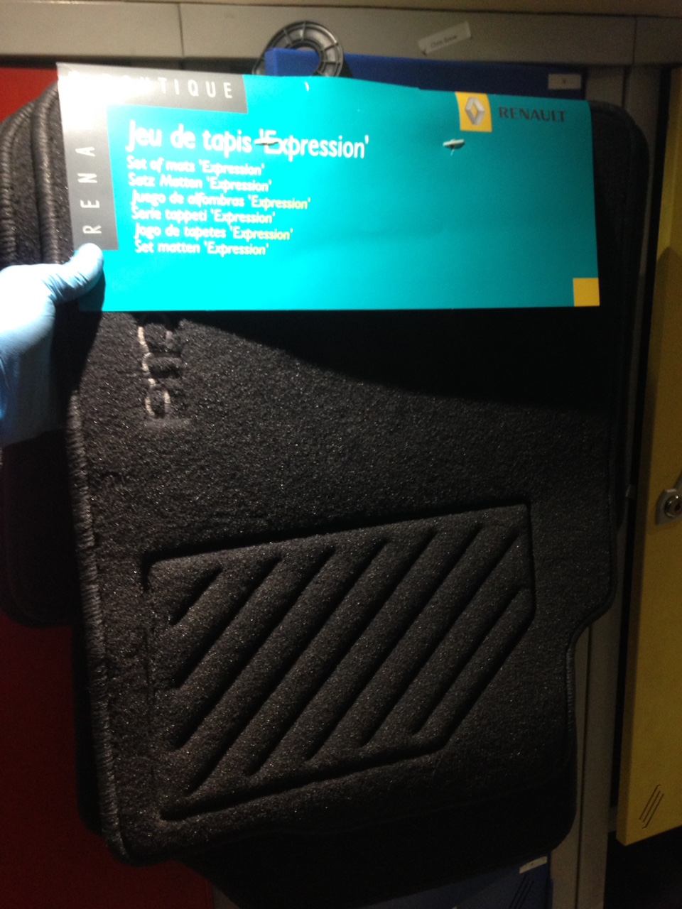

Another addition, this is the first time I've ever bought floor mats for a car
The best of the tires found on the car when I bought it ended up being the spare, and the boot got a good clean.

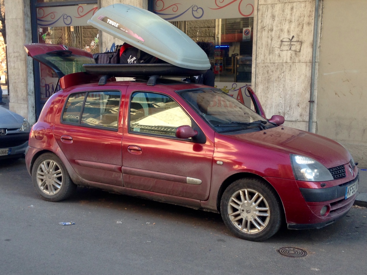

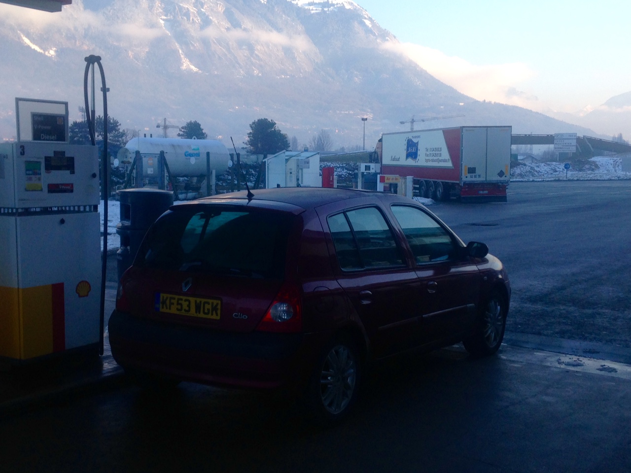

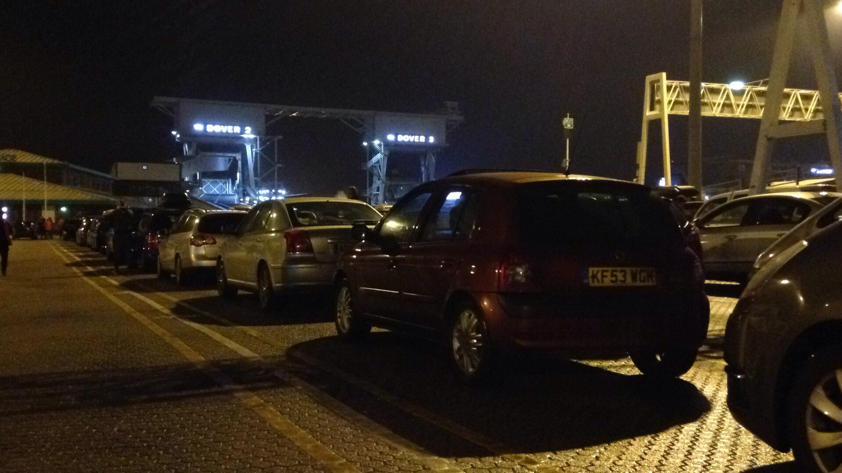

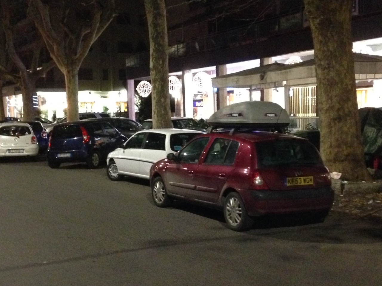

Trip to Paris completed. Almost 600 miles, 85mph average speed meant just under one tank of diesel did it, it would have done a lot better if I wasn't in such a rush. Border control pulled us over and checked everything right down to cylinder head bolts torque, what a pain.
Learnt lesson for next time: get that bonnet painted and shave.
All in all a nice trip to get used to the car. 6cd changer works a treat if you can still speak the CD language, air con worked the whole time, climate control bang on too.
I had my foot to the floor almost the whole time and she didn't miss a beat. Averaged 62 mpg loaded up to the roof and again, no less than 80mph. Came out intact from a minor collision with a fiat 500 left with no handbrake on, the cute little French girl was so sorry but no damage was reported.
I'm happy with this little red thing, fingers crossed for the future !

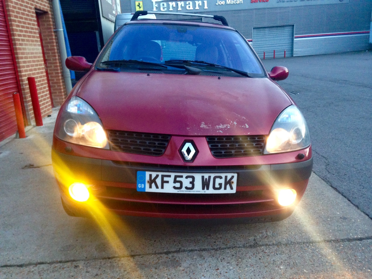

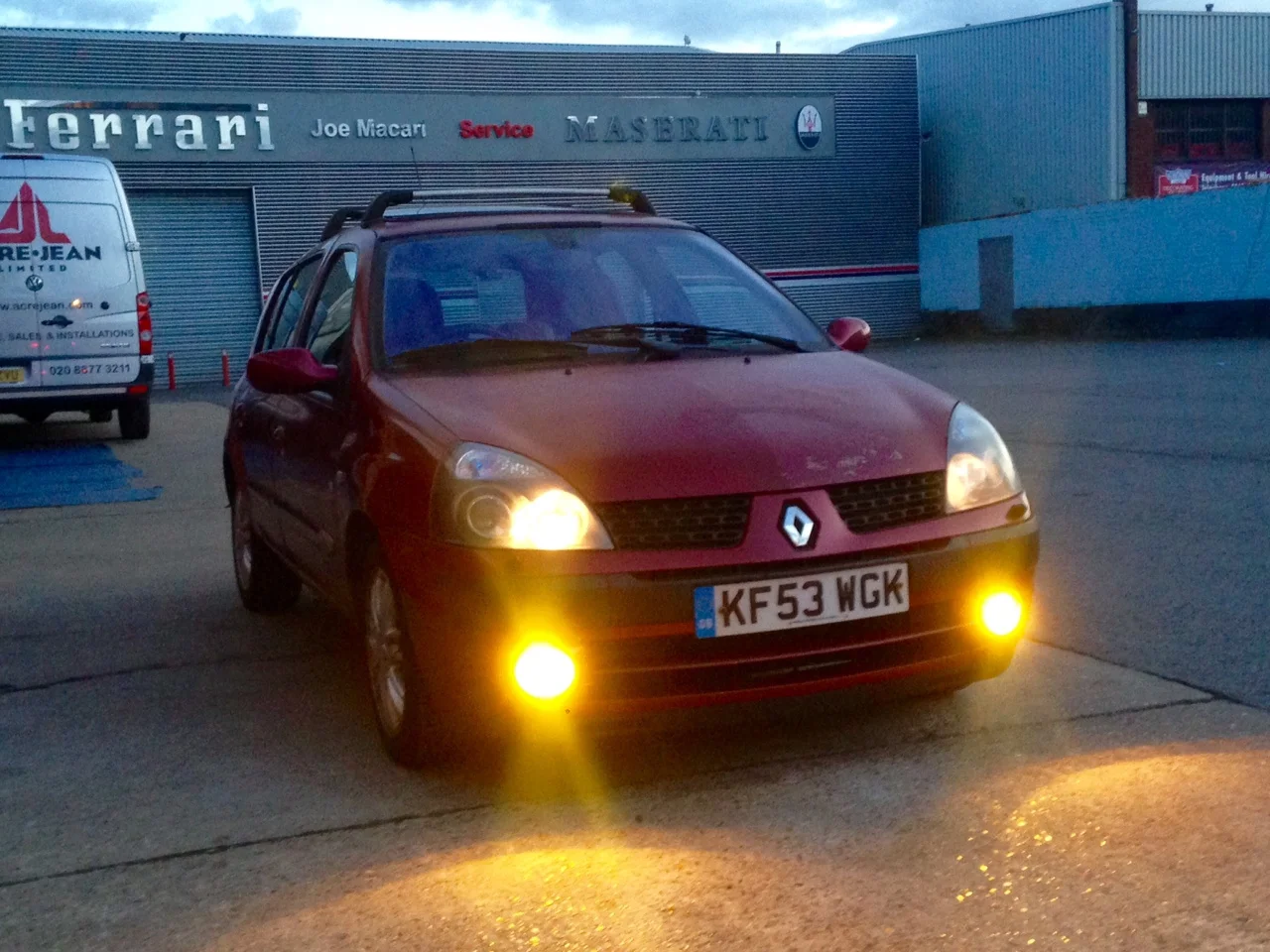

I finally fitted those yellow h11 fog light bulbs
Here's the before
Comparison
Final result
They are pretty yellow, not bad.

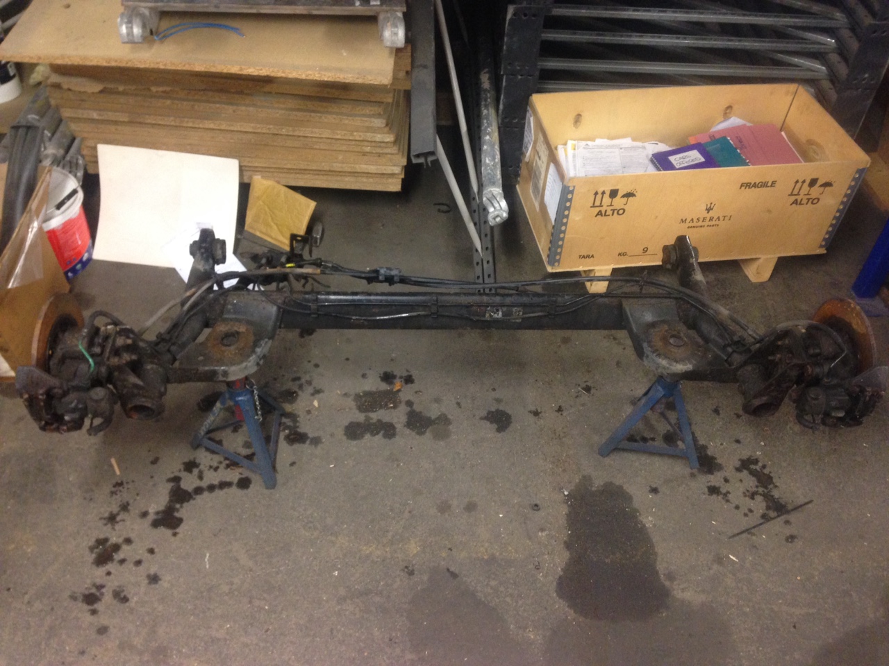

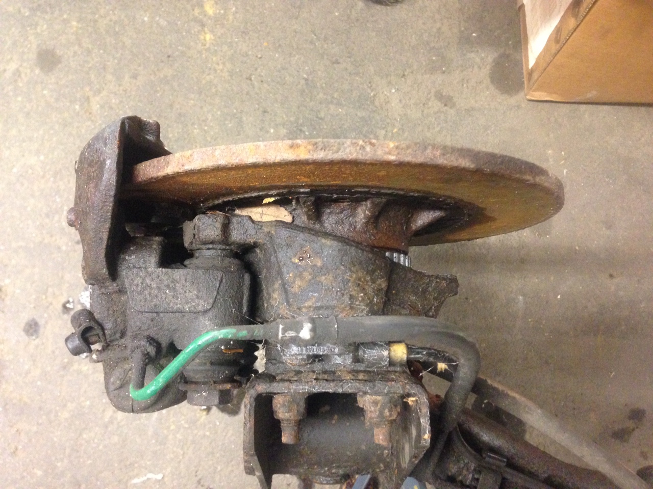

A) I'd like to retrofit the rear disc brakes, I found some 172 rear axles on eBay for around 50 pounds complete, other than ABS rings is it really a straight swap? Same master cylinder ?
B) another thing I'd like to have is cruise control and I've seen that on some cars the loom is already there and all you need is some switches and you're set. True?

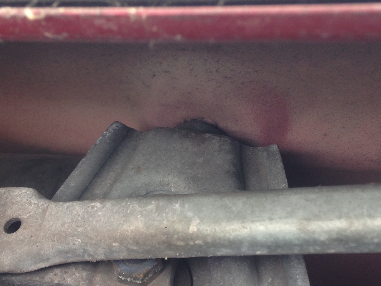

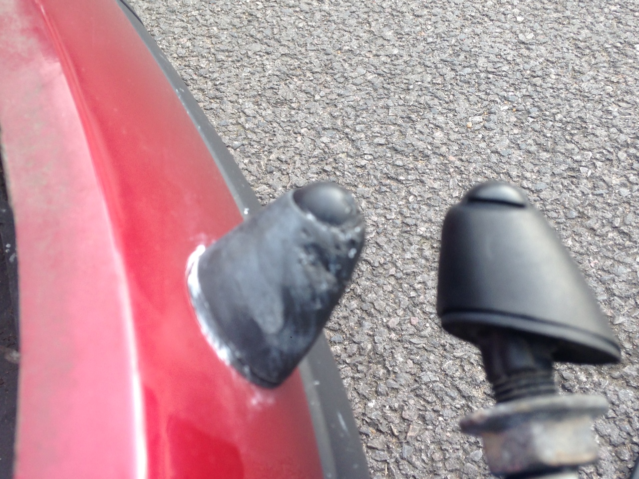

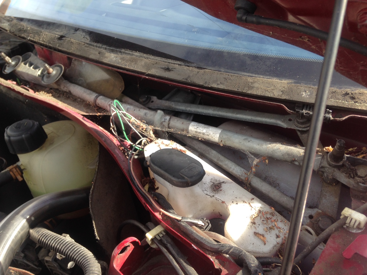

Sorted the wiper mechanism that made me cringe every time it operated: turned out to be the usual (from what I've read) linkage that had come off the locating stud.
Back at home, even greased, luxury

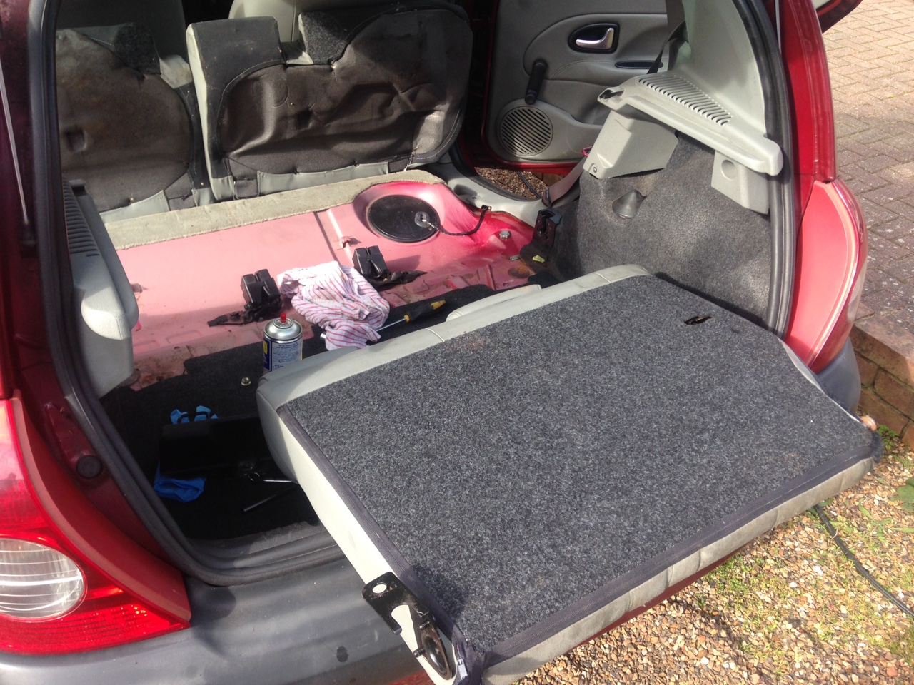

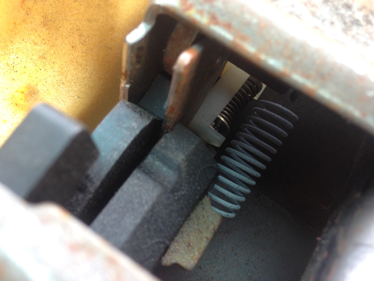

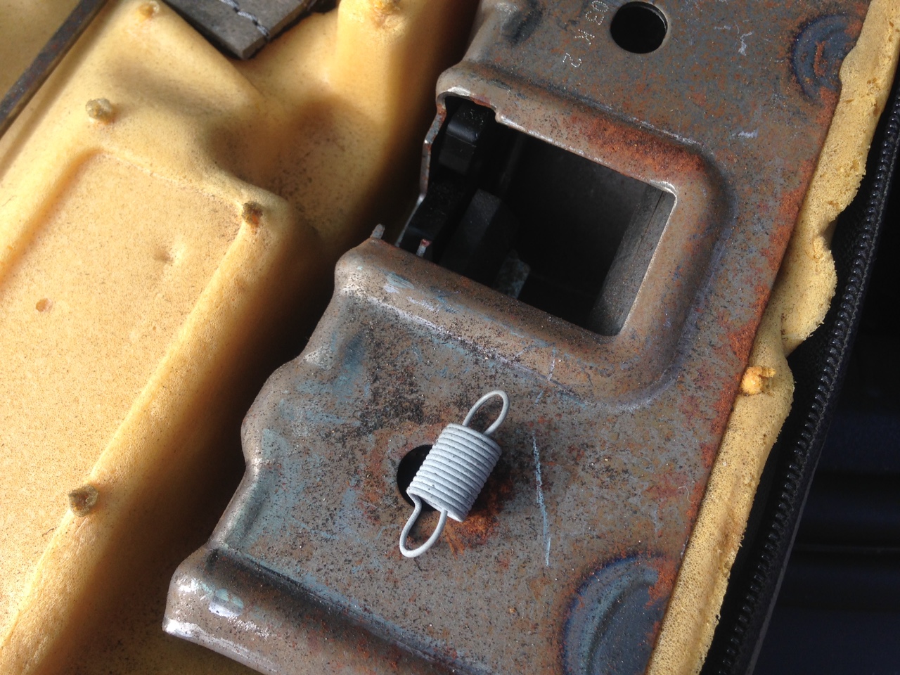

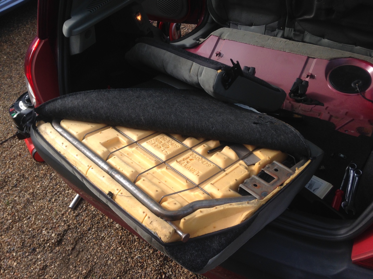

Next was the rear bench: the long part wasn't clipping back in position when upright, something wrong in the latch mechanism maybe?
Gut the back first
Obviously the winning rate was too high from the wipers job so the car said f**k ya kunt
But I was determined and found the culprit
c**ty spring had come off its pegs, thankfully it didn't get lost in the car
Good job I had another seat to take inspiration from
Yas!
Double win, it hasn't happened in years.

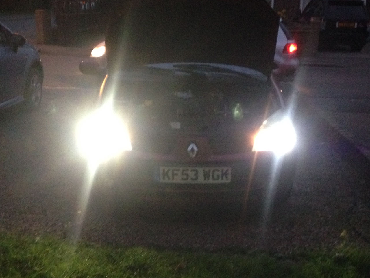

The other day I fitted those bulbs I was talking about and yes, they definetly make a difference but I'm still not convinced about the auto dimming, I'd like to be able to do it myself !
They are Osram Xenarc Night breaker unlimited d2s, got the for £60 on eBay.
New one on the left of pic
Pleased with this.

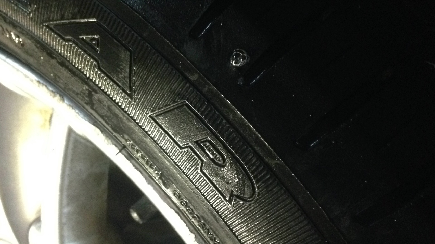

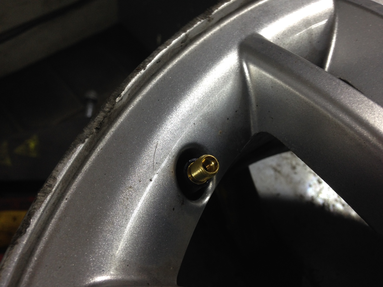

To finish this off, I realized why one of the tires was still low after all that work changing it and surprise..
See those bubbles? Yup, not repairable.
I've asked the seller if he could supply a matching tire otherwise I'll have to find it myself or whack an inner tube in it.

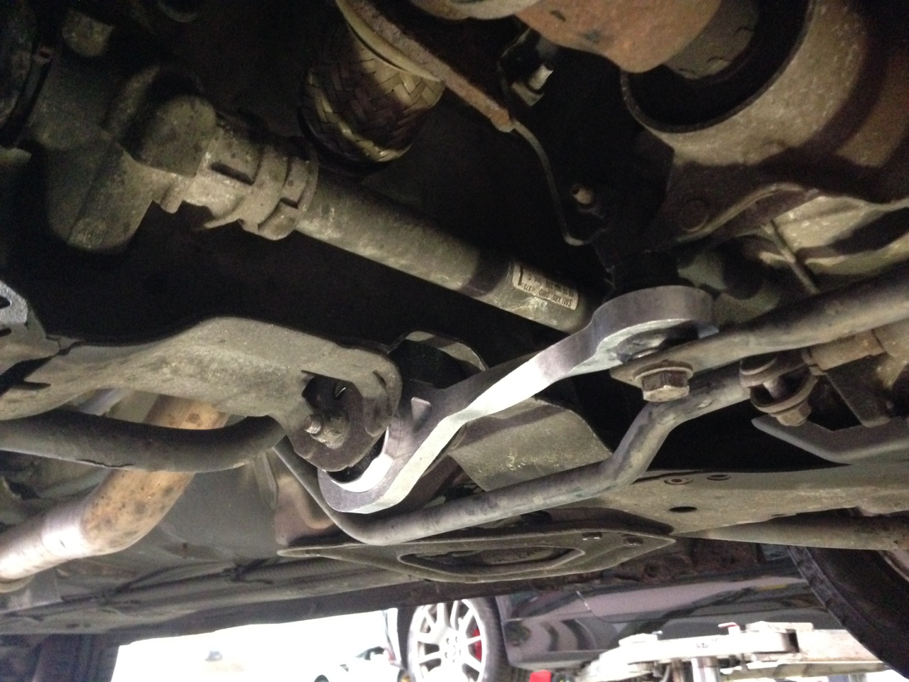

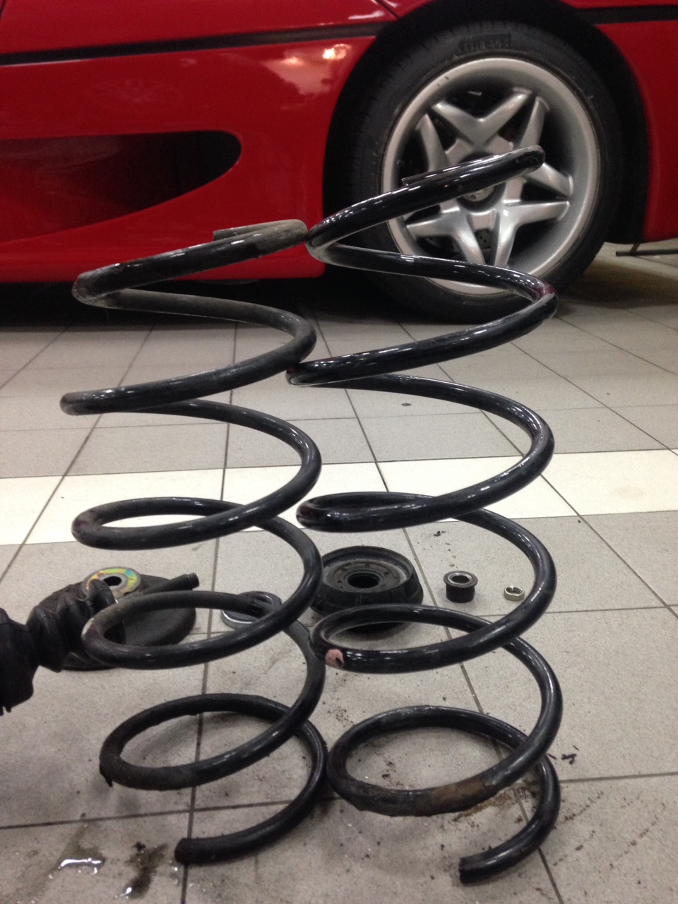

The only job worth reporting is the addition of a new engine torque mount, people call it the dogbone lol
Genuine Renault part paid 14 quid and some change.
Didn't improve much but there's definitely a difference. Better than nothing.
I fitted an inner tube in the punctured tire as a traditional puncture repair was not possible. I wouldn't fit an inner tube in a tubeless tire either but I had no other tire to put on and I'm currently in the hunt for a matching good year because that's the only way I roll.
On its way is a used driver side damper complete with spring and top mount that I bought with the only intention of using the top 17mm nut to correctly secure my new shock, I'll keep the other bits as spares; £15 from renparts, not bad.

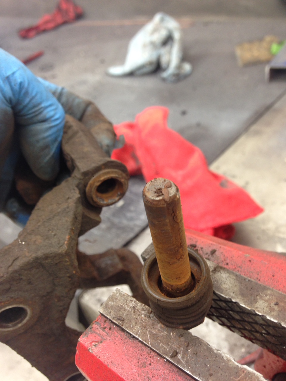

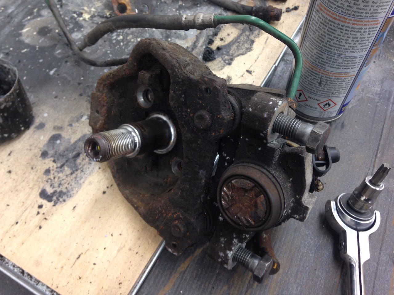

The broken bolt of the last post has been drilled out and the threads repaired. New bolts and fixed rear bench back in, happy.

I picked up a used bonnet as my old one was absolutely shot, plus they tried to bodge it with some oxy primer and the wrong shade of red.
Paid 30 quid for the "new" one, is not perfect but at least the front of the car is all the same color now. Oh and the headlights got another polish, getting closer to acceptable.
A couple of weeks ago I bought a spare strut with top mount for like 12 pounds off RenBreakers, only to use the correct retaining nut for one of my aftermarket shocks. Here it is
Now the two front dampers sit almost the same way. The car still leans on the driver side strangely but I kept the spring off that used strut, I'll compare it to the one that's on now and see what's what.
I bought some mist washer jets, the Citroen/Fiat ones that everybody talks about. Well, they spray way to low, so I cut some rubber wedges and boom, they're spot on now, I'll buy a different set in the future.

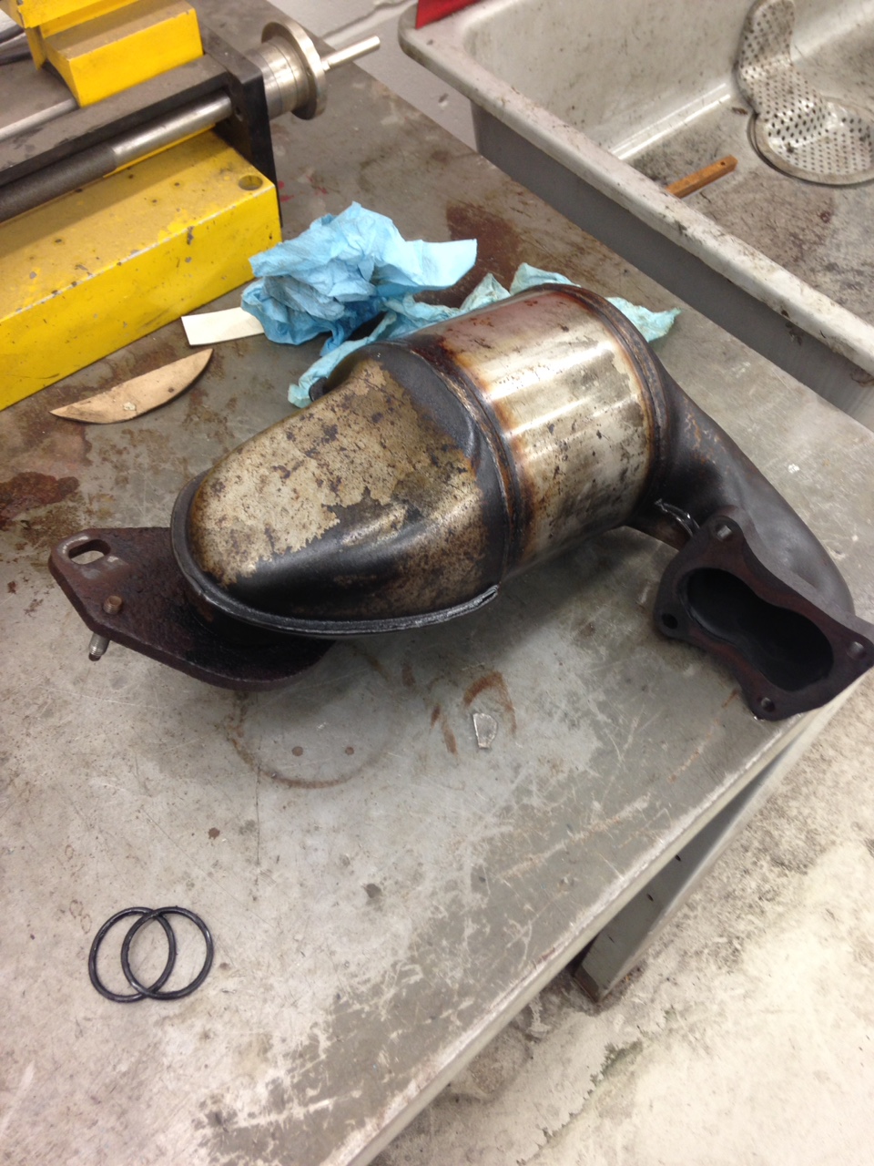

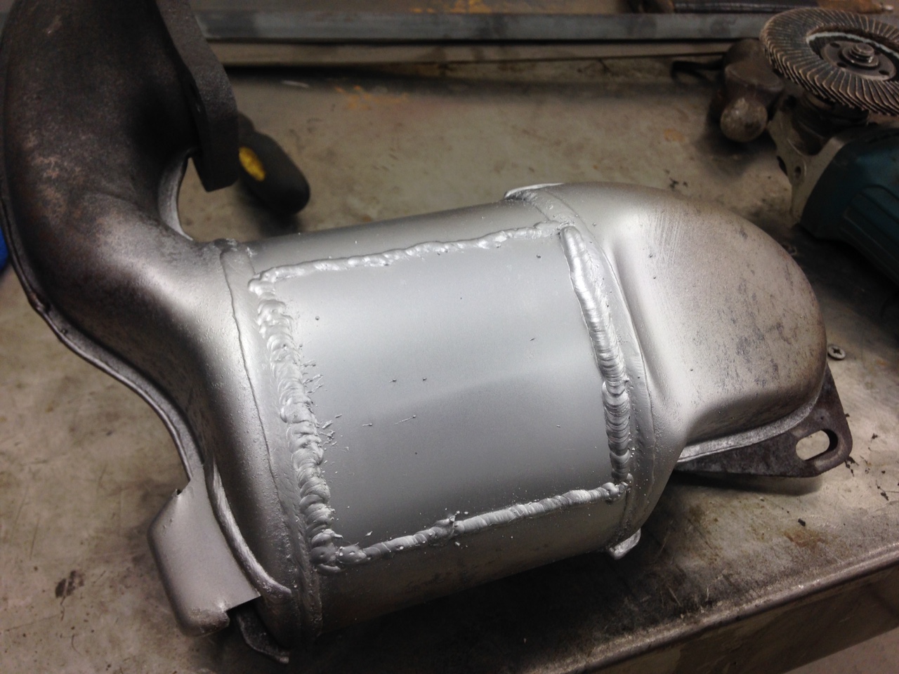

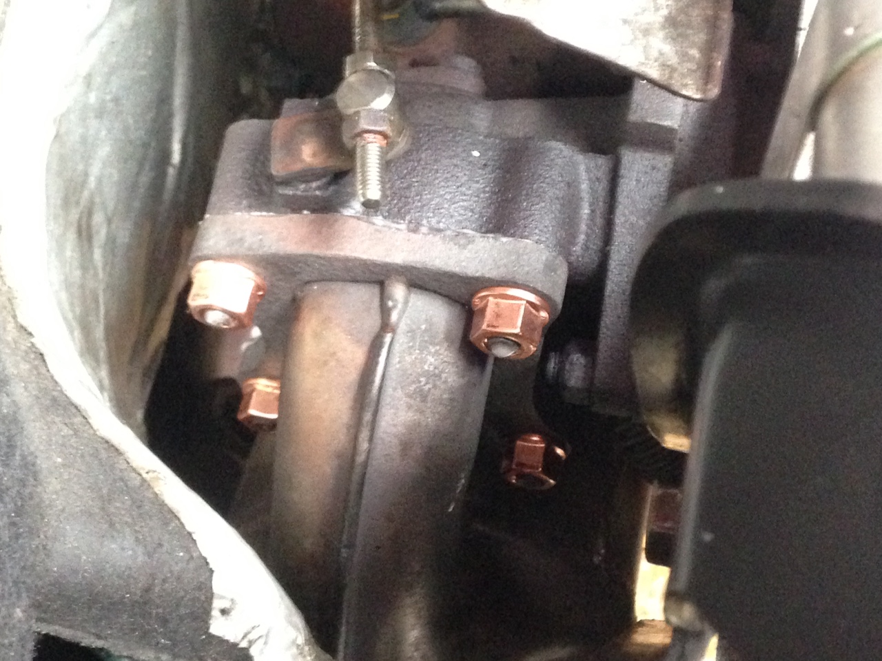

Today I had some time and some tools to play with so I decided that I was time to get dirty and gut the catalytic converter
I can't believe nothing broke during removal, not a single nut.

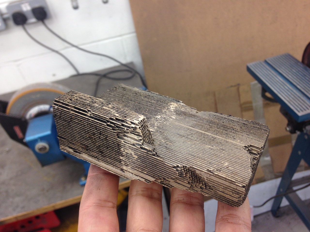

Here's the cat after surgery
And this is what was inside

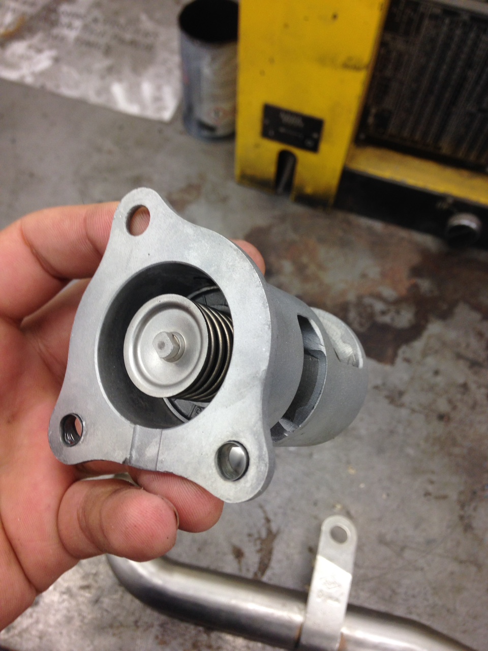

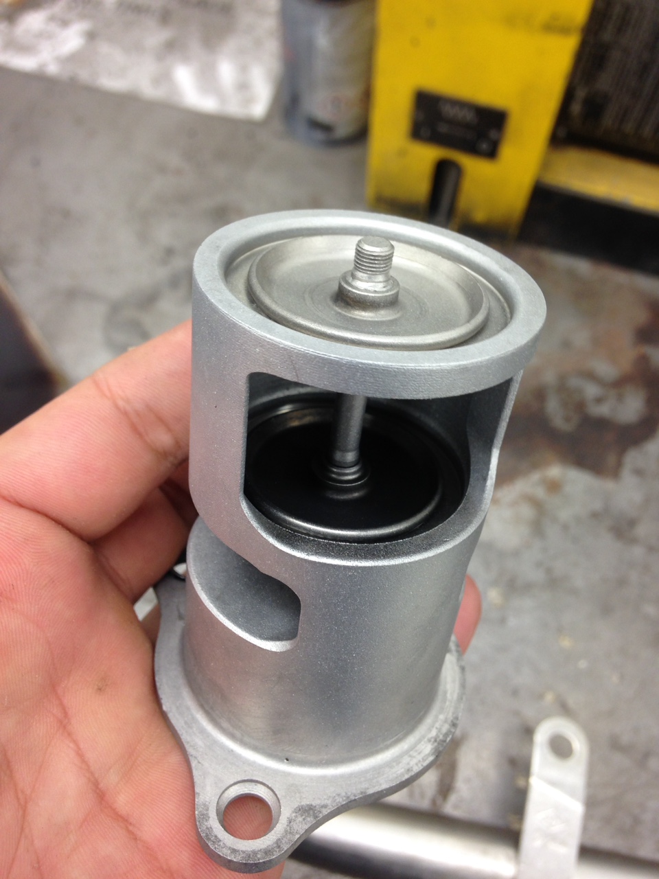

While doing this I decided to have a look at the egr again and try to fit a blanking plate that I bought a couple of days ago.
The valve was quite sooty and this surprised me, as I only use v power diesel and its only been a month and a half since its been out for the first time. Oh well, cleaned up again
Same goes for the cooler pipe
I then found out that the blanking plate would not work for my engine, and so I tried the old trick of flipping the valve upside down, and I had to grind one of the holes for the bolts as it came in contact with the shoulder in the cooler pipe housing.
Well, I have no vacuum leaks and it seems to work pretty good.
Cat back in with new bolts
And driveshaft back in.
Once you know what you're up against is not as bad of a job as I thought it was going to be.
I do feel quite guilty for what I've done, I do my recycling religiously and I've just emptied my cat ?? I'm a little s**t.

As per how the car actually goes with gutted cat and blocked egr: the throttle response is much smoother, there isn't that annoying "step" that I tried to cure with the new torque mount, or maybe there still is but it's much improved. You can hear the turbo spooling up from low revs and there no smoke at all from the back.
Performance wise, it's a 1.5 diesel.

I said I was going to compare a used coil spring that I got with a spare strut with my osf one and I was right, mine was shorter, a lot shorter
So I swapped that on and the car finally sits at the same height from side to side, I can finally get it aligned!
The play on the top mounts has been drastically reduced with the new shocks, and with the correct nut fitted on the osf one it's even better.
Last Saturday I had to remove the bumper to replace a washer jet that must have pissed off a dog at some point..
There are easier bumpers to remove I must say. It felt like a lot of f**king around for a small thing. It's done now, happy headlights.

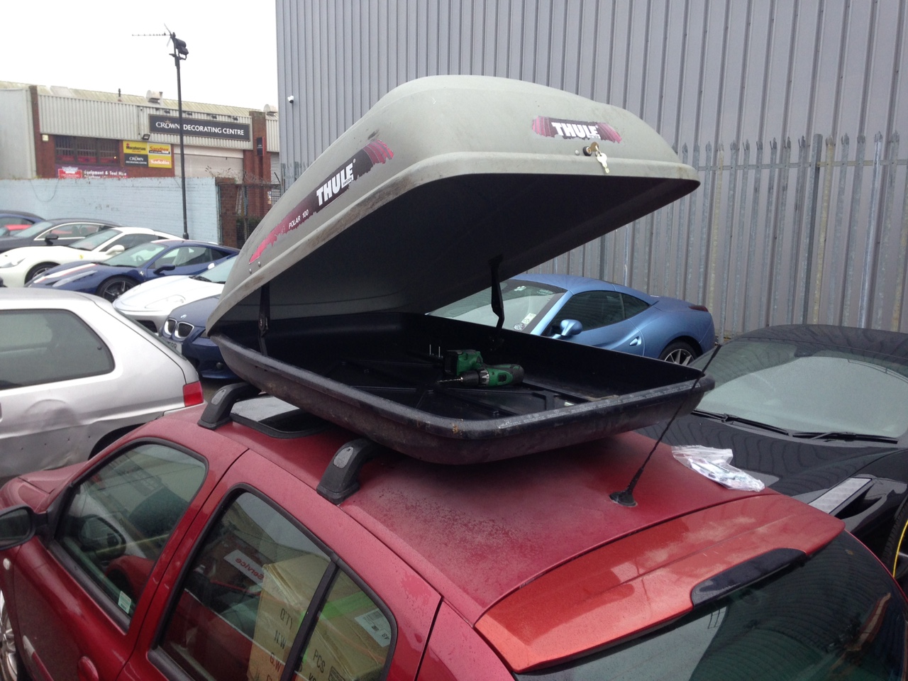

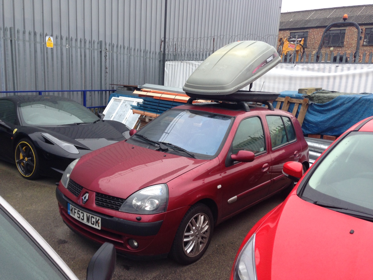

I then finally fitted the roof box I got, makes the car look like a multipla and rumbles like f**k at motorway speeds, but it should swallow all our bags during the Christmas holidays, so good times

As for your roof box rattling around it could be a number of things
1) Items in the box - try laying a thick blanket in the box first.
2) not being tight enough to the bars - try a few washers
3) the box is clanging on the bars - try a few rubber washers.
To be fair, it’s not the most aerodynamic roof box so it may be the wind noise that you’re talking of, if this is the case your best bet is a wind deflector. Then you really will be weird :up:😂

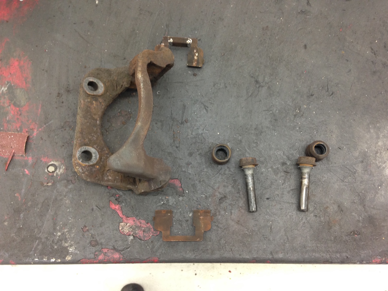

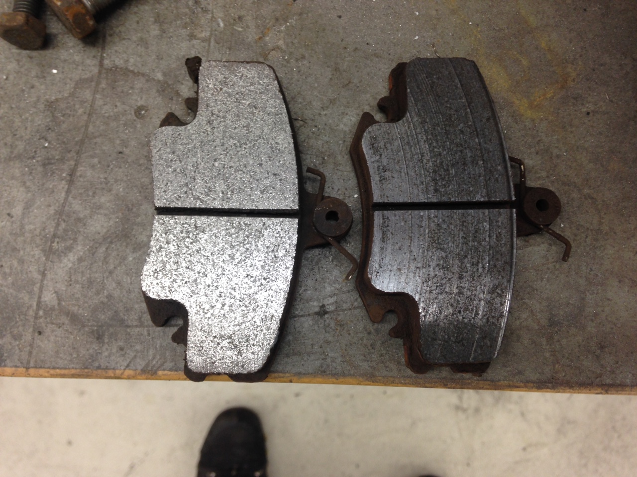

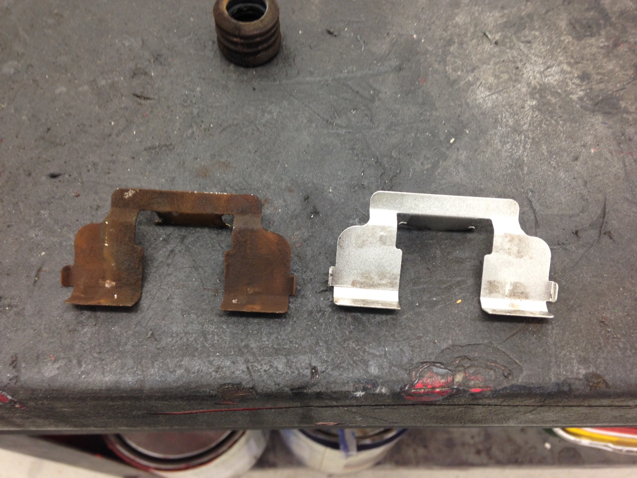

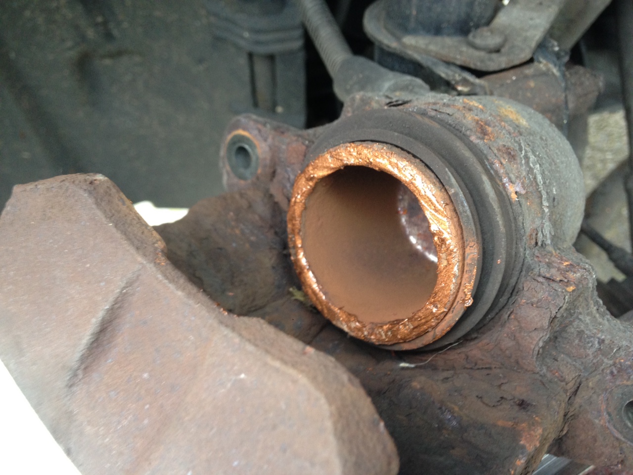

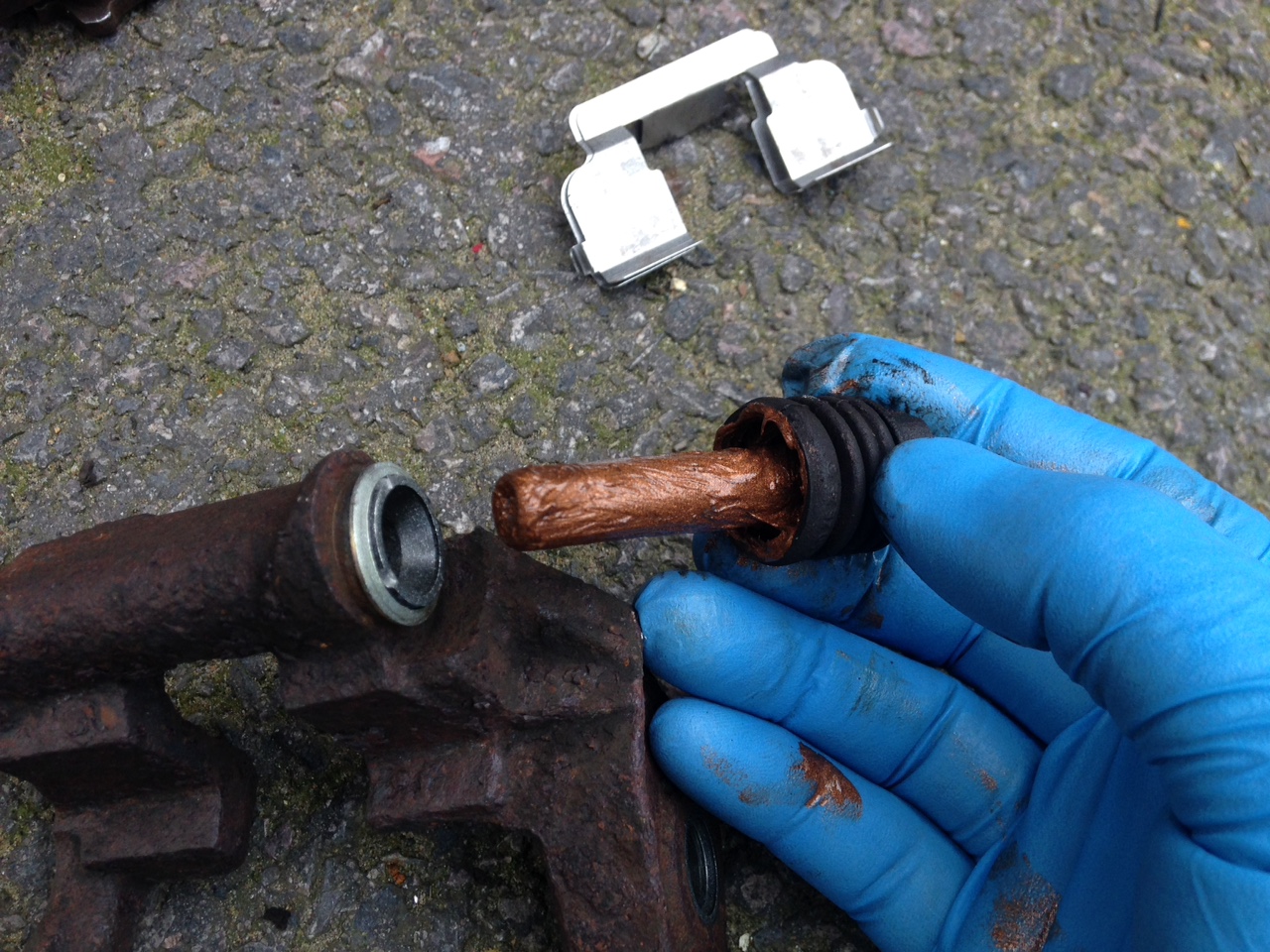

Let's start with the brake job; what I'm about to show you is not scientific and some people can judge it plain wrong, but it has worked for me in the past when I needed to restore some "bite" in the braking system without changing any parts. I did have a genuine reason to take the brakes apart and I wanted to see the condition of the pads.
Here we go, parts on the ground

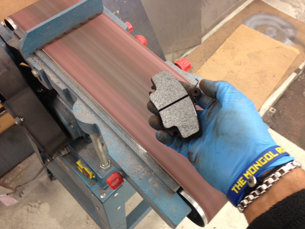

My goal was to clean up as much as I could from the caliper carrier, clean all the bolts and grease where needed, swap the discs left-right and swap the pads in-out. Yes, this can lead to vibrations at first but, at least for me, has always done more good than harm if this makes sense for you.
On the left, brake pad after belt sanding, the right one is still grooved
Then the carrier was disassembled
Those pad seats thinghys got a nice blast in the aquablaster
Slider pins in the parts washer
New load of grease in the boot and all over the pins. 3M silicone paste works best here, I didn't have it.
All partially assembled. I also blasted the caliper carrier but I soon realized it was gonna take too much time to strip it all to bare metal, another day. Some black paint to protect the bare parts and on it goes
Good old copper slip on the piston and also on the other side, that should kill the squealing.
Rinse and repeat on the other side lol
A shot of the other set of pads, right one not done yet, see the difference ?

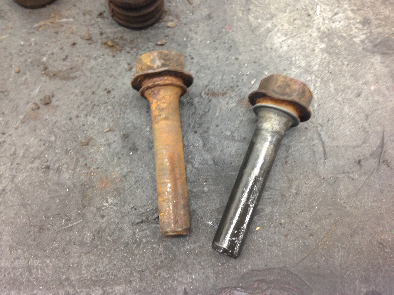

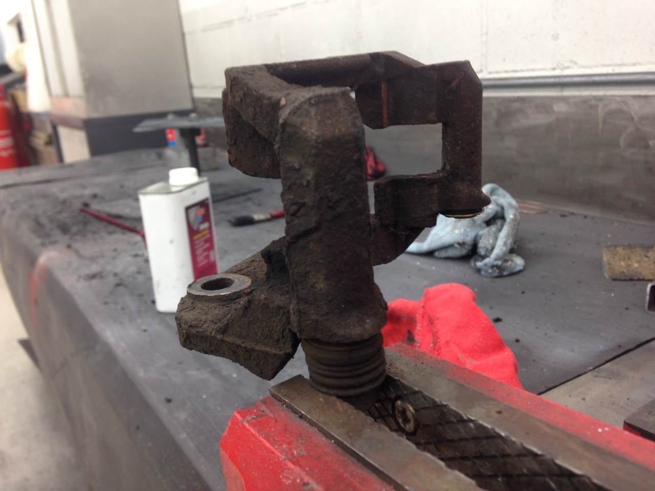

Finally the reason I did all this for: a stuck slider pin, excuse me miss vice..
Success, no heat or penetrating oil needed. Badass.
Comparison with the other one, fully working. They both got a sandblast and proper a proper grease up.
Yes, new genuine trw pads are 15£ on eBay and discs are not much more than that. But there's plenty of life left in these parts and I'm now feeling better about the front brakes, lovely jobbly.
Then it was time for the winter tires to go on. I have no experience with these but I'm going on a skiing holiday in new year so I thought I'd give them a go as they're mandatory where we're going.
I was going to get just two but ended up buying a full set to be legit. They came on some Mazda 2 steelies that I'm trying to sell, and I paid 80 for the lot.
They're continental winter contact ts790. Dot 2011 so they're surely not new but there's a s**t load of tread left and I'm hoping that being a top brand they won't be as bad as any other 6 year old tire. Fingers crossed.

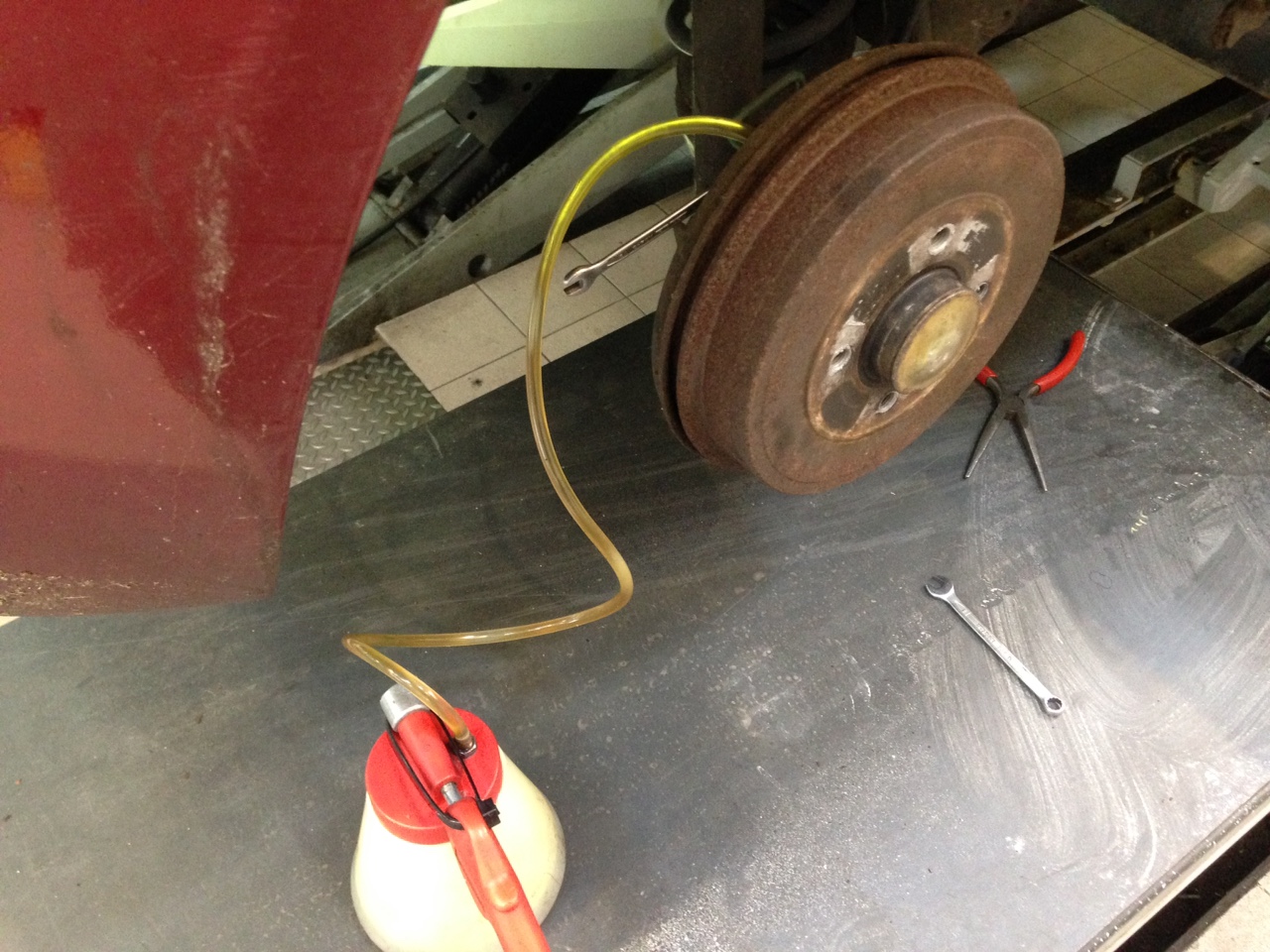

I finished off the day by changing the brake fluid and bleeding the system

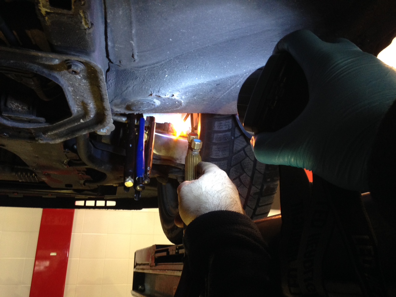

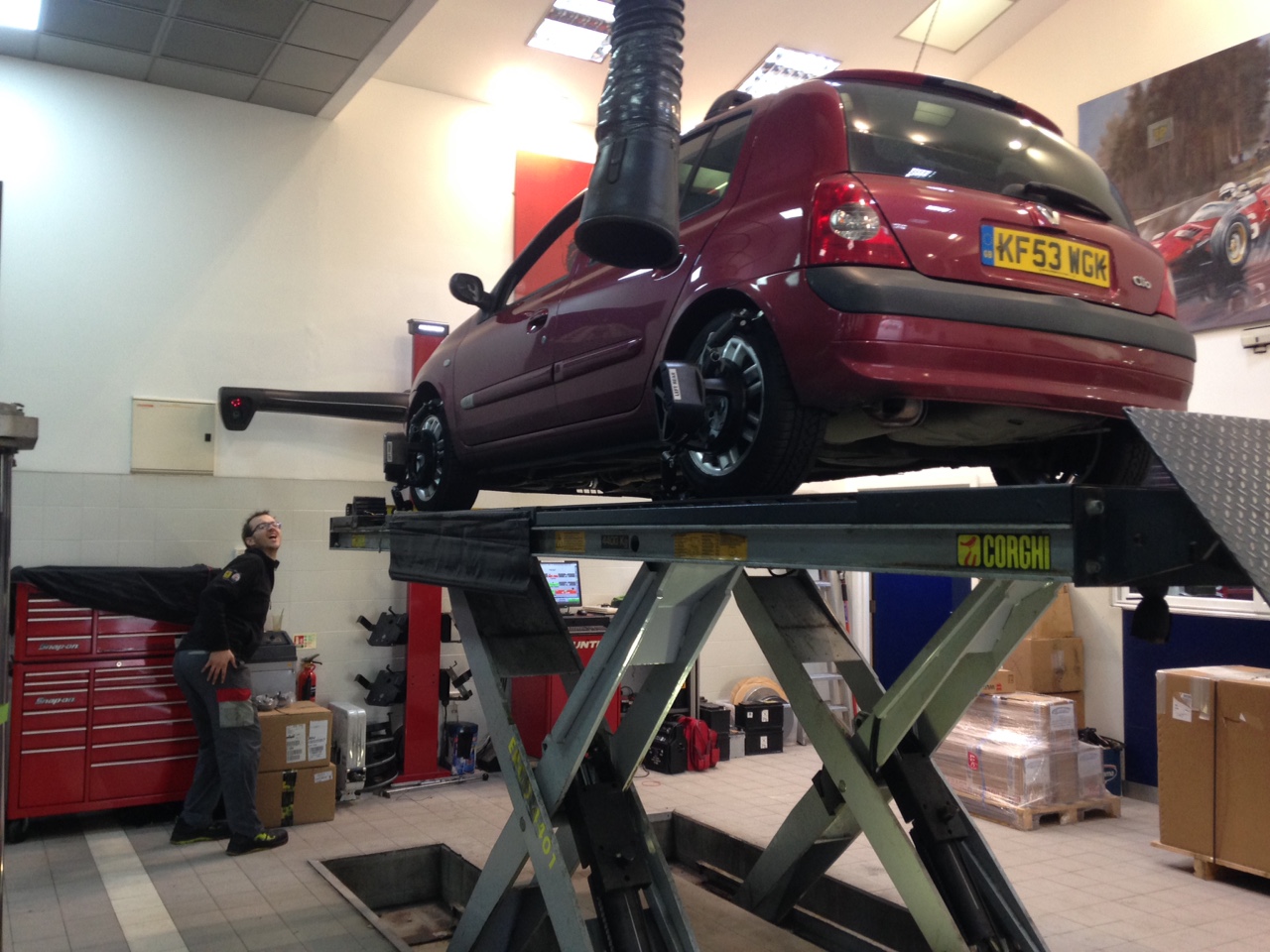

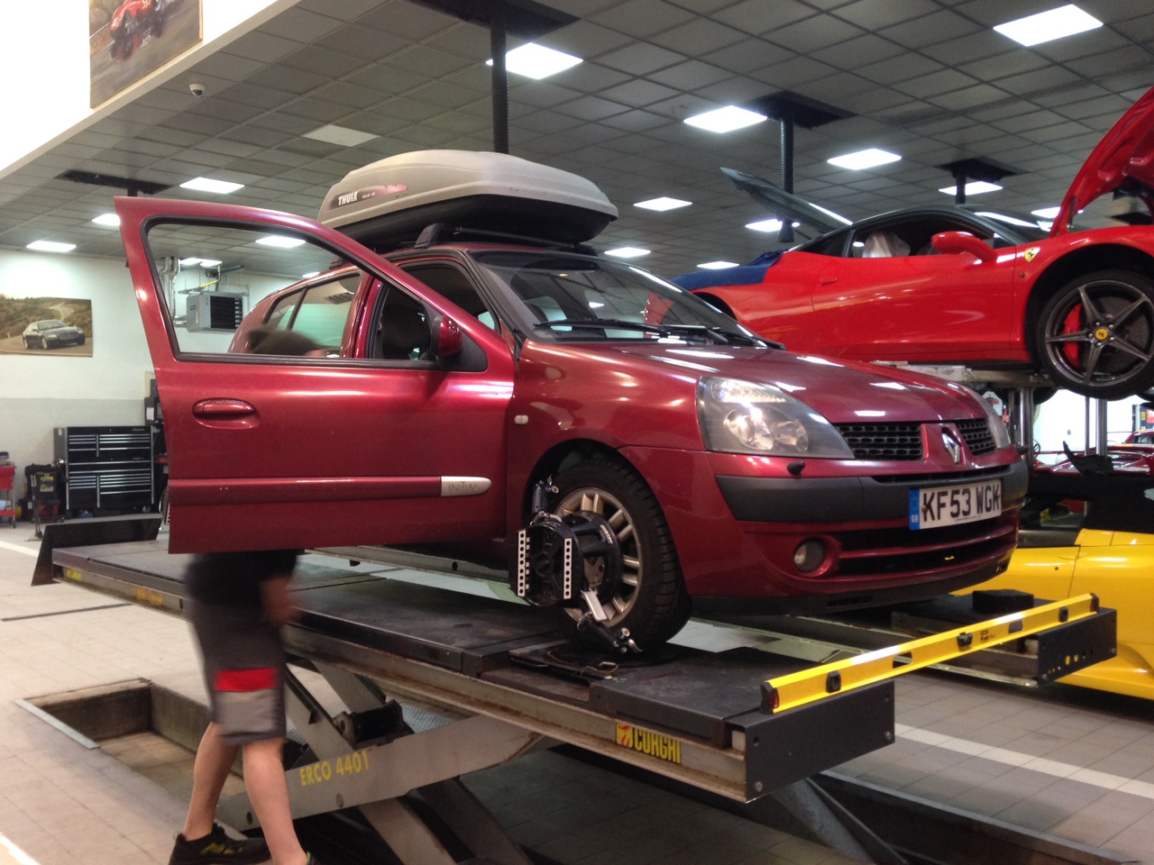

I left the car in the hands of a mate with the task of aligning it, good luck with that..

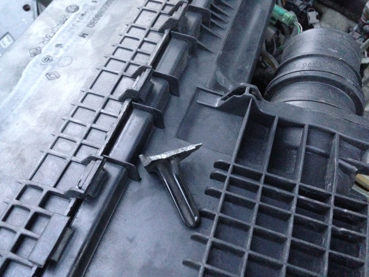

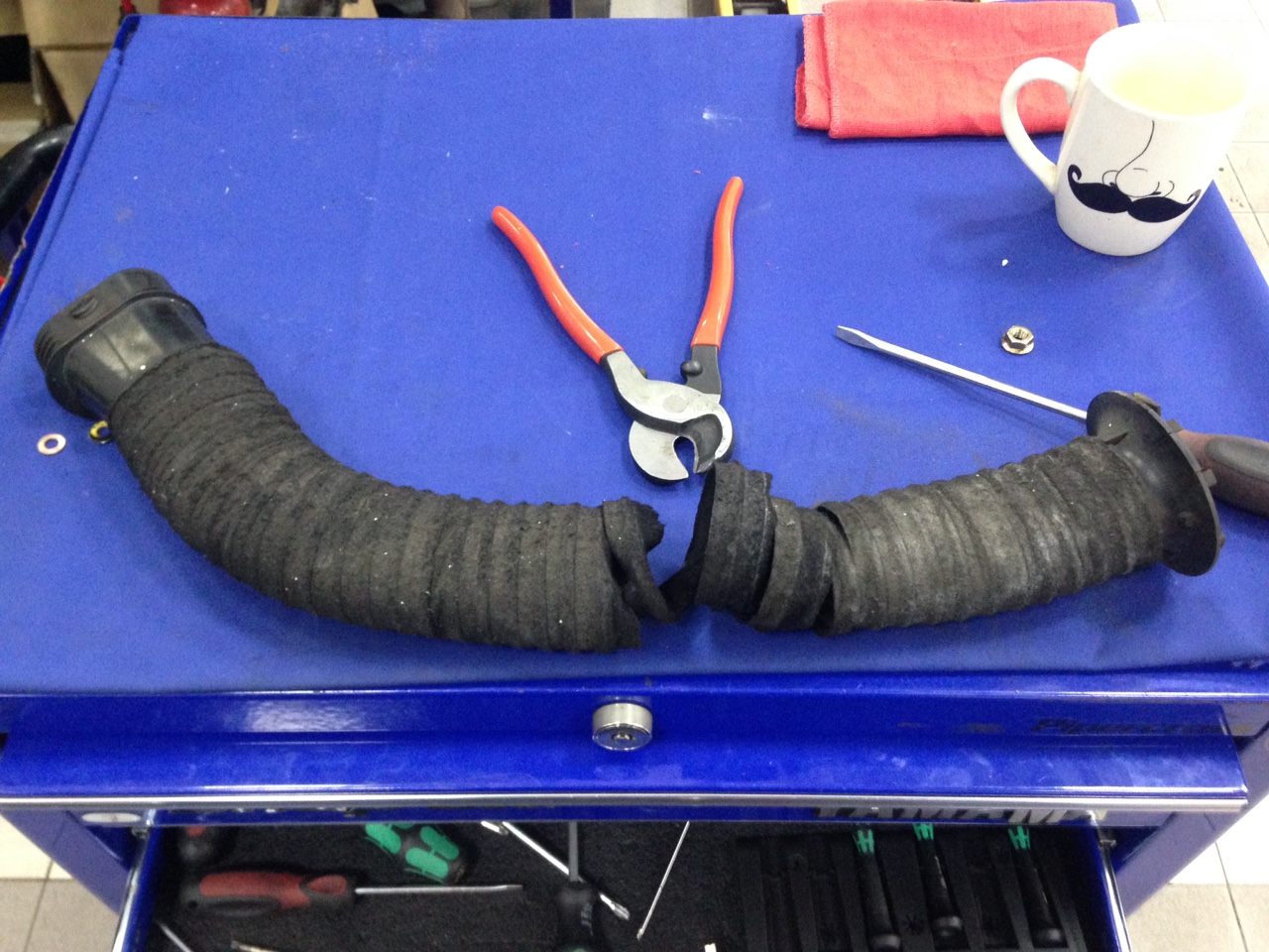

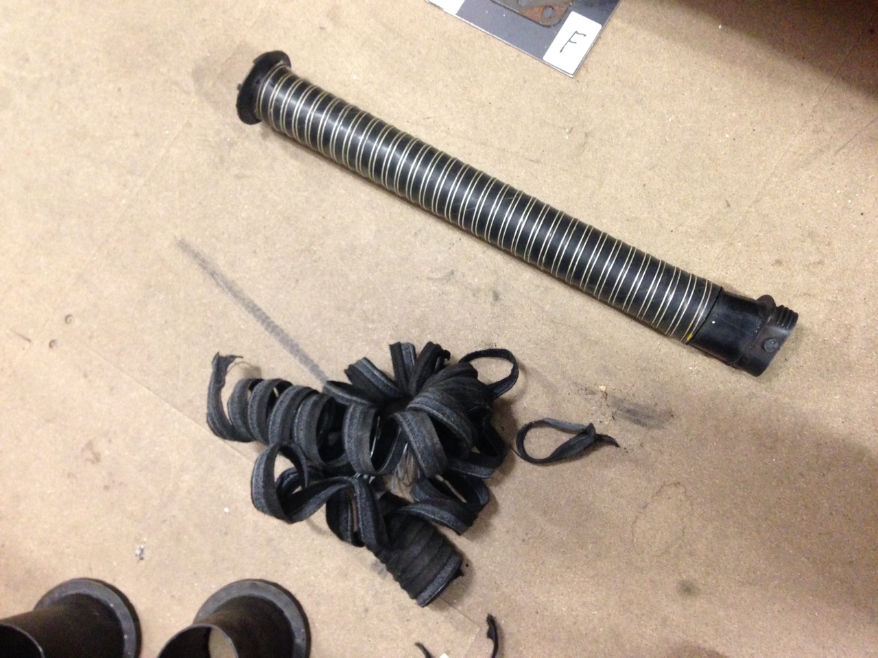

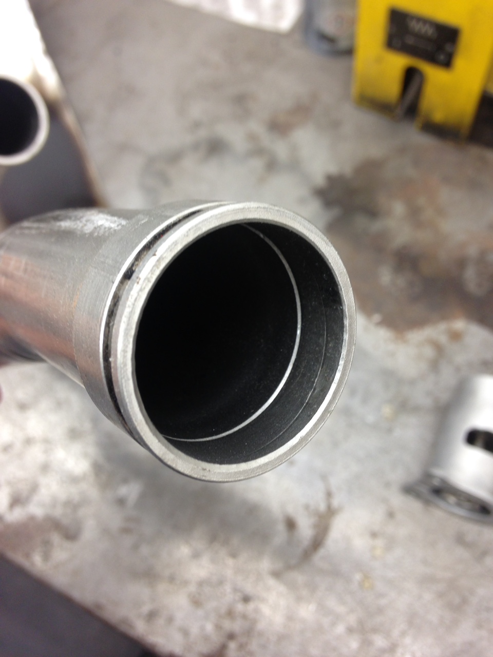

In the meantime I tried to fix a broken inlet pipe, picking from my stache of what we call "donkey dick"..
At the same time I repaired a broken peg in the air box by salvaging one from a spare that I bought
Champ.

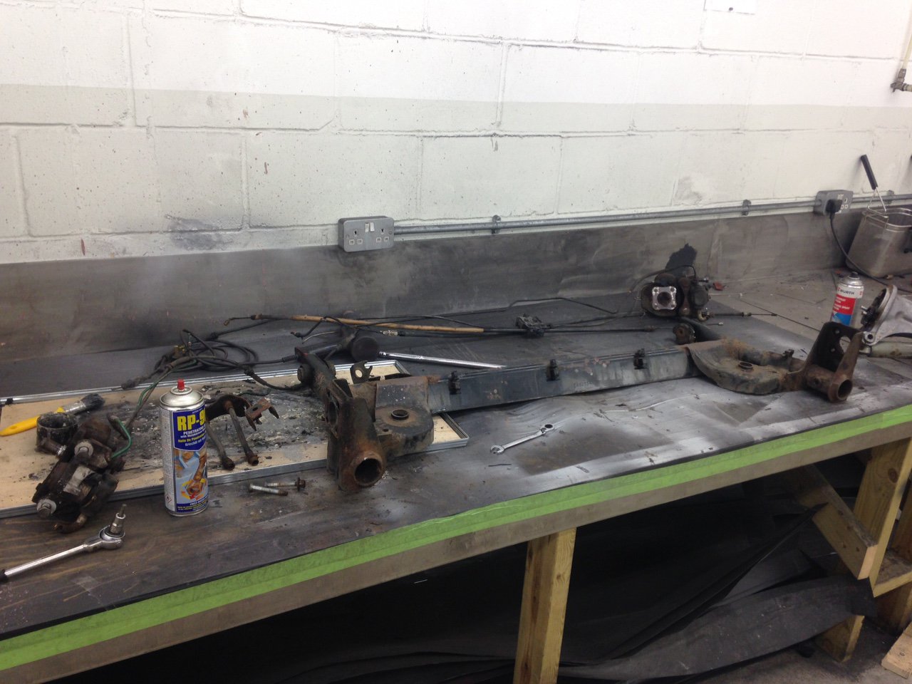

It turns out the car could not be aligned. The inner tie rods were glowing red but still wouldn't want to turn, and the alignment ramp leaves not much room to work, I'll have to spend some more time with some more space to work to get it to release. For now I'm gonna have to make do with 6mm toe out in the OSF and that pisses me off.

Then it was motorway time, a long 470 miles trip to bingley to pick up this
A complete 172 rear axle with disc brakes, abs and all the handbrake linkage. It will need some work before going on the car but for £45 can't really complain, I just hope it's not bent but will get the tape measure out soon.

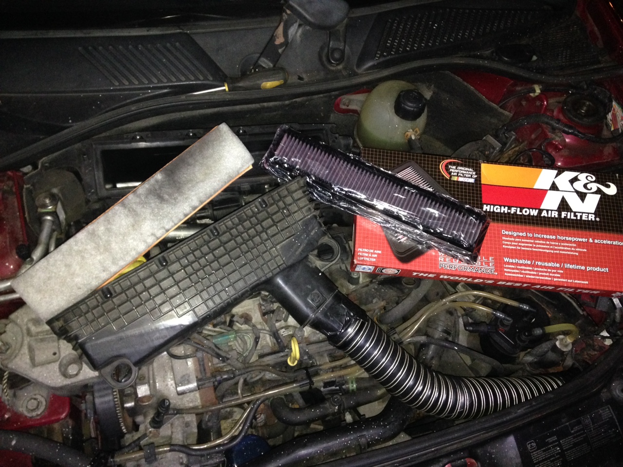

Before the trip the only upgrade worth mentioning is the addition of a k&n air filter.
Totally unnecessary but it was so yummy at £30 that I could not resist.

I crossed the channel via ferry this time, I was in no rush and it was cheaper, like half the price lol
Then it was a long night, calling everybody I knew to stay awake and do some chatting, but at 2am I called it a night, very little one, as I only slept a total of 3 hours sitting down as I had the roof box inside the car and felt too tired to put it on the roof.
When I woke up I drove another couple of hundred miles and finally reached the alps for the first fuel stop.

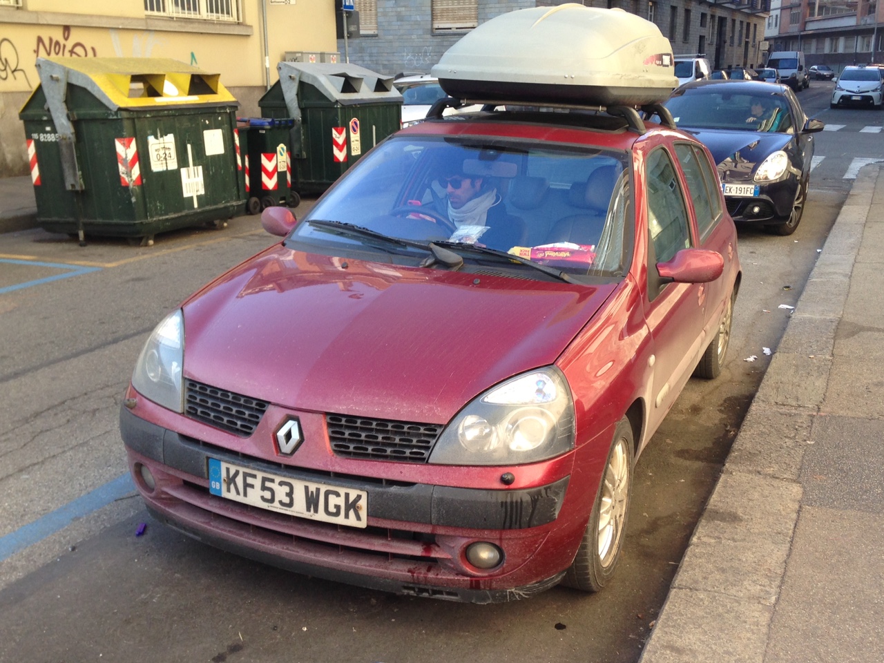

Once in Turin, at around 10:30, I met with my brother and we mounted the roof bars and box on top, and filled the box with all our junk to leave the boot at our "guests" disposal.
The car looked very far from home judging by the amount of dirt and salt on it. I like that.

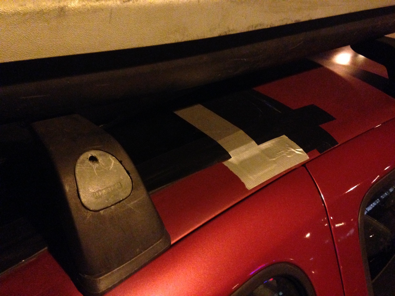

The first miles with the box on top and the car fully loaded soon revealed a fault, in the form of a massive amount of wind noise! As written before, I thought it was just part of the experience; the car is not designed to have a box on top and the box itself is not the most streamlined thing out there.
Part of that is true.. if only the sunroof closed properly! My brother infact pointed out that most of the wind noise was caused by the sunroof not pushing down on the gasket enough to isolate the cabin from the outside noise. Here's the solution:
We only had to stop 4 times (lol) between Turin and Rome to find the perfect combination of duck tape and speed, and after feeling very embarrassed and tired, we made it to Rome and later to Naples, to stay with our family for a couple of days.

Boxing Day was mostly spent driving, this time in the other direction: Rome, Vercelli, Turin, and finally Chamonix, in the French Alps. No pictures but this is when the car was loaded beyond its design figures. No rear suspension, full on "Italians on holiday".
The next morning we woke up in Les Houches, lovely small village in the valley of Chamonix, in the shadows of the Mont Blanc.
The car was nice and frosty, -5, not the end of the world.

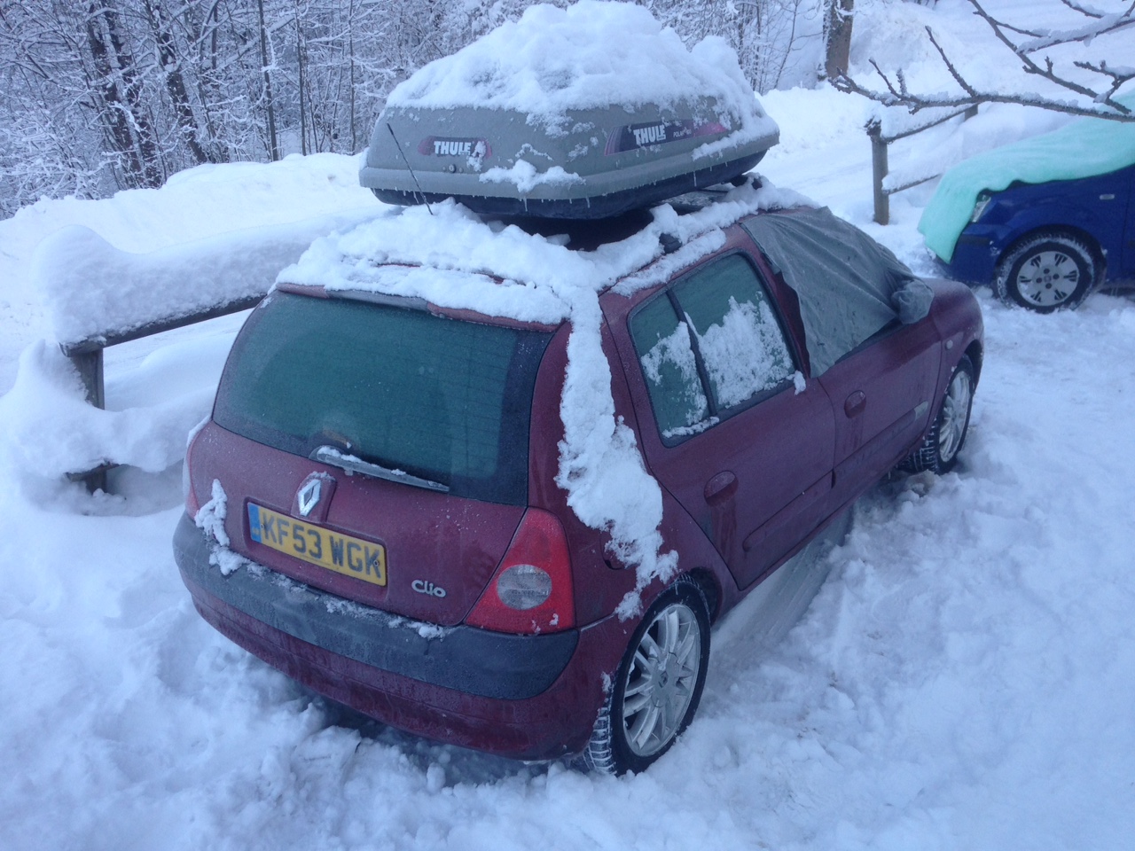

The snow gave me multiple chances to test the winter Continentals. They worked, of course they're not snow chains but they did the job, only once I had to reverse the car uphill because it wouldn't climb driving forward. All the other times the tires did great, you can still slide and lose traction but I never felt without control. A back to back test with normal tires would be the best thing to compare the driving feel.
Anyway, second and third day were a little bit colder: -14, and the most difficult cold start to this date with the Clio, I'll post a video soon.
We even snatched a Vivaro out of a ditch !

Today I finally freed up that stuck tie rod and the car could be aligned. The rear axle is out, strangely, but I'll have to go back there when the 172 axle will go on, and that's the next thing.

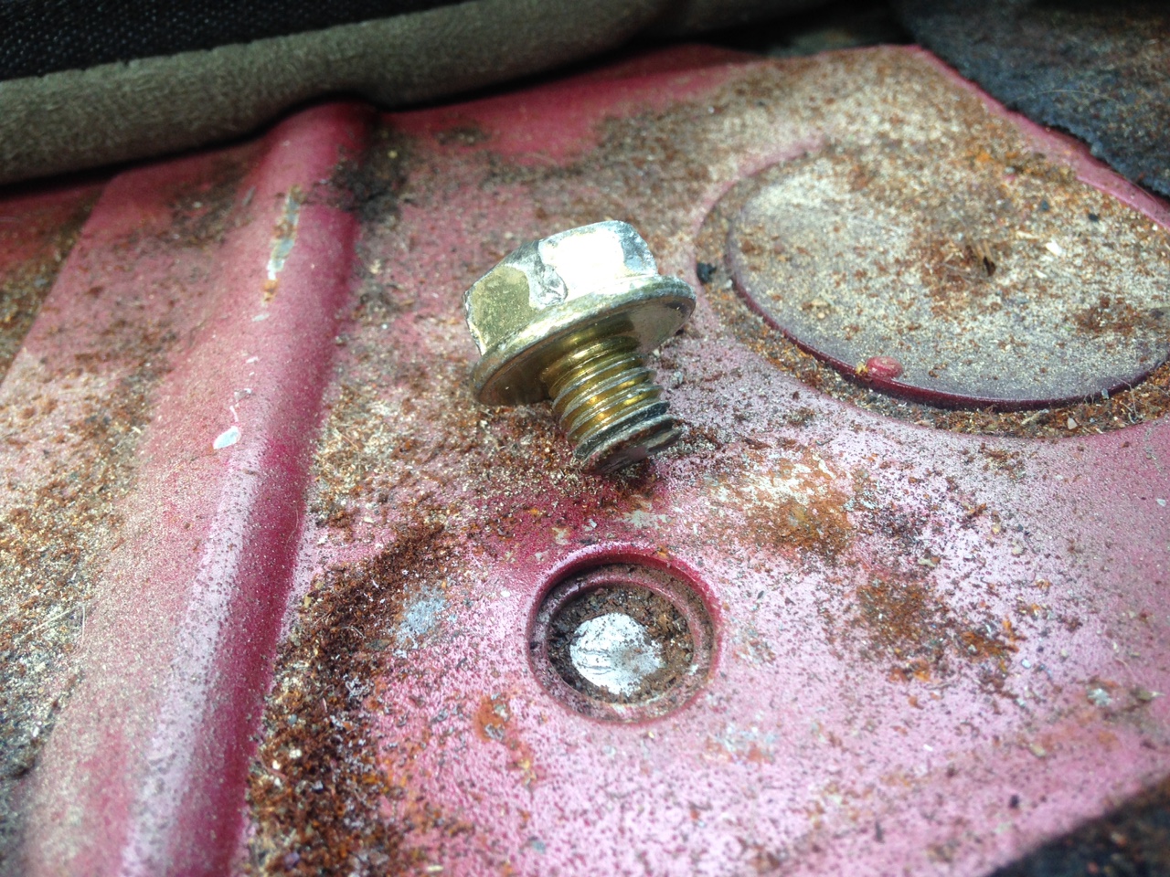

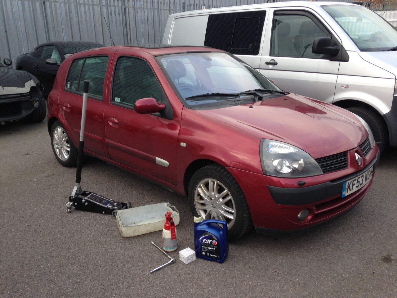

Second oil change in my ownership, I've done about 6500 miles from September, it was time. Same exact stuff off last time, Elf evo 5/40 and genuine filter. I even cut open the old filter just because who knows, I've heard these engines like to chew through big end bearings.. I couldn't find any badness, yet.

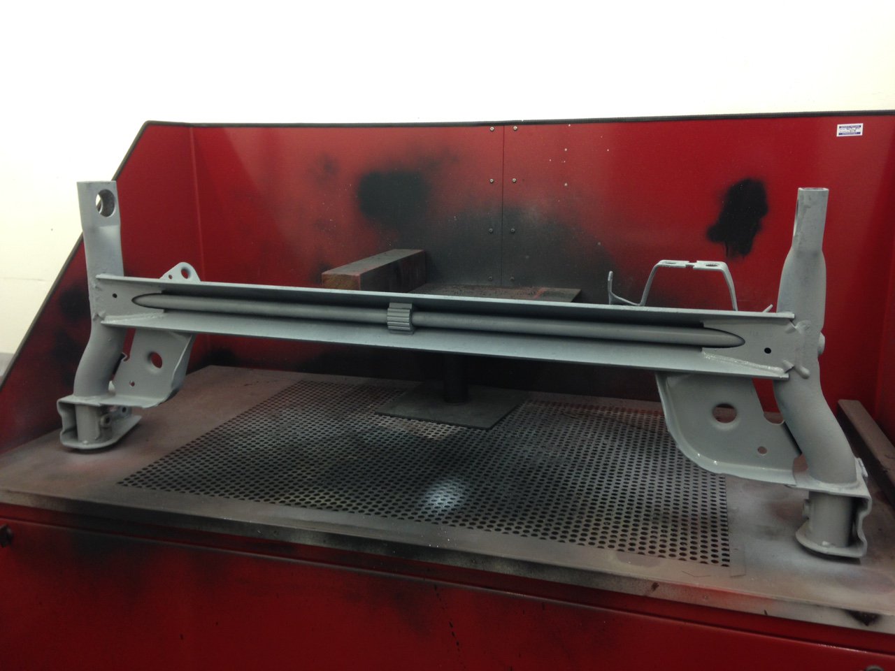

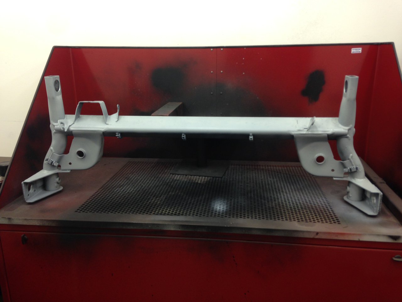

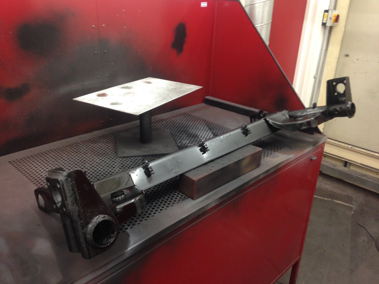

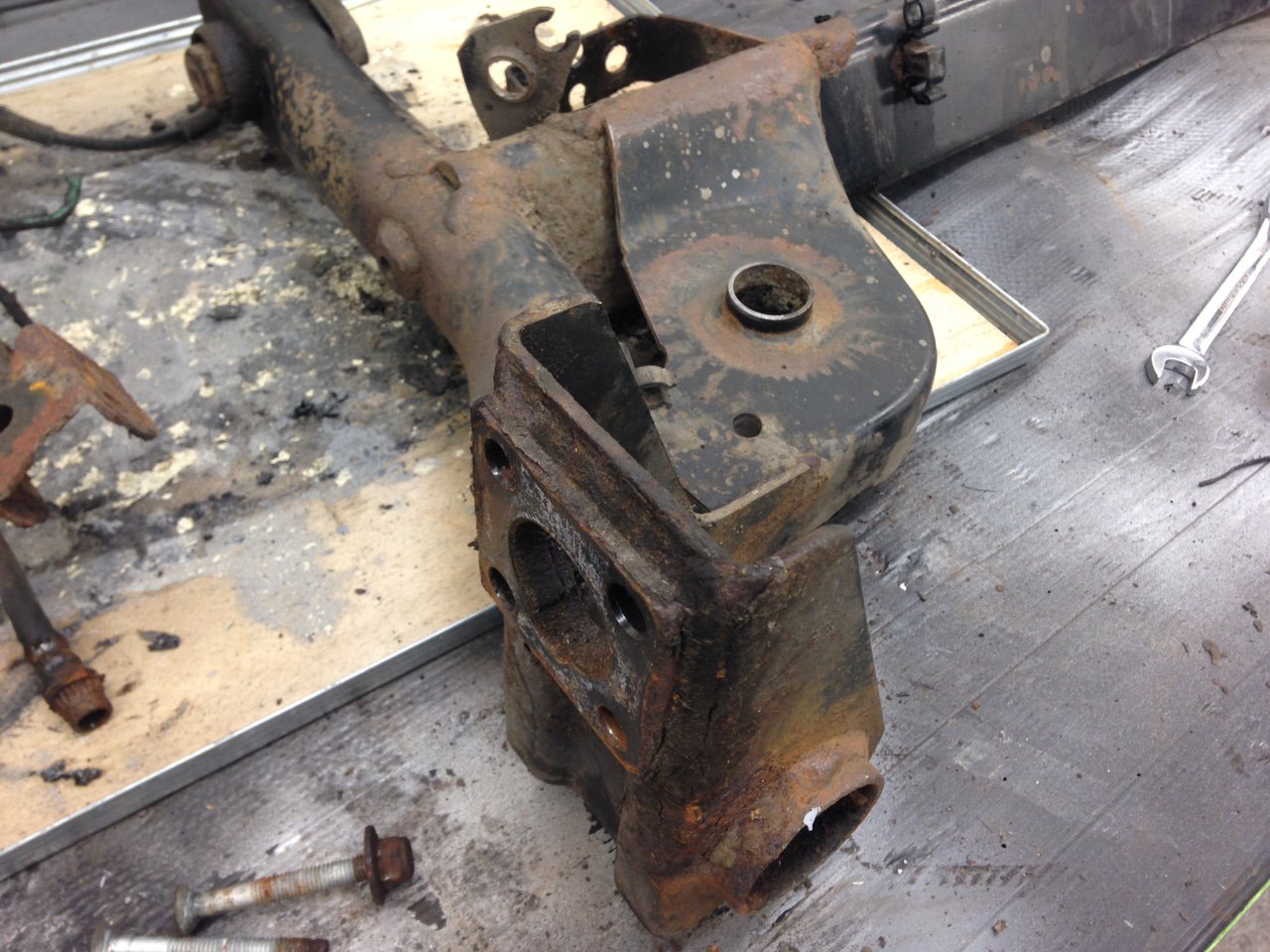

The more I looked at that 172 axle the more I wasn't sure wether to leave it alone or go full on overkill rebuilding and painting the whole thing even if the calipers are free and nobody will ever notice the difference.
I decided to go full overkill, that's me.
Remember, £360 clio..

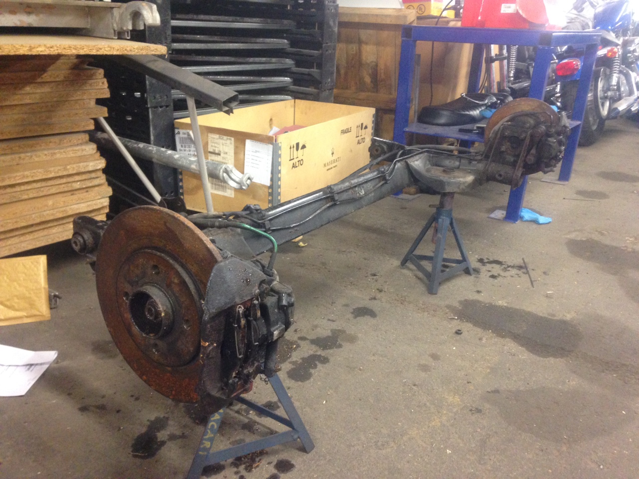

Here's the axle and some of its components before stripping

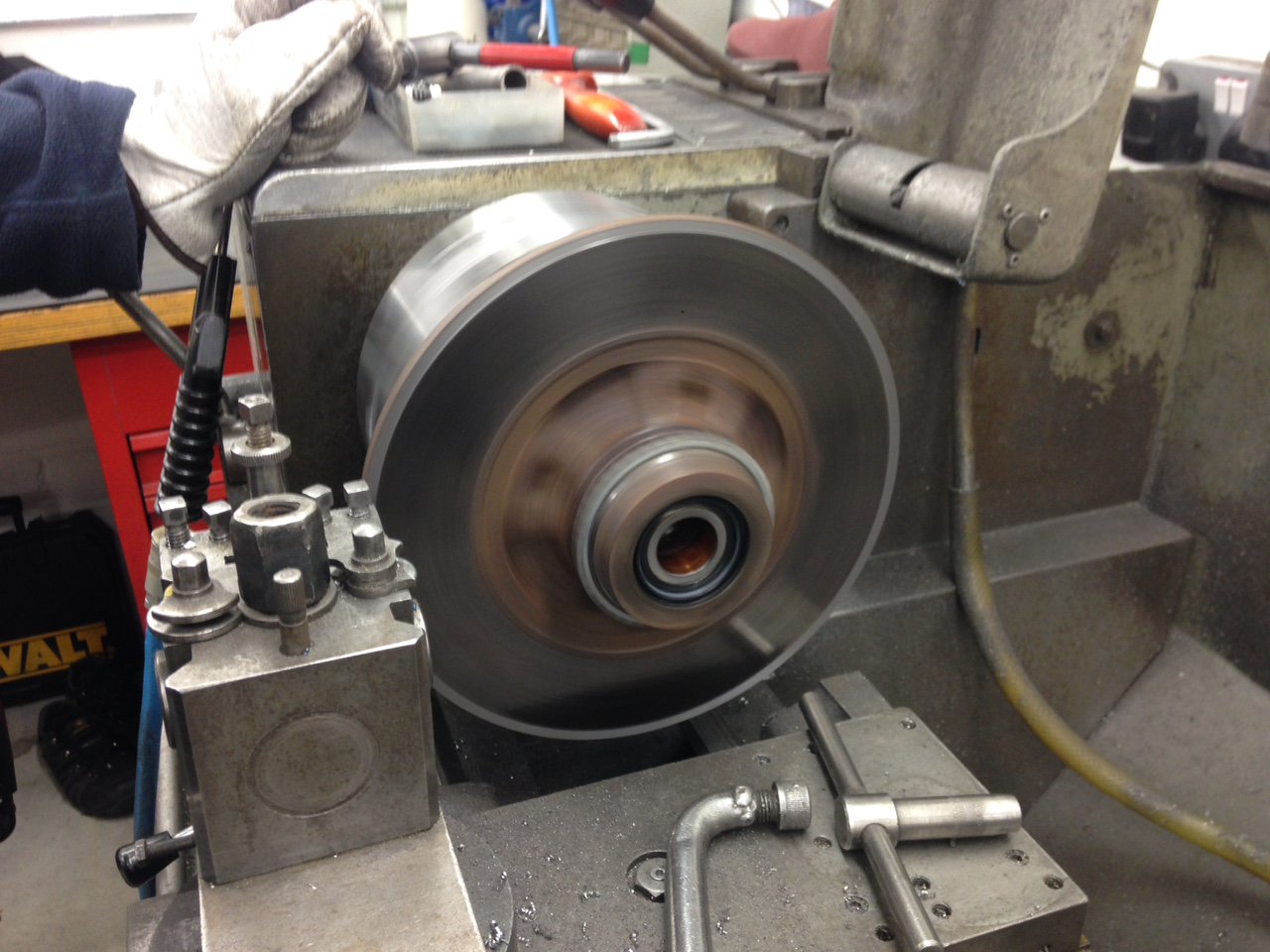

The discs were already off, I tried some ghetto machining with the lathe. They're now borderline at 10 mm dead, I'll see how many miles I can get out of them, they're only rears.. (he says..)

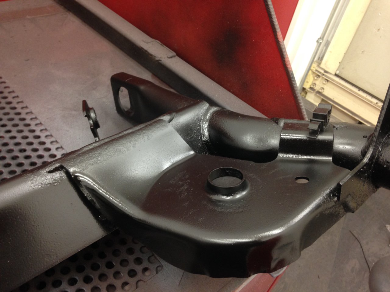

The bare axle then got some good wire brushing and even some sand blasting, then it was off to the paint room
Four coats of primer, 4 of Matt black, 2 coats of clear for peace of mind.
Will be pressing in some new bushings I got as soon as a colleague finishes his version of the Renault pressing tool..

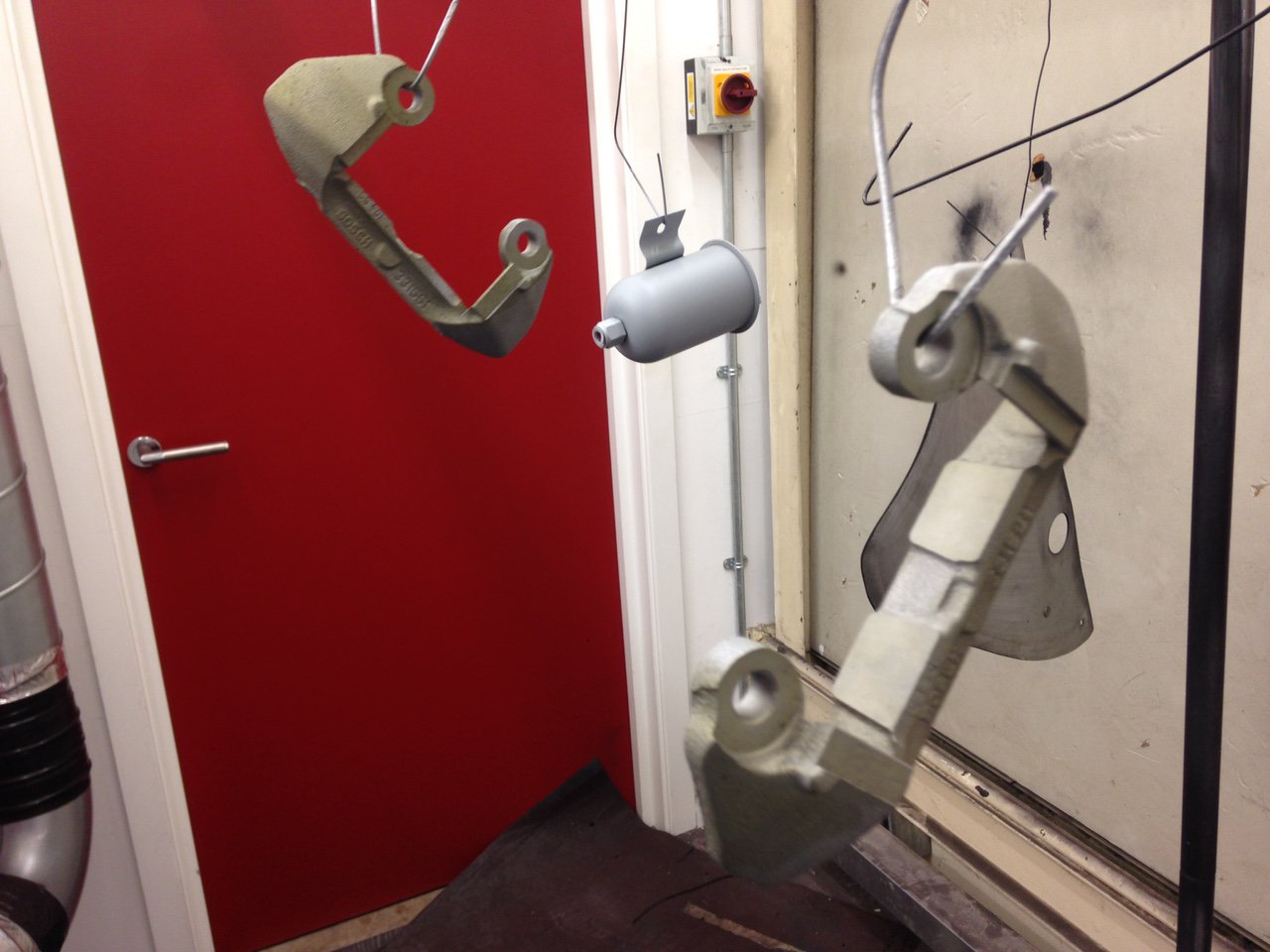

Then I moved to the calipers, or at least the bit that holds the pads. Sandblasting and some vht silver.
Will be probably rebuilding the calipers even though they seem to work ok, but I just can't help it, sorry :( those will be painted silver too, and so will the fronts.
Once the axle will be done I'll get some braided lines maybe, and hope that the wheel bearings will have some life left, if not I'll have to swap them with mines that are 6000miles old.
New ones are cheap but I hate wastage.

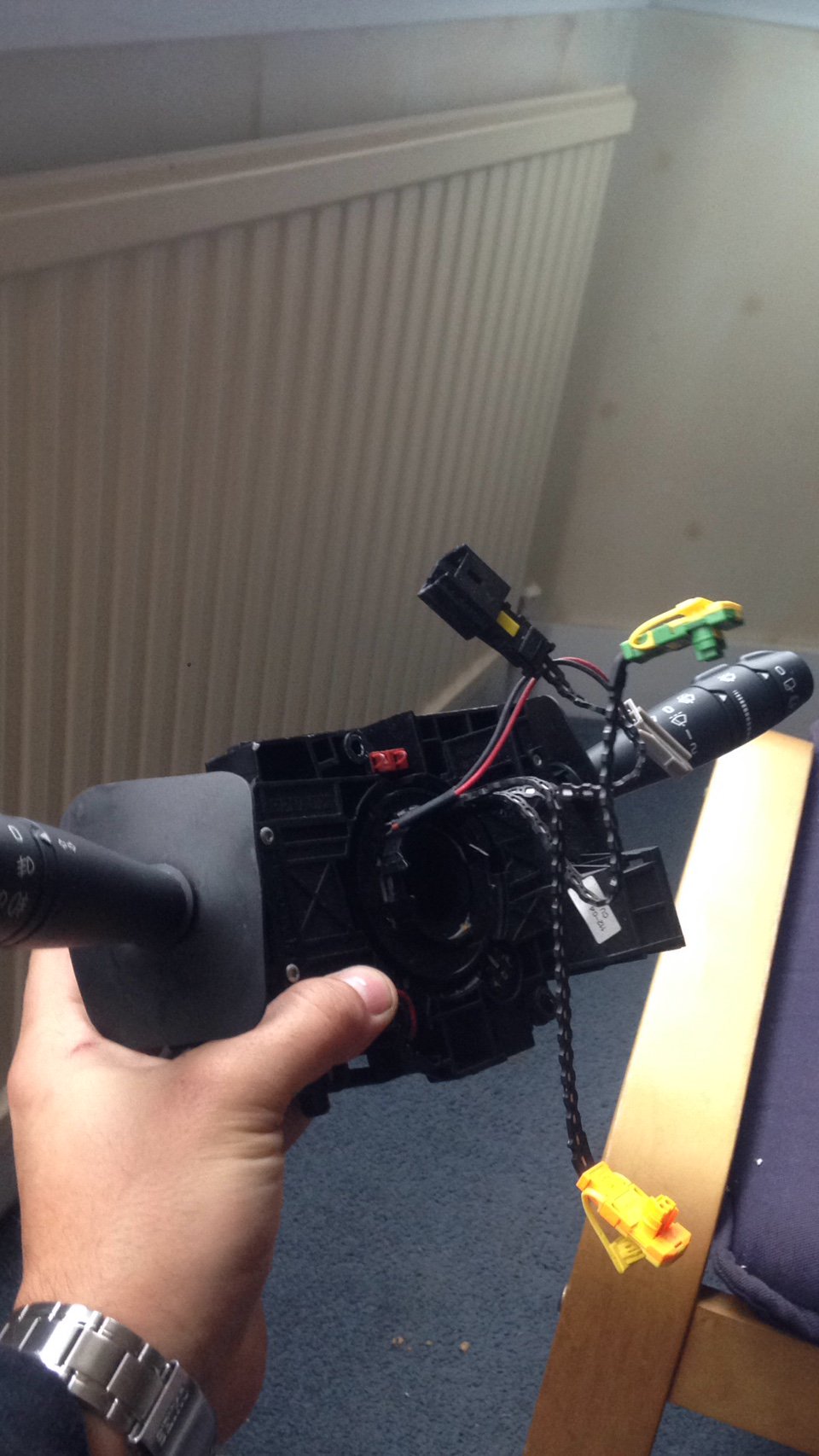

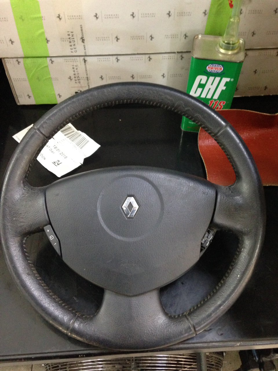

Tonight I finally fitted something I've always wanted: cruise control!
Being my crap clio actually a posh version, I wasn't surprised in finding all the right connectors waiting to be used, all I needed was a steering wheel, airbag, squib, switch panel and clutch switch, then some wizard will have to program it, or at least this is what I read.
Got myself the steering wheel first, I was going to get the cheapest one on the internet and that turned out to be a 182 Cup one, that hasn't got thumb grips. Feckin perfect, I hate thumb grips!!
I'd be happier if it had turned up with both cruise buttons.. the seller is taking care of this
I didn't realize this particular wheel hasn't got the Renault Sport bit of trim at the bottom; that means I won't be able to swap my fake ass walnut bit that comes on Initiale clios like mine.. I'd rather not have thumb grips tho so I'm happy.
Then the squib came, together with the switch panel and clutch switch, and a mountain of other bits..
Fitted it all and boom, cruise control works like a charm, no programming needed, FY.
The clutch switch is wrong, I bought one off an Espace that seems to be the one I need, but the system works without it no problem.

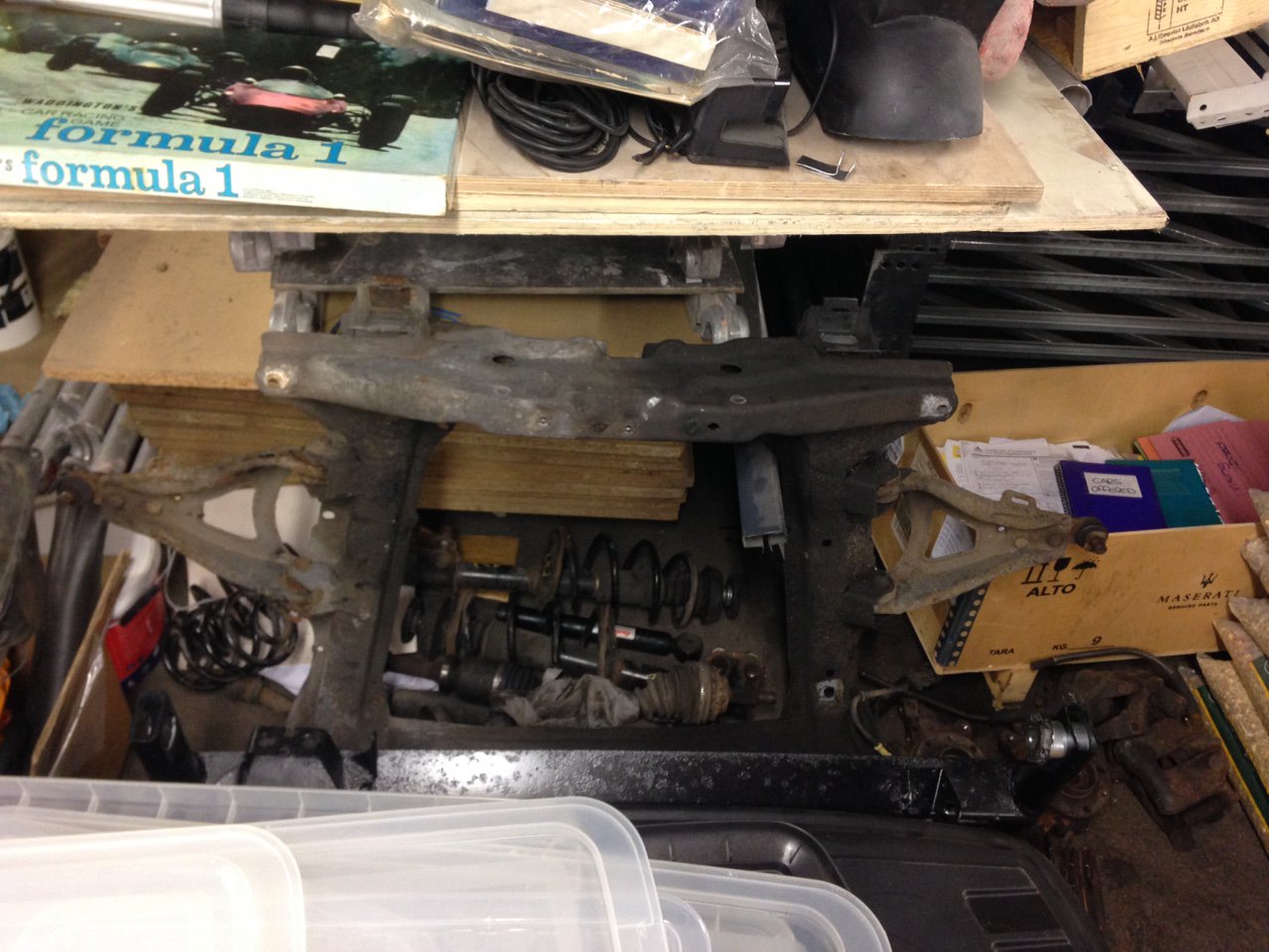

That pile of mess is a complete front end off a 182, with some bits off a 172
-subframe
-antiroll bar
-wishbones
-hubs
-struts
-driveshafts
-calipers
-discs and even a good set of pads
I also got rear springs and shocks.
Looks like I'll be doing a wide track conversion and full Sport suspension swap, i though about this even before owning the car, I hope that it will make all the difference that people say it does.
