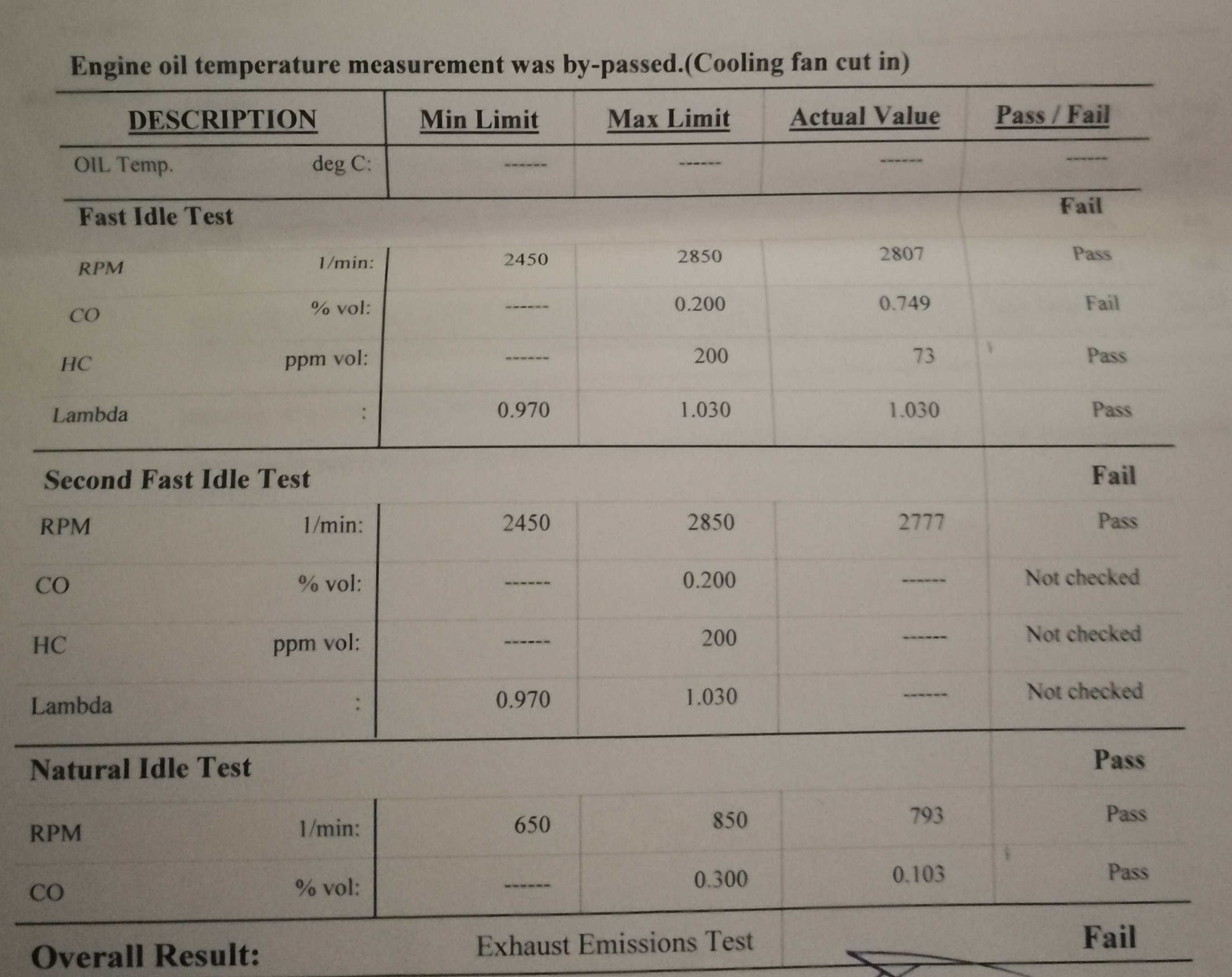

Here are the actual MOT emissions test details:
Hope that means more to somebody else than it does me! Appreciate the replies, thanks both.

I've got a pretty bog standard code reader, gives me live O2 data, might plug that in and see what readings I'm getting from the pre cat sensor, then borrow the pre cat sensor from my brothers 182 and see if the data is very different in an attempt to eliminate the sensor (or hopefully find a faulty sensor!)
