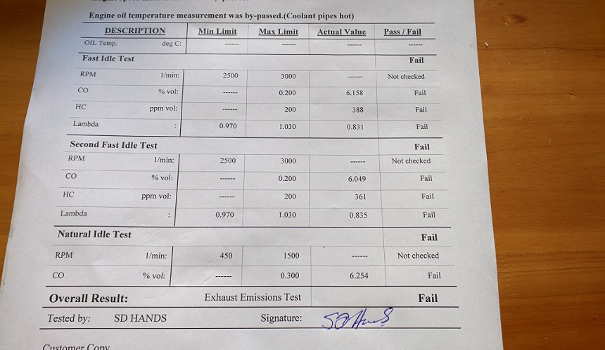

Had my mot today car failed on emissions, tester said it smelt Rich. Here are the results,
Fast idle test
Engine speed 2810 pass
Co 6.53 fail
Hc 350 fail
Lambda 0.827 fail
The cat is worn but doesn't seem to be blowing. Tester said there was a slight misfire at high revs. Plugged obd2 reader in no faults showing. The car only does 5 miles a day but had a 20 minute run before test. It has had a ktech induction kit fitted for 15th months and it hasnt been cleaned
. tester left it running for the whole test so it was warm for the emissions test.
Any help or advice would be great before I go throwing money at the car, again.
Thanks Alex.

This is pre-cat lambda and happened to me in January - a basic fault reader won't see it.
I got the lambda changed and it passed with flying colours.
