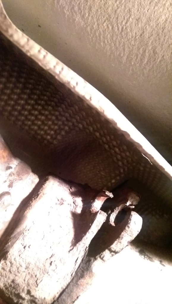

Went to look at the "snapped" bolt in exhaust, turns out it's not snapped at all. Looked more like the bolt holes have just decided to run away.. is this normal? (Cat left, mani right)

seen the cats go there, bung a washer under the spring and should be fine.
that should of been a pass and advise i'd say, not a fail.
What do you mean by under the spring? Between the spring and the cat?
I guess the proper fix is to get a new cat with shiny bolt holes

The proper fixing kit has two bolts, two springs and washers and nuts. The spring goes over the bolt to keep tension I guess. If you put a washer on both outer faces of the joint then it should hold better.

Ahh yeh I've got that kit from Renaultpartsdirect. The upside down hat shaped washer doesn't seem to fit in the gap it should, maybe I wasn't being forceful enough with it. As I think that would hold it all in
Looks like there are still remants of the old hat in the manifold (if thats it on the right). You need to chisel / hammer it out.
That could explain it then. Will have a go later and see if anything comes out, cheers fella

Also hammered out the old remains of the top hat washer and hammered in the new one 80%, it's pretty solid and I think it'll get through the MOT at least.
