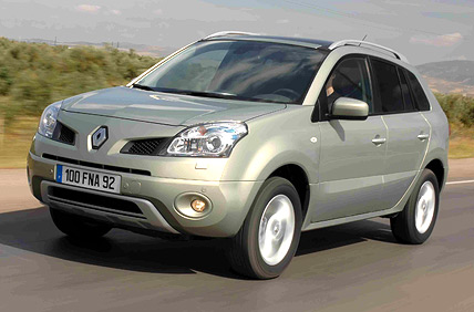

I was hoping for that little bit of luck but nevermind. My courtesy car from Ness motors was a 4x4:D, the Koleos
this is what i am rolling in till monday
Looks like s**t but drives pretty damn good
