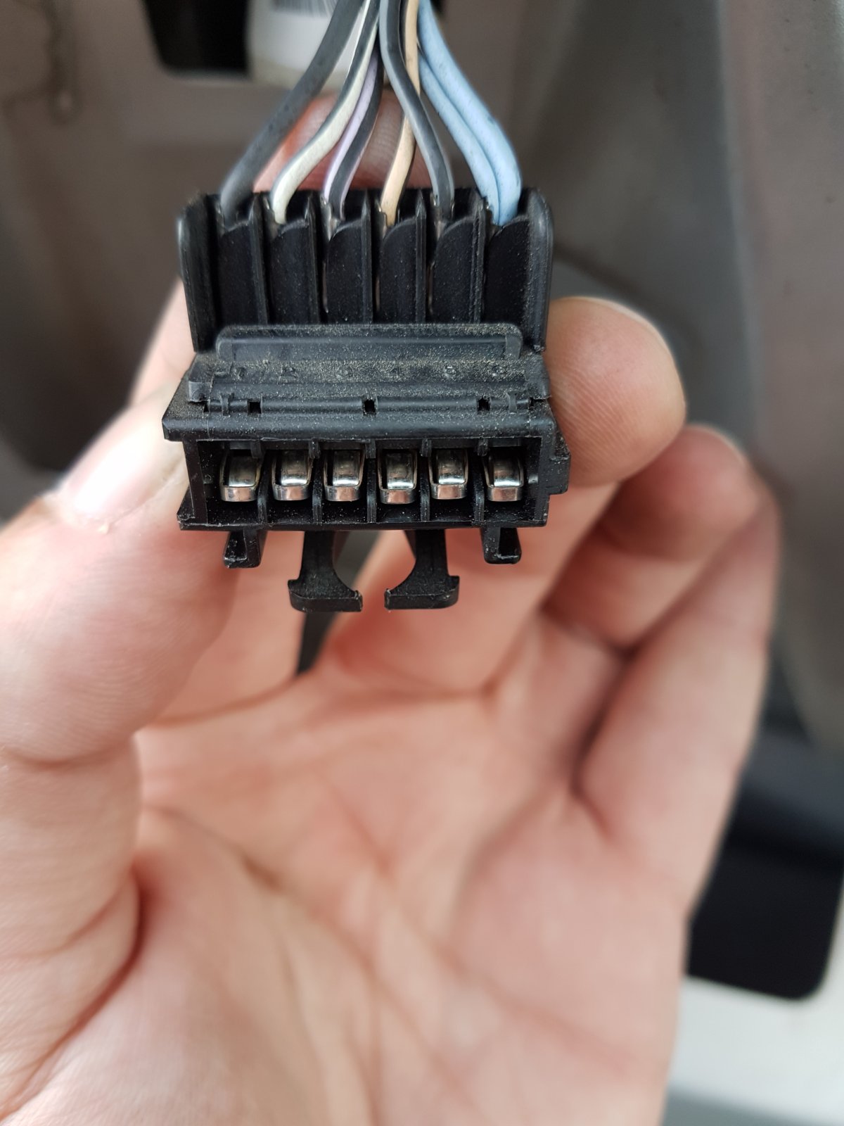

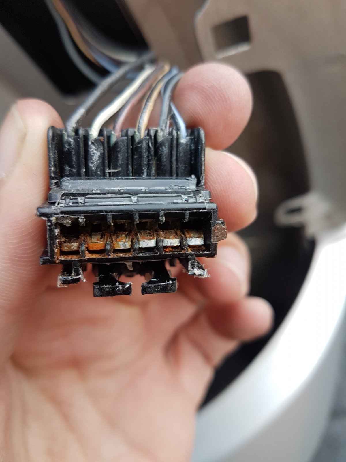

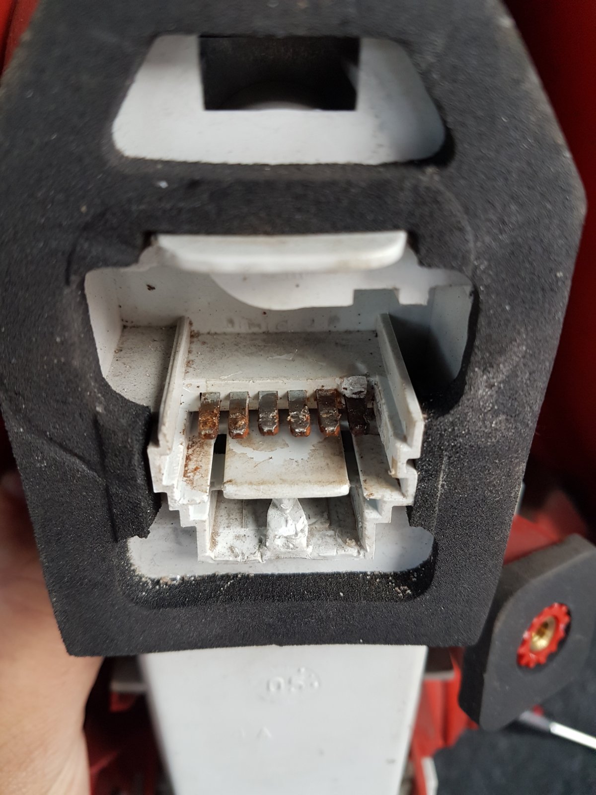

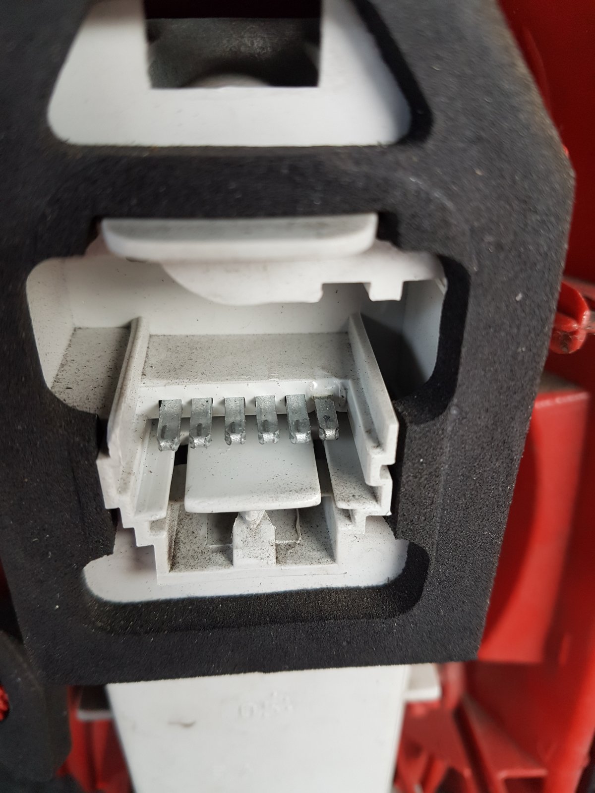

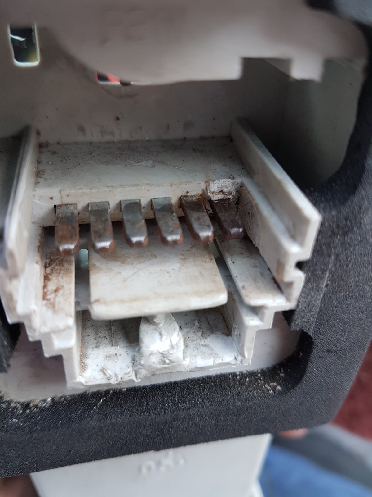

I think you maybe onto something, got home today and took the rear lights out. The pictures speak for themselves. I did try to clean up the right one, but i think i will just replace and see if this sorts it. If someone can tell me how to de-pin the connector that would be awesome! Someone has messed with the right one before the plug seemed to be glued in and evidence of screwdriver damage and one of the pins possibly melting the plastic. Will be sticking a wanted thread for a complete rear light and see if i can get the connector.

View attachment 190917 View attachment 190918 View attachment 190919 View attachment 190920
That looks rodgered

While you are at it use some sealant to fix the rubber bung above the light. Water usually gets in through the bung and leaks on to that connector.

Ta, i will give that ago. I ordered a new board and plug with some loom. So i will update once fitted.
