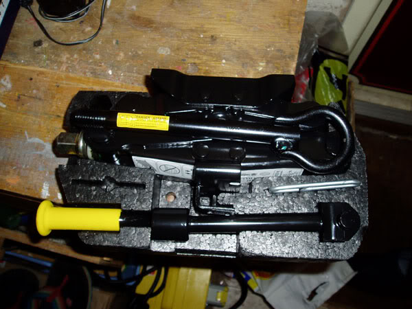

The jacking kit could come with a wee hook, which works well..
You could even cover the end with insulating tape for extra protection.
the kit in the boot? strapped to the drivers side?
only ever seen jack handle and towing eye in there?!
  Clio 197
Yup.. they're there for you to replace the original nuts that you take-off when changing the pads.
Due to the fact that they're esentially behind the wheel - they get hot/cold and are exposed to salt and the elements - so they can corrode over time.
The new ones have got thread-lock at the ends, which will help them stay-in (and you DO want them to stay-in, lol).
I've not used mine - originals are still in good cond.
