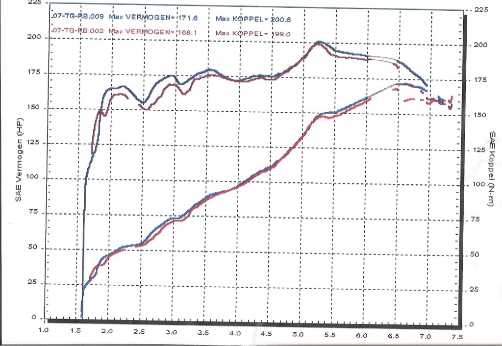

i made 161 at the wheels before with a Group N map and ITG panelfilter + exhaust. With the cams + inlets it made 174 on one run , think 172 was the last output. Torque is just above 200NM now , it's an awesome ride ; just right
i will look up the before + after graphs. I do'nt really like to look at those ; important is how the car drives at the end of the day ! My cup weighs around 950KG , with this power it is like a cart

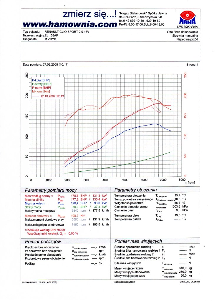

C&B's can very well be coupled with the stock ECU, not a need of a standalone. Of course stock ECU needs to be remapped. Frank's and my car (a ph-1 172) produce almost the same power with highly similar mods (same cams, 4-2-1 mani, decat and etc.) + Henk@FASTCHIP fully custom remap.

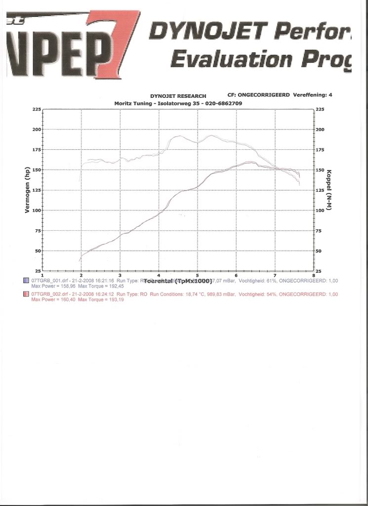

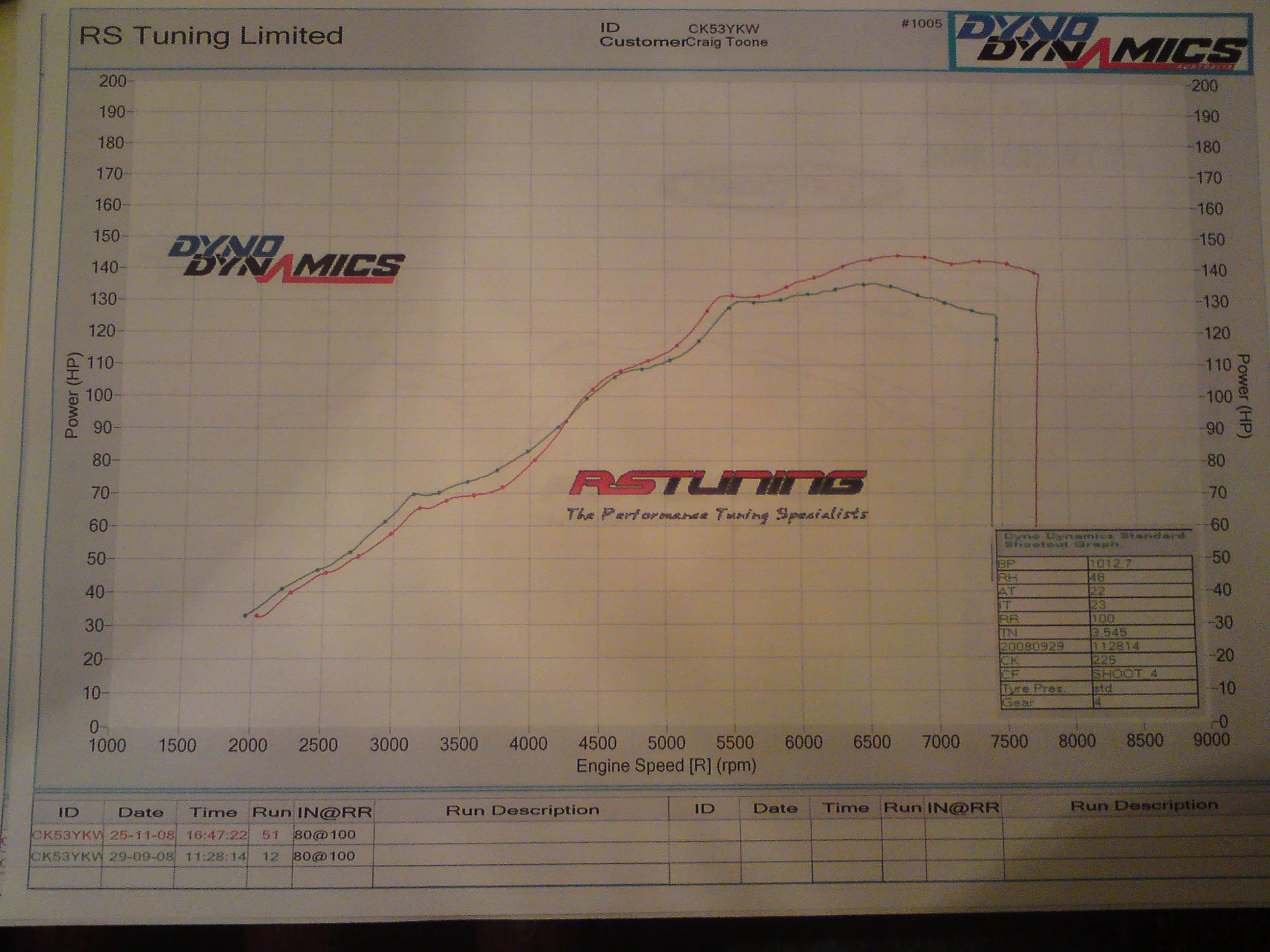

^^^this one is even worse, there is no way to have 80 BHP loss for a FWD car. I am pretty sure your car will make more when it is RR'd on a different dyno.
  Clio Sport 172 ph1
I'm pretty sure of that. But I've made my choice and it would not be wise to change RR now. I've made 2 runs so far and 1 is still to go (after the final calibration). Power on the engine seems right thou. I would be happy to see more but at least I'm sure it's accurate. I know of cheaper RR that you get 10BHP extra just for showing ;)
