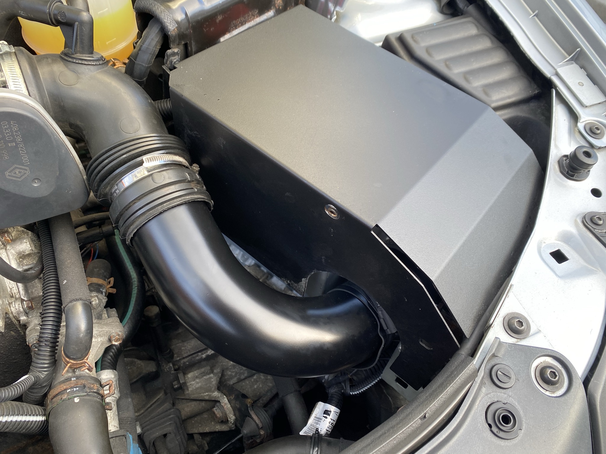

I have the fatty induction kit on my 182. The RamAir filter seems to be moving a little too much as it is catching and damaging the foam on the filter.
Just seeing if anyone has any good ideas as want to keep it in place (or as near to as possible) and prolong the life of the new filter I'm buying. Just don't want to replace it and it happen again.

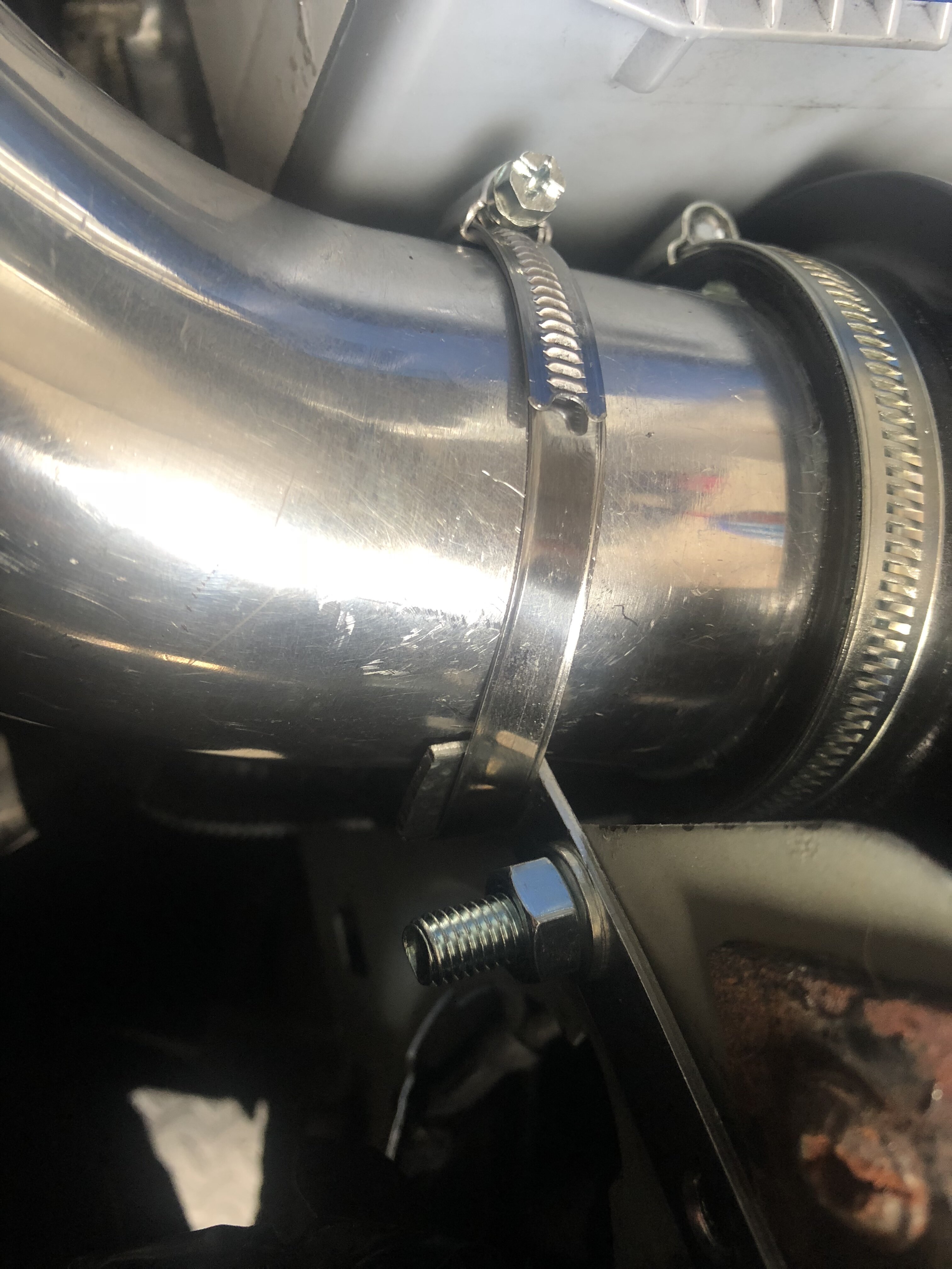

I used a small angle bracket and jubilee clip. Secured bracket to the brace that runs next to the battery and it holds it perfectly. Zero movement. My description is crap so I’ll try and dig out a photo.
Please, that would be brilliant.
