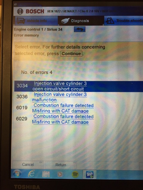

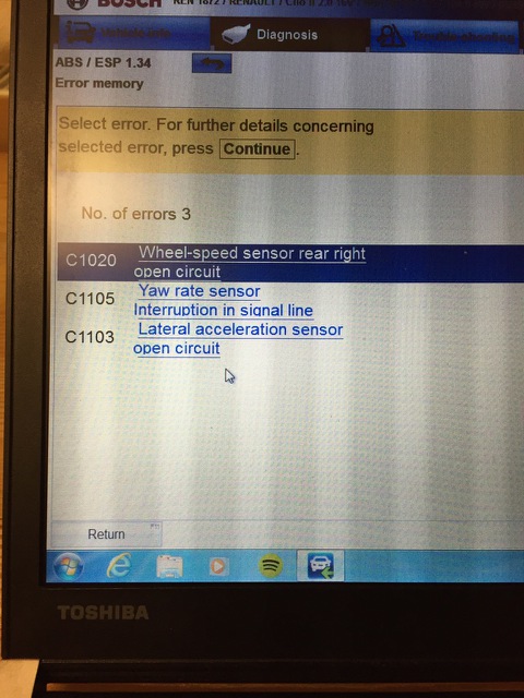

I just wanted to see if someone can help me the results found by plugging the car into a reader yesterday.
From my understanding the Injector fault code is now gone, I have replaced a faulty third injector and cleaned the remaining 3 professionally.
I can't make out which parts I need to order to resolve these faults. Any help on this would be appreciated.
The car itself is a 182 if that is needed. See the image below for the results :

The did have a lumpy misfire before I replaced the injector, But now it ticks over fine.
if it is left to run for a while, (10minutes) There is a sulphur/eggy smell developed, I assume this is because of the CAT. I have brought a decat pipe to resolve this, Although its not fitted yet,
The dash lights consist of ABS light & SERV Light. As for the car it has been sat in the garage since last September in bits. Only ever ran on tick over.
Hope that helps..

The ABS fault was present when I had it, that I recall. I think I gave Yodi the sensor (or it's still in my 987). If you want it & I've still got it, just pay postage.
The Yaw sensor error didn't show up on clip when I owned it though & the injector rail was replaced around 18 months ago.

Ok mate the serv light will be on because of the abs fault , with that fault code in the abs system I would start by checking the connection to the rear right abs sensor and if the connection and wires look ok then 9 times out of 10 its a faulty sensor i'm pretty sure they are only cheap anyways.
As for the engine management faults I would clear them down and run the car and see if they return , most of the time they are old faults are that just stored in the ecu.
That sulphur / eggy smell will be the cat but if you gonna use a de-cat pipe I wouldn't worry about it :)
If you could check if you have it still mate, I will happily cover the costs mate?
Yeah, I am really not sure about the YAW sensor, As for the injector rail really useful to know, I changed the injector but the rest is fine.
Would be interested to know if you have that sensor tho mate? Appreciated..
That sulphur / eggy smell will be the cat but if you gonna use a de-cat pipe I wouldn't worry about it :smile:

Thanks for this mate, I shall check the wires first, Any chances of it being the ABS ring? I heard both of these are a pig to replace.
I will clear them down tomorrow morning and re run the diagnostics, Yeah would be worth me replacing the Lambda sensor and placing it in the Decat plug?

I replaced the front abs rings a month or so before I sold it.... It's the sensor, that's why I bought one.
Come to think of it, the reason I replaced the injector rail was a misfire on 3 - I think I gave Yosi the spare rail so maybe it's gone on ...

With that fault code of an open circuit its either wiring or sensor failure , as for your lambda sensor it might not be at fault , those fault codes could all be related to your faulty injector.
Best thing to do is get the car plugged in again clear down the codes ,fit your de-cat then run the car and see if the fault codes return, you will have to refit the lambda to the de-cat sensor plug or the engine management fault codes will return anyway.
  dan's cast offs.
clear codes, take it out for 20 or so miles, kick it's head in and see what comes up code wise and look at live data. the clio ecu is a bit dumb to say the least:wink:
