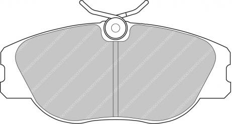

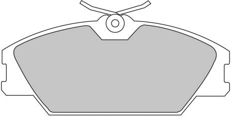

the 565H is a thicker pad with a larger surface area, obvious from the images below, price difference between the 2 is about £10, but some companies sell the cheaper 406H pad at the same price as the more expensive 565H pad which is a bit naughty in my book
406H dimensions and image
129,9x51x18,3mm
565H dimensions and image
130x53,5x19,1mm
