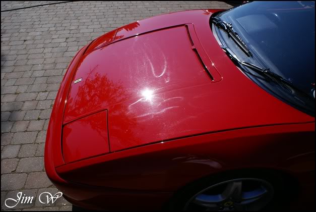

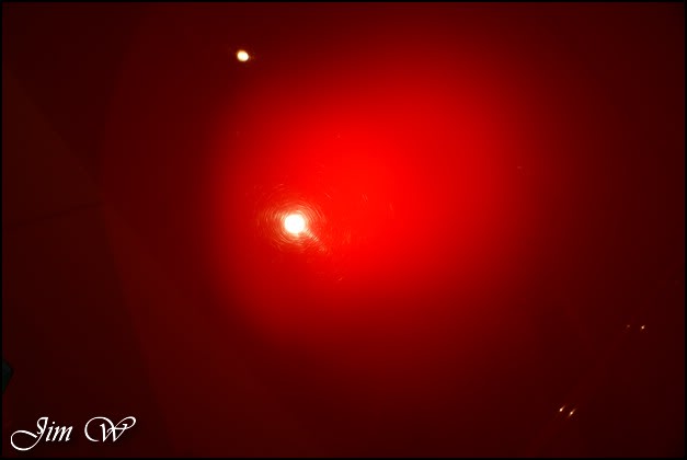

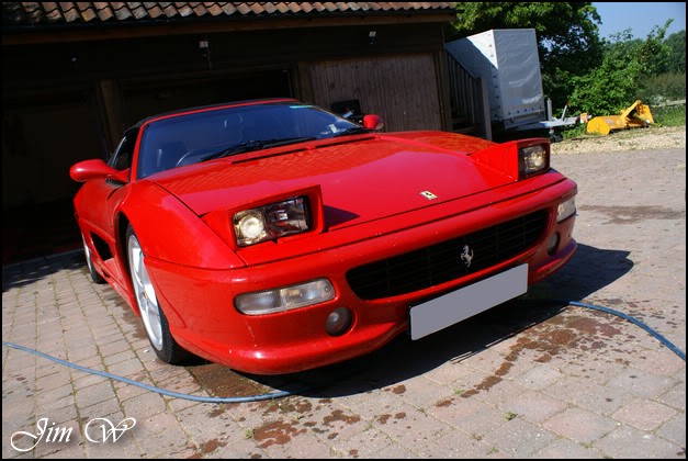

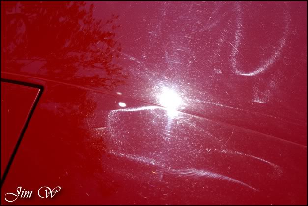

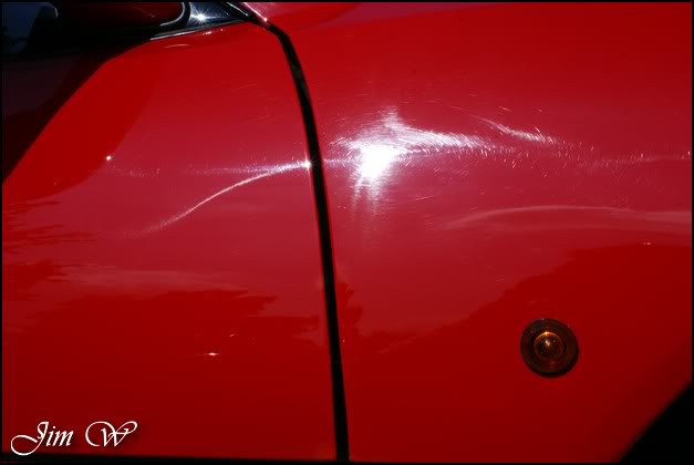

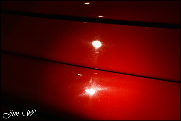

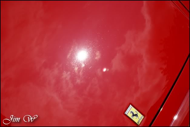

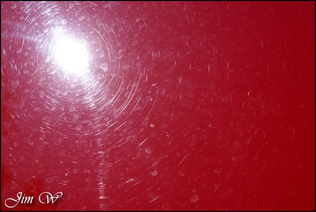

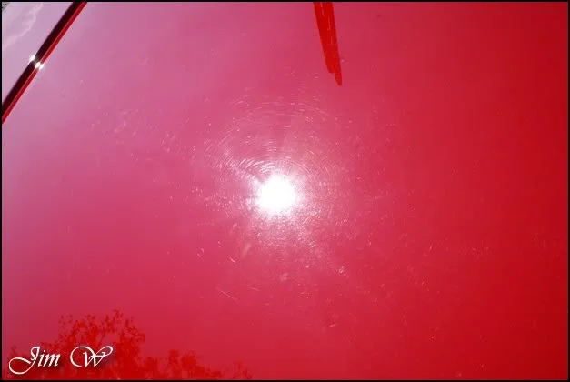

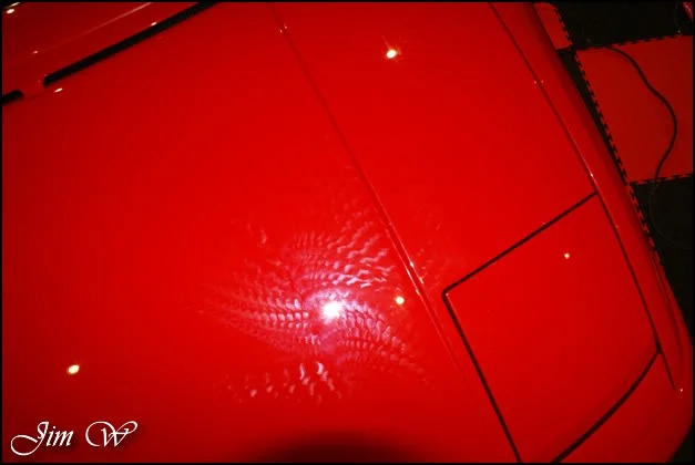

Taking a cheeky moment to check the paintwork on the Ferrari, I noticed some pretty wicked buffer-trails and swirls in the paint. The work of a previous detailer apparently.
The car had been worked on by an Authorised Detailer of one of the big players in the Detailing game – I’m not one to name drop, but, to say I was shocked was an understatement.
My job was to rectify the issues and tidy ‘the edges’, as it were..

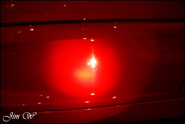

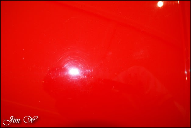

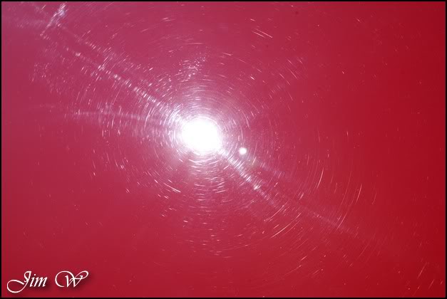

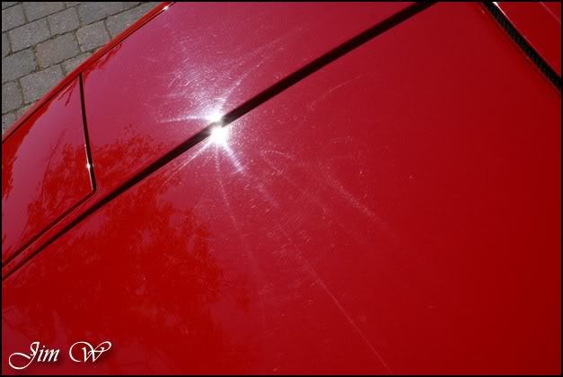

Inspection:

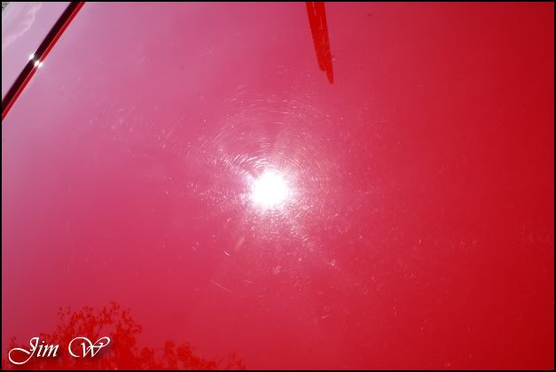

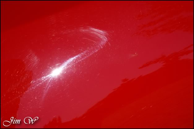

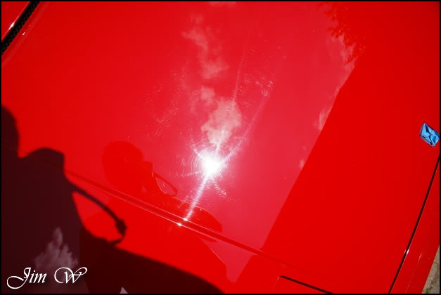

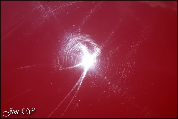

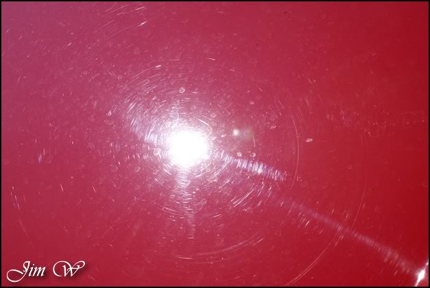

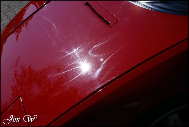

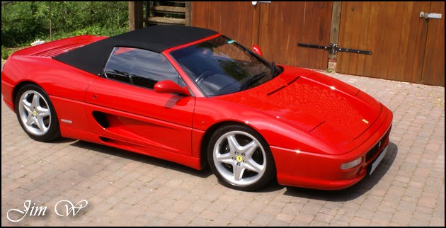

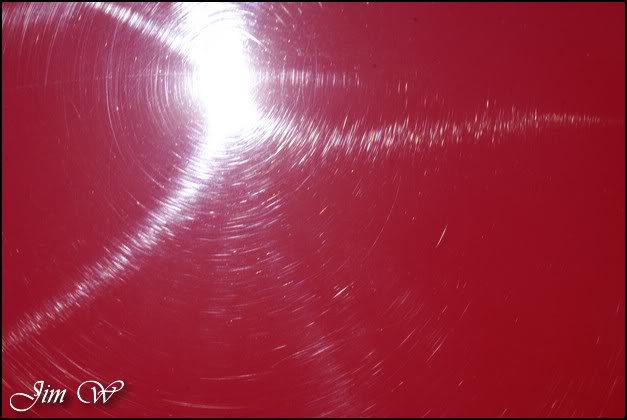

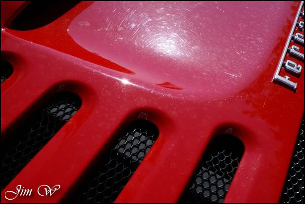

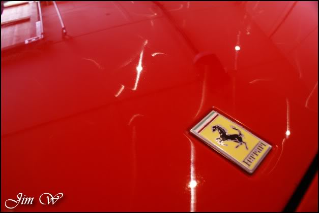

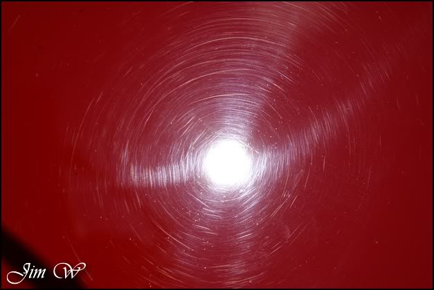

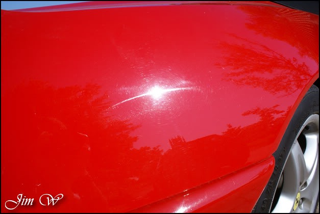

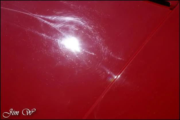

As seen above, the paintwork was well and truly butchered with its previous machine polish experience…

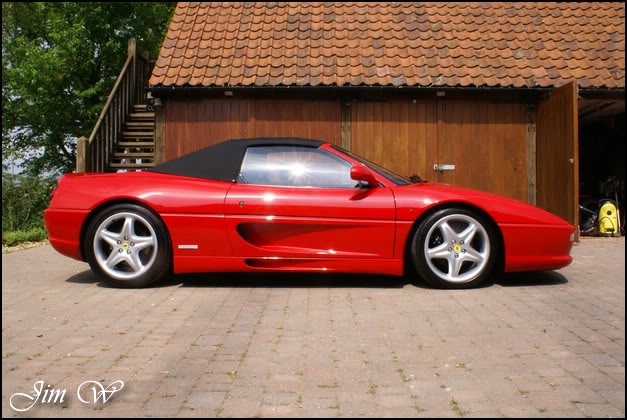

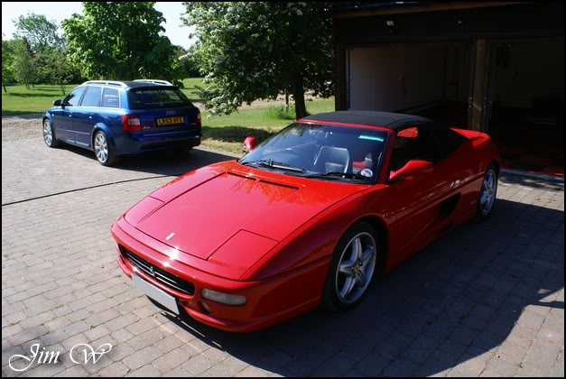

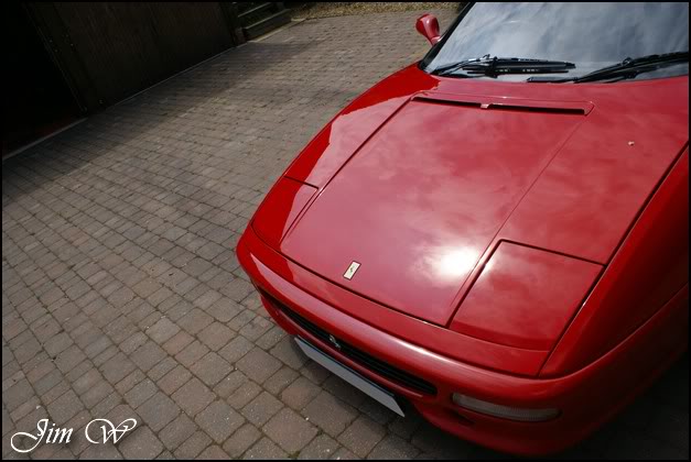

On the whole, the car is very clean. Until I appeared I on the scene, it lived happily tucked away in the garage where is remained spotless… Whilst working on the Mercedes however, unfortunately, the F355 had to stay outside to allow for a decent work space within. Here, the mixture of rain, wind and dust left the car in the condition you see it in above (….minus the buffer-trails!)
It was a scorcher today; pushing 28˚C by late morning. With that in mind, the sooner I could get undercover, the better.

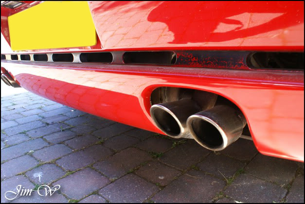

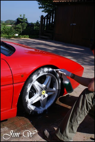

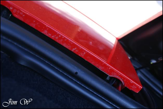

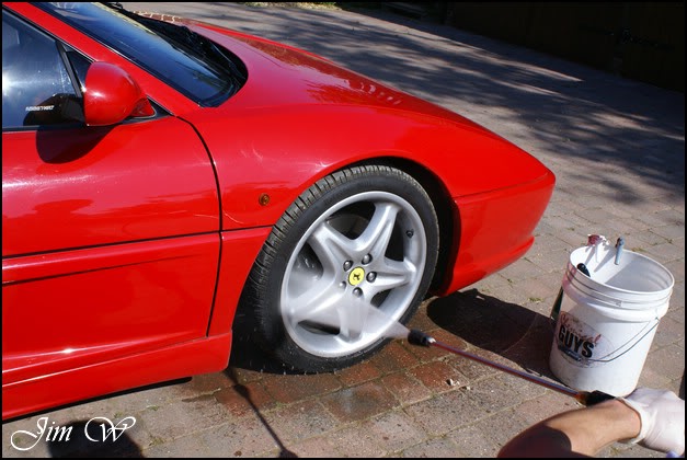

Wheels, tyres and arches cleaned with Megs APC and a mix of brushes and mitts. AutoSmart Tardis later used on the alloys to remove a few fine tar deposits.

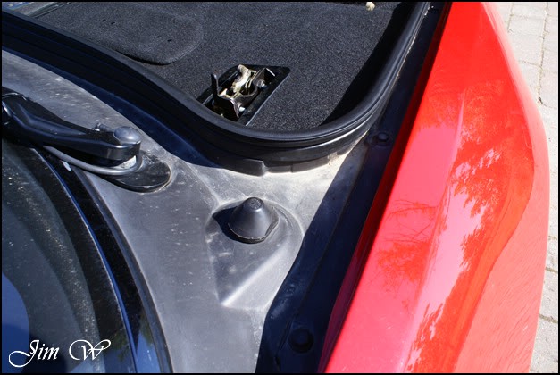

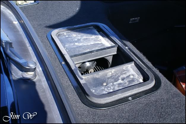

Bonnet sills wiped clean and headlights raised to allow cleaning here, too.
Other intricate areas cleaned in the same way:

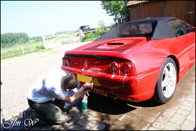

Using the same ONR mix I used to wash the car with, I began claying the car with Sonus Green.
Contamination pick-up was minute; very little fall out present.

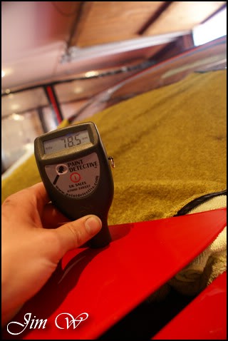

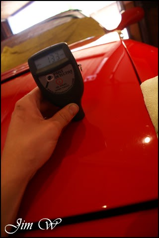

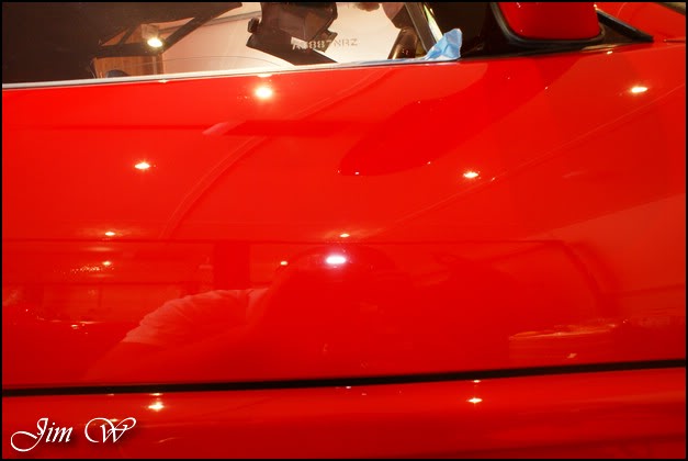

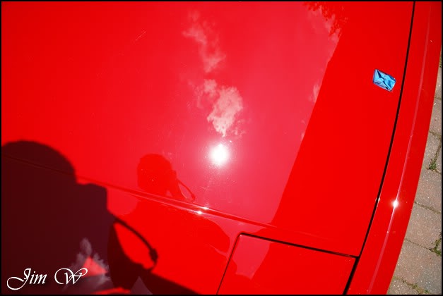

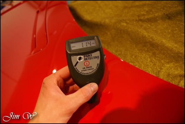

Paint depth readings varied throughout the whole car. One or two high areas, but also a few well below the 100um mark.

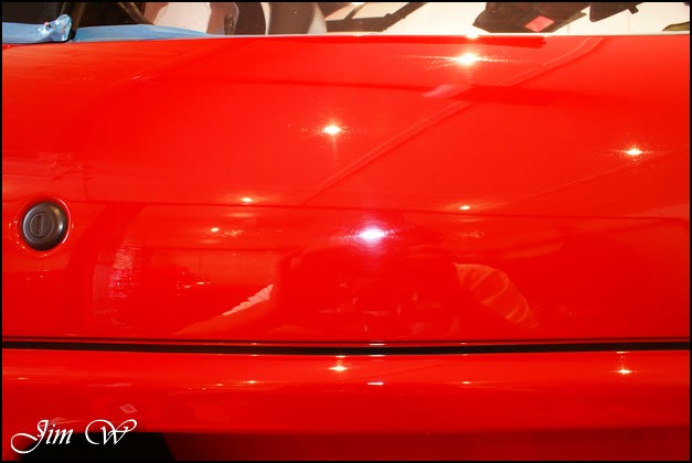

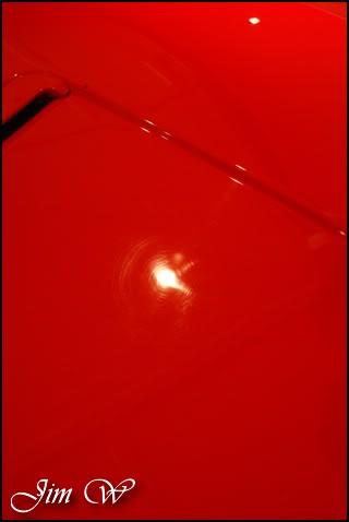

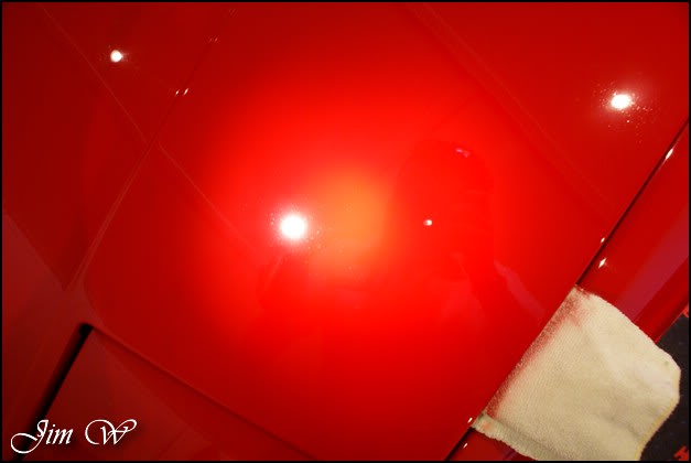

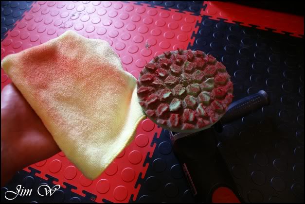

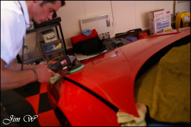

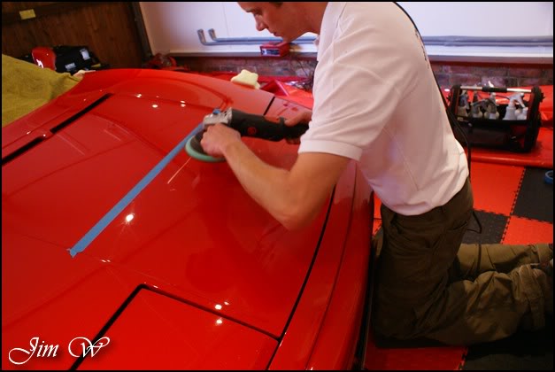

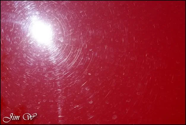

With that in mind, I started with Menz 106FA on a 3M Polishing Pad and went at it on the bonnet..
Before:
After:
Before:
After:

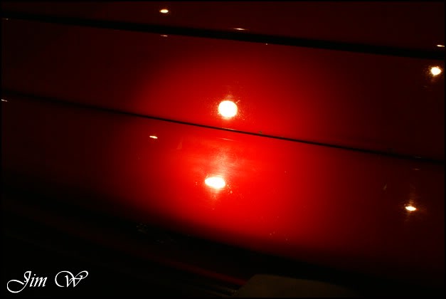

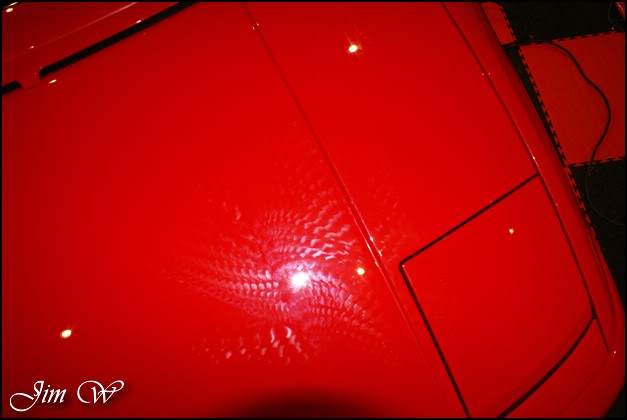

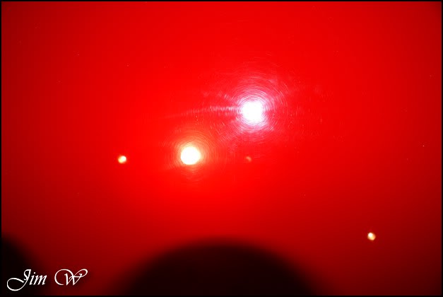

As you can see, not cutting the mustard quite enough; buffer trails still visible.

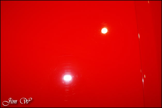

Stepping up to Menz 203s on a green light cut hexlogic pad did the trick nicely.
Before:
After:

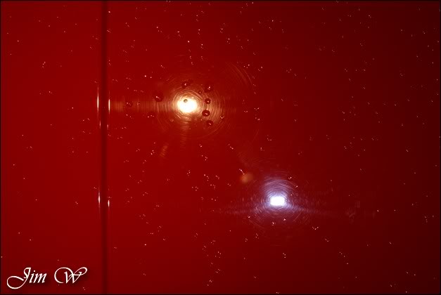

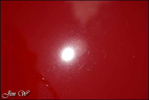

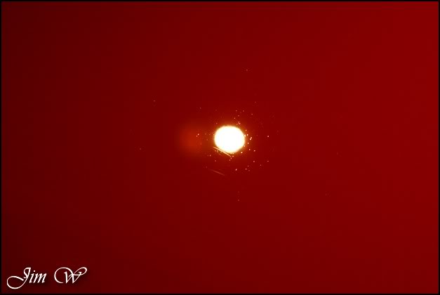

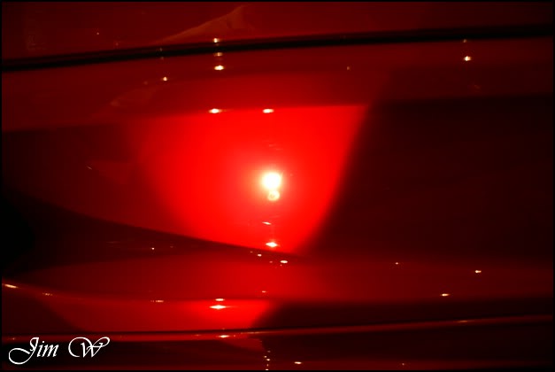

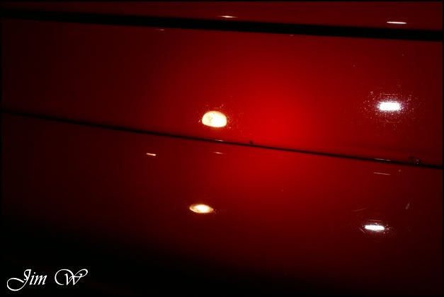

One or two deep scratches requiring further attention to chase them completely..
Before:
During:
After:

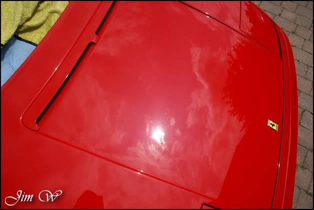

Bonnet 50/50 in sun:
Before:
After:

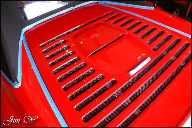

Smaller spot-pads used for the trickier areas:
Lower bonnet lip and front bumper before/after:

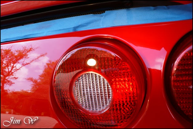

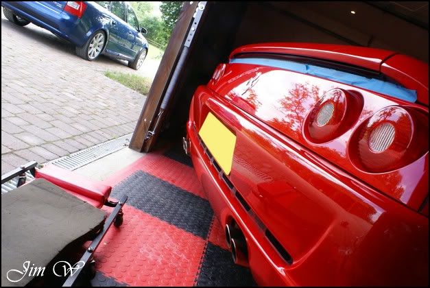

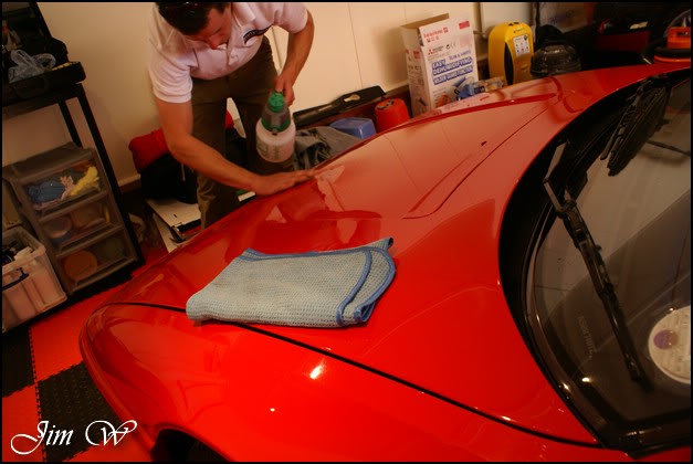

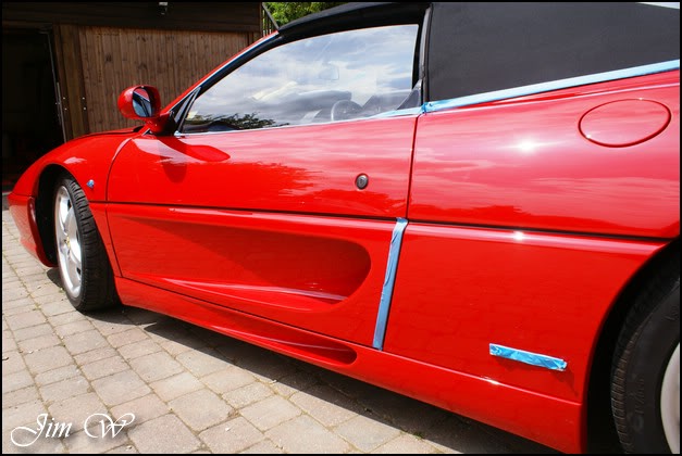

Machine work was finalised and back out into the sun to check my work:

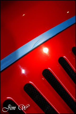

After tape removal and a quick dust down, Clearkote Red Moose Glaze was applied by DA and a 3M finishing pad..
Adding a real depth and richness to the paint, then follow by SuperNatural wax:

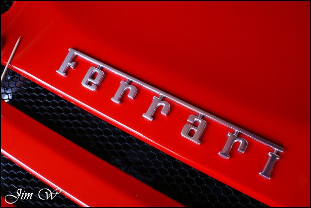

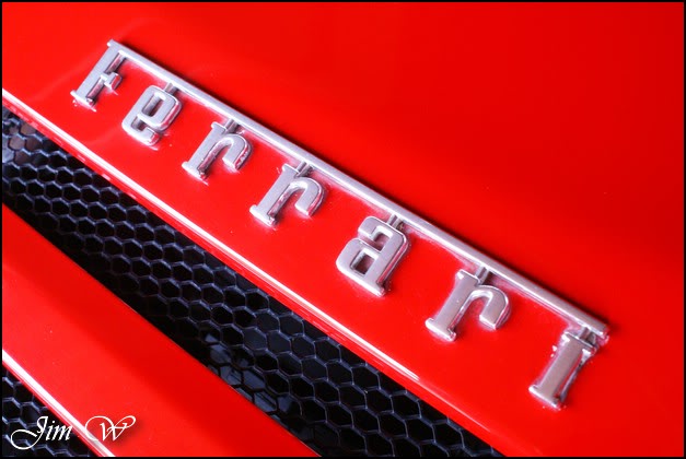

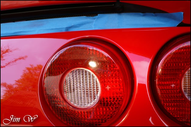

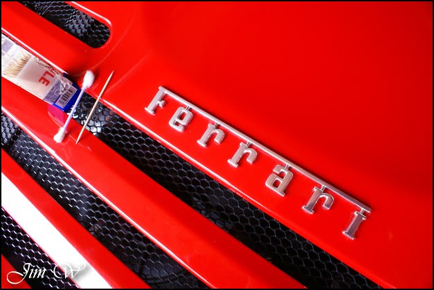

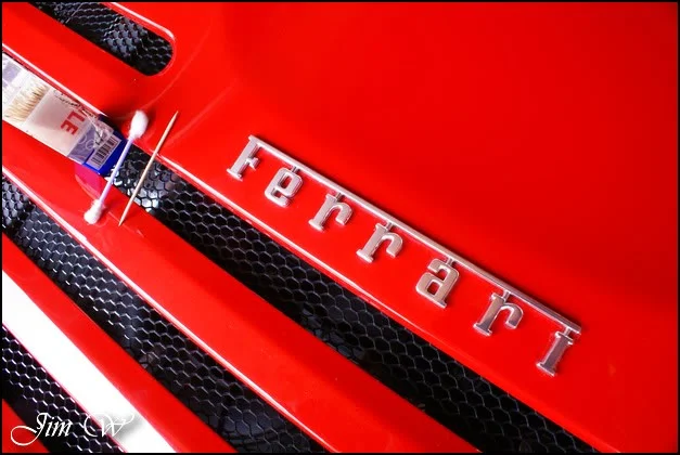

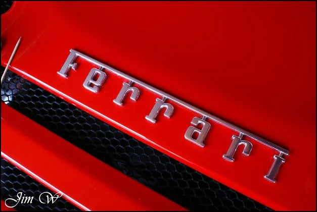

A few detailed areas were looked at like the rear diffusers, badges, grilles and locks etc..

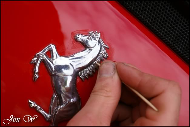

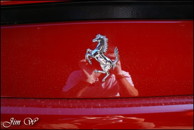

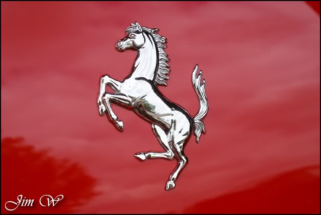

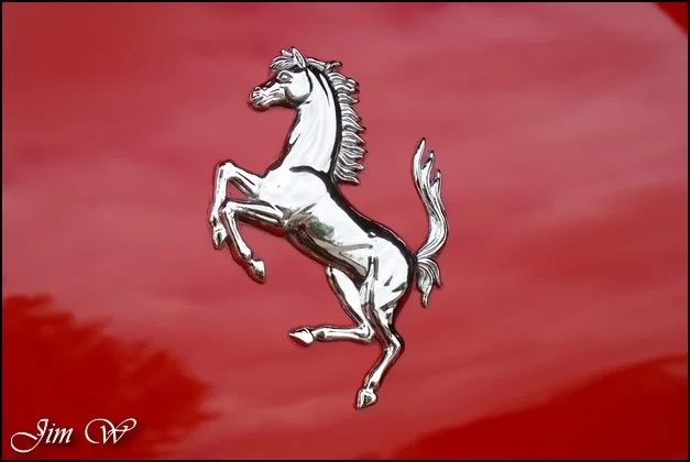

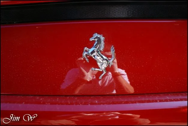

The prancing horse was caked up in polish build-up.. The edges were cleaned with cotton buds and Jeffs Prime and a toothpick removed the excess product from in and around..
..putting a smile back on his face:

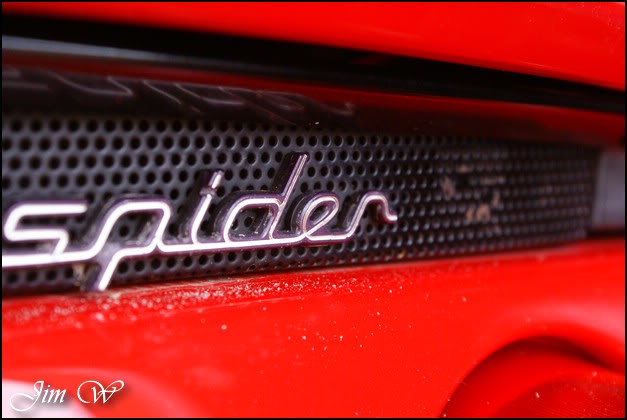

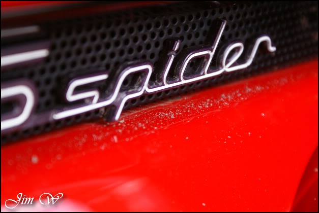

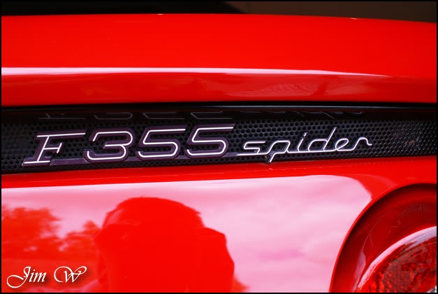

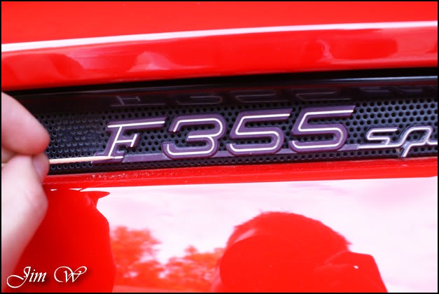

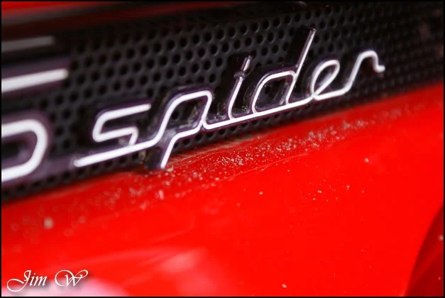

The “F355 Spider” badge had accumulated a fair amount of crud, too.
The white line that made up the lettering was almost yellowing in places due to the dirt trapped within.
Example: “half the D, the E and the R” yet to do..
Depositing the rubbish below..

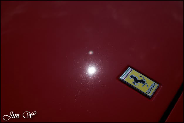

And finally, after:

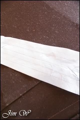

Fluff/debris removed off of the hood with 3m tape: (image over exposed (tape should be blue!!))

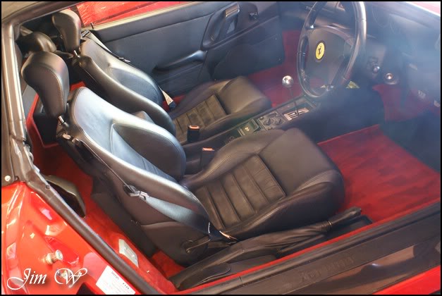

The tyres were dressed with New Look Trim Gel. Exhausts with Autosol. Interior hoovered, wiped and leather treated with LTT Auto Ultra kit. An hour or so was then spent on the 997 Turbo Interior as I didn’t get round to finishing that last time (Leather with LTT kit and mats wet/dry extracted) and a final wipedown on the Ferrari finalised the day.

The dodgy marks that were mentioned from previous detailer.
Could that be the washing technique after the detailer left Jim?

Those holograms/buffer trails are rediculous. The owner must have been stupid to pay for that IMO as I wouldn't have what so ever.
Nice correction man :)
As above Gally.. You can inflict damage by incorrect wash technique for sure, but, in this instance, the marks seen are the results from (as budgie rightly says) a too harsher polish and pad combination when it was last 'polished'. :S
Hmm.. Not sure how he hadn't spotted them before to be honest! To the untrained eye, people don't know any better! "hey look, my car is all shiny *bling bling*"
.....fail!! :rasp:;)

looks ace id be pissed if i payed somone to make my paint worse. must have been a harch compound to do the damage though right?
  Rb182cup+s2 rallye
jesus cant believe them marks when i got all my kit and a spare bonnet to practice on i left them very same marks after 30 mins of figuring it out they was gone so for a professional to leave them is shocking.
The trouble is, most people wouldn't spot them. Their eyes aren't 'trained' to spot them as such.. Only if you caught it in the right light at the exact angle, then, "hell, thats one clean 'highly polished' car!") I'd be interested to know what their approach was too... :S
