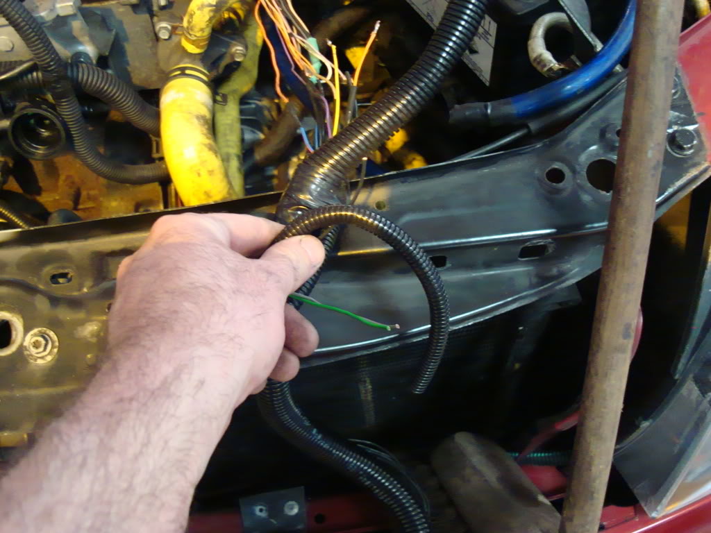

We cut the loom off as you said you were fitting a complete new loom, and its messy as hell leaving a loom end there.
Yes, peel the tape off the unertminated and an used connections well done... did you peel it away from the solder and heatshrunk connections? We see so so called tuners usuign scotch locks and chocalte blocks to wire cars. Our wiring is always spot on, and if it gives you a fault then moan, not before hand... jesus. You drive a french car, our wiring will be the best wiring in the entire car!
this is something that separates a "tuner" install from a pro motorsport install, you won't find any soldering anywhere near a motorsport install, soldering looms together to some is acceptable, to motorsport boys, its s**t
that's not a dig, thats a fact
Ah yes indeed, but in motorsport you generally are running complete looms, terminal to terminal, hence they are crimped (and yes we have the £450 tool to crimp properly! lol)
When joining wires to an exisitng loom in a road car though, soldered conenctions, which are then heatshrunk with the adhesive to cater for load/movement is the better way of doing things. Though I really have seen cars with loads of halfords scotch locks, bullet connectors and choc blocks for their engine wiring, shocking!

oh i've seen some shockers, i of know another tuner on here that used bullet connectors on the crank sensor, genius that!
  HBT 172 Cup
LMAO @ bullets on crank sensor.
When i did a lot of wiring on my car i wasnt very good at soldering, i did a lot of it with Heatseal Connectors, they are better made than bullets, and you seal the ends by heating with a lighter, so there is no "slopiness" when tugging. a reasonable sollution for a DIY'er like myself, "that" cheap though at around £1 a connector.

yes cookson , when i get chance to get it tow'd down there , will try getting sorted in the next week or so , i will give fred a ring , i can get you a nice broom handle bonnet stay if you want :eek: , its the new trend , lol
Meh. I had one blocking off a dumpvalve T-piece on my cosworth in 2003. Its old skool, lol

Theres loads more on passionford, saxp, bla bla, but I dont need to worry, we do well enough to afford a bonnet stay so I guess things are going well :) (Bonnet stay is indicative of the rest of the workmansjip on the car, ie cage not bolted in, cam timing out, bodged exhaust... hmm only 30bhp increase mtech, so bad of you!)
Nowt wrong wi a blob of solder ;)
