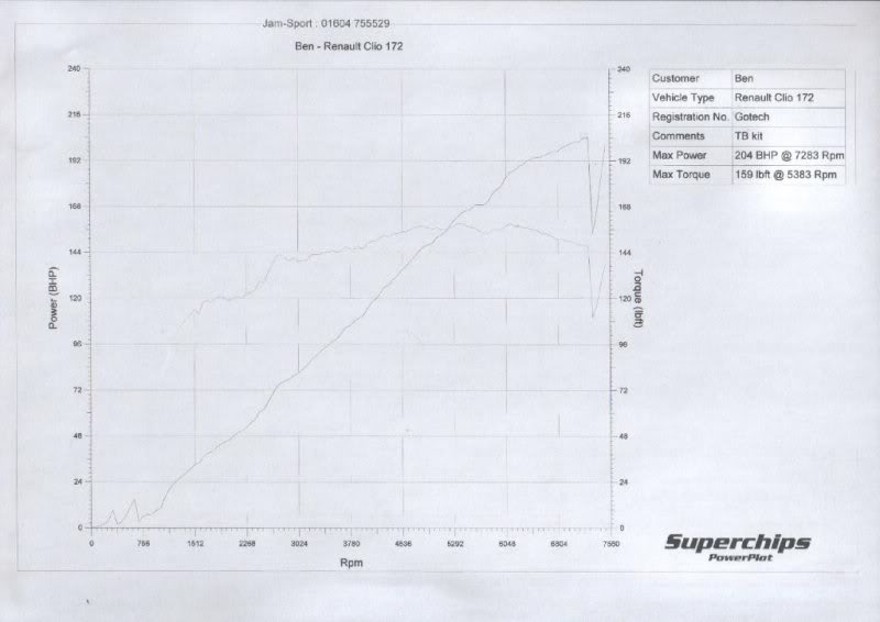

i dont have a power graph , i was never given one by matt , as said i have only ever read good things about m tech hence why i took it there in the first place , he has offered to map my next car for free which i cant complain about !!!
Heres my graph
AT power bodies, Standalone ecu, and group n exhaust, otherwise standard engine.

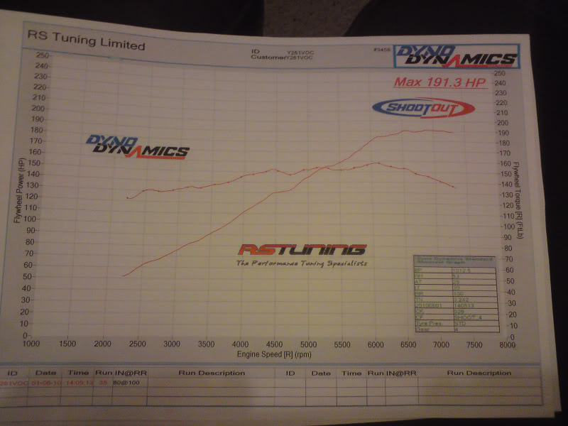

This is mine, 191 bhp on RS tuning's RR which is generally known to be very accurate, iv been told to expect closer to 200 on other rollers
This is with 135,000 miles and standard, bar the exhaust.
Still retains the catalyst also

its been a long day pal, that pretty good power for the spec I think, isnt a 172 about 145ft lb standard though?
Andy - I think the V4 ecu is more than up to the job as it is a very high spec ecu with some excellent features
Probably overkill for a N/A engine though which is good

have compared a few cars now and DD always seems to read 5-6bhp lower than the superflow around this level of output. Swings and roundabouts, every dyno is different etc, blah blah blah. I'd pick a Superflow if i was buying a dyno though
That's mainly because of how the DD ATMC2 correction factor works out estimate flywheel power. If you run a DD with the SAEJ1995E correction factor they stack up pretty bloody closely with each other.
