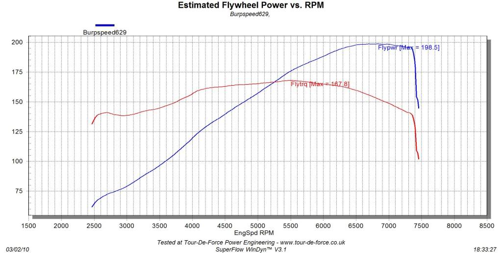

I will post a graph tomorrow fo the before and after. Before, the torque curve was ALL over the place, now its as smooth as ever all the way along, in fact im going to nip down to the unit now to get it... back in 10 :)

Can anyone (with more direct clio mapping experience) explain the terrible torque curve from the engine as it arrived (graph above)
It may help both Nick and myself get his car performing as he wants!
Adey.
all clios seem to have that funny kink in the torque, will try and find all my clio printouts and put them up, got stock, remaped, exhaust with remap, jenveys, and jenveys with 428s

If Renault let a car leave with such a bad torque curve I would be worried. usually we find that a car with 'bolt on' mods which is not mapped correctly can have odd torque charasteristics, hence the aftermarket management route.
