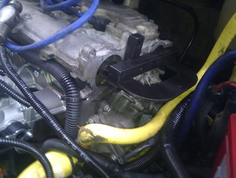

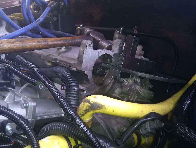

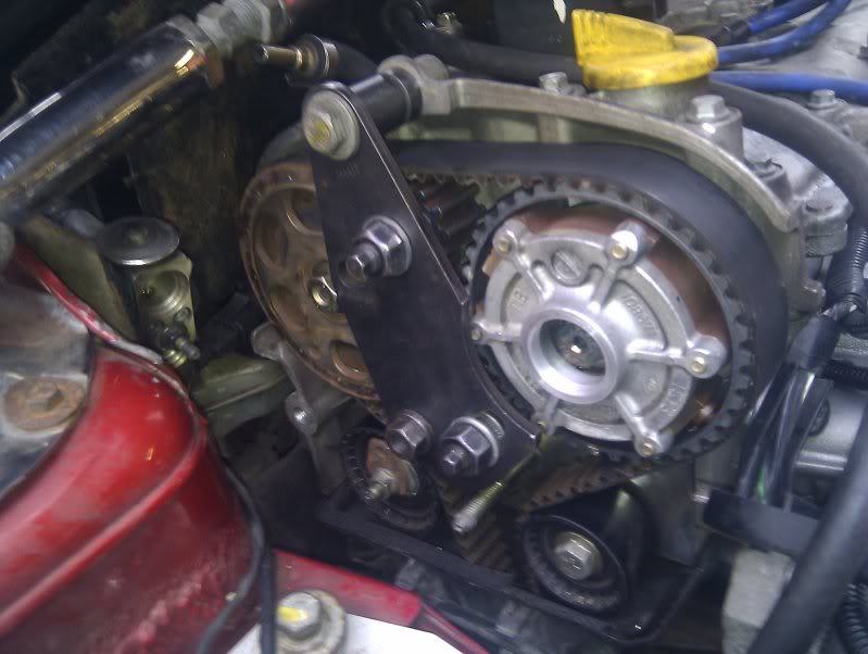

Just been to M-tech
Timing was out!!!!
So I reset it (after removing and cleaning the pullies)
And locked the pulleys in the correct manner
Good job danny, so its been out the entire time from whoever fitted the cams before!
would explain why it felt so underpowered when i took it round oulten, good show danny, now i guess they can get it all mapped up and making some good figures, nice one
yeah top man danny , they should of knew the cam timing was out before mapping the car but it couldnt be helped , would of saved me a lot of time and money
saturday hopefully or tommorow , im sure they will be on here once its all mapped up again to post up dyno graph , for it to get 182 with cam timing out and vvt disconected i thought that was quite good , should hopefully see good results
Dont think they could have known really. They didn't fit them and have no past experience of that spec cam etc. Not something that you check before mapping either, just have to rely on it being done right

Nick you will be pleased when it comes back im sure, incorect cam timing is so common on these engines and makes a MASSIVE difference. I gained over 30bhp when I corrected my belt timing
