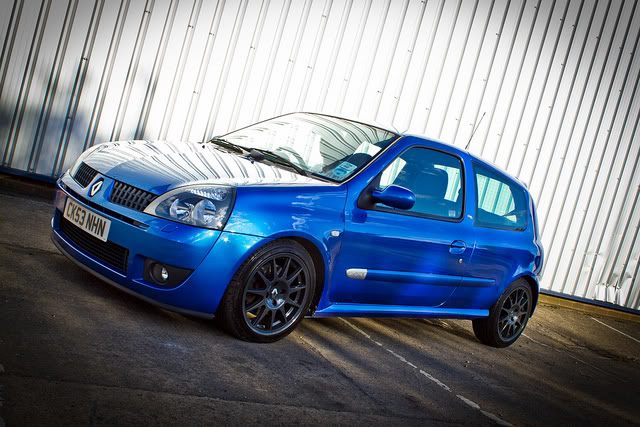

Here is mine, which is lowered on ktec coilovers with rarb. Other than that it is standard.
Thanks for those 2 replies guys, textbook reply Timps and a very nice example you have there!
