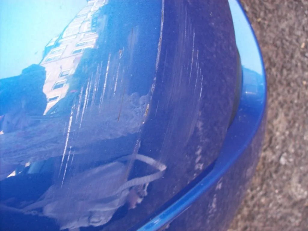

Scraped the car slightly on the front bumper, what can I do to get this out....
A close source suggested T cut.
Can you get someone out to do it for you? If so can anyone recommend a company?
Depends entirely on how deep it is. If it's gone through to the plastic, it'll need paint, other wise you might get away with using something like SRP, and a lot of elbow grease.
pics
respray thats down to the plastic.
to make it a little better you could Wet and Dry it with 3000 Grit auto detailing Wet and Dry then polish but you still will have scrapes.
**edit**
forgot to add there's a usual rule of thumb if it disappears when wet it'll polish out.. if you see it when wet its a respray..
Is down to primer in some places and plastic in others. Wont ever polish out. Have you got any polishes? Not worth buying any, but if you have something, worth giving it a go over to try and minimise how bad it looks.
if it was black on black you'd be sorted mate as its blue on black I dont think you'll get away with it but keep us up to date :) good luck!
