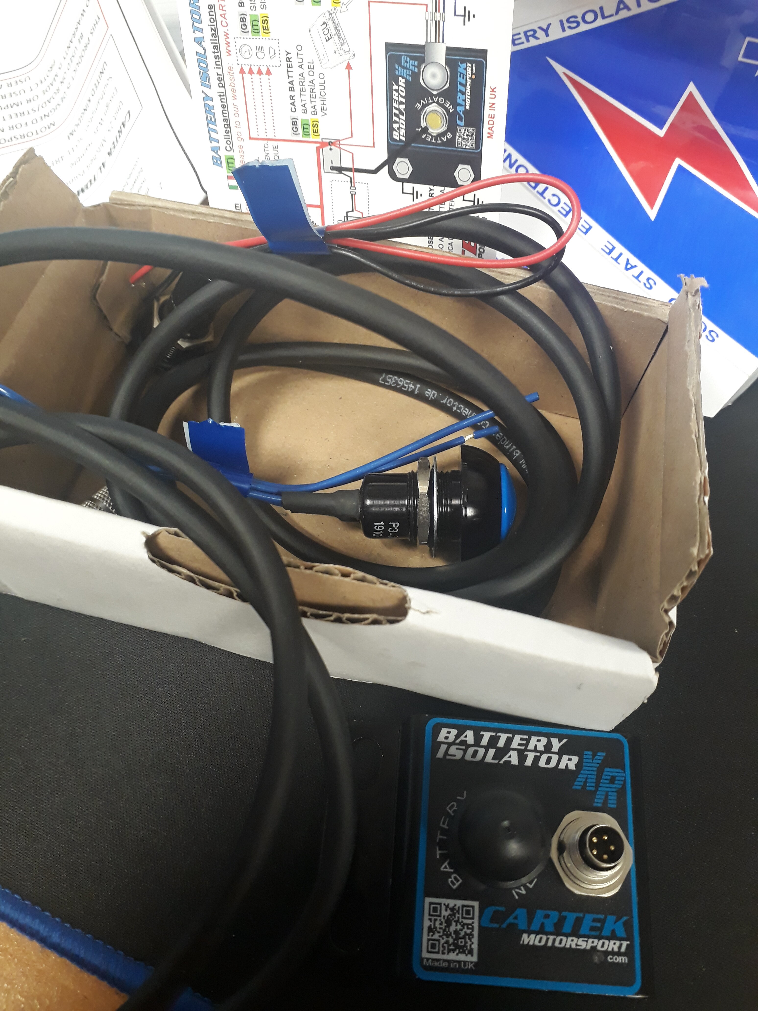

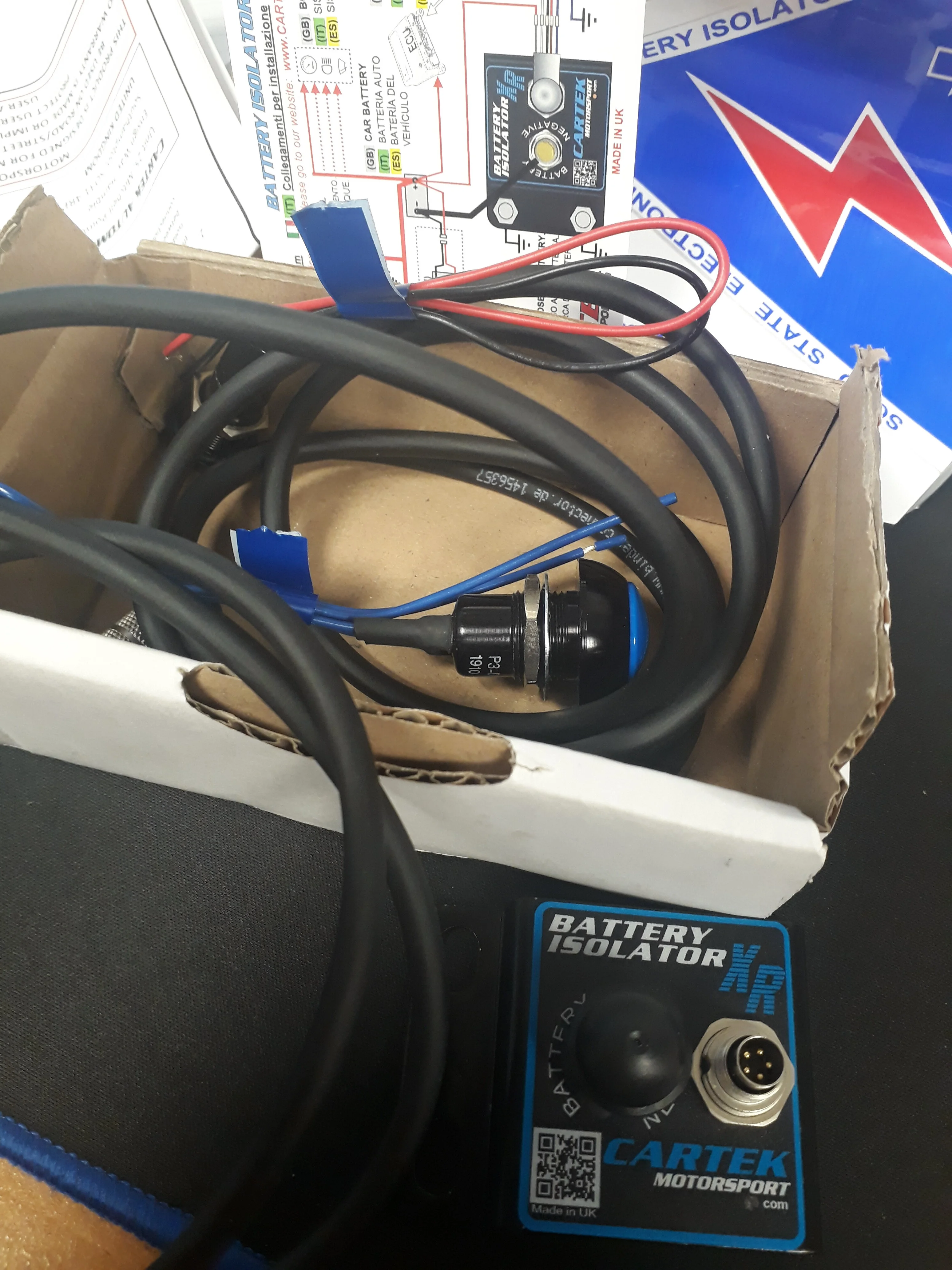

I bought my race car with the setup you describe, but wasnt the best execution. (poorly cut and soldered to the existing power cable). i moved the key turn from the dash above the glove box to the radio panel as it was hard to reach with harnesses on, but it was pointed out its possible to knock the key when gear changing, so i looked to renew but eventually found a good deal on a cartek XR isolator.
