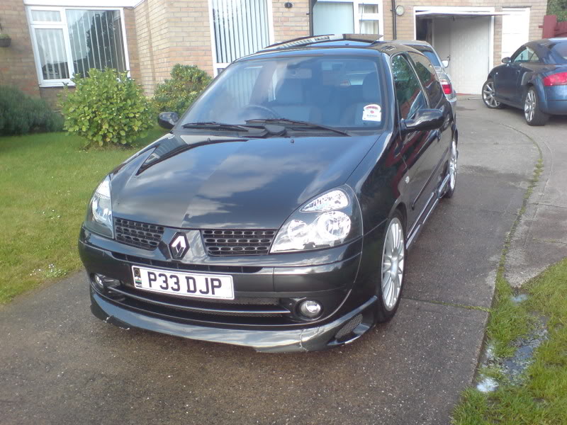

Basically got a touch up or two to do on my splitter on my car before I sell it.
Ive refurbished my wheels before and they came out like new, my spraying is very good as im patient and dont mind sanding down.
Just a question though, the corner of my splitter has split completely on the corner... so now I need to fix it back to the splitter which remaind attached to my bumper.
Anyone used a fibre glass kit before? Any tips hints? Or any good guides you know off? Ive browsed cliosport guides but no luck.
Thanks
Mmmmm havent got any pictures off it fallen off, only because its held on with black gaffa tape , so when I take it off, its a b1tch to get back on...
I have this photo:
If you look on the right side (facing photo not cars right) you can see a crack.. well basically from that crack its completely fallen off, as in the corner part
drop bumper off, or just splitter if it comes off seperate, then fibreglass it from the back
grind the crack down at the front and put some in the front, grind that down, skim of filler, prime, paint
if its completely snapped id probably reinforce the back too thinking about it
screw a metal piece accross the back. countersink 2 small screws at the front then grind the heads off if needed, then fibreglass and fill
