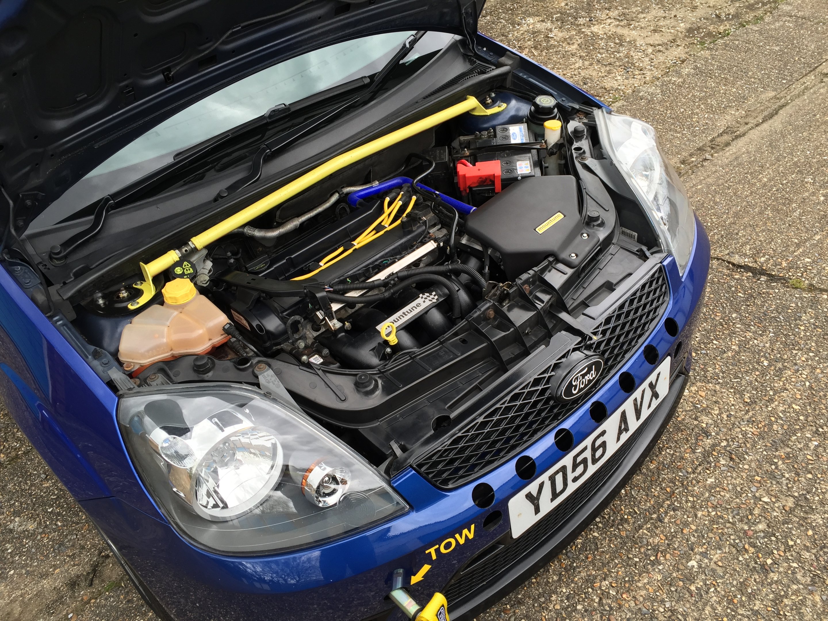

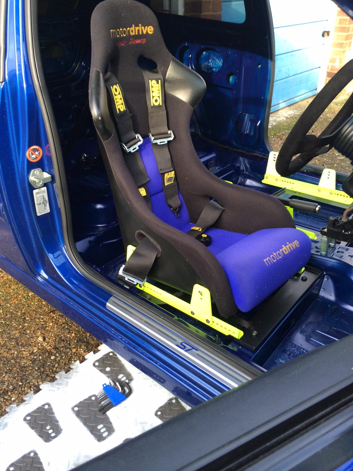

This was mine.

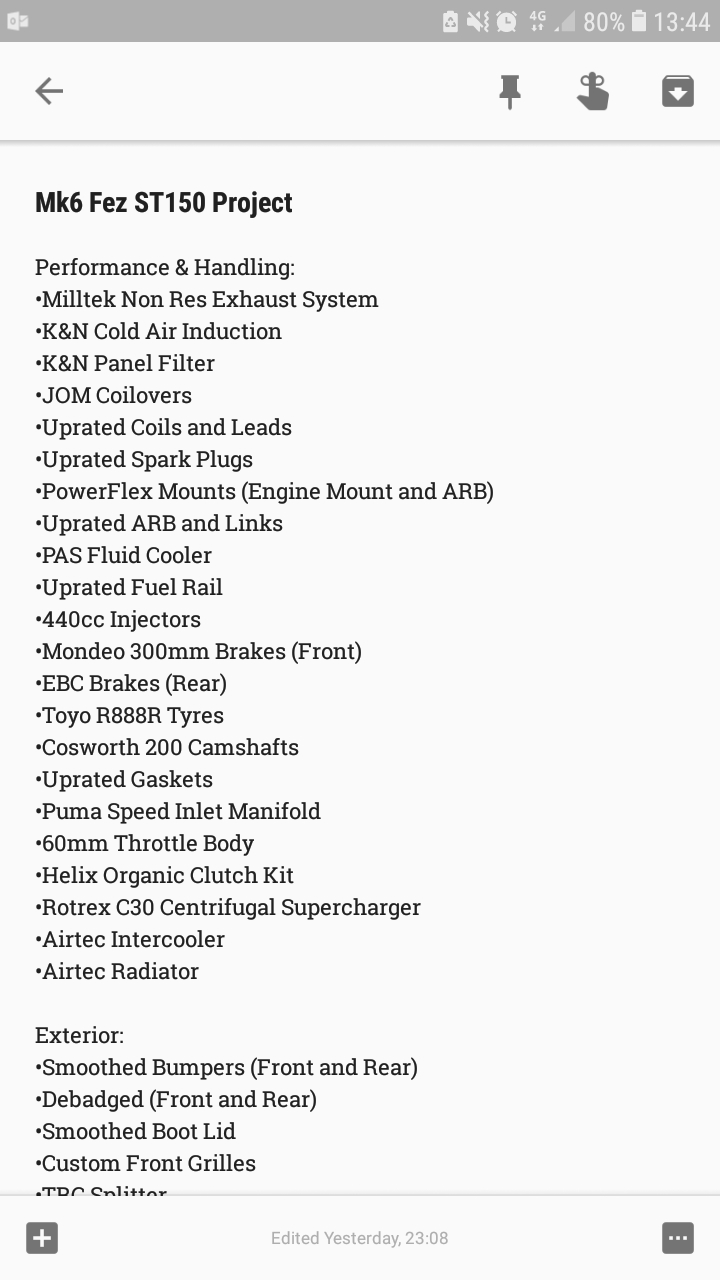

I have been shopping around and updated my list of stuff which I'm happy with.

Then I'd probably be better getting the EBC big brake kit then if that's the case?..
You won't need bigger injectors or fuel rail.
Mine was MR 200 with no engine mods other the a baffled oil sump, oil cooler and PAS cooler. I used 10W 60 oil as well. Most of the time the revs will be high due to the gearing of the fiesta.
you can use, like I did, final drive from a 1.4 fiesta giving better pick up out of corners.
Just buy the front calliper brackets from a focus ST170 (eBay) discs for a ST170. Genuine Ford discs will be fine if not better then some aftermarket discs.
Keeping the front calliper of the fiesta will work fine. If you look for pads listed under the focus ST170 it gives more pad options.
You won't get this many pad option using mondeo calipers.
If your going to use 15inch wheels you need to shave the back of the calliper be 2/3mm and you can't run wheel weights. Not on on the inner edge any way.
This will be fine for track use, touring cars never use wheel wieght.
Any thing you want to know drop me a msg, I went very deep into my fiesta have two friends with them as well and all working at Ford/Mountune.
