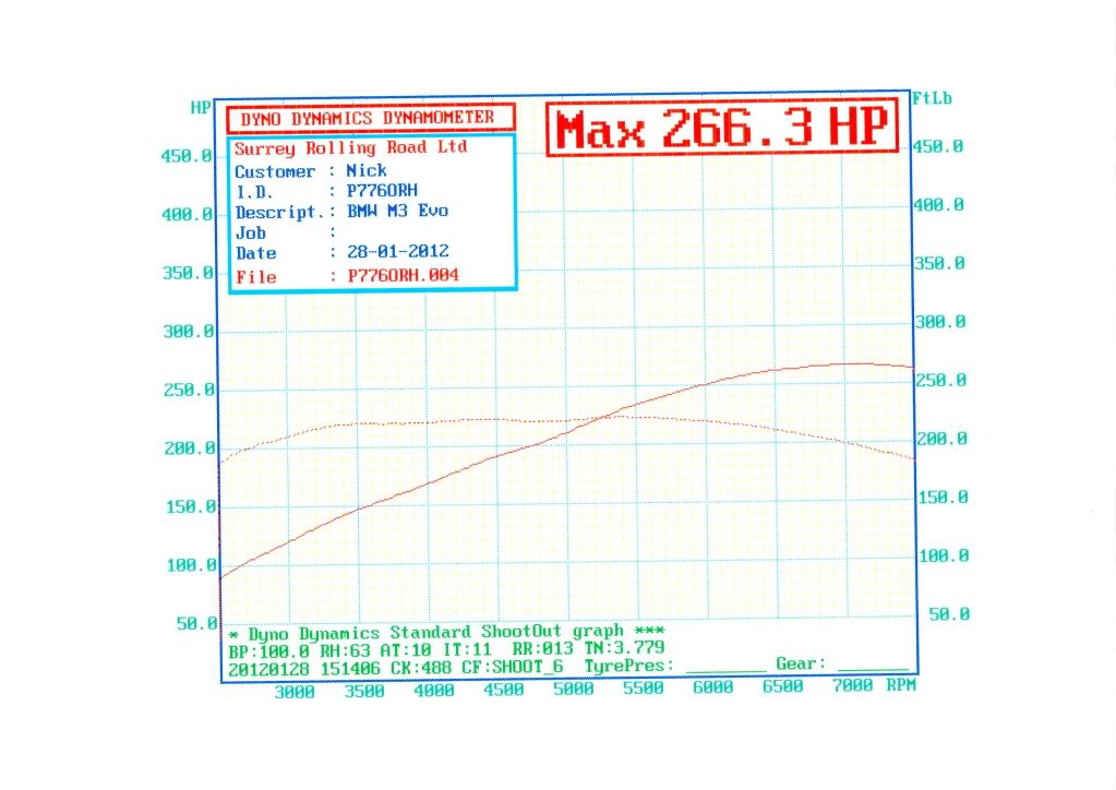

With working away I knew I'd be missing the annual Surrey rolling road day and really wanted to take the M3 to it, thankfully Ollie82 on here said he would as his Cups 'hibernating' atm. Eagerly waiting on the day for him to text me saying how it did, the cheeky fecker text me saying it had only made 266bhp and that there was Vanos problems and restrictions with the standard airbox and filter. Rest assured at the time I was pretty pissed/gutted but thankfully 5 minutes later he text me the actual figures...
Flywheel figure -
Wheel figure -

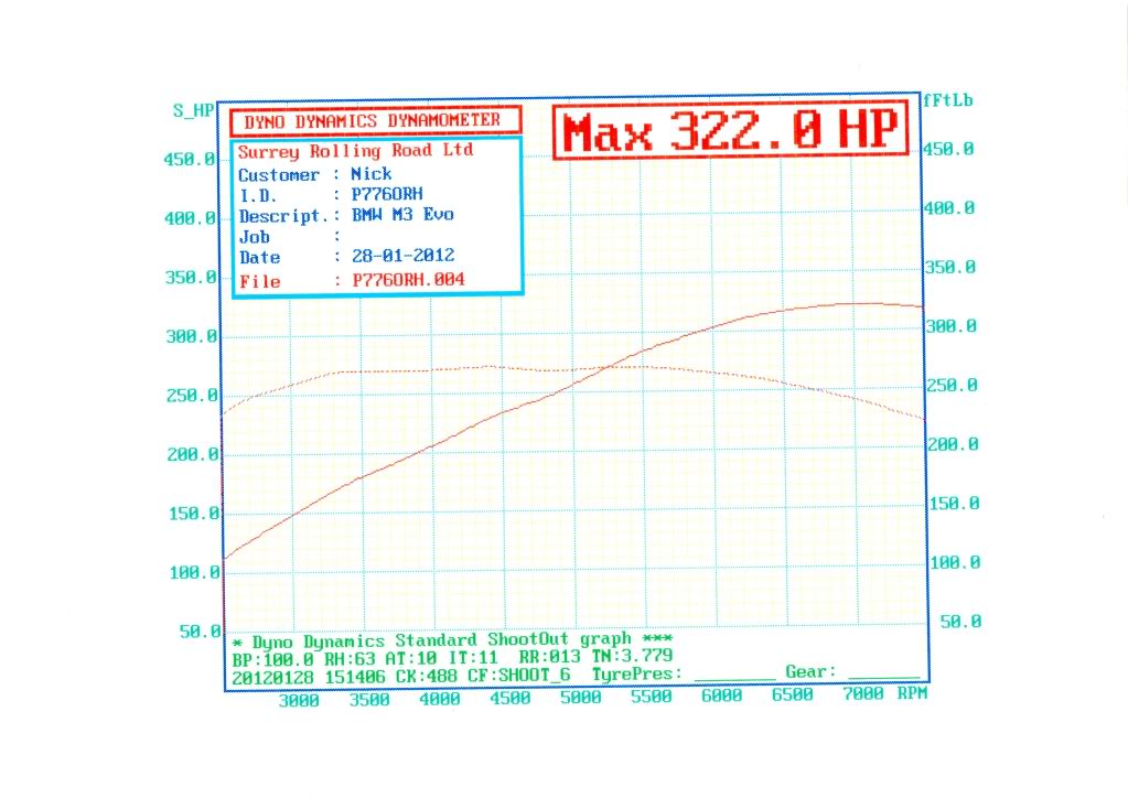

Rest assured i'm over the moon with the results, standard they are 321bhp so for this to make over book power is pretty impressive as the Evo engines never seem to make book power...
The best part is I had taken off the Simota air filter that people rave about and put the standard airbox and a Gen. BMW air filter on the car and its made more power and torque with the standard setup! Simota setup on top and the standard setup below...
So a nice 9bhp and 10lb/ft of torque gain with the standard induction setup, it actually now holds more torque at higher rpm also! Apart from the changing the induction side of things I had changed a couple more things, them being...

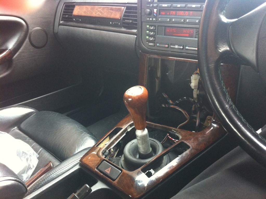

Having purchased some wood trim last year for the M3 which was taking out of the car before I purchased it I was going to get it refurbished as it was a little worse for wear. Then last week a fellow off M3Cutters had purchased a new M3 saloon with the exact wood mine should of had, he wasnt really interested in having wood so a few pennies were exchanged and swapped my standard black plastic parts over and I had the wood trim i've wanted for ages! Finished fitting it all yesterday, also fitted the new Gen. leather handbrake and gear gaitors also. A few little cracks as they do over time but nothing too extreme, you could say it has still worn less than the year of the car.
The finished product!
Wood interior and a saloon, old man status achieved I think! lol

lol @ retrofitting the sodding wood.
I do understand your thought process though Nick - as BMW intended is a good way to do things. Although admitedly i'm retrofitting some refurbed 'Carbon Cube' trim from the normal Sport model to mine - instead of the M3 'Titan Shadow' stuff. So thats OEM+, which is also fine ;)
  Saab 93 Aero Wagon
If you'd have told me a year ago that in a years time you'd be getting wood over wood trim for an old BMW uberbarge, I'd have beaten you over the head with your own shoes.
It pains me to say it but I actually prefer the look of the wood over that horrible plasticky trim you had in there before.
