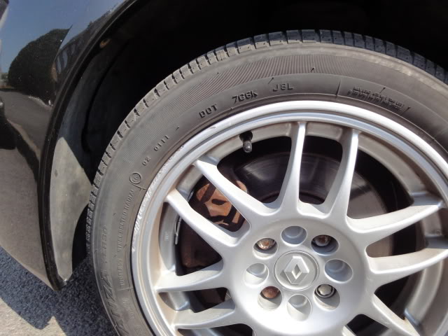

First of I replaced the Dephaser pulley because it was noisy (thanks to Tom at West's for sorting the pulley) and fitted a new timing belt kit and auxiliary belt, while the car was on axle stand I got down to cleaning the wheels swell.

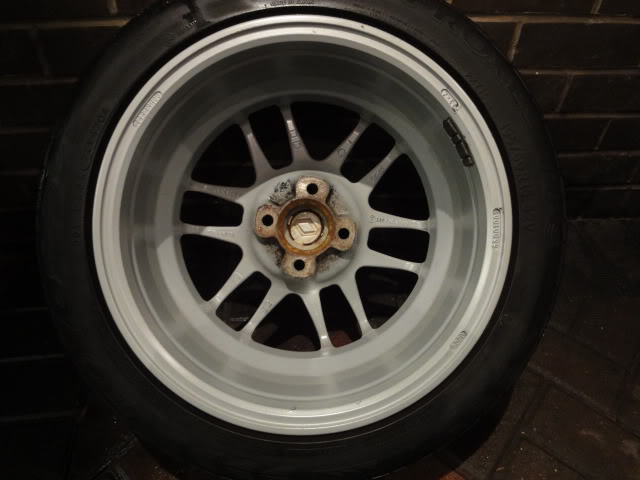

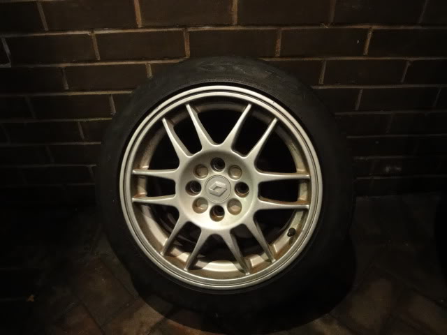

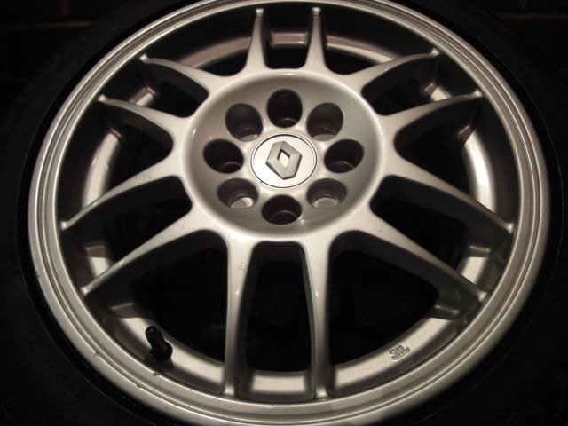

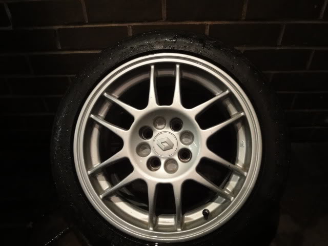

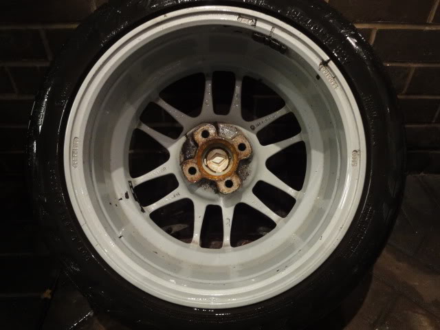

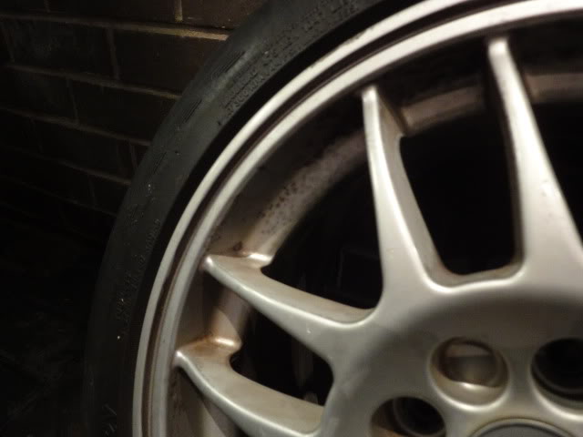

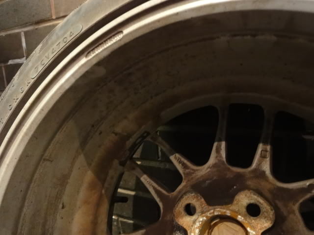

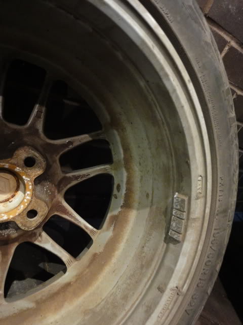

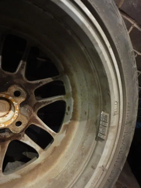

Some befores of the wheels
Got to work on them with some AS Smart wheels and a swissvax wheel brush and they looked like this then

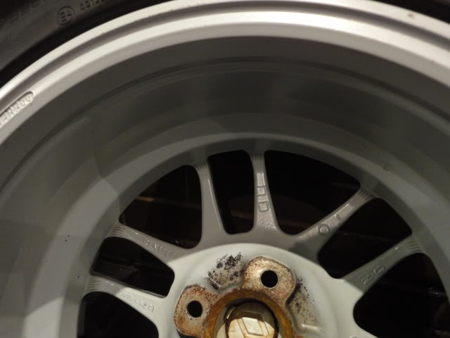

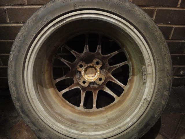

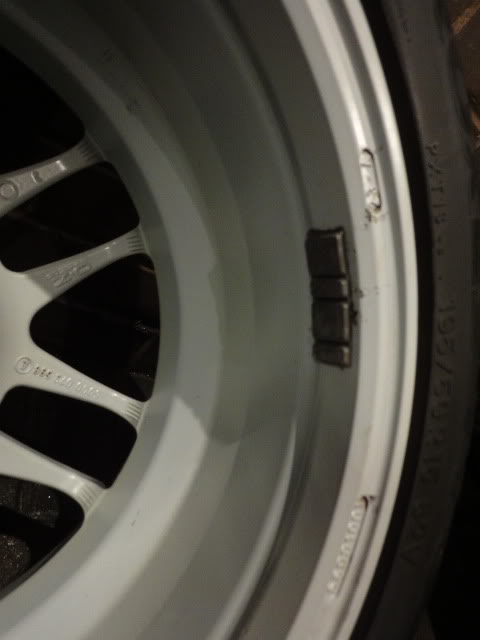

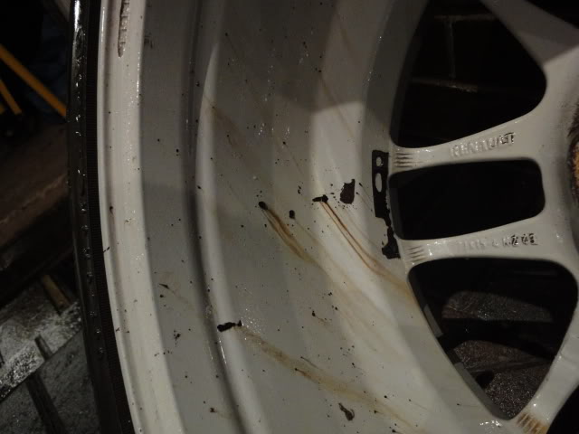

Still not perfect with all the tar and left over wheel weight adhesive, so some AS Tardis was required
Tardis at work
After the tar was dissolved by the Tardis all that was left was the weight adhesive which took ages to remove but looks so good once removed.

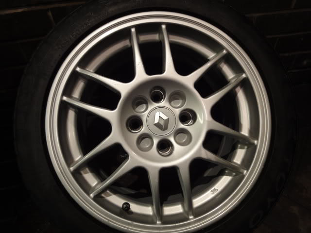

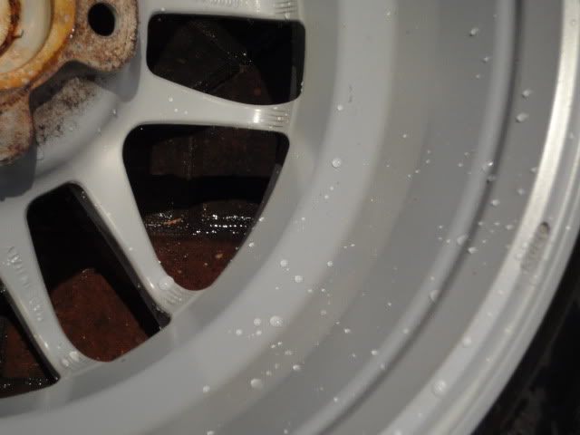

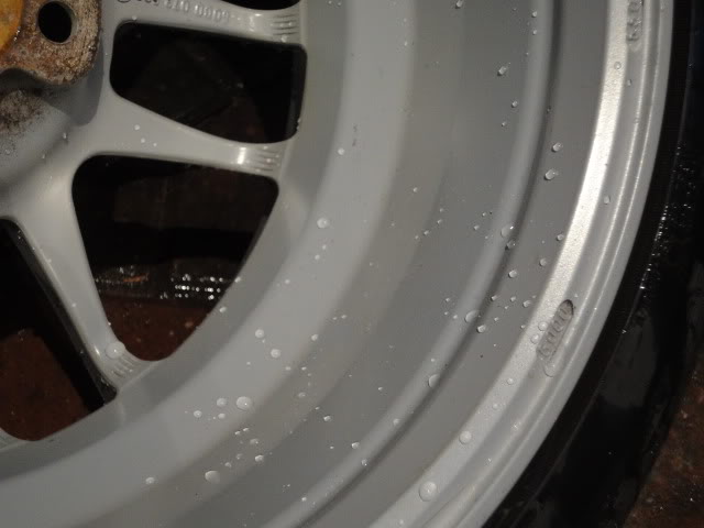

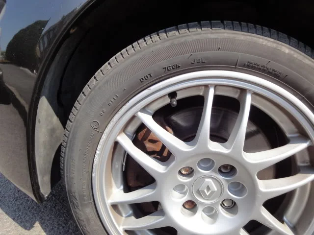

Now all that was left to do was apply some wheel sealant or wax, in the past I've used Poorboy's Wheel Sealant and FK 1000P both which are really good but the end of last year I ordered some GTechniq C5 Wheel Armour that is so easy to apply and remove and the protection and beading it provides is the best I've seen.
And now for some beading shots
I only took photos of this wheel but the process and result was the same for the other, I even did the spare too while I was at it.
The wheels do need a refurb but that can wait until summer.

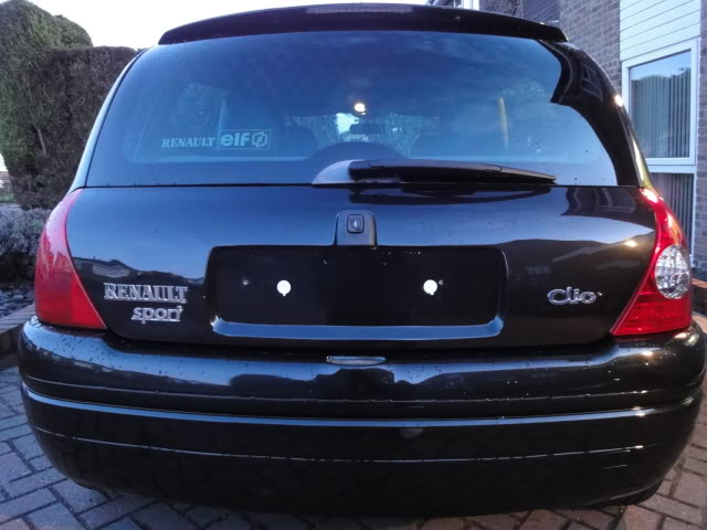

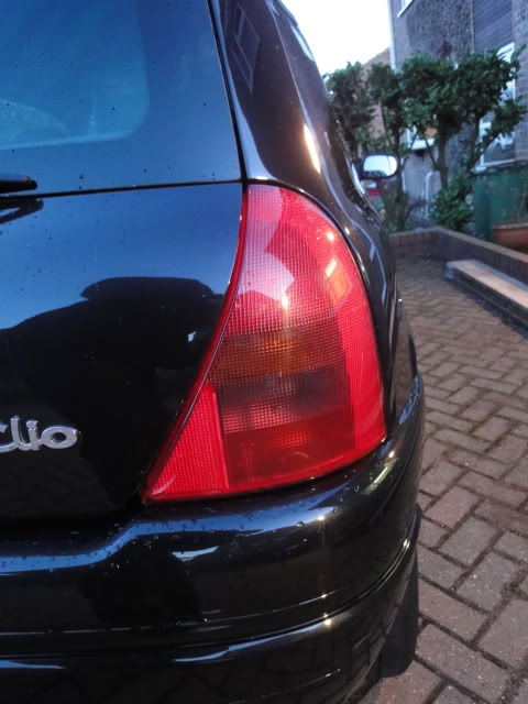

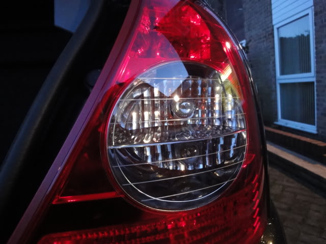

After winning an auction for some phase 2 rear lights on EBay they arrived and were in great condition, a quick polish with Meguiars PlastRX and a couple of layers of Chemical Guy's Jet Seal 109 I decided to fit them one night after work.
A few befores
And with the help of the guide on here it was a lot easier than expected
and a photo to compare the difference between the two
even fitted Silvervisions to the new light
and all that was left to do was to do the other side
Now I know that not everybody likes phase 2 lights on a phase 1 but I think they do brighten up the rear of the car.

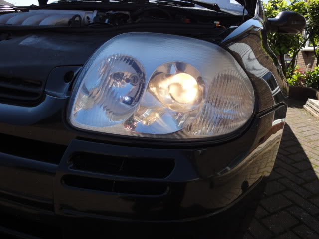

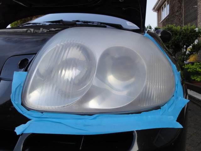

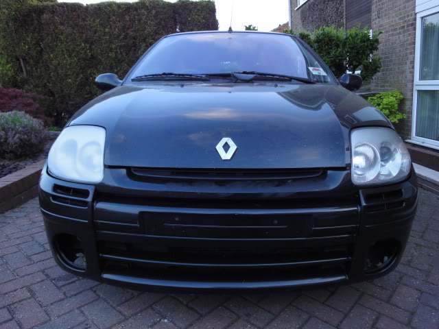

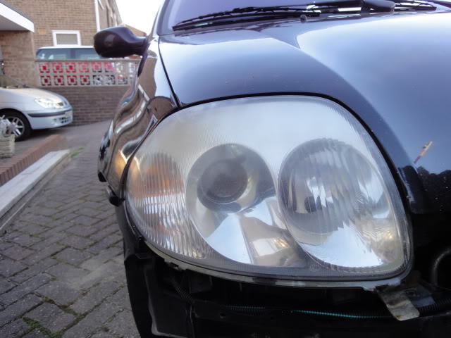

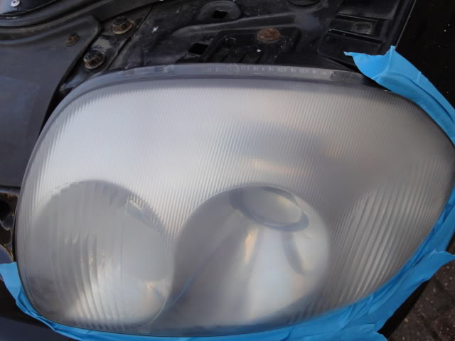

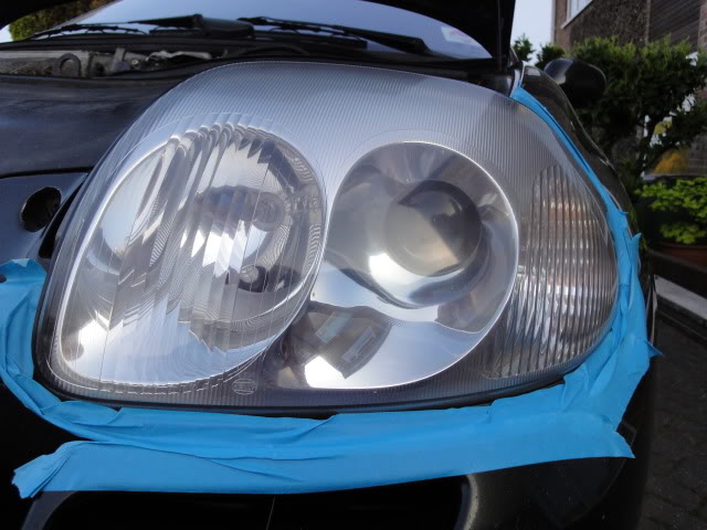

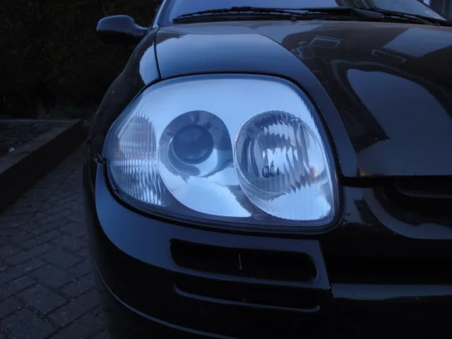

Now it's time to sort the front lights they had started to fade around the top so some wet-sanding then a polish was on order, I did do these once but wasn't too happy with them cause I hadn't sanded all the oxidation out of them
As expected some befores

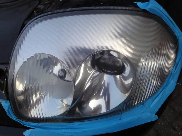

You can just see the haze around the top of the headlight in the photo, so a going over with 600, then 2000 and finally 3000 I was happy with then but they both looked like this
Time to polish them up so I broke out the UDM and Meguiars PlastRX and it started to shine again
It was looking a lot better and now time for another comparison photo
Looking a lot better now to do the other headlight

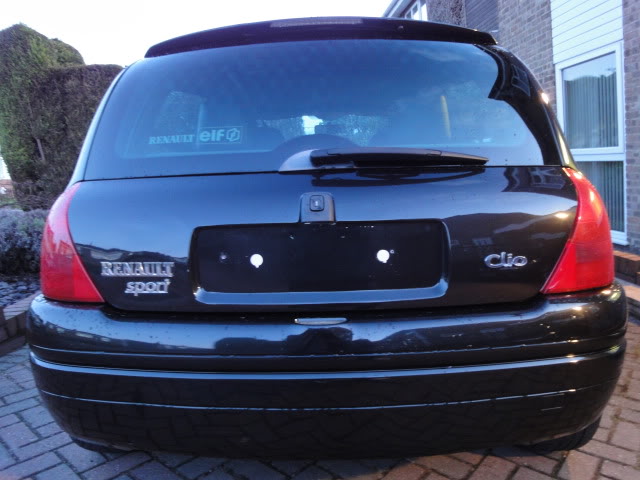

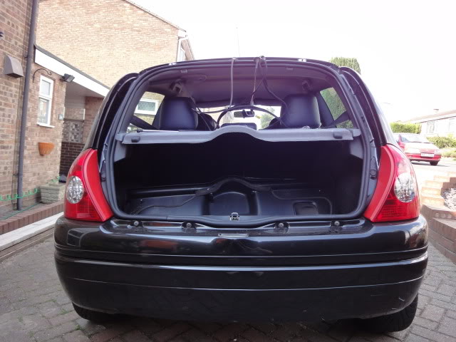

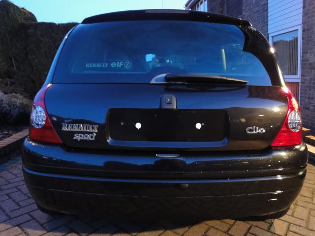

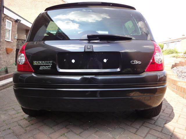

The Clio sat like this for a couple of weeks until I won a Clio phase 2 boot lid of EBay which was a bargain and was only a couple of streets from where I live, that was collected and all that was left to do was fit it,
As normal a before photo

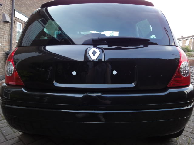

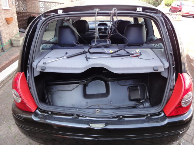

Removed the interior boot trim and plugged and extracted the wiring loom unbolted the boot lid and now I'm left with a rather large hole at the back of the clio
And just like that the new boot lid was fitted along with the loom
I also know that some people might now like the look of a phase 2 boot lid on a phase 1 clio but it was a bargain and it's now got a nice shiny Renault diamond on it, and I took the clio badge off to clean it but it has started to pit in a few places so I'm in 2 mind whether to refit it or buy a new one.

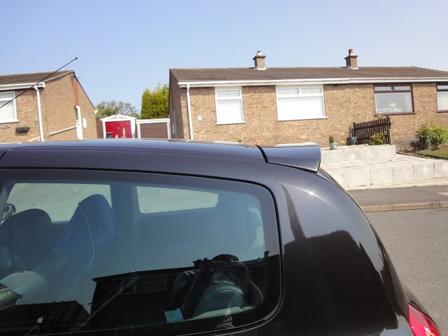

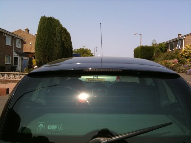

Cup spoiler time!
A before
This next photo was taken by my Iphone because my camera battery died, so unsure of quality
No during photos cause I was just getting on with it and I kept getting dragged away by my Dad wanting help every 5 mins.
But now for the afters
The car looks so much better with the cup spoiler fitted, there are a few small bits that need sorting with the spoiler but they will get tidied up in the next few weeks.

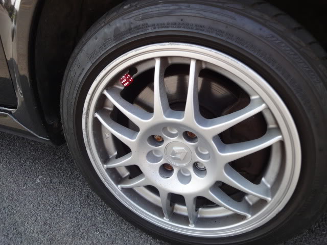

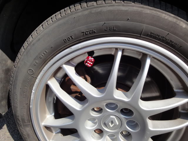

Now for 4 very small changes
Before
After
I like them, they bring a little colour to the wheels and look great especially when the tyres are dressed

Dust caps - Remove
Lower it
  VW ID.3
Cup spoiler was of eBay, it came pearl black so I didn't need to paint it.
What's wrong with the dice valve caps?

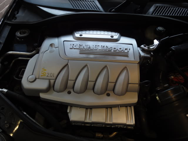

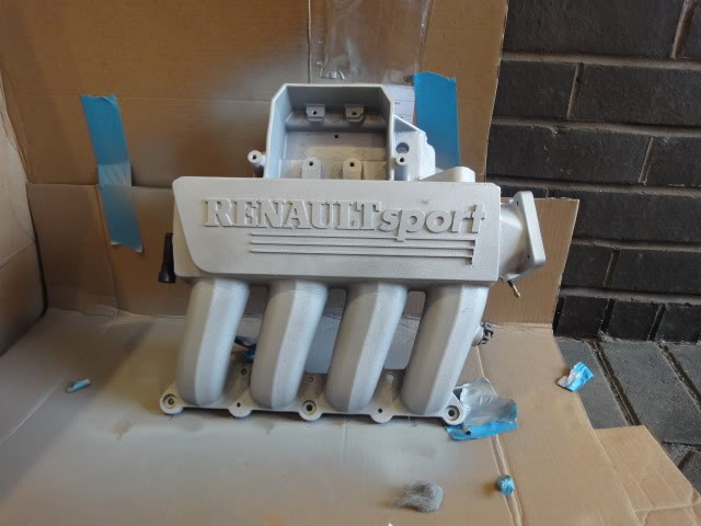

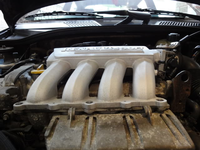

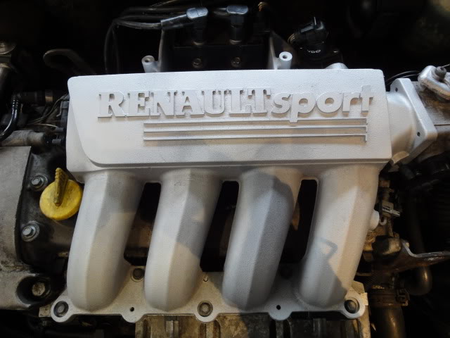

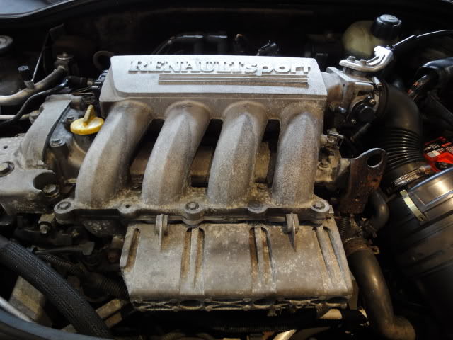

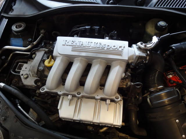

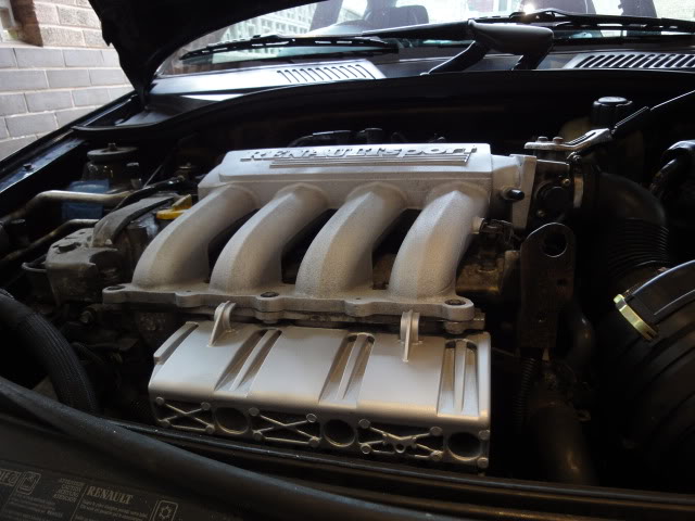

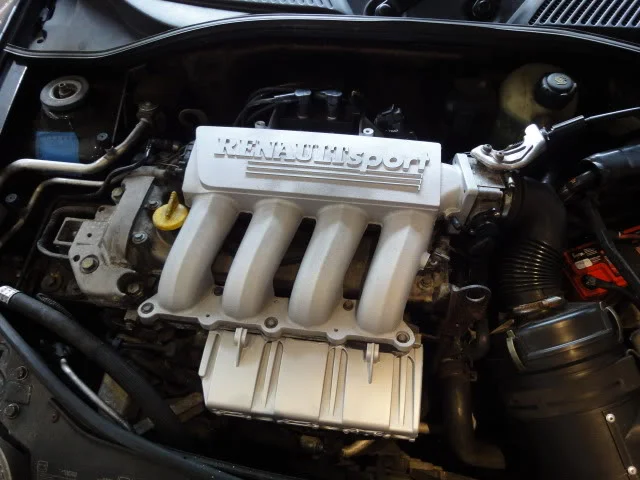

Got fed up of the inlet manifold looking crap so got some Halfords silver high temp paint and got cracking taking the inlet manifold off
before shot
Got the manifold off and was to eager to paint it so didn't get any pictures off the car before painted but heres one of it painted
and fitted back on
It looks really good but now the fuel rail guard looks crap, so i painted that too

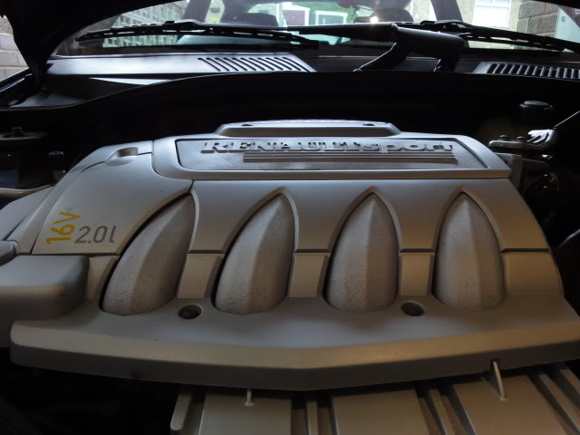

Also decided to clean the engine cover and even applied a layer of Zaino AIO and refit it, (has been sitting in the boot since I changed the Dephaser Pulley and Timing Belt)

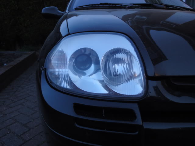

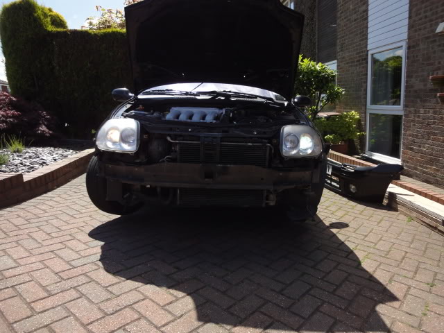

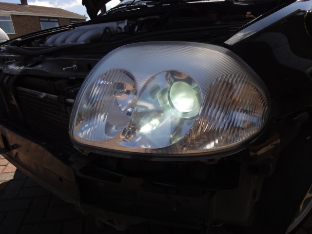

Got chance to work on the car the other weekend, only got a few jobs done, got the HIDs fitted and gave the headlights a bit of a polish again to clear them up a bit more.
Standard Headlight Bulbs
After the bumper, radiator grill and the headlights removed I fitted all the kit for the HIDs then test fitted them and checked that everything was working ok before I refitted everything.
Passger side HID fitted, drivers side still standard
You can just tell the difference in the day between the two,
Then cracked on with the drives side, after everything was checked to be working ok I refitted the grill and bumper.
