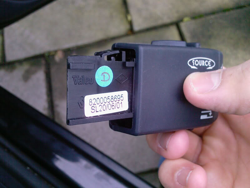

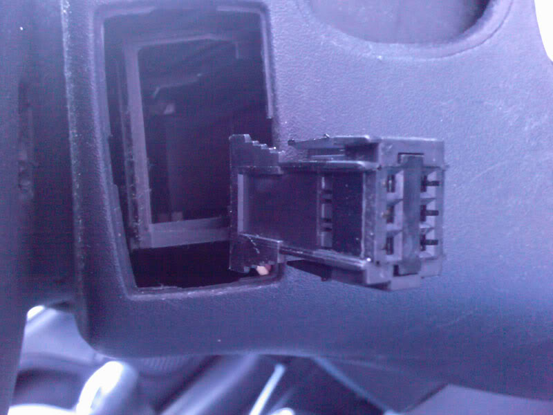

The fingertip control thingymajiggy has seperated from it's place and is only being held in by the wire connecting to it.
I have tried fitting it back in but it doesn't seem to want to clip on or anything and I can't see any damage to any of the parts so I took a couple of pics to see if anyone can see any damage as I am unsure if I should get a new fingertip control or the bracket that it fixes onto.
I've finally sorted it, the little thing sticking up on the control was fairly worn so when I pushed it in it wouldn't spring up to keep it in place.
I managed to bodge it by stuffing some blue tack right into the corner of it and then pushed it in quickly and it managed to click into place.
I'll stick with it for the time being as I've other more important things to spend on for the time being but if it comes out I'll have to buy a new one regardless. I had to take off the cover from the coloumn to see how exactly it clips in to get a better idea of it but was a simple job really.
