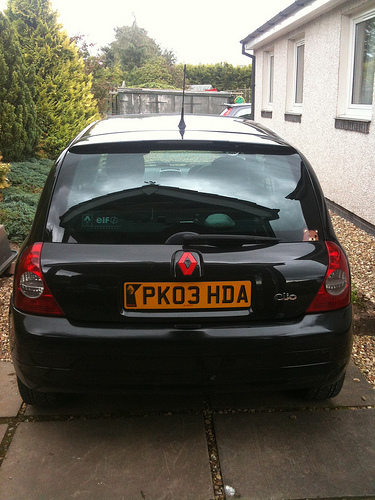

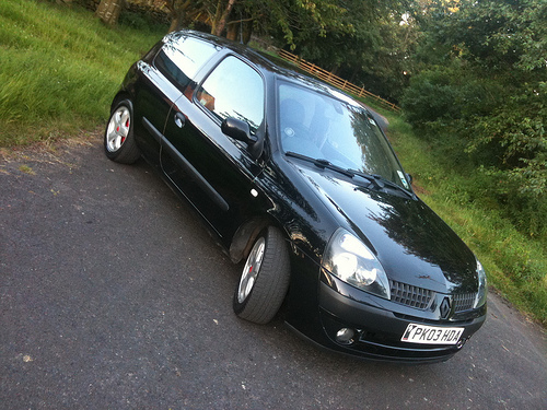

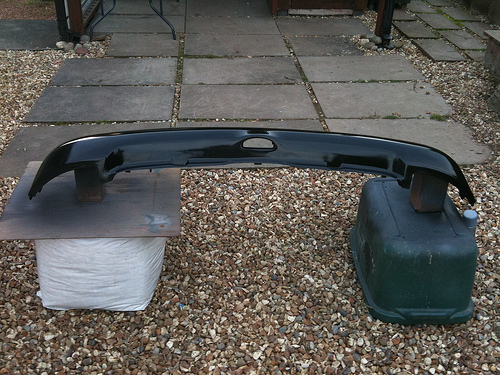

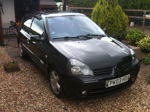

Just finished Colour coding my car yesterday, its the first time I have spray painted and to be honest its came up quite well I think.
Sorry for the low quality iphone pics.

how hard was it to do the bumpers/ side strips? i do abit of spraying myself aswell and want to do the same to mine!
nick
Looks like they could do with a good polish!
Get some 1800-2000 grit sand paper on them, then give em a good polish. Will look as good as the rest of the paint then.
Side strips are easier, because there's less of a flat area.
Bumpers are a bit harder because they're much bigger. Looks a good effort for a first attempt though mate!
As said maybe leave the lacquer for a week then get some really high grade (wet) sandpaper and smooth off the orange peel, then polish it back up.
Will take a lot of elbow grease by hand though!
