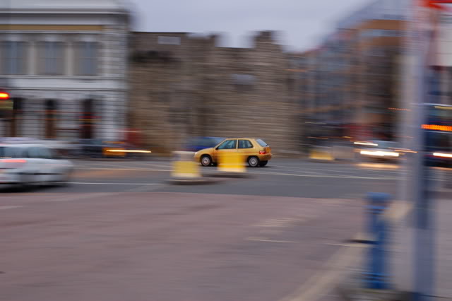

Right, was waiting to get picked up yesterday so thought id have a little play and take some pics of the traffic! lol.. Didnt get half as many strange looks as I expected!

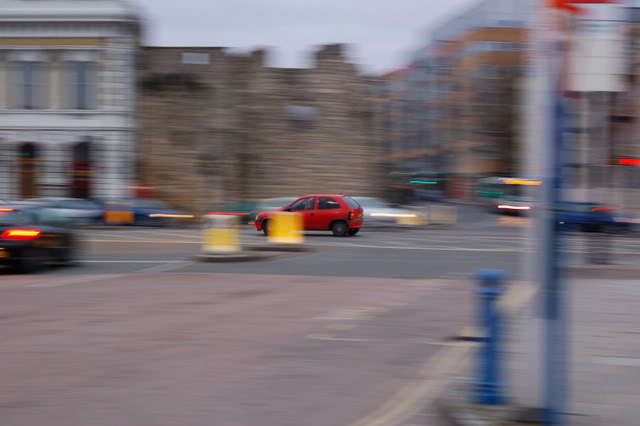

I went with 1/10sec speed. Is that too fast? Too slow? Was using my trusty 50mm. As you can see its not the best location for it. But gave me something to do..

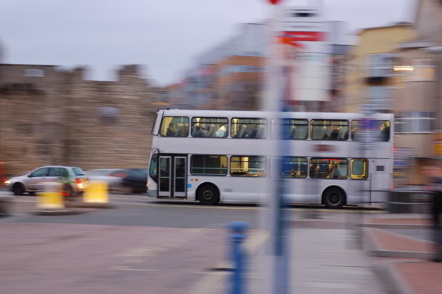

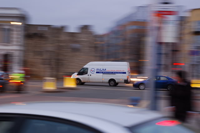

A lot of them ended up looking like this, did I just not pan properly? Shaking? too slow/fast?

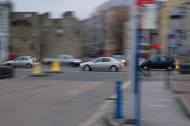

Doesnt look as bad now its smaller but the back blurry and the wheels look like theyve wobbled and are 2ft from the car..

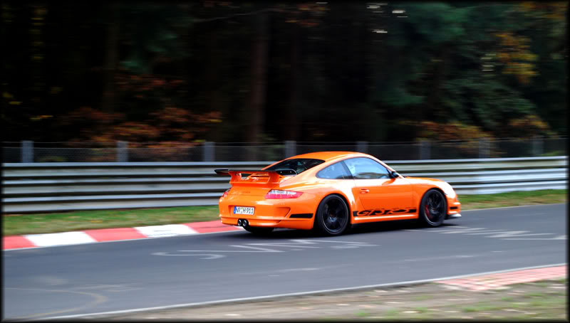

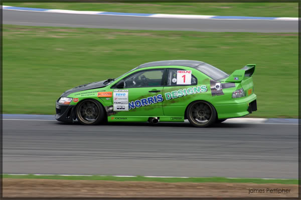

Had a few "better" ones..

I'd have personally gone with a slightly quicker shutter speed, probably 1/40 or 1/50.

The shutter speed is all related to the focal length. i.e. a 200mm lens with a 1/100 shot will show more motion blur than a 50mm @ 1/100.
There is probably a graph somewhere showing the relation of the two but I know that the rule of thumb is that you should shoot at the focal length of the lens x the crop factor of your camera to help eliminate camera shake. So, 200mm x 1.6 (canon) = 1/320 (obviously not to be used for capturing motion blur)
The main thing is, it is easier to pan smoothly for a quicker shutter so you will generally get better results using a longer focal length.
disclaimer, I could be making all of this up..... it was quite a long time ago that I did the "panning" section of my photography class.
  Fiat Panda 100hp
TBF rev, there pretty good, it's just the focal length that's letting you down, the subjects are pin sharp and nice blur. Shutter speed is dependent on a number of factors including light etc. Do what ever you can get away with really without blurring the subject. Practice makes perfect, Chris's guide on here tells all the correct camera settings, which you've probably already read. Very good 1st attempt.

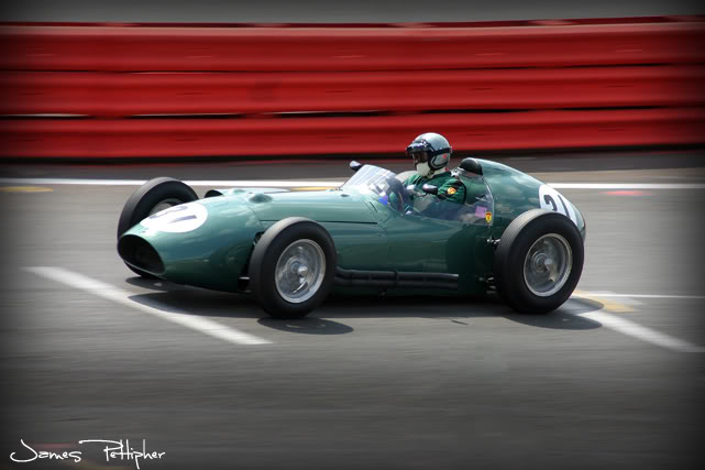

Mine -

No worries, I just wish I could remember stuff like that when I am actually taking photos and not when I get back and look at them on the PC thinking that I should have done something differently. Playing is definitely the best way to learn, and the most fun. Your 365 has more creative images in it than I have in all of last year so you are definitely doing something right!

I was expecting some awfully blurred panning shots, yet the subjects are actually reasonably sharp waaaay off in the distance, especially considering your shutter speed.
You appear to be a natural at this photography stuff, tbh. All I can suggest is more practice as it looks as though you've probably nailed the basics. As others have mentioned though, when you do use a longer focal length, bump that shutter speed up a bit (try 1/50 or something) as 1/10 at anything beyond 50mm is pretty challenging to say the least. The speed of the subject is another factor, town traffic is probably fine at 1/30 - 1/50 even at longer focal lengths, get out to a circuit and try using 1/10 at 300mm or something and your world will be full of fail, quite frankly.

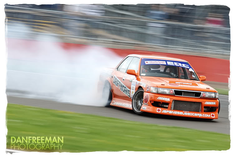

my 2 favourite pics
Ben that motorbike shot is nice, were you actually panning though or taking it out of moving car alongside it.
Justin nice pics, the last one could have benefitted from a slightly slower shutter speed to get more blur though
  Fiat Panda 100hp
Panning, lol. Was bored at work one lunch so went to a nearby dual carriageway. I wouldn't dare do it out of a car window, would get some dodgy looks lol.

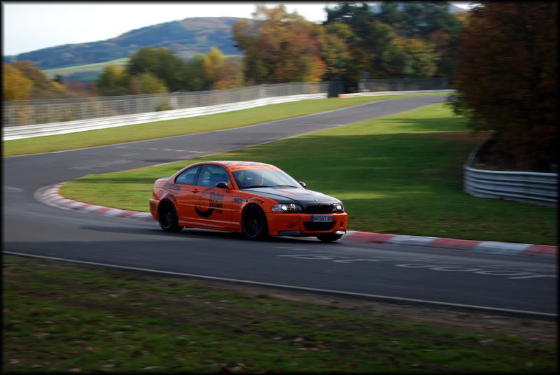

This was about 1/60th I think:
This was 1/30th I think.

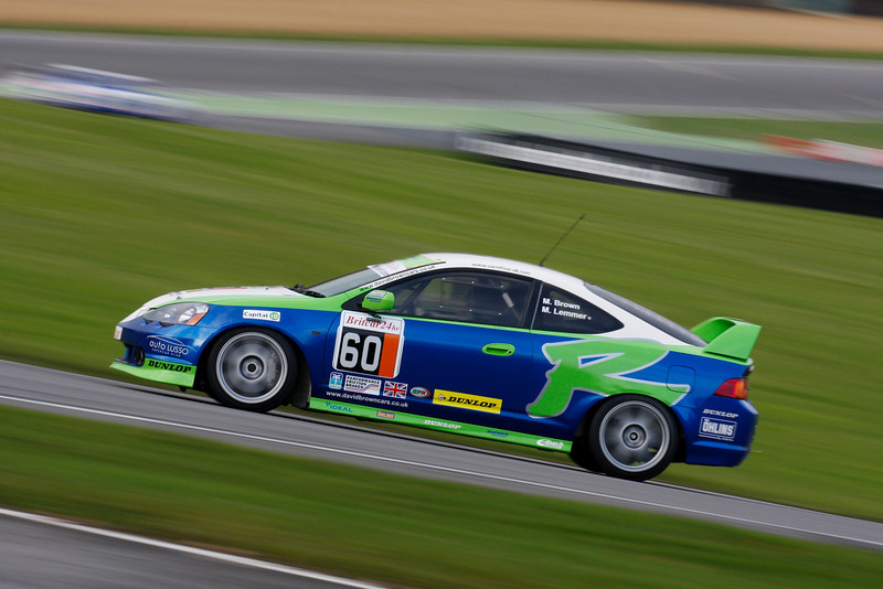

Ive also not found that you need much more than about 1/60 to get some really 'blurred' images.
This is 1/50

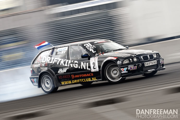

1/50 is definitely a nice shutter speed for very blurred motorsport shots when you're talking 100mph+, but it's worth experimenting with even slower speeds (which will help improve your faster shots anyway) as the effects can be very interesting. 1/60 - 1/80 is probably my average, but I tend to forgo sharpness for sense of speed, there are a few photographers I know who seem to get a reasonable sense of speed out of 1/250 with the same focal lengths and equipment as me, but I just can't get to grips with shooting that quickly.
A nice 1/60 example, whilst we're all sharing :)
On top of that, it's also remembering that when you're at angles when the car is coming towards (or away from) you, the rules change again.You can comfortably take the shutter speed up a few notches to 1/100 - 1/200 and beyond and still get ample blur, any slower and you start to lose big chunks of the subject due to the changing focal plane.
