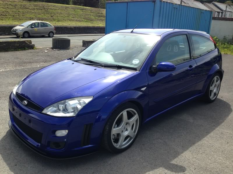

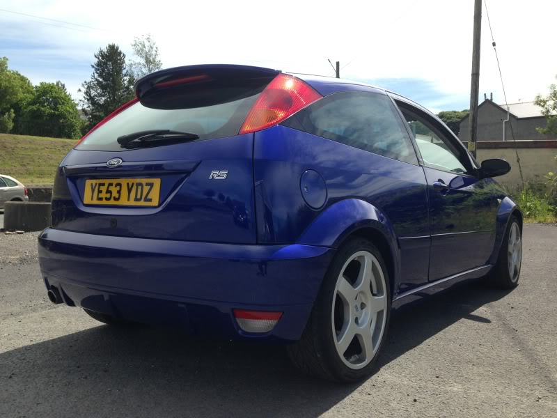

heres what we started with;

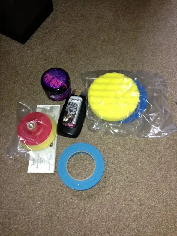

Got my order off i4detailing, can see how this can become expensive.

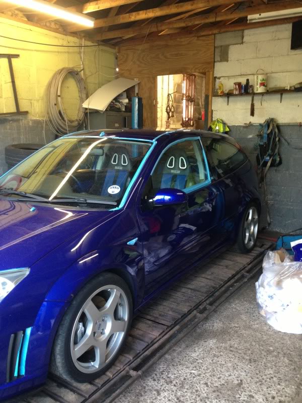

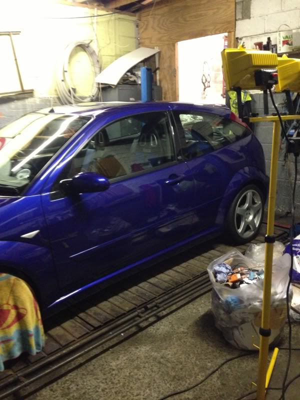

car was dried and put back in the garage on the ramp, handy to have, didnt have to bend so had good access to lower parts of the car

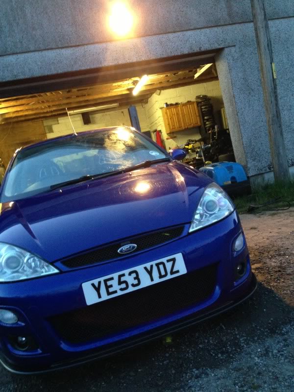

Was hard to see what i was doing so out came the halogens
and all taped up
time to start polishing:

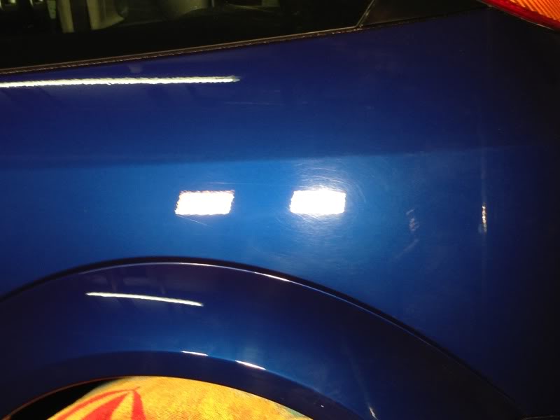

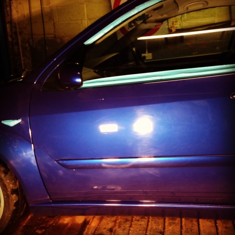

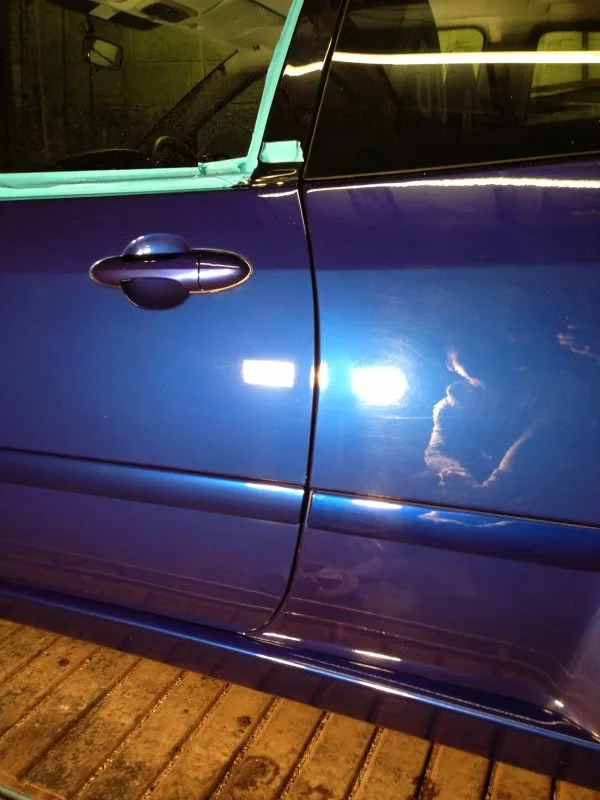

heres the door after one hit with yellow pad and S17, found this combo worked best

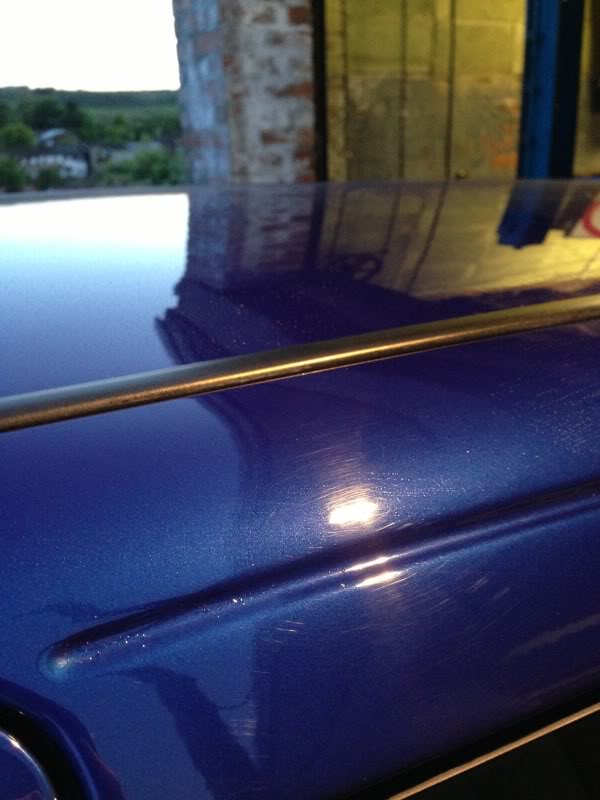

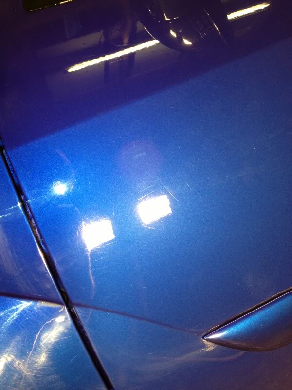

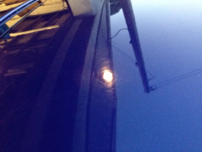

major difference, but the car was covered in, what i believe theyre called RDS?
deep scratches on the car, almost every panel, as said earlier, maybe from washing with a brush or just poor method lol
Lots of deeper ones remain:
decided 2 hits all round would do the trick
Door done, sort of a 50/50
Rear quarter, 50/50 (deeper scratch remaining)

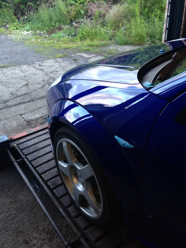

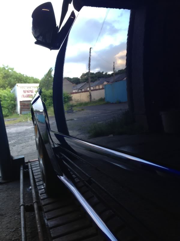

continued on, and got it all finally polished, then i gave it a coat of dodo juice purple haze to finish
was really impressed by that stuff,

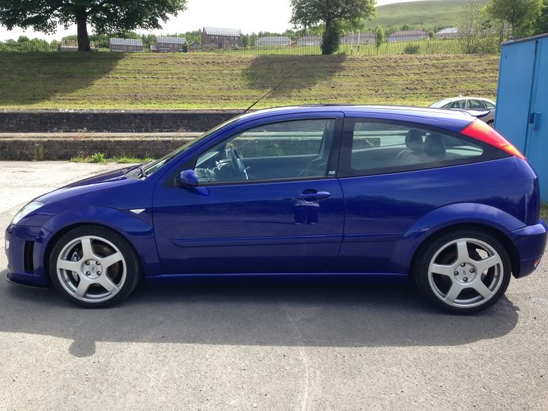

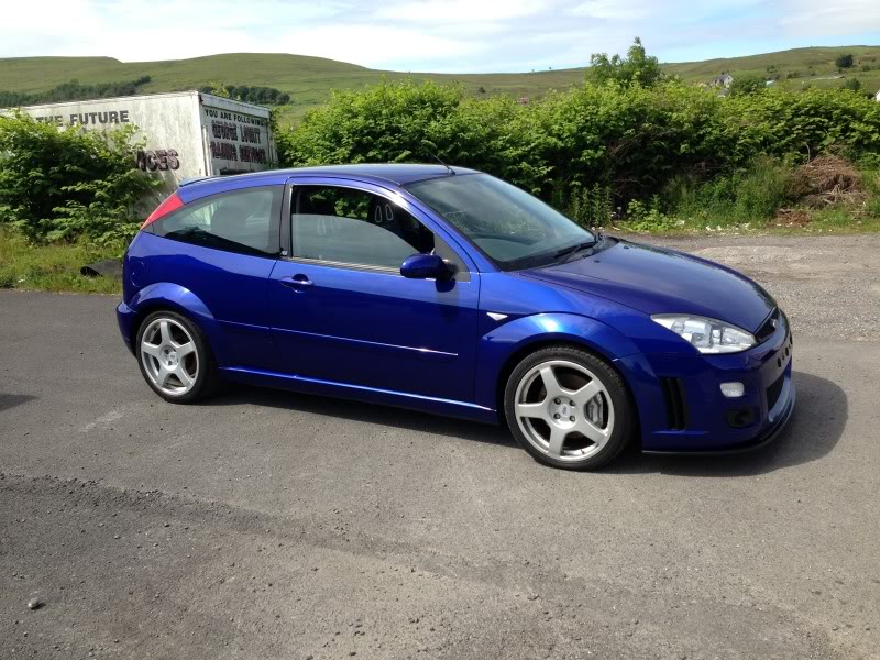

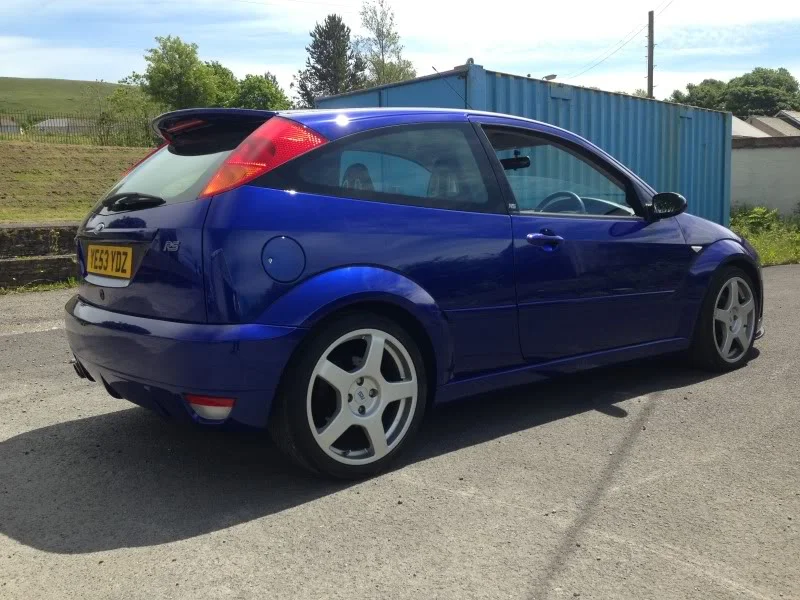

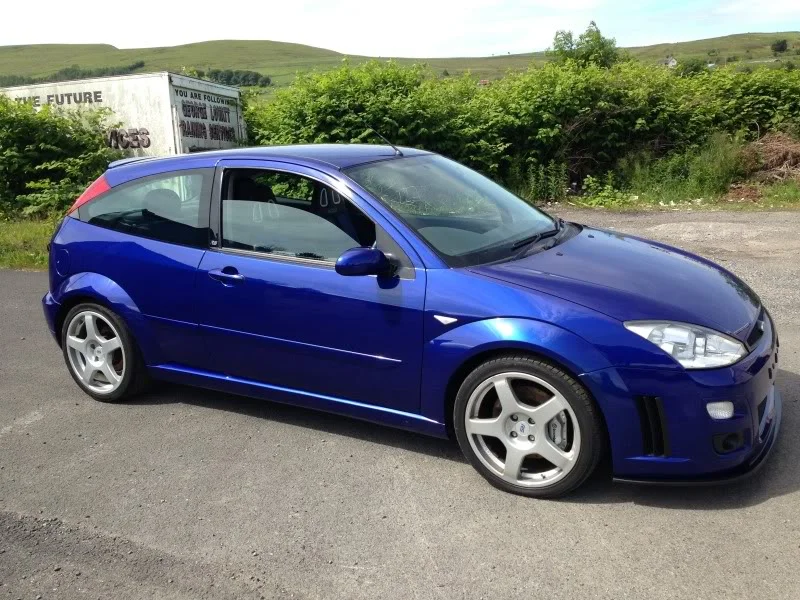

heres some rubbish pictures of the end result, didnt take many as i didnt plan to do a thread lol
If im honest, the uploaded pics make it look s**te lol
but its definatley loads better :)
