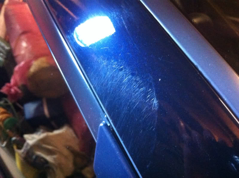

I went for the A pillar on the drivers side to start, the worst area on my car due to a muddy football bouncing off of it and causing quite a bad scuff/scratch patch:
Again, a little aprehensive due to not using one before, I went ahead with the speed set to approx 1.5 and a slow smooth movement from the wing mirror up to about half way along the top by the door line and back down again. Then I upped the speed to approx 2.5 and did the same again, working the product till it was almost completely clear (2 to 3 passes). As I've seen mentioned before, it is supprisingly difficult not to speed up the movement of the machine across the body work just because it is set to a higher speed, almost constantly reminding myself to slow down.

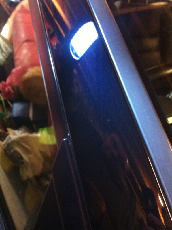

A quick buff up with a microfibre and I was literaly amazed by what I had just achieved:

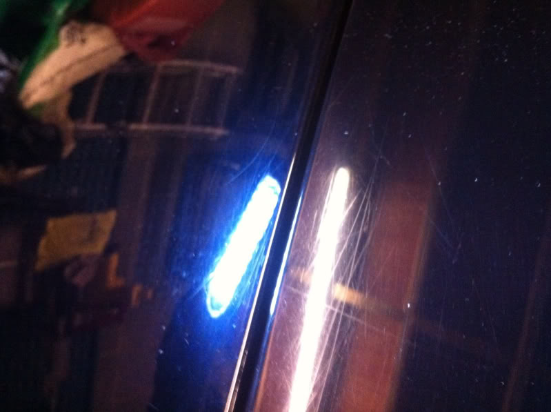

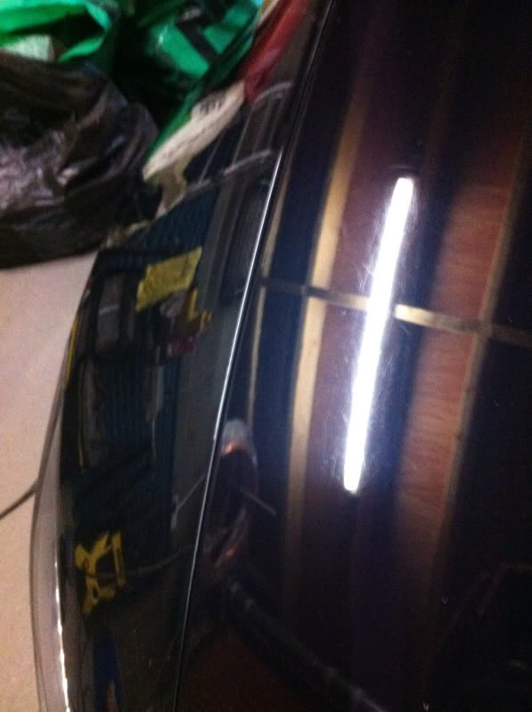

So, massively chuffed with the results I pressed on with the rest of the car. A quick before and after on the bonet/wing here too:
I know it's not like I've achieved 100% correction but that wasn't what I was aiming for as first attempt with a machine. Going at it with a harsher product and a cutting pad straight off the bat would have been even more dumb than not having a paint depth gauge and not testing on a spare pannel.

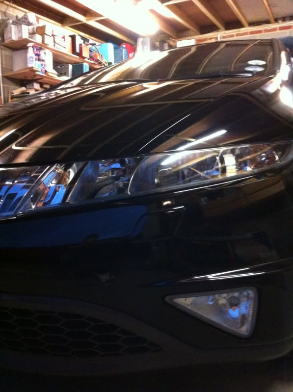

And just for completness I then went over the car with some Z2, then some Z6 then some more Z2. I've never used Zaino products before but what can I say? So simple to use and the finish is great. The pics don't do the car justice, it looks sooo black it's unreal, it's like someone has poured the thinkest, blackest oil over the car, smoothed it out and laquered it on.
