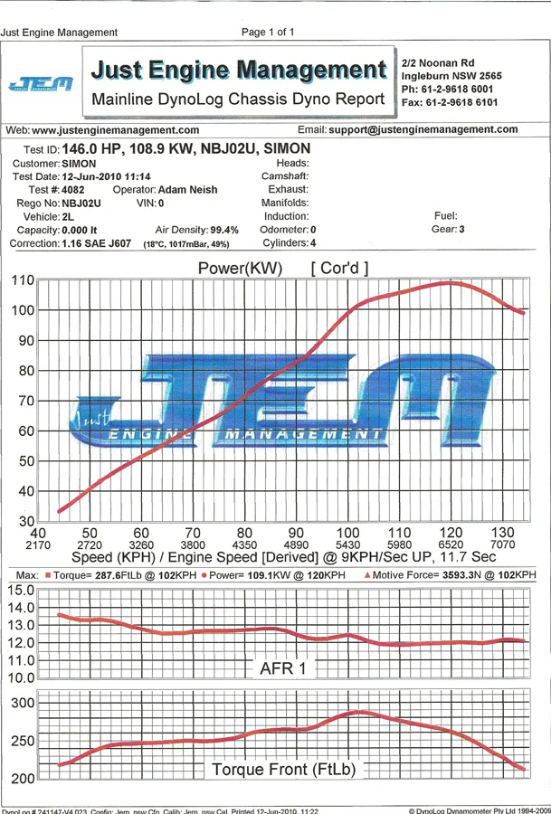

Had the car on a dyno today. Here are the results. Mods are fastchips latest performance cal, and JMS road induction kit with original elbow as my package was missing breather filter.
The dyno operator was very impressed with Henks map.
cheers
Simon
