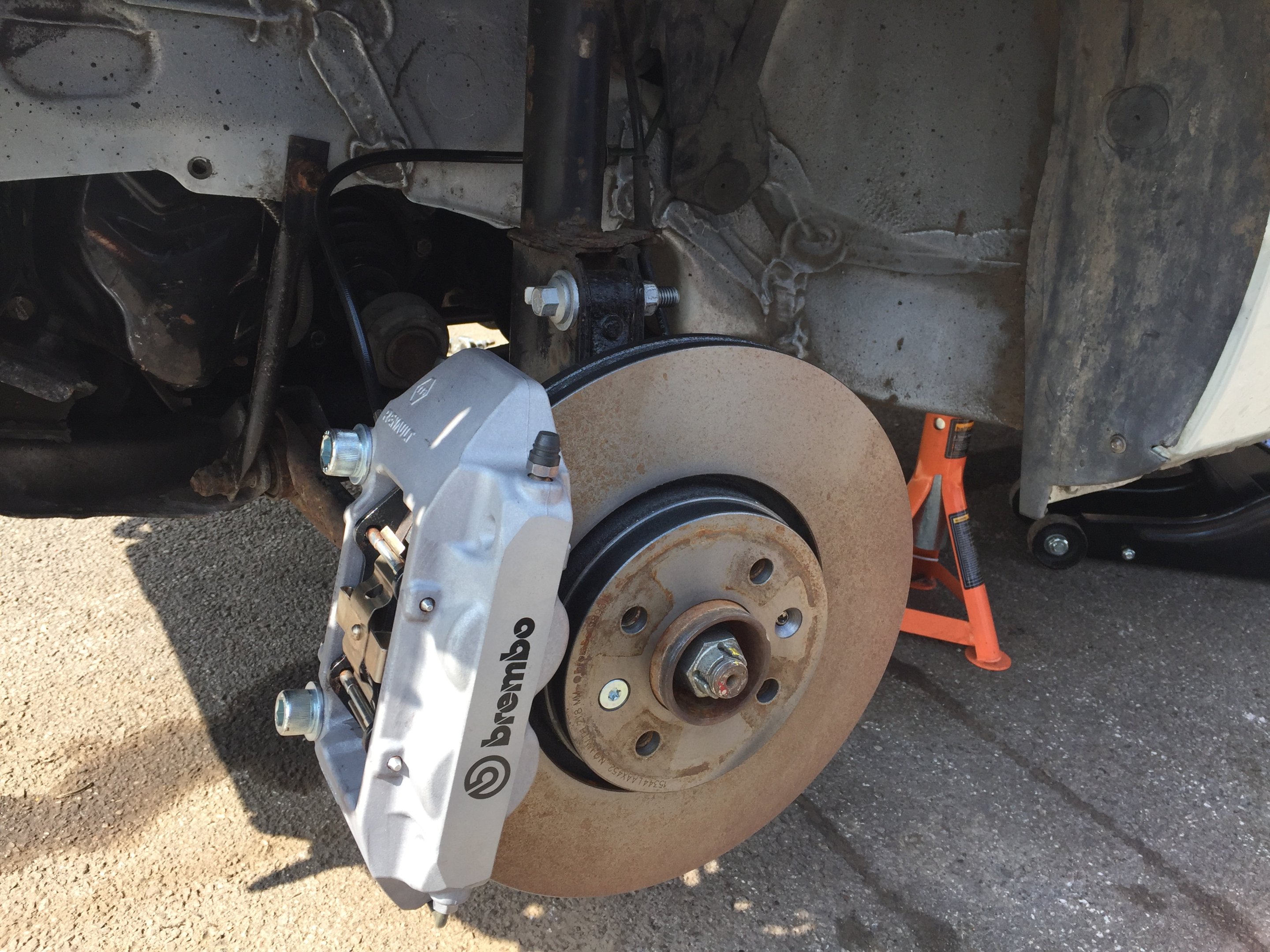

Hi folks, just bought some 197 brembo calipers to fit on my 182, just wondering what else is required to make these fit? Just got standard size discs at the moment. I know a new bracket is required but with Regards to brake lines will my current braided ones be cool?
Any help would be appreciated.
Cheers.

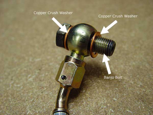

No you'll need lines which have the banjo fittings on the end.
Like this

Is it not machined to get the pad surface area better seated on the 280mm discs?
Id take the upright, disc, bracket and caliper into wherever you will machine them and take off whatever amount you need to make sure the pads arnt missing the outer edge of the disc. Taking 5mm off a 300mm bracket and the calipers might be okay but wouldnt on the brackets I have
