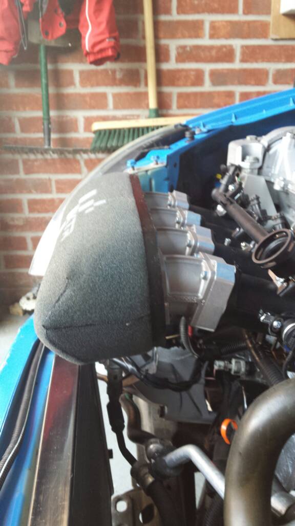

Trim the bonnet, I have the jenvey angle adapters on myn that cost 300 using 60mm trumpets which gives me a total of 120mm but I still had to trim the bonnet. Hope this helps

I don't have a link for the adapters but I do have a pic. I must warn your they aren't cheap! Look on jenvey website, your looking for 45mm spacers with 22. 5 Deg bend and also adapter from tf-sf if my memory serves me right. Total cost is 300.

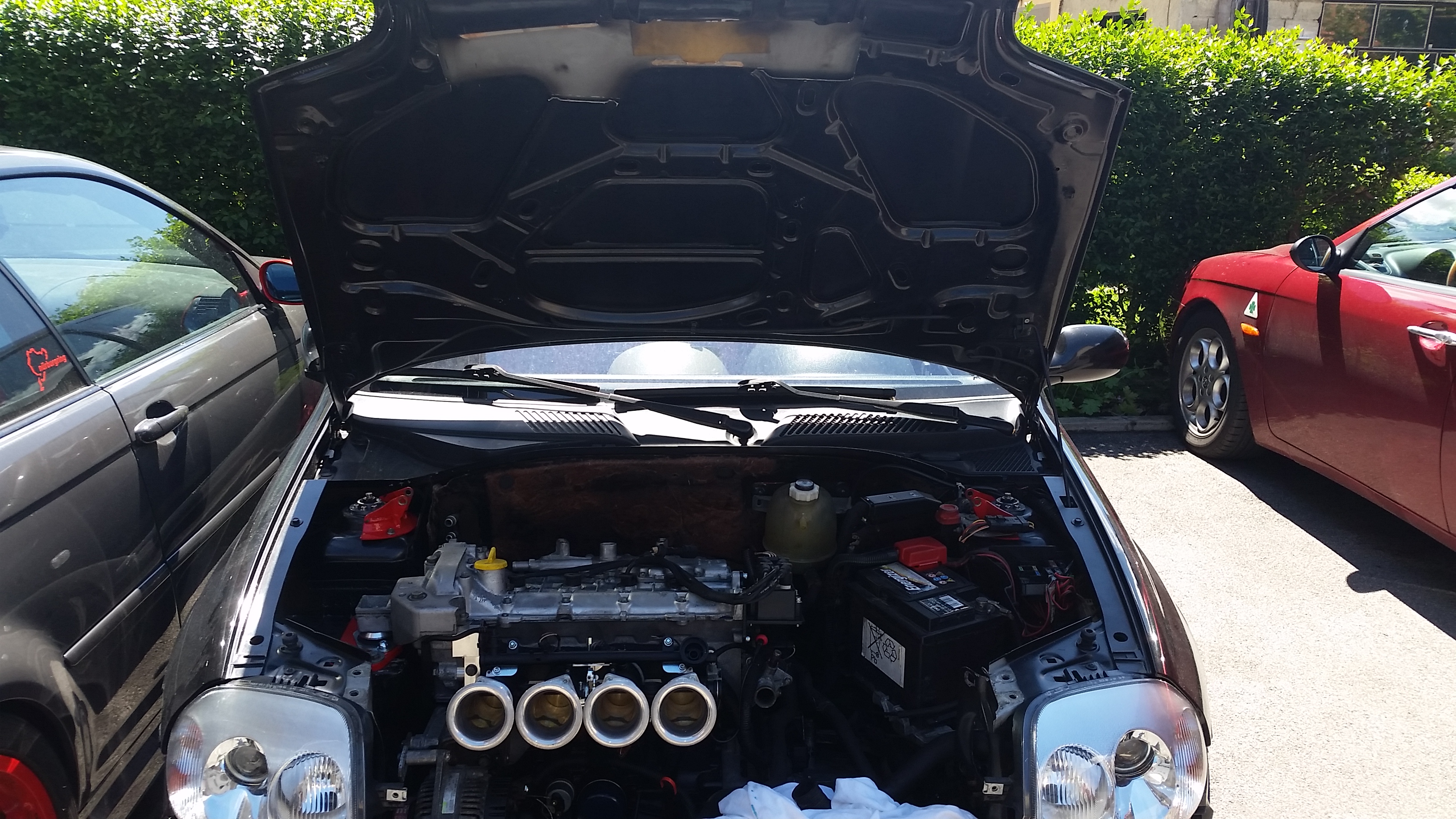

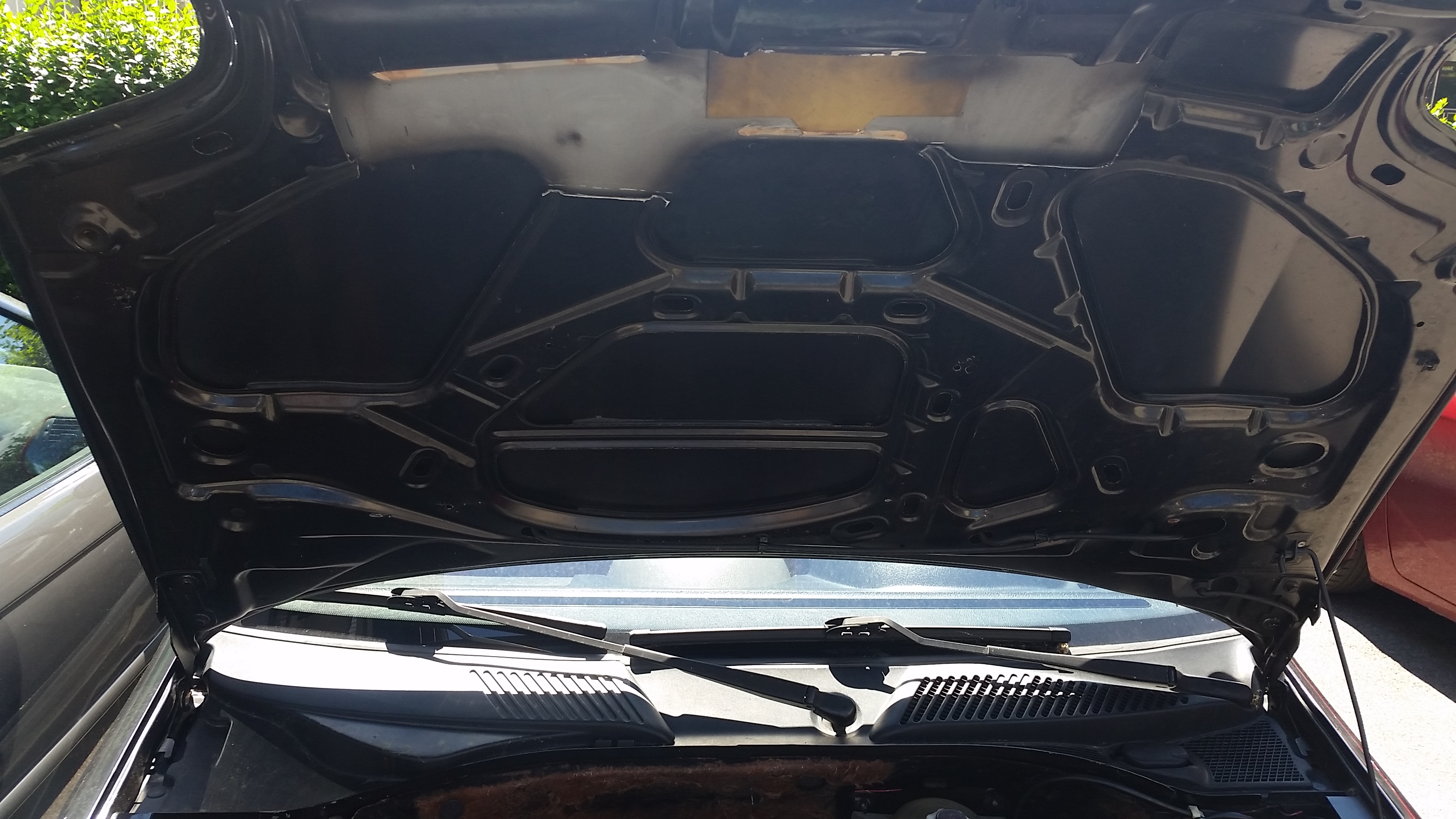

Finaly found the time today and tried... Dth 90mm fits on ph1 after a little bonnet butchering...
The bonnet clearence is about 5mm to the trumpets, since i got the hardest compound engine mounts it should not be a problem.
Probably will need to use the socks air filter.
Hope this helps someone.

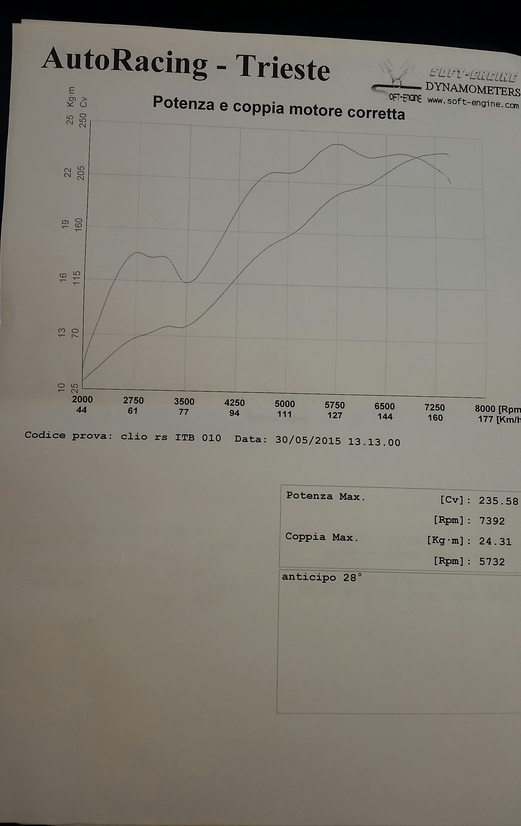

in the end just had to chop the inner side of the bonnet... the car was mapped in italy and made 235hp
acceleration... didnt manage to get it to 100mph cause i ran out of straight line and was holding with one hand a camera and the steering wheel... all in all i'm verry satisfied.. weight is 990kg, still a bit of lightening to do ;-)
