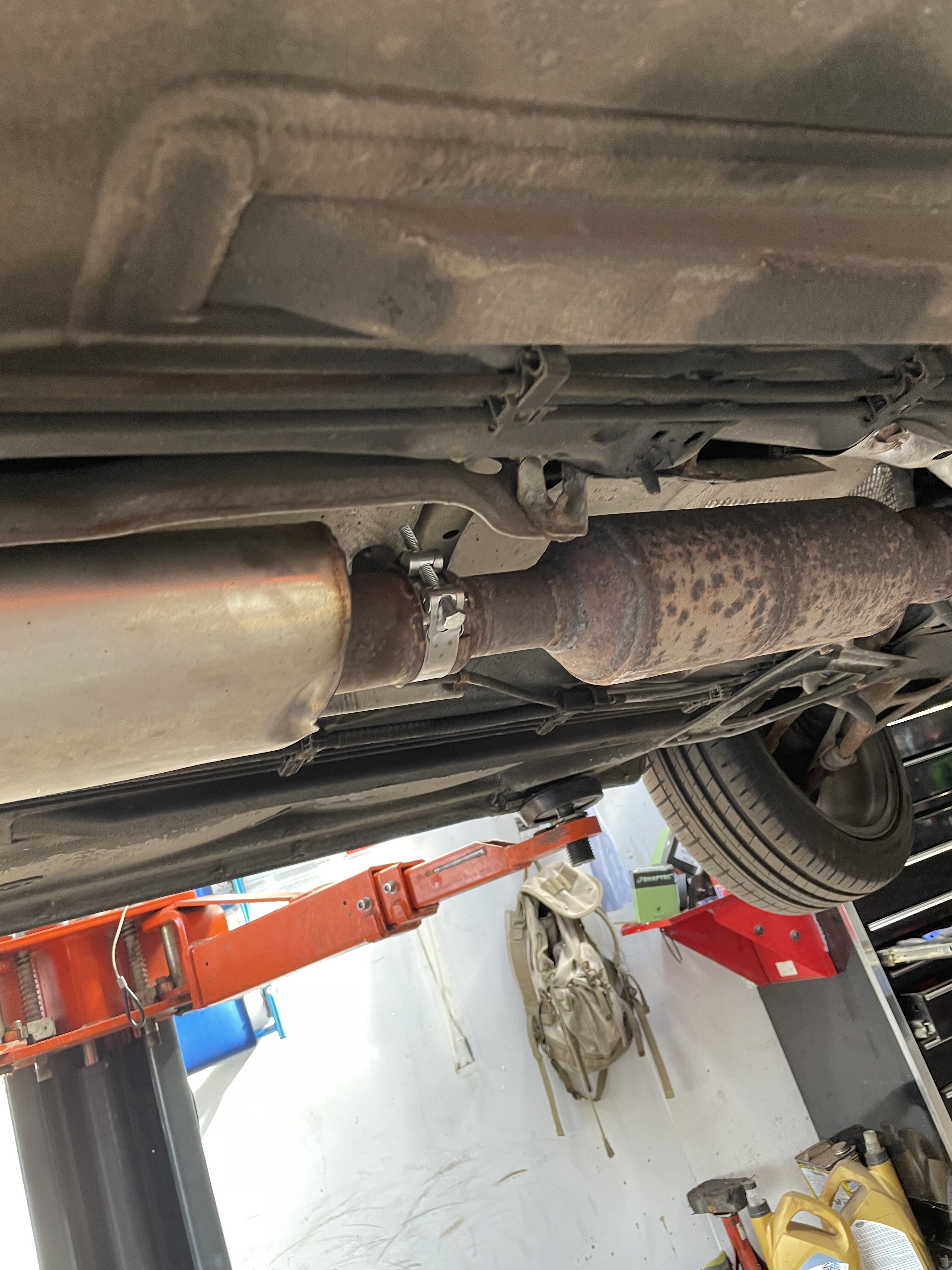

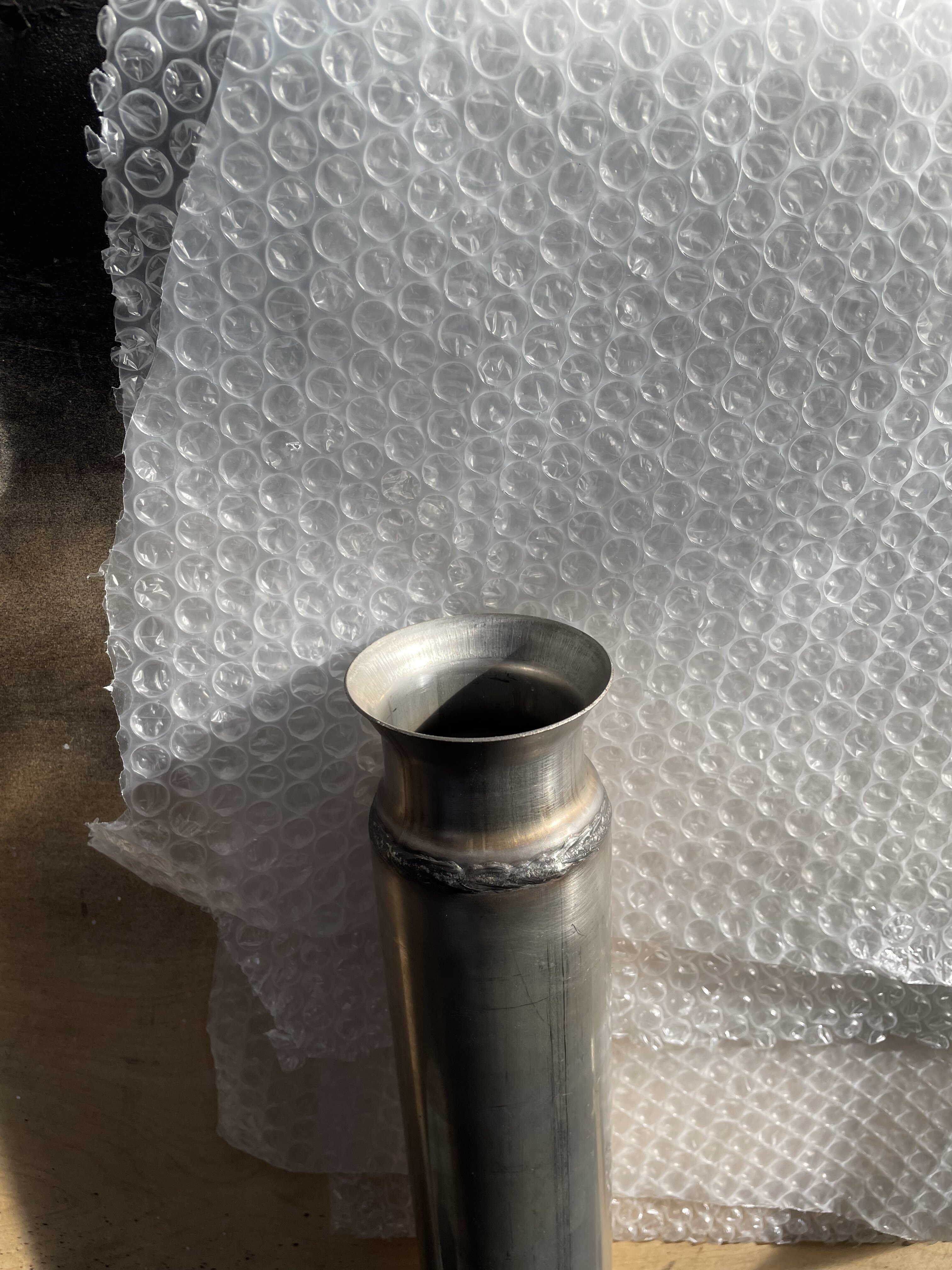

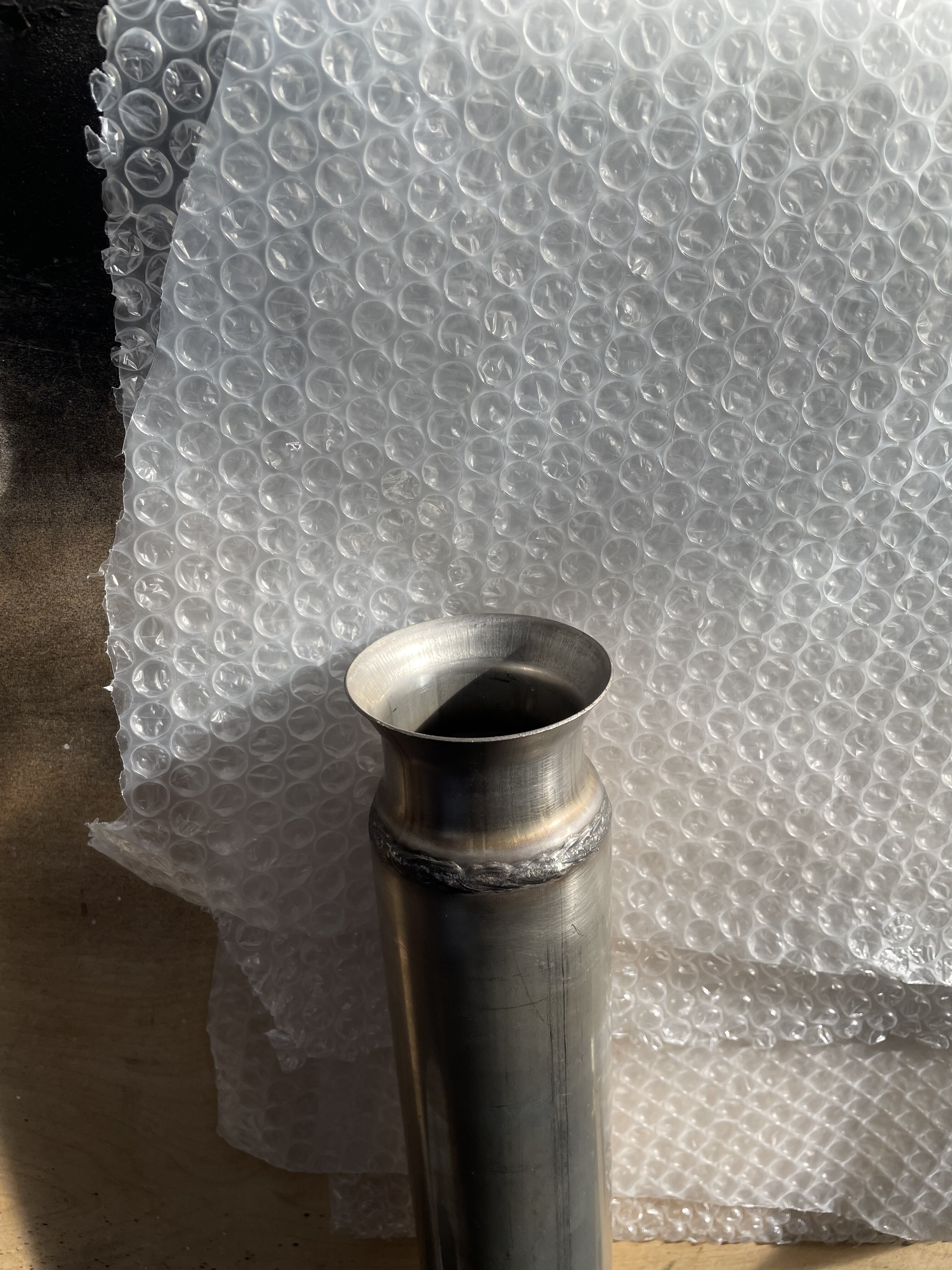

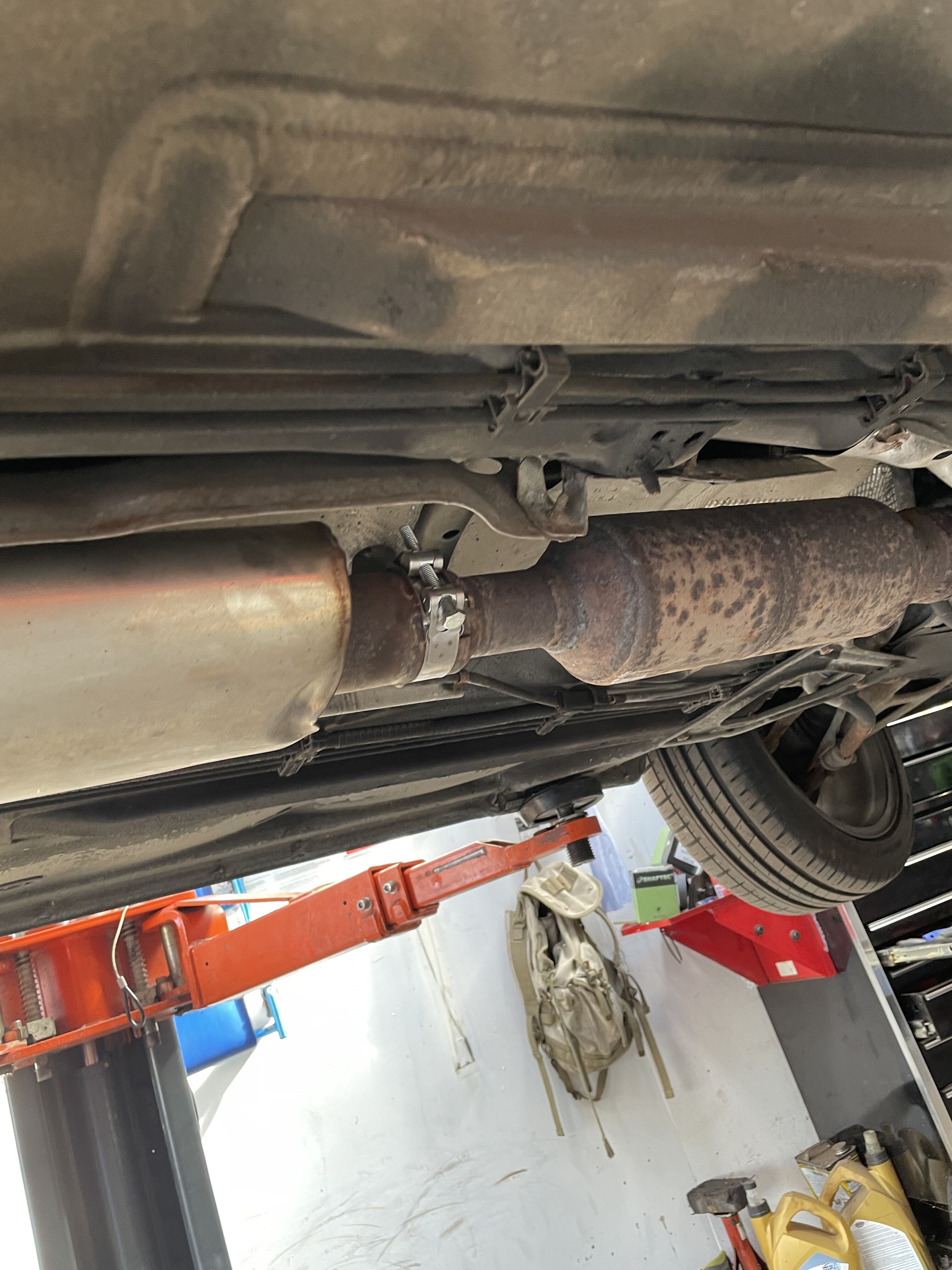

This is the joint on the end of the non res pipe however I don’t have a photo of the end of the cat sadly! I have this photo of the cat with the old resonated pipe attached. Don’t know if that’s any help
This is the joint on the end of the non res pipe however I don’t have a photo of the end of the cat sadly! I have this photo of the cat with the old resonated pipe attached. Don’t know if that’s any helpView attachment 1545182View attachment 1545181
Your original cat has been sleeved to remove the olive joint, which is a terrible design and always ends up blowing! The flaired joint welded on the new system needs removing and adjusting to suit.
Most aftermarket systems come with that joint as a removable part as most have done away with the olive joint and aftermarket cats/decats do also. Most custom exhaust places should be able to sort easily. Much better without the olive joint in the long run.
Looks like the original cat has had a 2.5 inch pipe welded on to fit inside a milltek centre section.
Even if you cut the olive joint off the scorpion you would then have a 2.5 inch pipe so would just butt together.
As @clio tyres has said, this should be pretty easy to make work.
Either your mechanic is hesitant to modify your brand new exhaust, or doesn't really want the work. An exhaust shop should have it sorted straight away.
