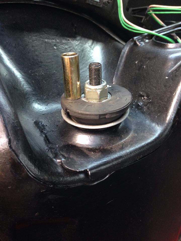

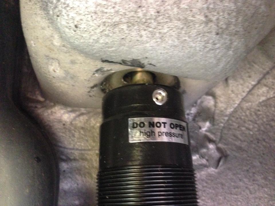

But a couple of questions. The main one being about the rear top mount rubber.
Do I need the little gold washer still? If I leave this fitted then there's a gap between the chassis and the top of the damper shown below.
If I remove it, the damper touches the car. But then it's hard to judge how tight to do the top nut. doesn't feel tight at all but can see the rubber compressing a fair bit.
My thoughts are that the gold washer needs to stay fitted to protect the bush? But then why is there a gap, or is this normal.... See pics below.
With gold washer fitted:
The washer removed. Gap in the arch is completely closed up now..
as Paprika123 has suggested the rubber bush is a 2 piece item. one half goes inside the wheel well, the other in the boot. The metal sleeve joins the 2 halves of the bush together
Makes sense to me. I must have just missed it when removing the old shocks. Silly mistake but I'm learning lol.
So I keep the metal sleeves in then yeah?
Cheers.
Yes keep the metal sleeve in, easy mistake to make if its the first time you've had the rear suspension in bits.
