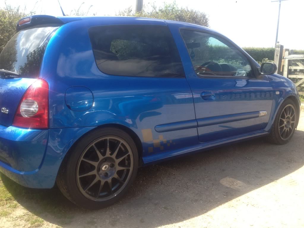

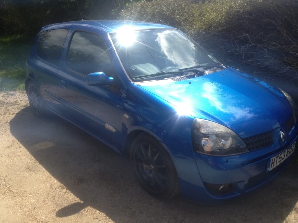

Well the car I'm looking at has anthracite turinis on? I've no idea what size or offset they are as quite new to the scene. My previous car was a focus rs and it had 362mm discs with ap 6pots on and the braking power was incredible!
on a side note what do you think this is worth as don't want to get my pants pulled down:
done 70k had the belts done and currently has no MOT?
Those are 16" wheels so you will easily get 300mm under them, and if you are prepared to spend some money you'll get 320+
But I am really not sure why you want to unless you are going for big power.
