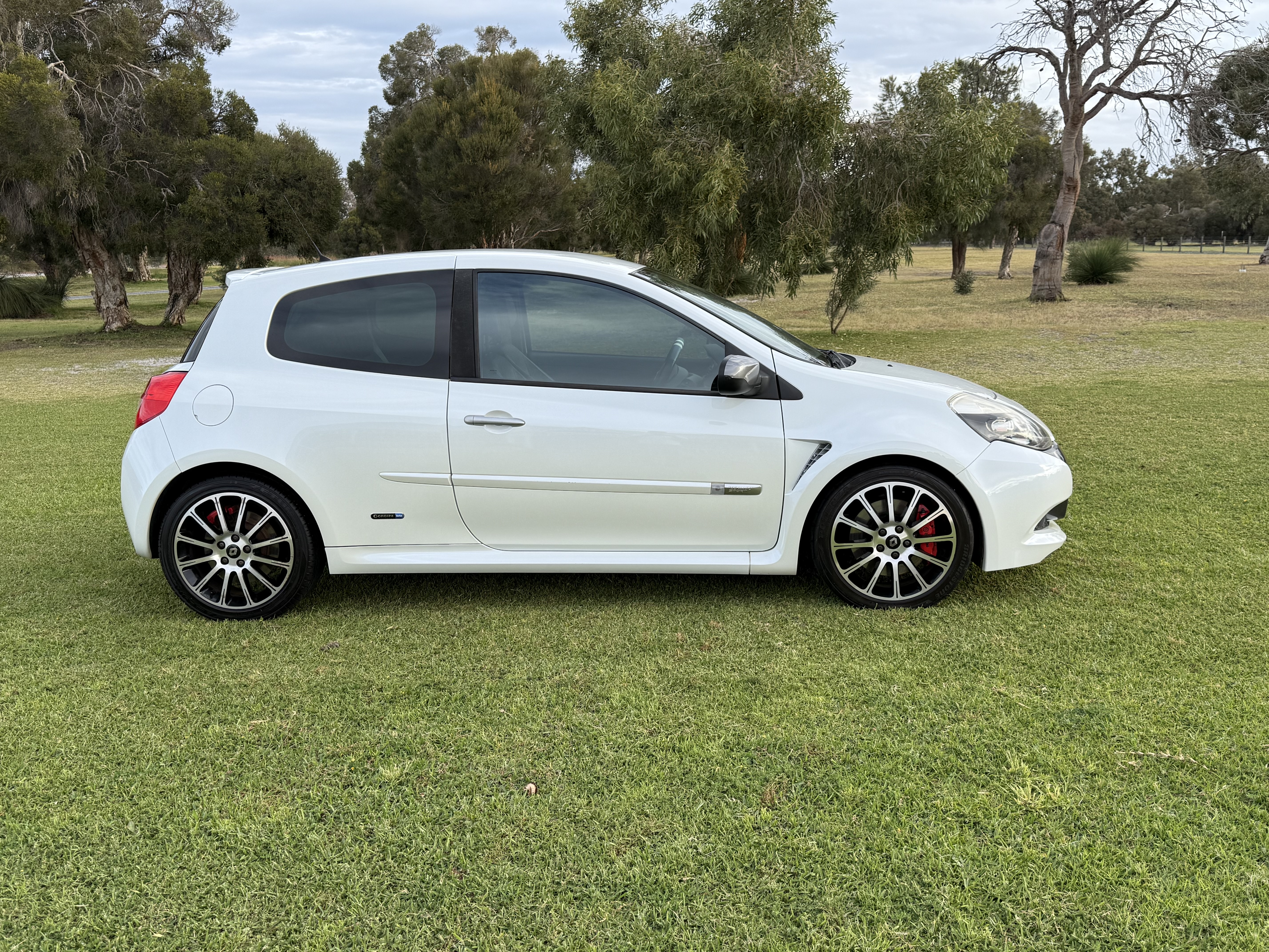

Hi all, new owner and first post, can’t see an EBC thread.
Recently purchased my first Clio, keen to upgrade the front pads. Road car with occasional Club level motorsport event.
Thinking EBC Yellowstuff, but keen to know:
- thoughts or experiences on these
- other Recommendations
Also without me lifting a wheel, can anyone provide the part number for RS200 Brembo brake pads?
Many thanks
