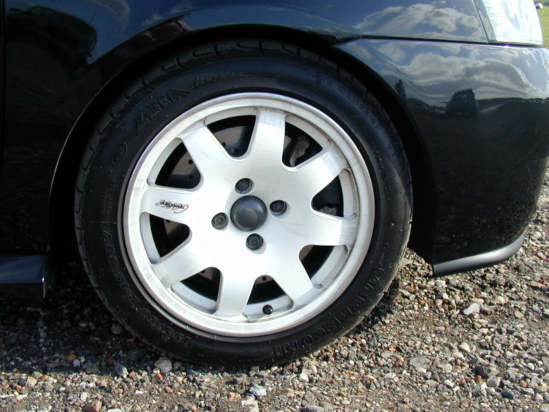

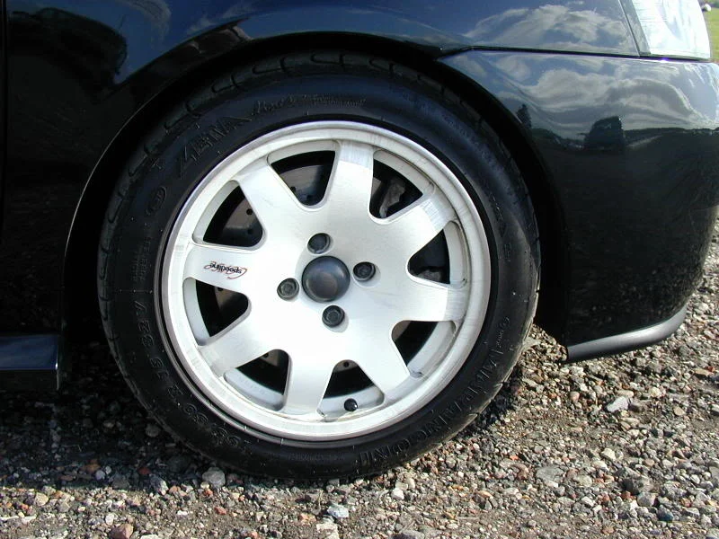

i've got the k-tec big brake disc conversion, as edde says and i think it looks much better. Heres a pic, bear in mind this is behind a 15 inch wheel lol
eddes cheekily found out what car takes that size disc, and i think its a renault 21 or 19... im sure he'll correct me though ;)
